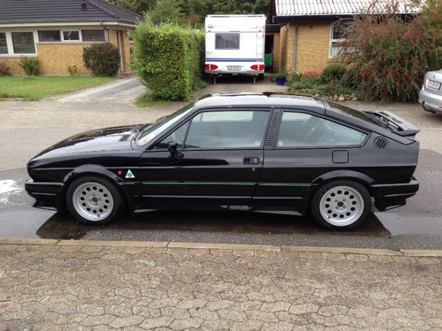

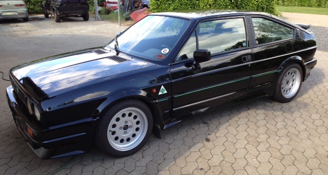

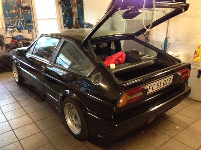

This is my Sprint. It has been in my ownership for almost 5 year but I know the history and the person who rebuild it back in 1991/1992. It sits on Ronal A1 7x15 and yellow Koni with 45 mm lowering spring At the moment it got a 1,7 ie engine converted to carbs with raised compresion, lighter rods, 282 degress C&B cams, very light ported heads and a 2,5" Iresa exhaust with a crossover manifold. It puts out around 130 bhp which is not enough so I'm building a 16v on carbs just for the fun of it :)
Here is a ton of pics :)

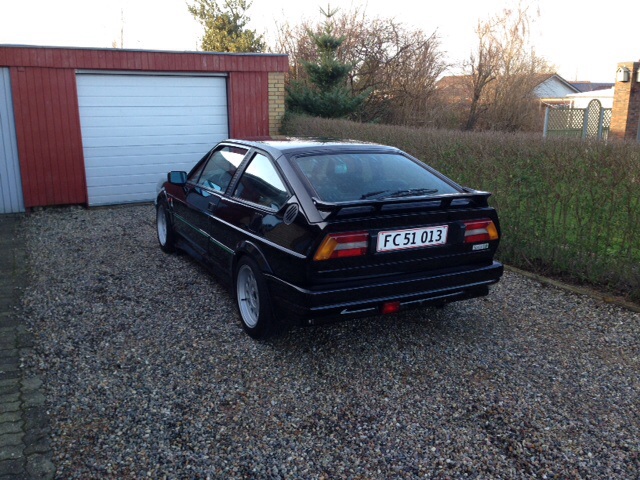

Familie car :-)
Re: Danish Zender Sprint
Nice sportwagon 8-)

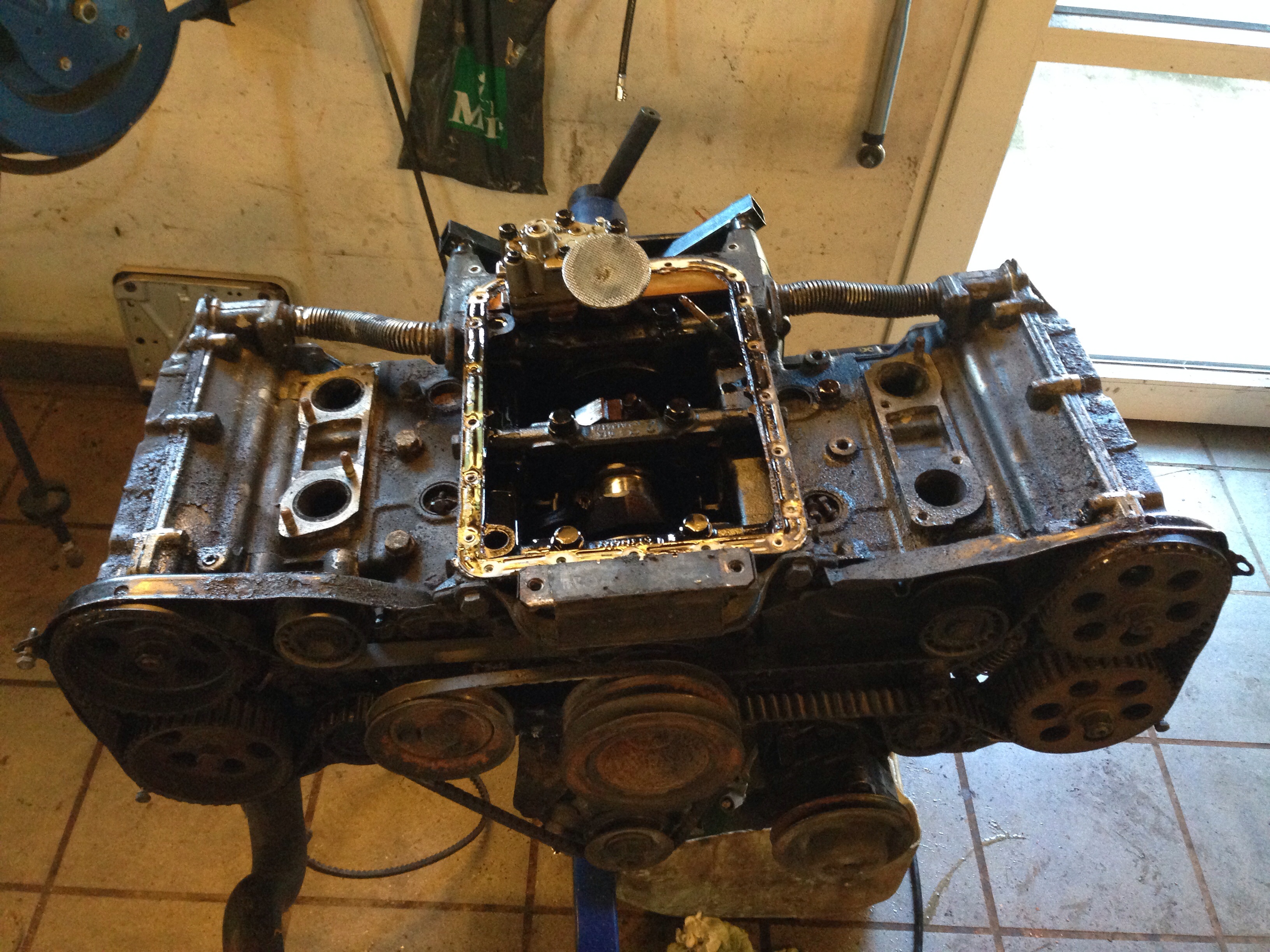

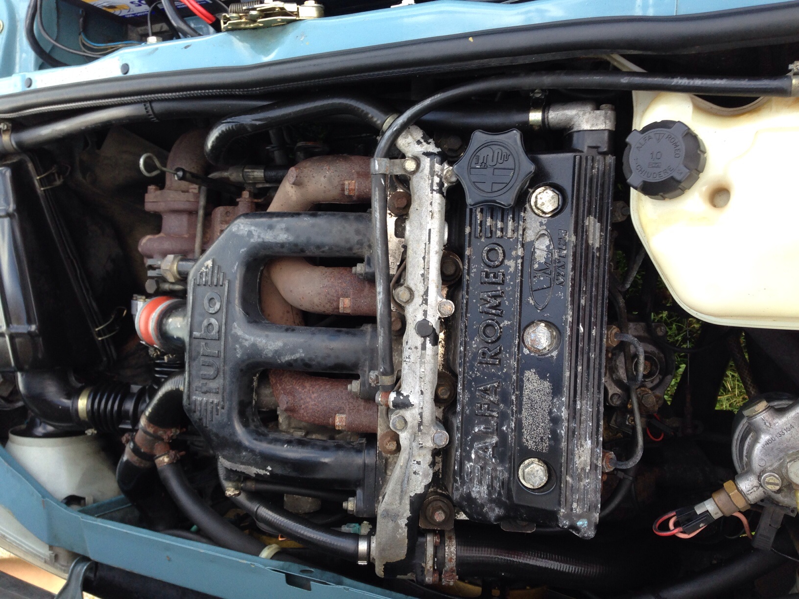

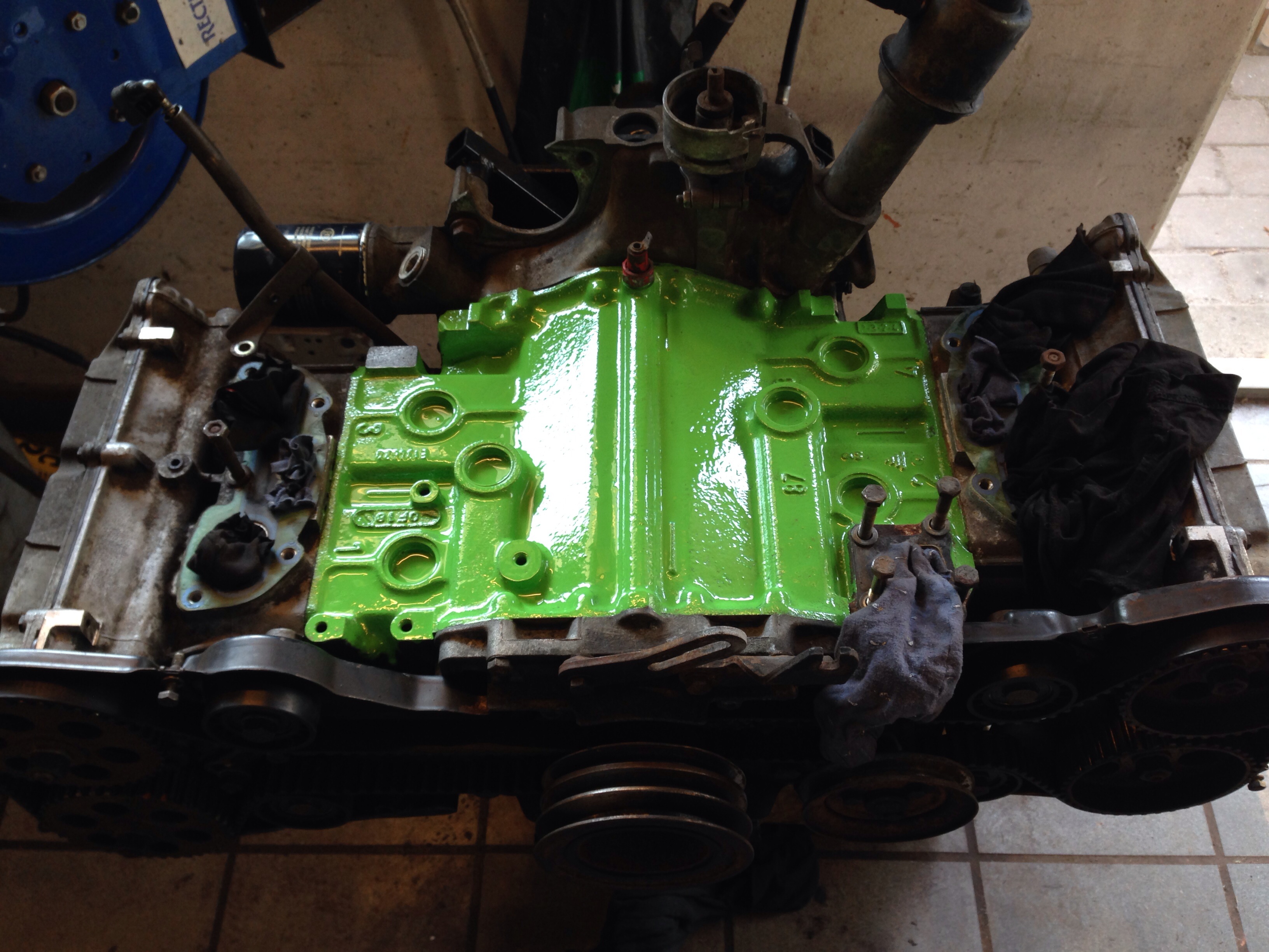

Finally got some time to work on the 16V engine :) Big ends bearings ok so no point in changing them :) TB etc striped of the engine. Will get a nice cleaning with hot steam and after that some green Hammerite :)
SteffenJ3316V
Posts: 130
Location: Denmark
Post by SteffenJ3316V »

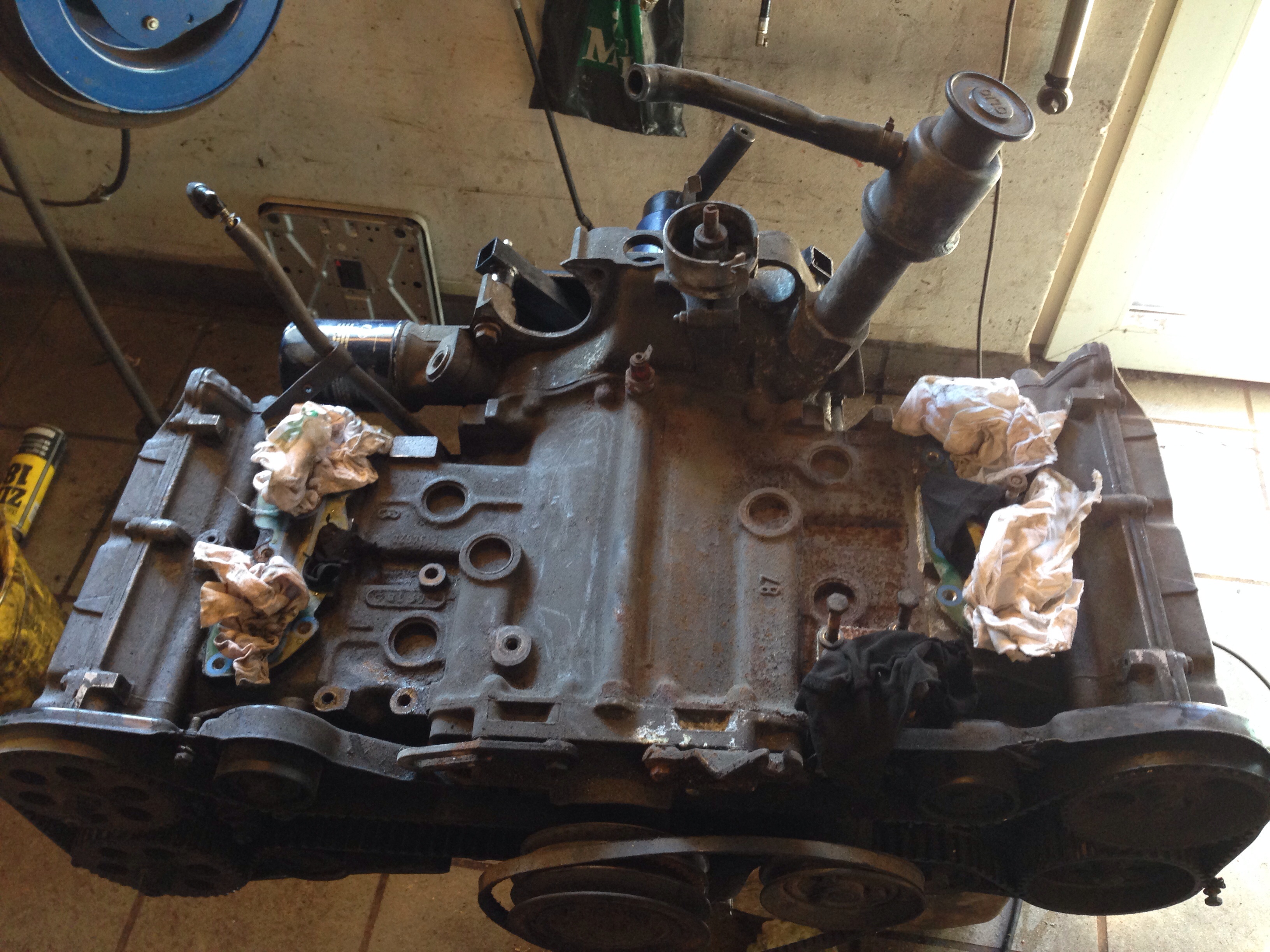

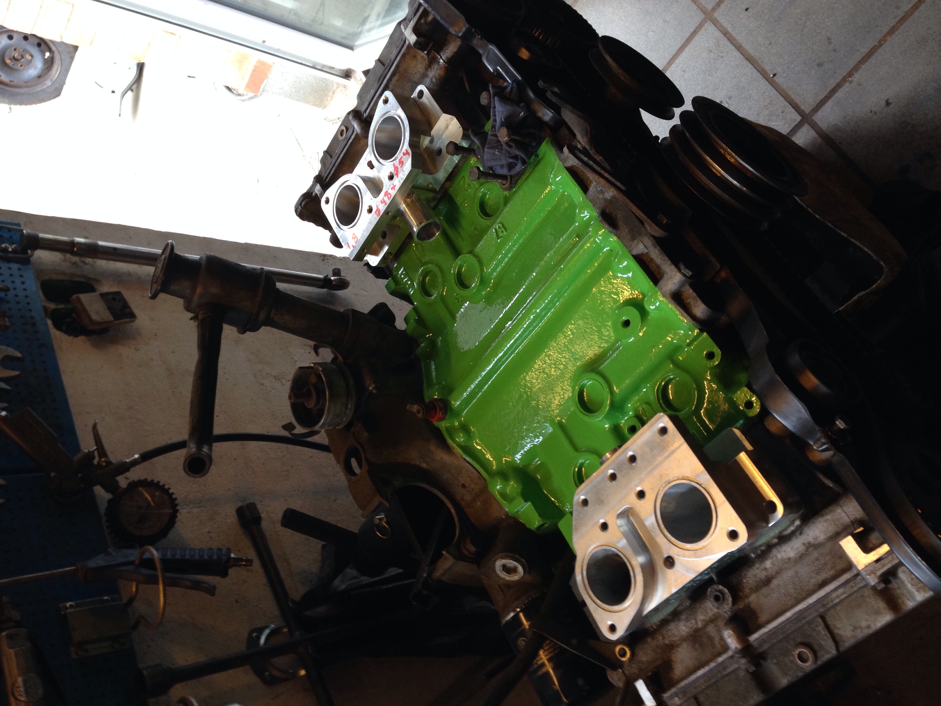

And now it's green :D Still needs a 2nd coat though. A picture of the manifolds aswell :)
It looks like the inlet manifold has been milled from solid? - Neat work.
PS Very nice Sprint!!!
SteffenJ3316V
Posts: 130
Location: Denmark
Alfasixnut wrote:It looks like the inlet manifold has been milled from solid? - Neat work.
Thanks :)
Yes they have been milled from solid. A danish guy who works with CNC machines made them to use on his own buggy. Then he desided to make a few ekstra pairs to make a buck since all the hard work with making the programe for the machine was done :) They are by far the best ones i have seen :)

2nd coat of paint and trial fit of manifolds :)

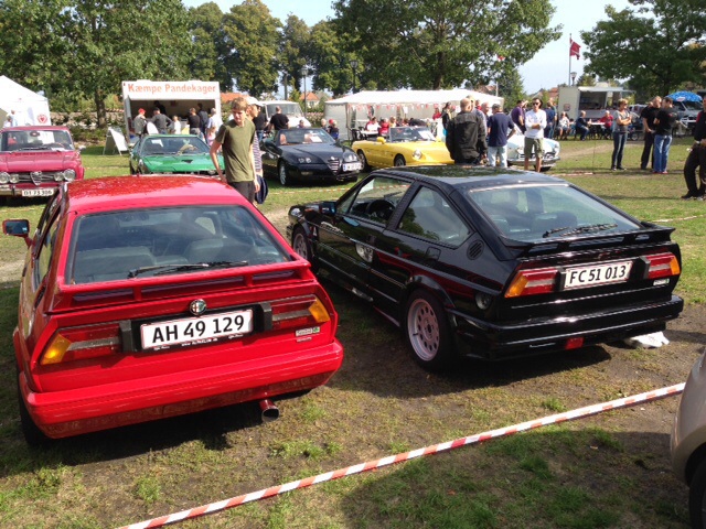

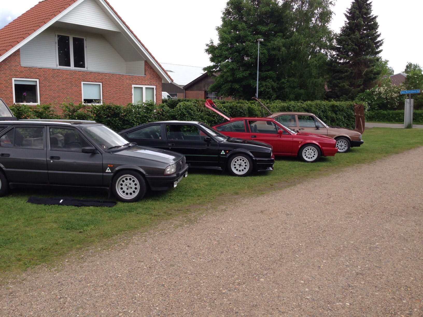

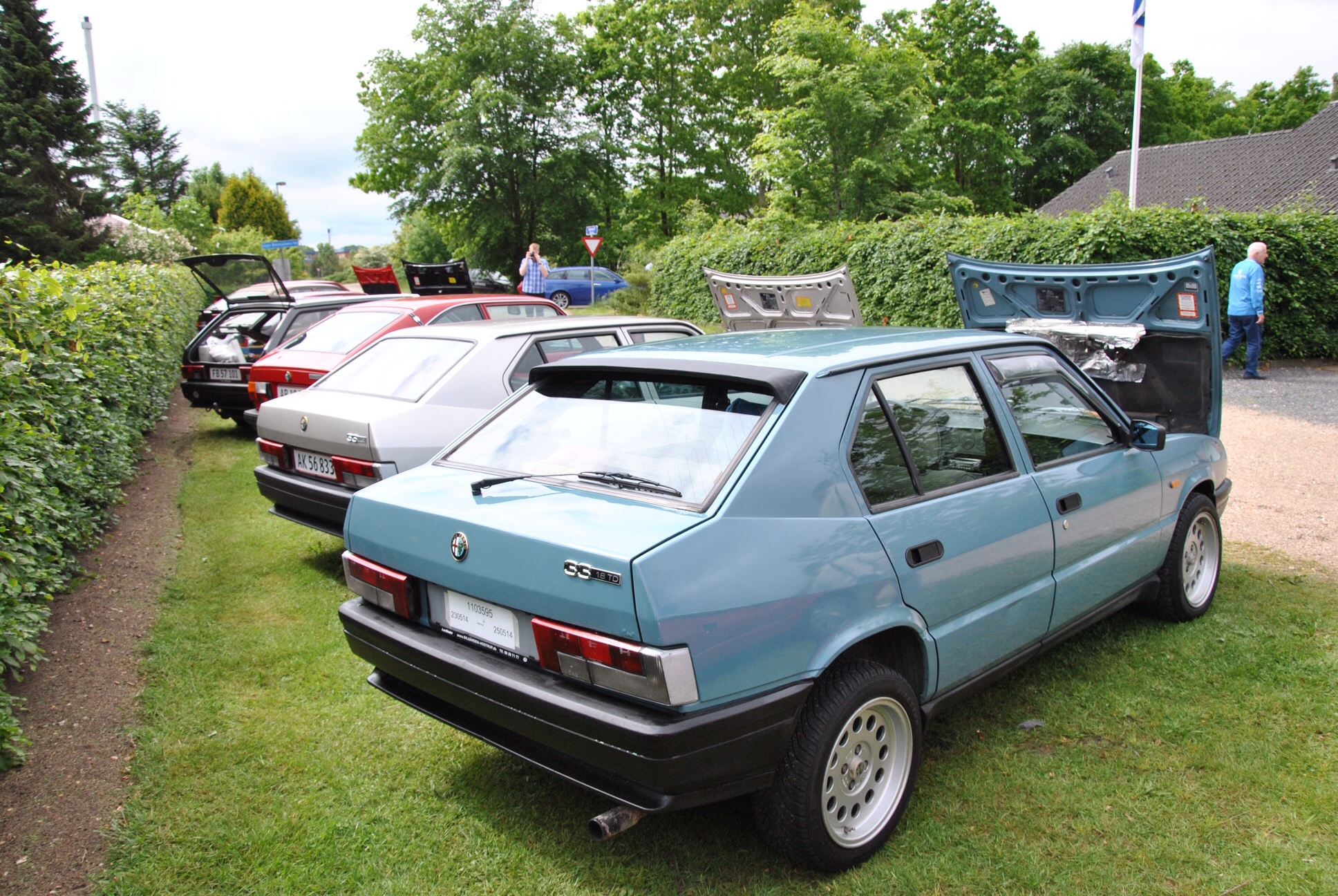

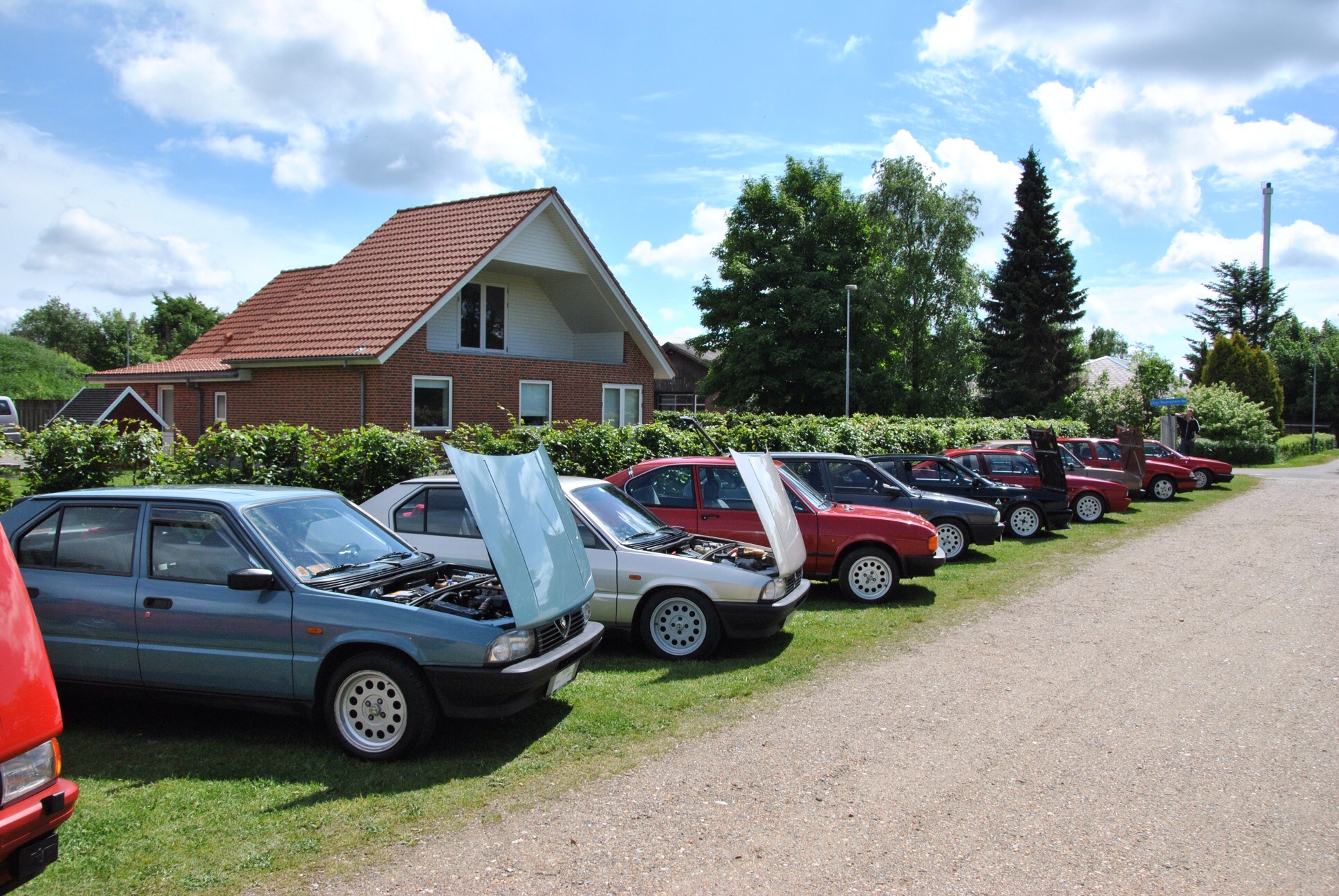

We had planned a boxer day with the Danish Alfa Club. It seems that Ronal A1 is the wheels that everybody wants :D
Simonsud
Posts: 331
Post by Simonsud »
What engines in the second to last picture !!!
vecchioalfa
Posts: 433
Post by vecchioalfa »
Simonsud wrote:What engines in the second to last picture !!!
Looks like the 1.8 VM Turbo Diesel
SteffenJ3316V
Posts: 130
Location: Denmark
Yes that is correct :) It's the blue 33
Looks like a great day and a top turn out 8-) nice boxers :D
