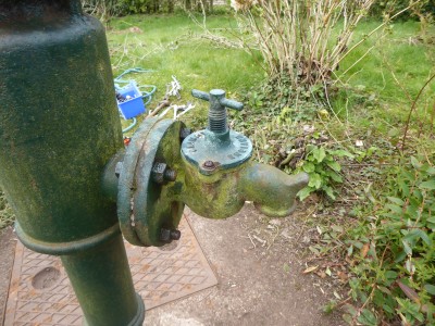

Started rebuilding a water pump, not expecting one so old were you ! :lol:
So this is the post I said I would do last week for any silly comments or attempts at humour in this worrying time.
Its not coming apart in any rush the bolts are &/16 Whit and the greae has long since left so keep worrying them and penetrating oil etc .
Love the tap on the side. Tererbly old English
Over to you.......

Well...I have shown you what an odd task I am up to anyone else out there working on odd stuff.
p.s all I have managed to do is get the Tap off so far. Need a 7/16 whit ring spanner and a bigger blow torch.

I expected to see an old vintage car water pump, so you fooled me too! :lol:
Great project, love stuff like this.
I might have a whit spanner if you need one, got a bunch somewhere in the shed..

Bolts all rusted solid. Only thing moving for a week was the little tap on the side.
Sheared several bolts despite great care. Plus lots of heat and penetrating oil used up and patience. :evil:
No information on it on the web. Took some pictures to show you all and lost the camera. Argh ! :? :evil:
How can something so simple be so frustrating.

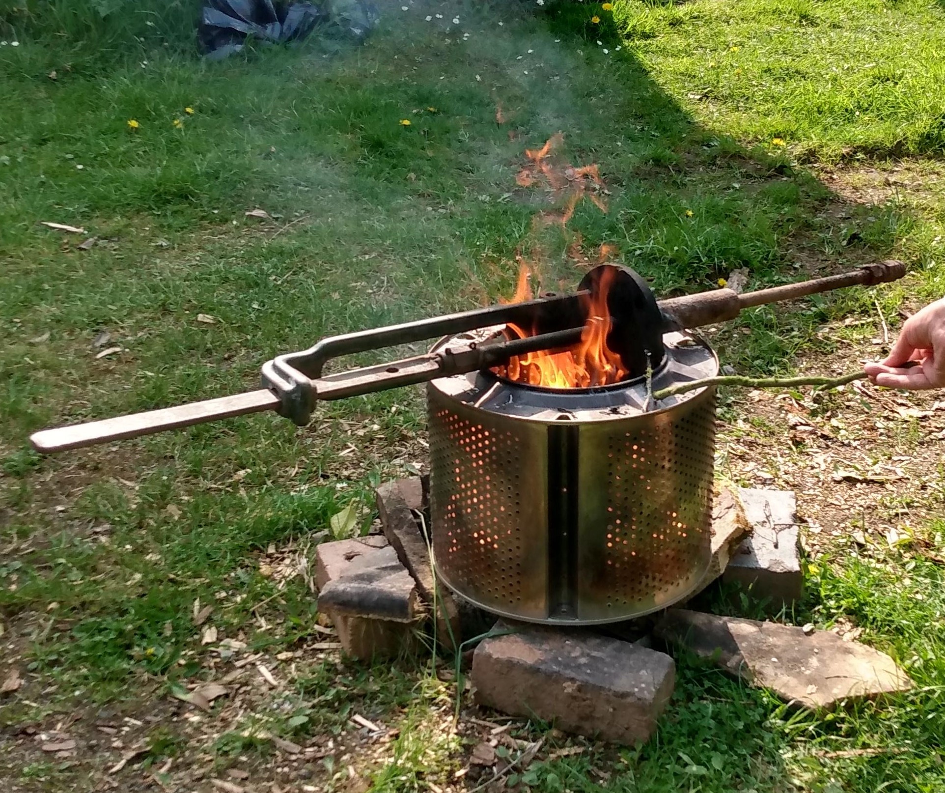

Rain stopped and had all the right ingredients. English hardwood charcoal as it burns so much hotter, then pine cones which the Romans used for smelting on top and it got so hot when I poured oil around the brass nut it just ran down the threads as if sucked in. That then unscrewed and all kinds of rubbish and rust came out.
Had my son helping as he is a burns nurse so stopped me being stupid as he has seen every variant of stupid and as he says `only been on the ward for 2 yrs !' Did manage a small finger burn, but hid it well. ha :lol: :roll:
Then the bar moved and if I can buy some bolts i can start rebuilding. So pleased not to have broken anything and glad i kept calm and just worked at it. :lol: :D
Posts: 2901
Re: Rebuilding water pump.
Great stuff, good old fashioned, tried and tested methods. A great result.
Good use of an old washing machine drum as well.

Kegsti66 wrote: ↑Mon May 04, 2020 10:30 pm Great stuff, good old fashioned, tried and tested methods. A great result.
Yes I was impressed that the washing machine drum did not melt. I have seen whats left when large charcoal kilns melt
(when the air supply gets out of control) and they are some serious steel, so it did very well. :D It does not look hot,
but it was impressive. :lol:
