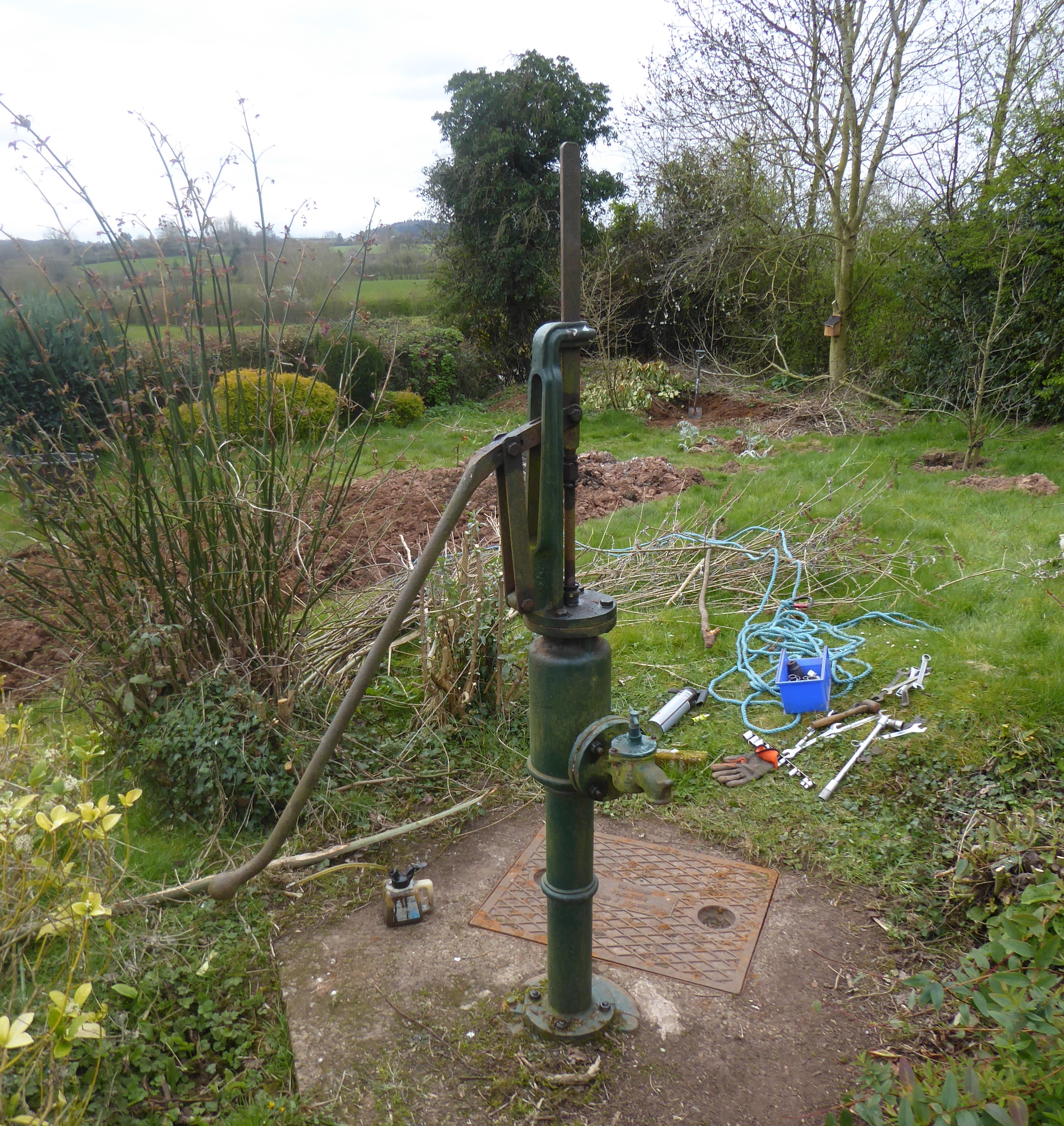

Started rebuilding a water pump, not expecting one so old were you ! :lol:
So this is the post I said I would do last week for any silly comments or attempts at humour in this worrying time.
Its not coming apart in any rush the bolts are &/16 Whit and the greae has long since left so keep worrying them and penetrating oil etc .

Bolts all rusted solid. Only thing moving for a week was the little tap on the side.
Sheared several bolts despite great care. Plus lots of heat and penetrating oil used up and patience. :evil:
No information on it on the web. Took some pictures to show you all and lost the camera. Argh ! :? :evil:
How can something so simple be so frustrating.

Pump now has the lid loose, but it will rise no further than this which is very annoying.
This brass bolt is simply very very tight and not sure where to get a new one if I ruin it. Also this task is meant to pass the time not turn into a trip to casualty or great annoyance.
I think the cup at the top held grease or similar at one time and stopped the steel rod from rusting and swelling.
You can fill it with penetrating oil and it stays there in the sun for hours. :roll:

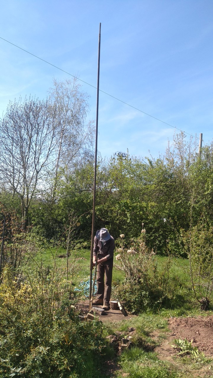

Finaly got the pump off by accidentally snapping the shaft at the top as it turned out to be a tropical hardwood ? :shock:
Then got one shaft out detached it and pulled out the next :o
Re: Rebuilding water pump.
that's a big flag pole :D

Finally got the whole thing out and now trying more heat. Typically the valve/plunger at the end that spends its time
under water is in good condition. I just hope the clack valve at the bottom is fine as I can only see going down the well
as the way to resolve that and I do not fancy it.
Brass nut still not moved :roll:

How deep does that go James. Twenty to twenty five feet ? :shock:
Oh no, 40 ft to water and not sure how deep it is altogether, but I doubt if it is much more.
The shock was the first time I looked in there was when all the flooding occurred around here and the well looked 10ft deep.
Then looked the next time and the water was way down and such a shock I felt I was falling in ! :shock:
One of those times when your mind has an image it expects and then you just cannot quite process it.
