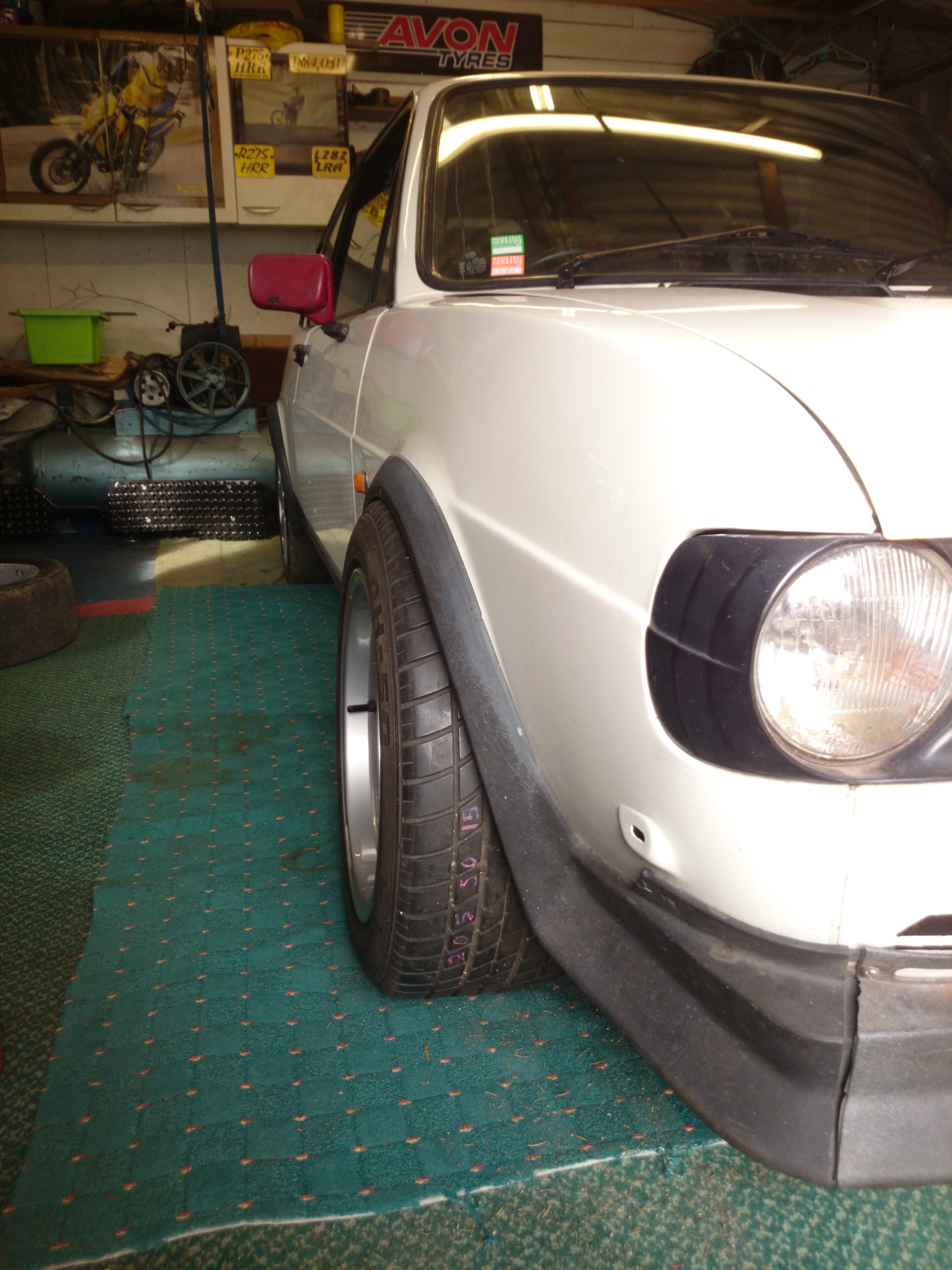

I've got 7x15 with 195/50/15 and only had to roll lip on arches to stop rubbing and its 60mm lower as well will look at offset when I get to work
Re: Bigger wheels
A 195 50 15 set up is just 25mm larger diameter than a 185 60 13, so will fill the arch 12.5mm more and sit 12.5mm higher too on the same suspension.
So if the width and offset arent radically different it is a painless exercise to run 15's.
I've got a few 15" wheel sets, running 195, 205, and 215 tyres, but also trofeo arches to use so going for a wide set up anyway, but be careful on what effect it can have on slow speed steering, it can start feeling heavy as the track and footprint starts to expand!
Looks and drives great though, I'd recommend 15's all day long :P
Re: Bigger wheels
Without Trofeo, 8j width and 205's gets a bit close!

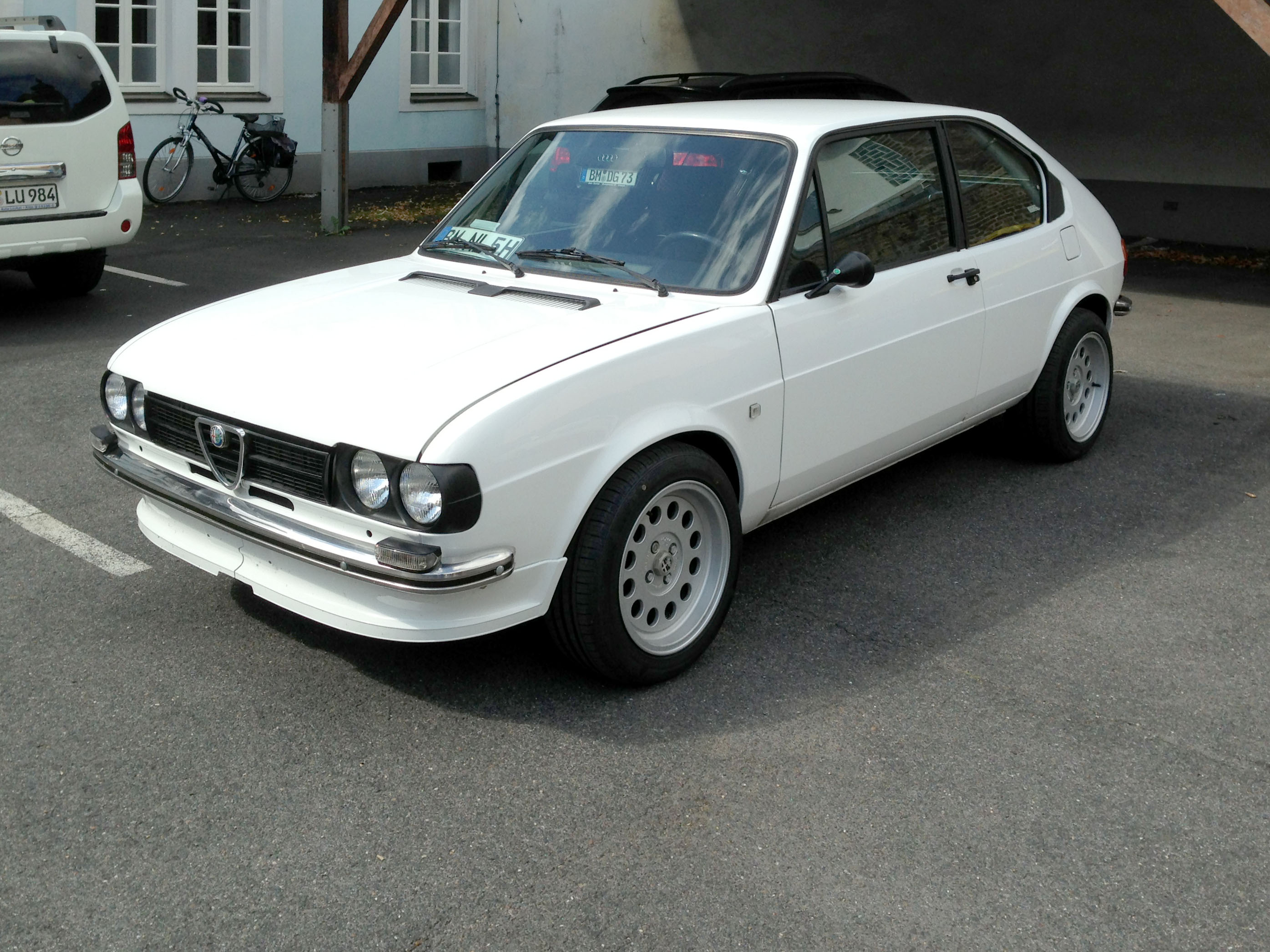

Simonsud
Posts: 331
Re: Bigger wheels
Post by Simonsud »
Offset 35 still room for wider tyre

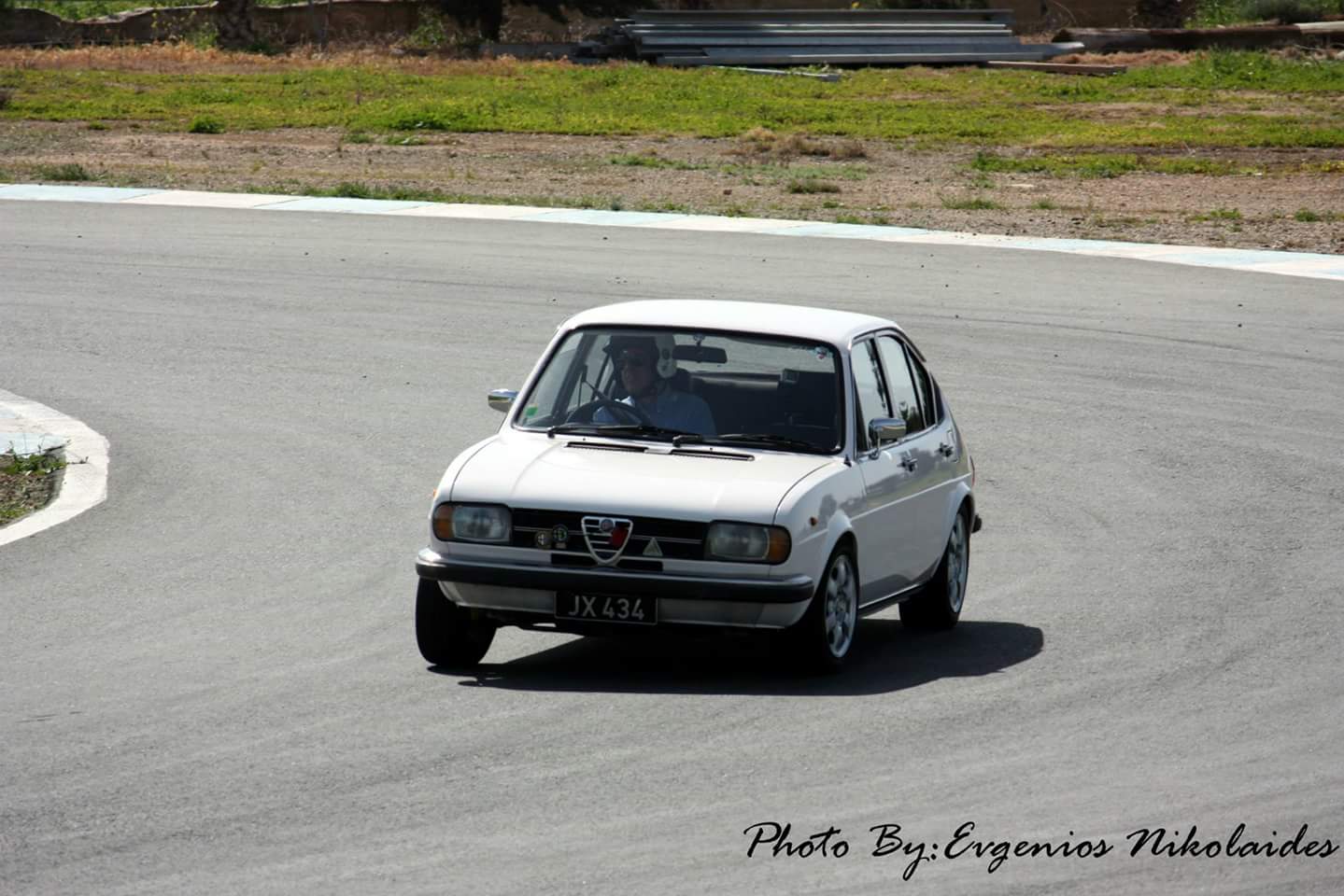

Factory fitted 13" rims are fitted with 165/70/13 street tyres, but for track days I am using a set of 14" (5.5" 36ET) with Toyo R888R 185/60/14.
With 14" rims you must fit 185/55/14 to get same overall diameter, but Toyo do not give such an option thus a bit of a higher gearing and slower acceleration. For best looks originally fitted 13" are the best, but road holding suffers compared to 14" ones.

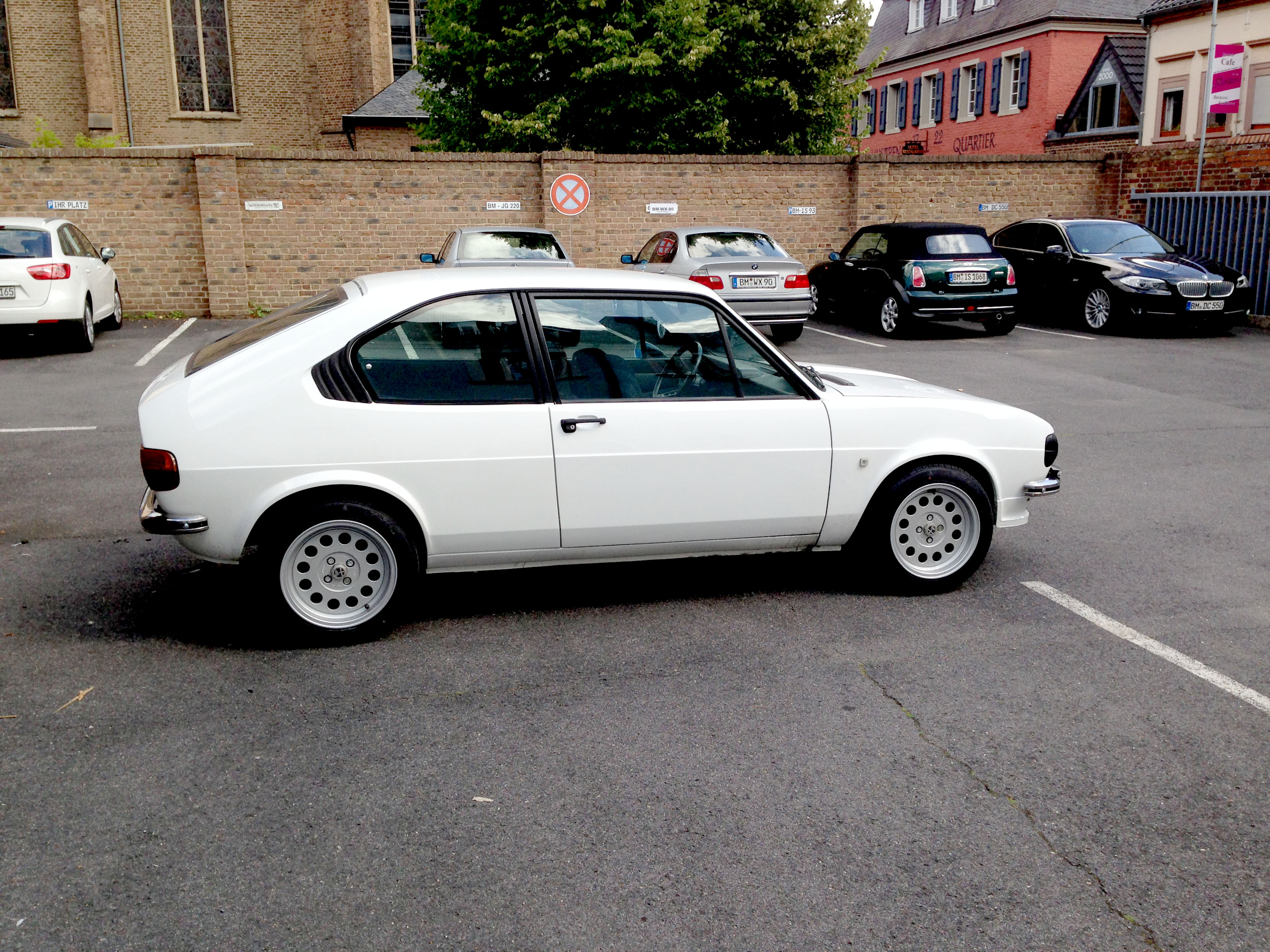

these are 185/60/50 on ronal 15 x 7 et 25
the car is not lowered at the back. i think she better should be lowered ;-)
Arches on the back are rolled
