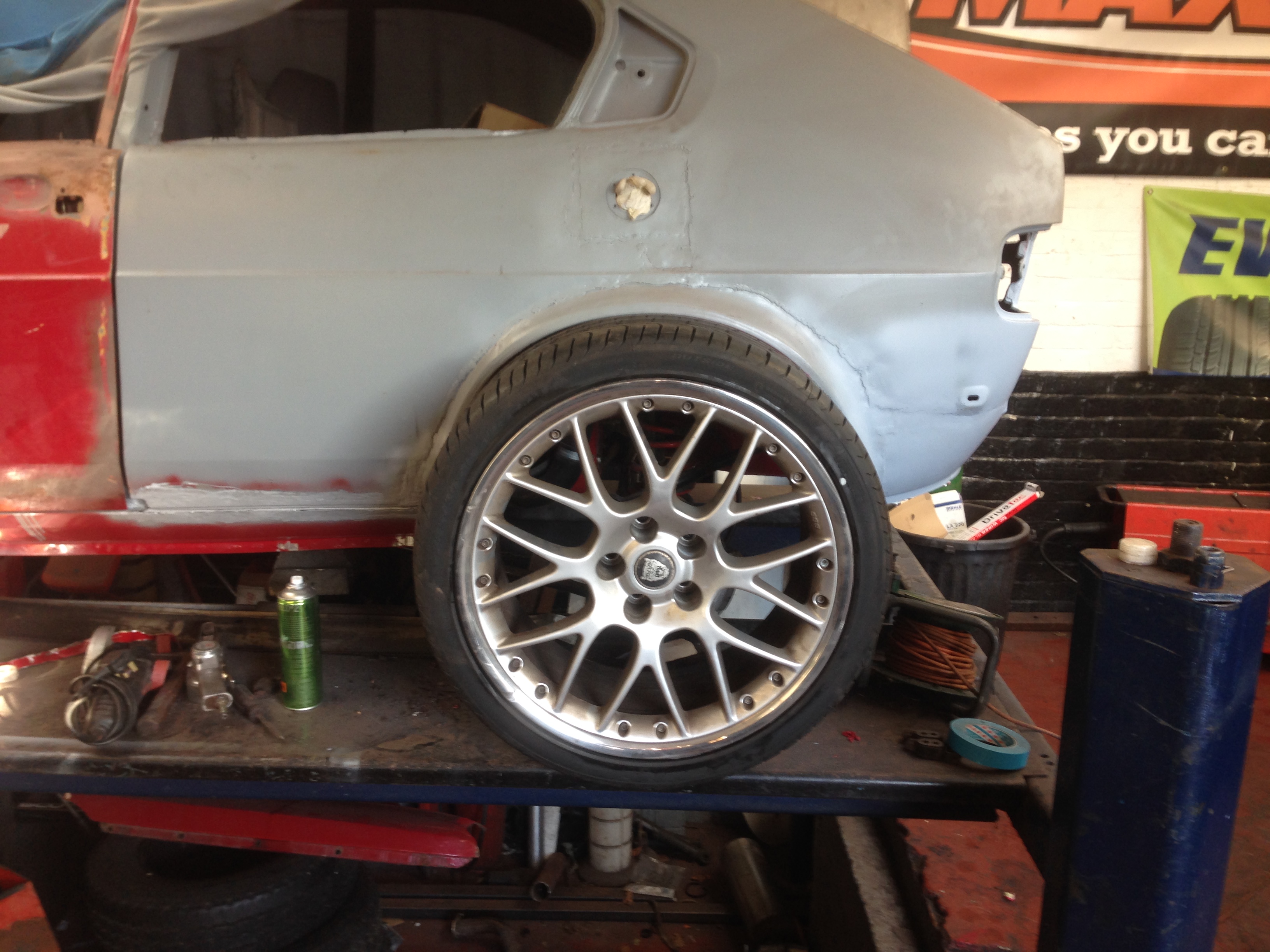

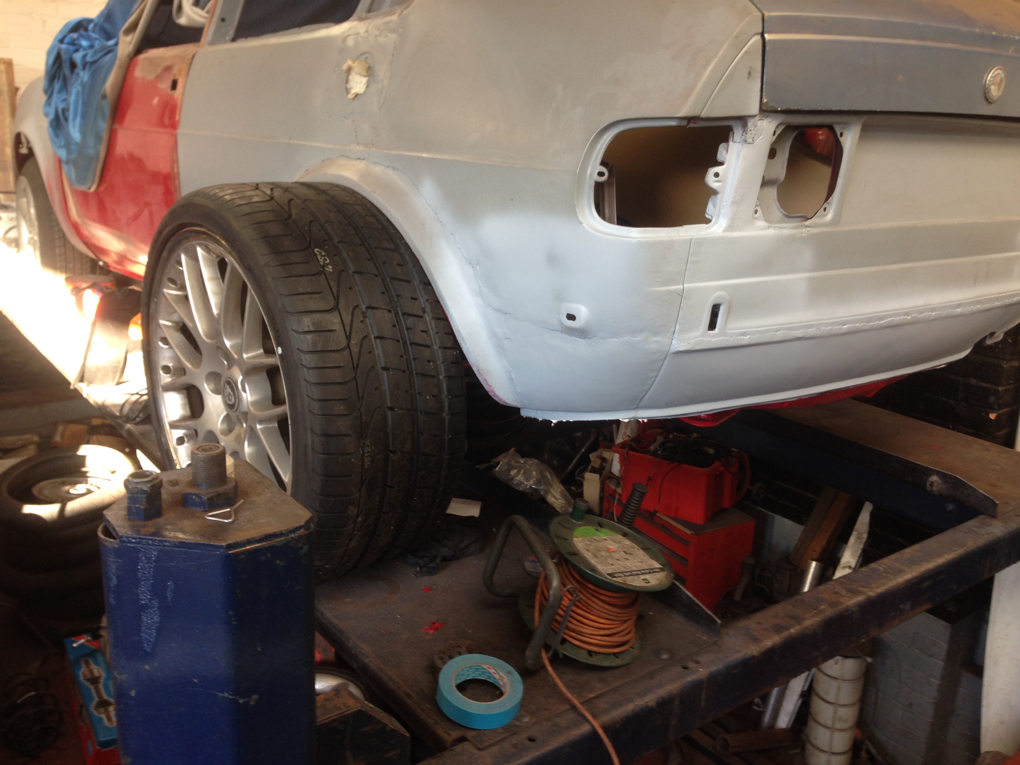

these are 185/60/50 on ronal 15 x 7 et 25
the car is not lowered at the back. i think she better should be lowered
Arches on the back are rolled
