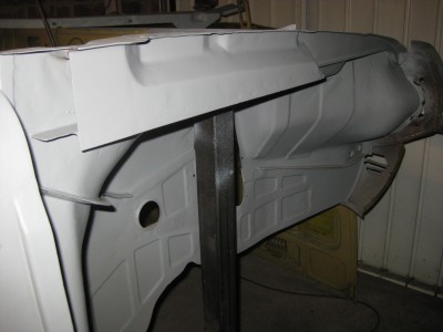

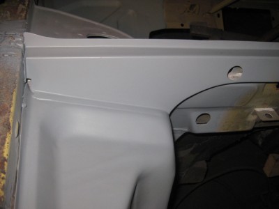

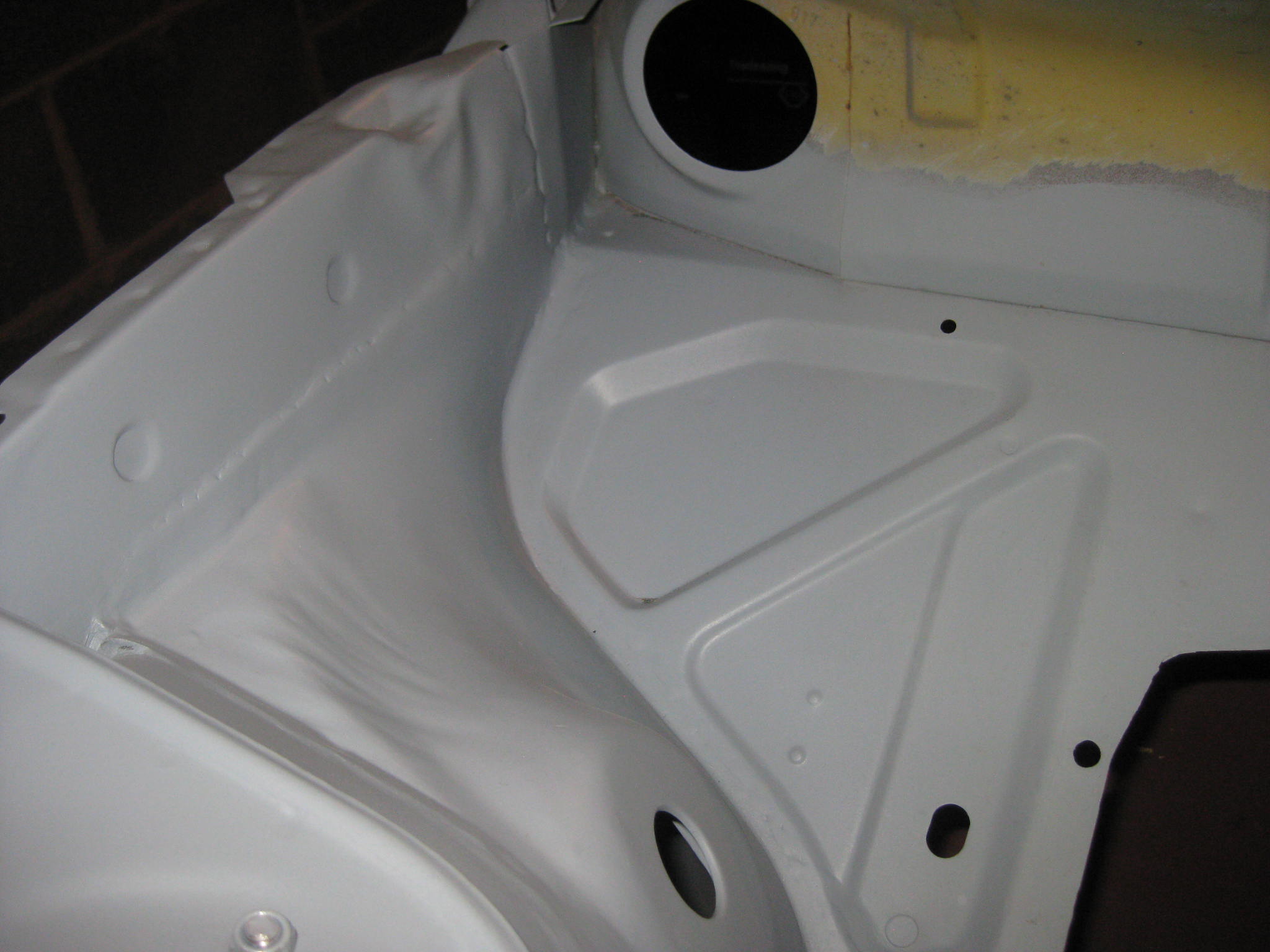

Ok chaps, time for an overdue update or 2......

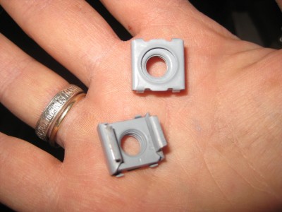

After fitting the inner wing panel there were a few bits to finish off... These captive nuts are stainless and came off ebay, if anyone wants to know I can upload the item number..

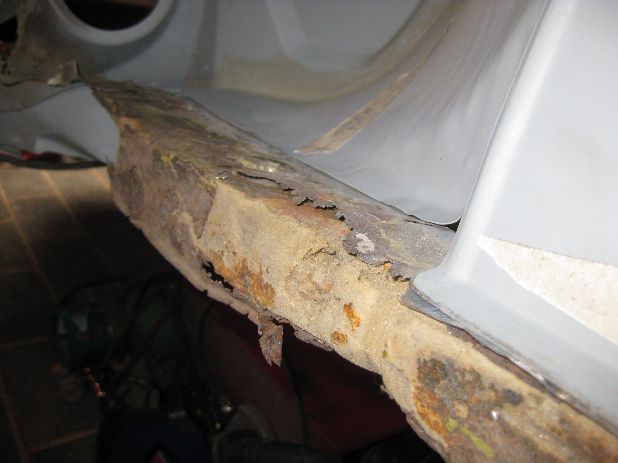

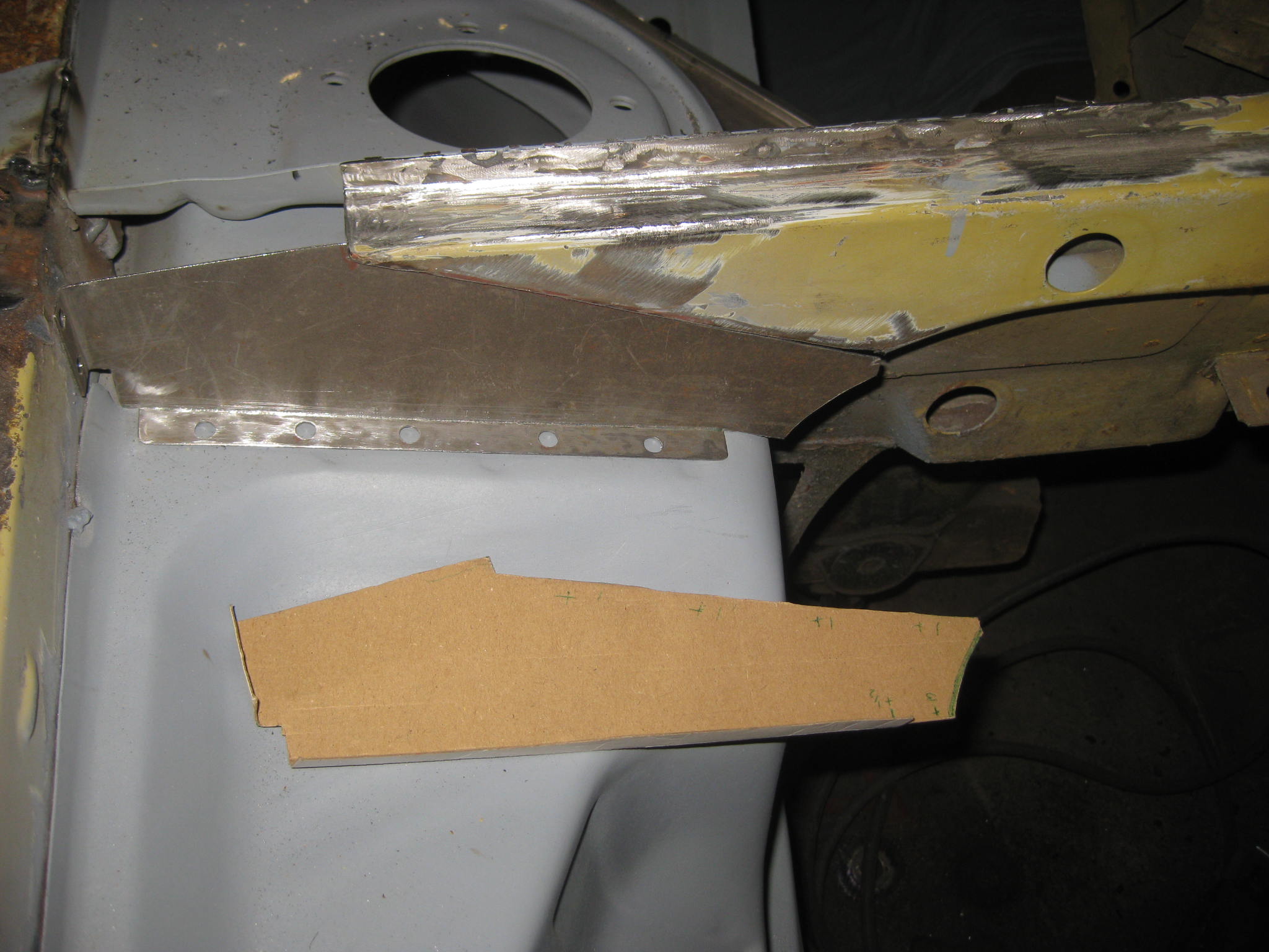

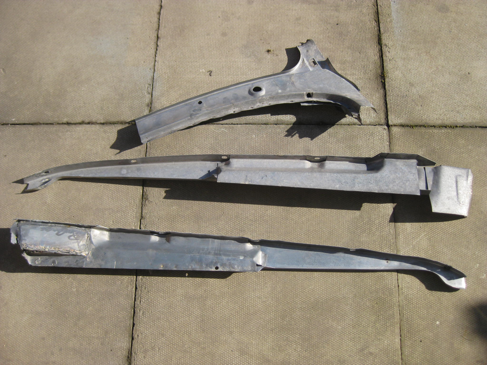

The next job was the wing mounting rail, John at just suds came up with one for me, it was a new panel that had been fitted to a project that never got finished, thanks John
I took that rail along with the other rail I already had that was new but had rust in the seems through bad storage and 1/2 the scuttle panel down to the strippers.... After some metalwork both were given a coat of etch primer.....
vecchioalfa
- Posts: 433

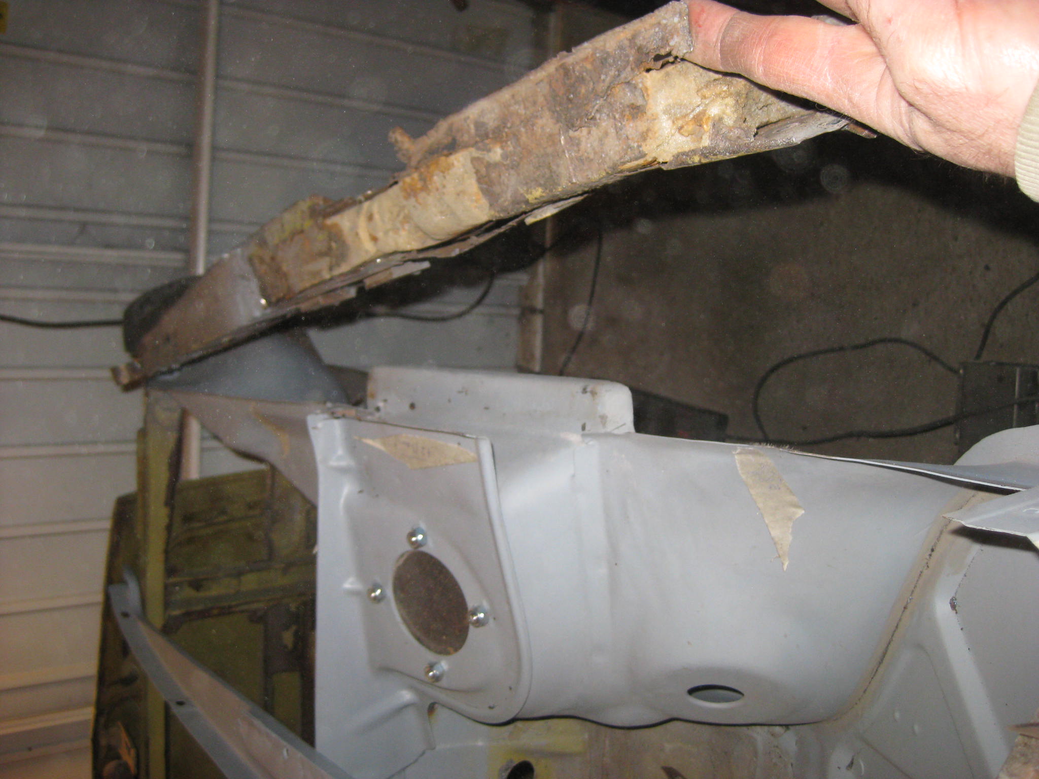

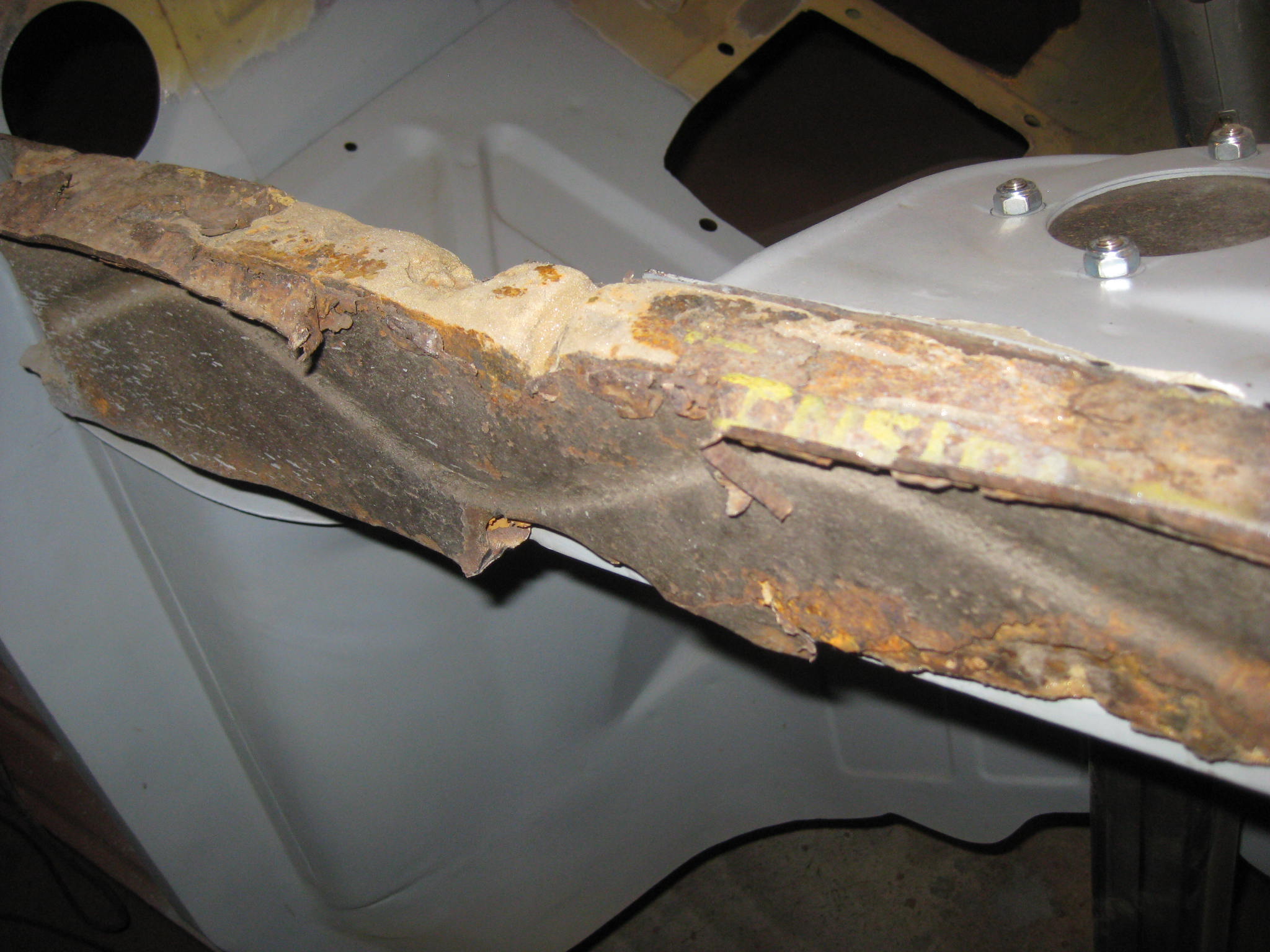

Now to remove that rotten foam filled old rail.....

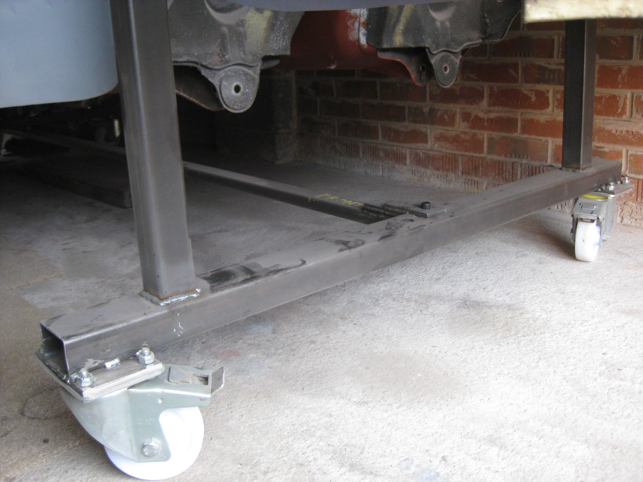

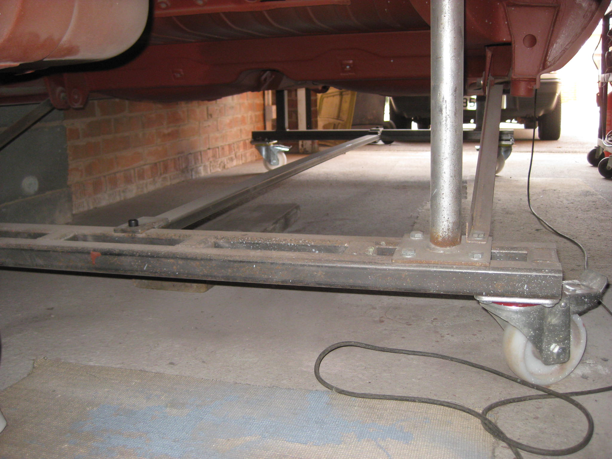

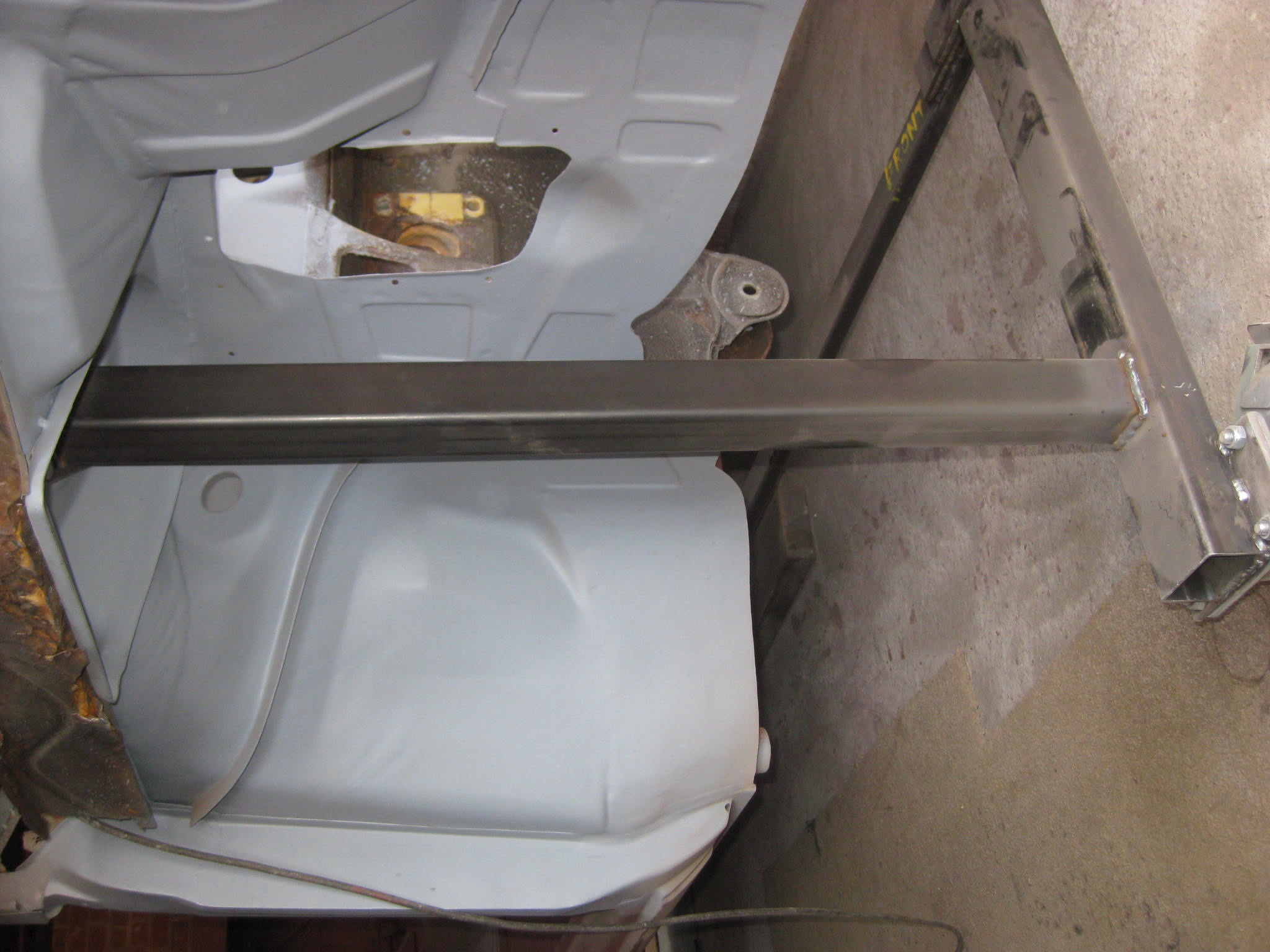

With a house move approaching I needed to get the shell mobile, those of you who have followed this rebuild from its beginning 4 1/2 years ago will remember I had already made up a frame for the rear of the car so I needed to do the same at the front and join them together.
The hardest part was getting the uprights vertical to the top plates that fit to the strut top points
I now have the front and rear sections bolted together so the shell is ready to move when needed
[/quote]
Could I have the eBay item number please as I need some for my sud and great work on your sud as usual I'm sure it's going to look amazing when it's finished
vecchioalfa
- Posts: 433
Hi,
No problem, here is the link to the item off ebay Germany:
http://www.ebay.co.uk/itm/10-Stuck-Kafi ... 53eece1f53
These are spot-on on size and stainless so no further problems getting the front bumper off
The seller also has a listing in English although this one in german is a bit cheaper,
Cheers,
Adi

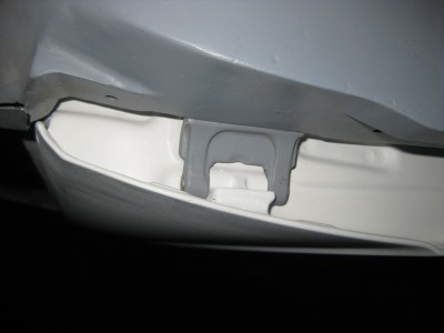

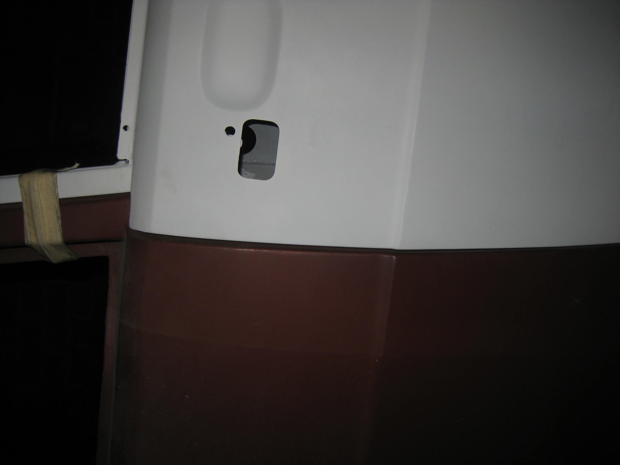

Wing mounting rail is now on, all welds neatly ground back and 1st passing of seam sealer added
Another big job done....

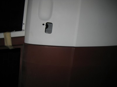

Next up..... O/S Door.....

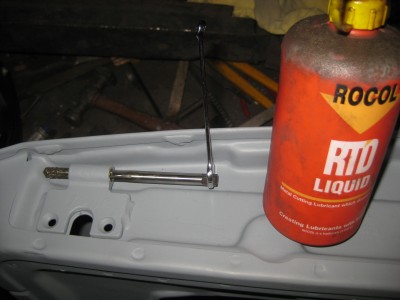

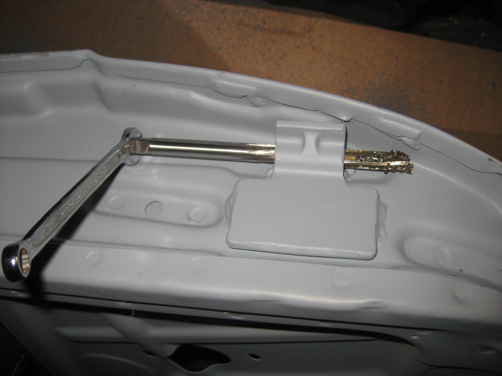

Getting a good door gap is impossible unless the hinge pins are in tip top order as we know, mine were badly worn and as they are welded on it presents a bit of a problem. these are originally 8mm tension pins top & bottom. I decided to do something better. There is not too much thickness on the hinge bodies and removing metal in situ is not easy as you can imagine. I decided to open the holes out to 8,20mm and make up some solid hinge pins from the shanks of some 8,20mm long series drills I ground the shank of the flutted section of the drill wit the dremmel with a cutting disc on it
A small was added to the pins and a grub screw fitted though the outer section of the hinges I also added a small hole (about 2mm diameter) to the inner section of the hinges so some oil can be added when needed
vecchioalfa
- Posts: 433
A sigh of relief now the door is on, the whole A post was rebuilt from scratch if you can all remember....
Door gaps are very good
No shims at all at the top and only a 1mm shm added to the bottom to get the gaps right
Well happy
Well happy

The 8,2mm Long series drills are available here should anyone want any:
http://www.ebay.co.uk/itm/Twist-drill-d ... 3ce8317870
Obviously one drill will make one pin so you will need 4 drills.....
The reamer you will need is an 8,20mm HAND Reamer, these have a tapered lead on them and will pick up in the existing holes, care is needed along with some cutting fluid when reaming them out. As some of the wear takes place on the original pins and some in the hinges 0,20mm was enough to remore all the wear from mine although you could go slightly bigger provided you can get hold of the right size hand reamer but not too much or the hinge will be weakened.
