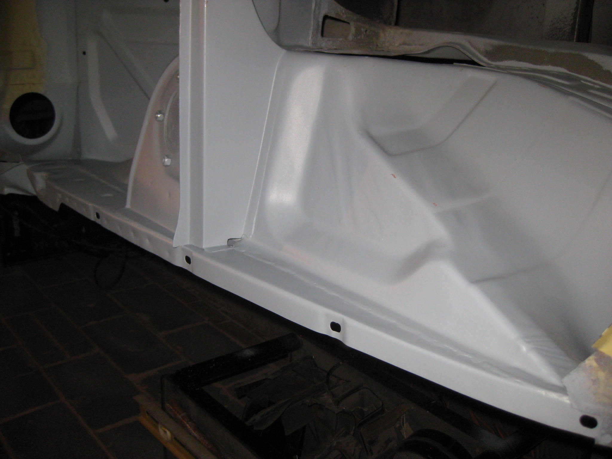

Ok chaps, time for an overdue update or 2......

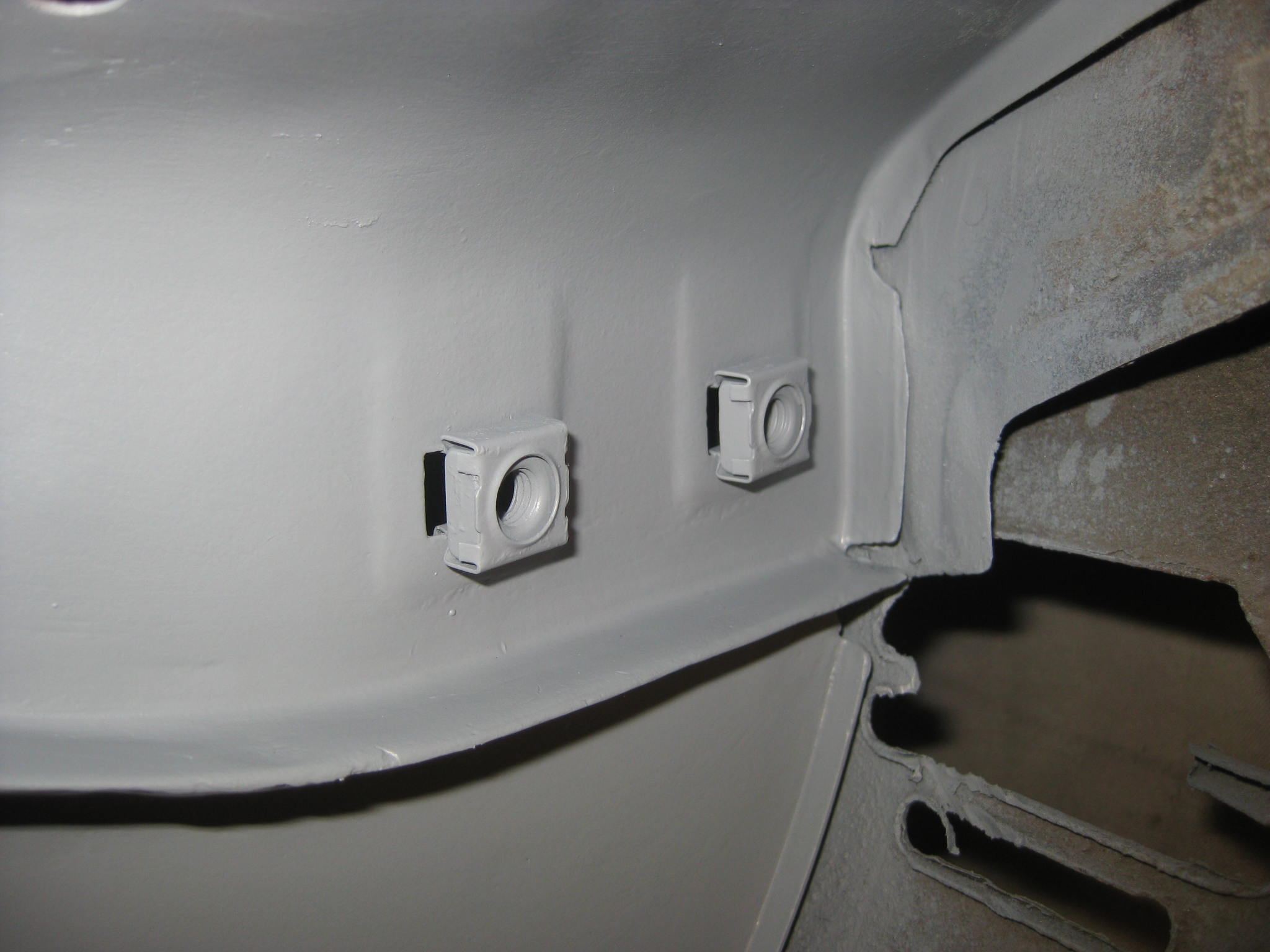

After fitting the inner wing panel there were a few bits to finish off...

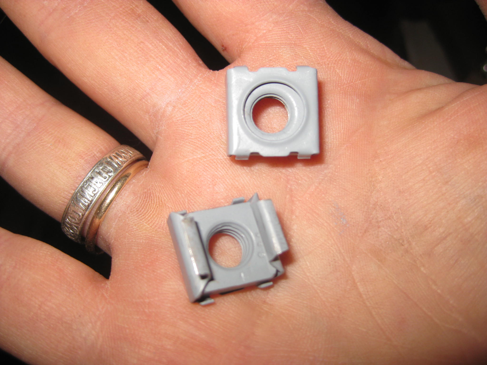

These captive nuts are stainless and came off ebay, if anyone wants to know I can upload the item number..

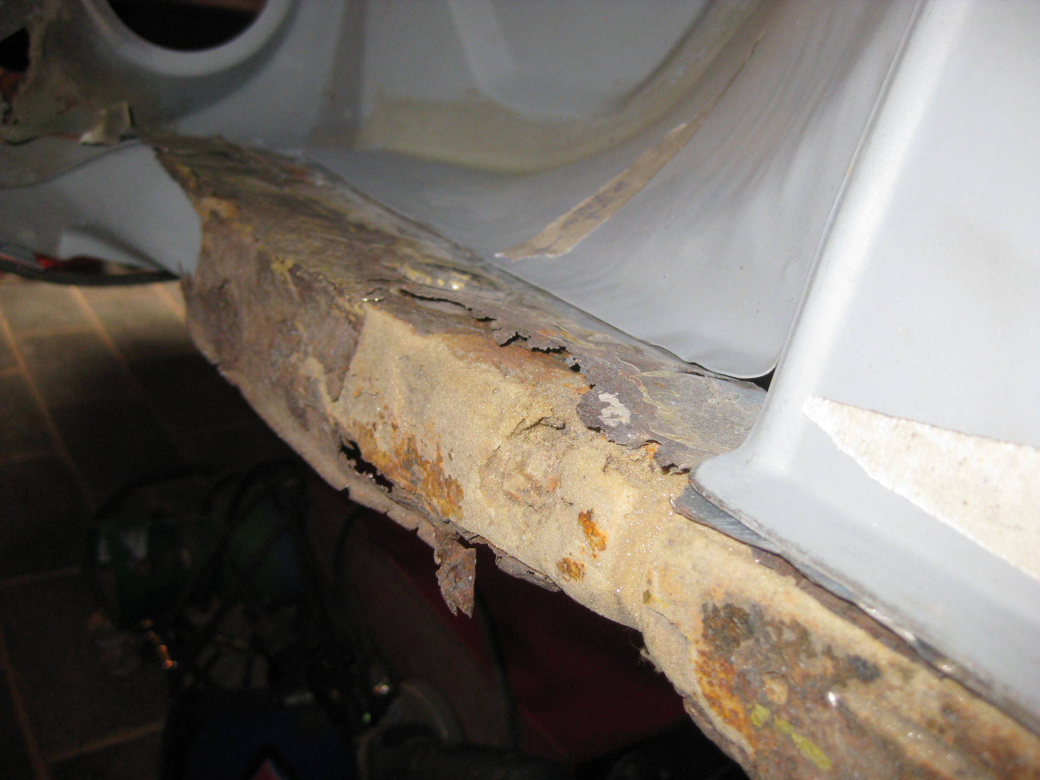

The next job was the wing mounting rail, John at just suds came up with one for me, it was a new panel that had been fitted to a project that never got finished, thanks John ;)
I took that rail along with the other rail I already had that was new but had rust in the seems through bad storage and 1/2 the scuttle panel down to the strippers....
After some metalwork both were given a coat of etch primer.....

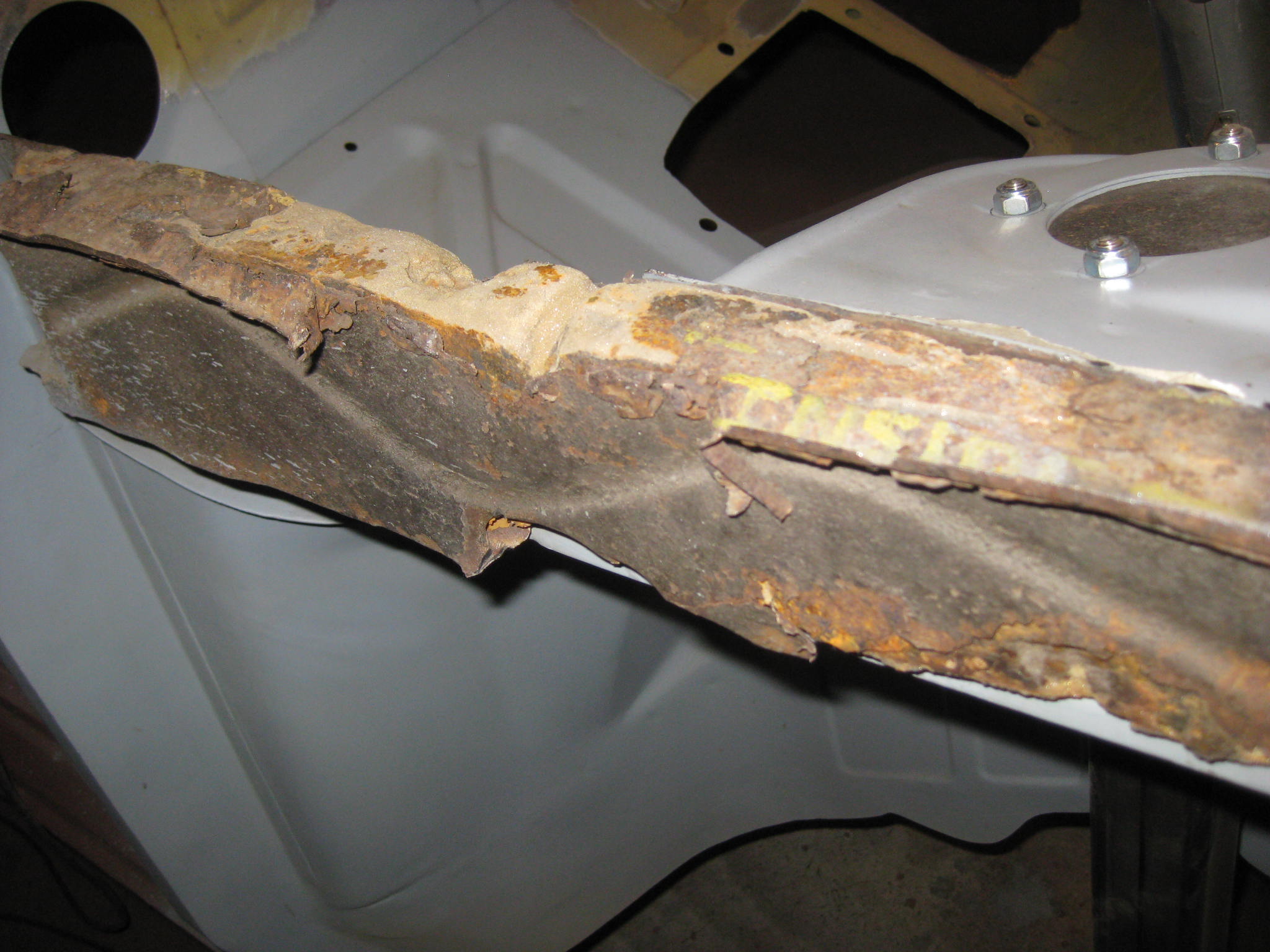

Now to remove that rotten foam filled old rail.....
[/quote]
Could I have the eBay item number please as I need some for my sud and great work on your sud as usual I'm sure it's going to look amazing when it's finished :).

No problem, here is the link to the item off ebay Germany:
http://www.ebay.co.uk/itm/10-Stuck-Kafi ... 53eece1f53
These are spot-on on size and stainless so no further problems getting the front bumper off :)

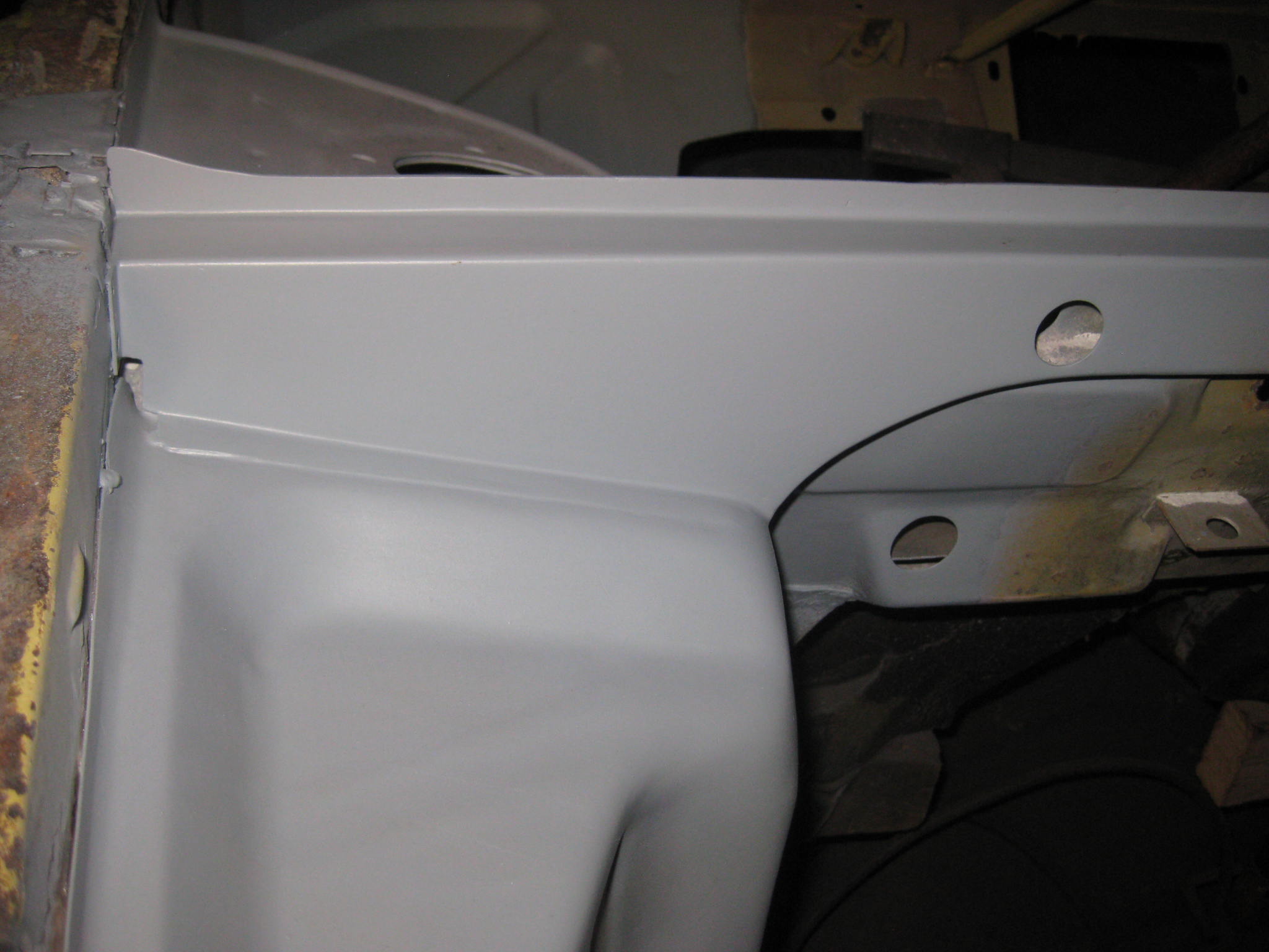

Wing mounting rail is now on, all welds neatly ground back and 1st passing of seam sealer added
Another big job done....
