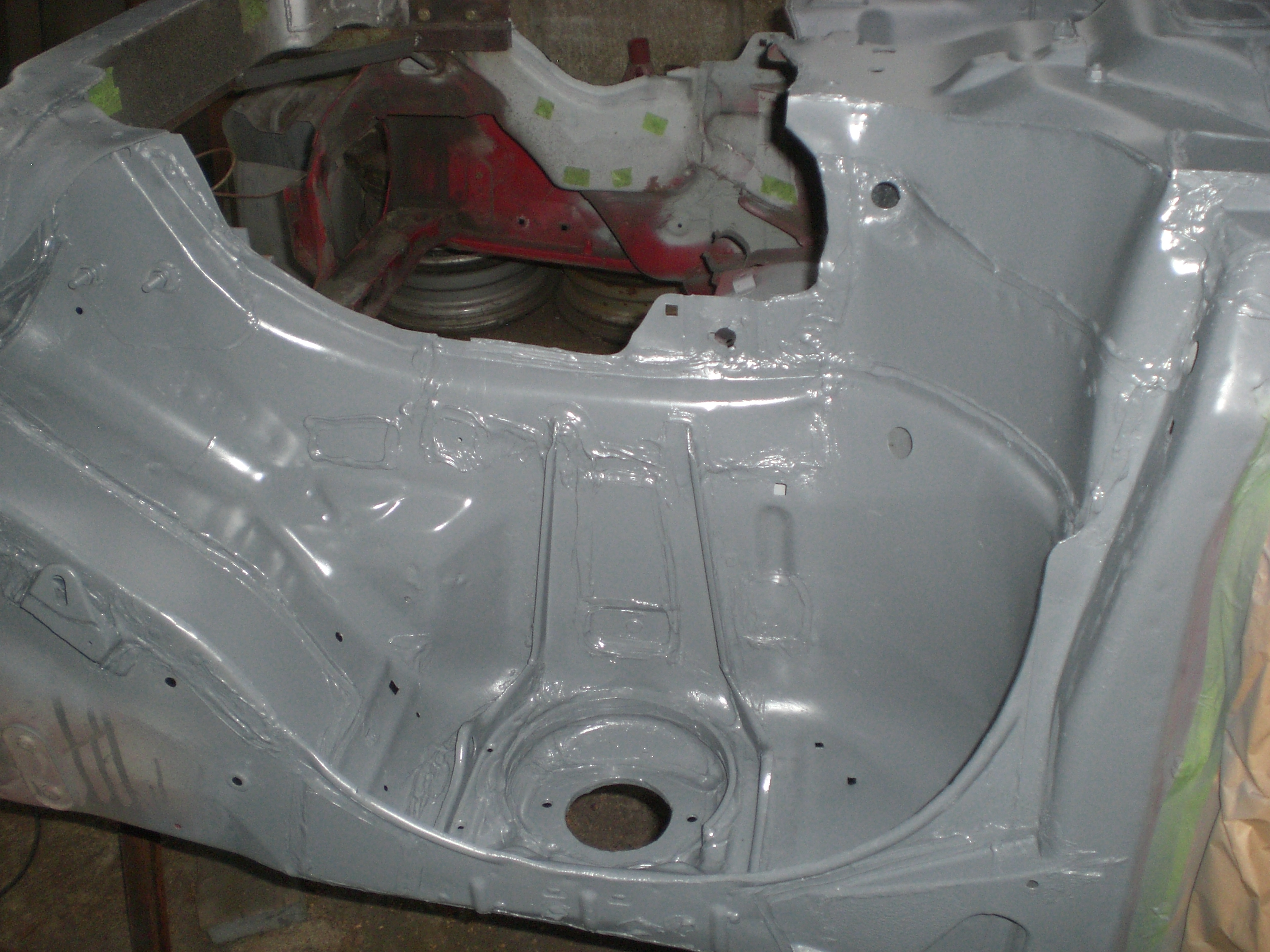

Been a couple of months now since I posted, for a few reasons, but back on track now just about...
This last week or so Jims' been on his holidays so I've had rule of the roost so to speak. Truth be told Jim lets me come and go as I please but I do sometimes feel like I'm in the way despite him saying to the contrary, so thought I'd take the opportunity to put in some late nights and break the habit of not working Sundays....this is me taking things easy :roll:
The rear arches got seam sealed inner and out, maybe not the neatest but functional and it's my car which I will use as it's intended so important that's it's sealed well.
The front strut towers I've reinforced where the joins are, in the hope it will be OK.
This last Saturday afternoon I set about scrapping the thick black underseal off with a paint scraper and heat gun, not the nicest of jobs. The knotted wheel would do the job but that black stuff is nasty being flung around, makes a right mess.
The rubberised original stuff though does come off nicely with the knotted wheel on the 4" grinder. Painfully slow but comes off powdery and not in big clouds of dust.
Eventually though it was all off, which of course revealed a few more areas that needed welding...
Rear inner corners of the chassis rails got chopped out and made with 3mm stuff, a few captive bolts in the floor had bad rust around them so I chopped them out and made new plates. The bottom of the spare wheel well, all the usual little jobs that get ignored but take time...
I did unearth this little surprise too, a few cracks in the floorpan near the middle of the car
On looking inside the car they are near the drivers seat mount!
Thankful I spotted them at this point as very easy to weld the cracks and plate them over, much more so than if they'd appeared once it's back together.
With everything welded the outer seam sealer went on, inner rear arches are now mostly sealer :D
Monday after work I went down and etch primed it all, the front arches and strut areas I've still a little work to do then they'll be etched before it all gets a good soaking with stoneguard ;)
Must admit it feels good to hold a spray gun again 8-)
This afternoon the plan was a simple one, clean up the front inner arches and strut towers then seal and prime them.
Of course life is never that simple..
For some reason I'd missed a rusty section right in the middle of the drivers strut tower reinforce where it sits to the chassis rail. A big of digging and a 3" x 4" hole needed filling in! Luckily some 3mm sheet was to hand so a strong plate got welded in to finally finish of the structural welding....he says with crossed fingers!
Time at last to seam seal all the repairs..
Then etch prime...
Before getting the whole underside coated in stoneguard, at long last!
It'll be a week now until I get back to it to put some red on...
floor and arches painted now, 2 thick coats of brushable enamel. keeps it watertight and hardwearing.
i'll leave it a week or so to harden off fully, I've other things to be getting on with.
then the plan is to get the car on axle stands to get the 'screen surround done and suspension back on...underside repairs finally complete..
