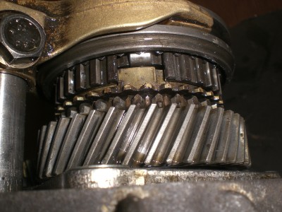

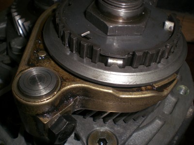

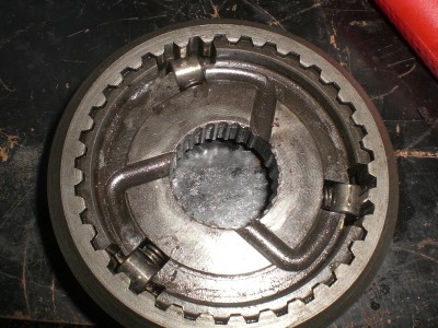

Got the 5th gear fitted tonight along with the rest of the selector mechanism, just about complete again now. Thought I'd just show the tricky to re-assemble little sprung rollers that fit inside the hubs to keep it in or out of gear. They are fiddly to put back in as being rollers that's what they want to do! Springs just ad to the fun.
Attached back to the gearbox and with the retaining plate on to stop them popping out, this is pictured with 5th gear engaged. Normally on a pair like with 1ST & 2ND gears the other gears baulk ring would prevent the rollers from popping out, the 5TH is all by itself so needs the plate. Note too how the gap looks almost enough for the roller to escape!
This last shot is from the same gear but with the gear not engaged. I hope this makes more sense to what happens and how.
At the top of the picture the selector fork is engaged in the sleeve ready to pull said sleeve downwards, remember this sleeve is splined onto the shaft so it spins at shaft speed and the gear at the moment is free spinning.
As it travels down over the synchro hub grooves it pushes the brass coloured baulk ring downwards engaging the grooves and as it is tapered it grips onto the gear itself, the little pointed teeth directly above the helical gear teeth are all part of the same piece.
As the speeds become the same then the synchro hub engages the pointed teeth on the gear completing the path and locking the whole lot together.
Incidentally the sound we here when crunching gears isn't the helical pieces trying to mesh like we assume, they are already in mesh! It's these poor little pointed bits that haven't been able to synchronise speeds before being able to get into line.
Hope that makes sense?

Question : What is the worn bit here ? If you waggle to check neutral, the arm pops out if you push too hard. Is it the arm or the removable piece with the cut out? Obviously, this is a Sud ti gearbox :D
I've not actually ever done a Sud 'box mate to be honest, always left them to Tom after reading about disappearing detent plungers although he always assured me they weren't that troublesome to do!
I can't quite picture what's happening, I'm guessing the lower shaft with the arm pointing upwards is the part attached to the lever which should be moving the above section?
More often than not a worn/broken or stuck in detent ball will allow stuff to move where it shouldn't.
A wider shot may help me make a better guess mate, but I really am no expert on these things! Saying that though taking them apart to find out how they work is the fun part.

Exactly that Tony, the brass coloured part needs time to match the speed of the synchro hub to the gears which being in mesh will be spinning at a different rate, either slower or faster depending on if going up or down the gears.
A little wear on the tapered section means it can't match the speeds before the little castle gears are trying to mesh, which is where you get the crunch from. A little patience, even for half a second, will vastly prolong the life.
Whilst mentioning it all, I bet everyone has had the feeling when changing gear that the lever has only gone half as far as it usually does, or like you get two stages of movement? That is where the baulk ring gets engaged but hasn't fully engaged with the gear itself, letting the clutch out at that point gets the nasty noises!

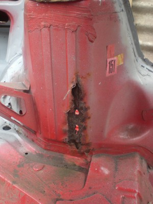

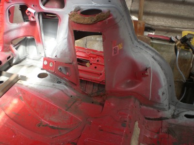

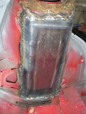

The drivers side rear wheel arch/strut tower area has one last task to attend to where the reinforcing section had some rot in it as can be seen..
Although it didn't look too bad the decision was an easy one in reality, chop it all out!
The lower piece where it overlaps the chassis rail didn't look too bad on the outside but no point in not having a look, glad I did as underneath it was the inevitable corrosion waiting to spread.

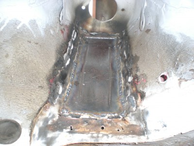

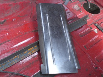

I was going to make one big plate to cover the whole lot but too many variables to deal with so I've made up a piece for the tower to fit on the inside out of 2mm stuff complete with some bead rolled ribs to aid strength, not easy in such thick steel.
This was welded on the inside of the car and overlapping the original thin inner wing for strength, also welded along the bottom edge to the chassis rail top edge.
A bit of a clean up then the usual etch primer to protect it and that'll do until I go back on Wednesday, quite pleased with a few hours on a Sunday to keep things ticking along.

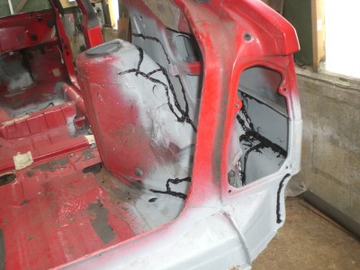

The rear arches got seam sealed inner and out, maybe not the neatest but functional and it's my car which I will use as it's intended so important that's it's sealed well.
The front strut towers I've reinforced where the joins are, in the hope it will be OK.
This last Saturday afternoon I set about scrapping the thick black underseal off with a paint scraper and heat gun, not the nicest of jobs. The knotted wheel would do the job but that black stuff is nasty being flung around, makes a right mess.
The rubberised original stuff though does come off nicely with the knotted wheel on the 4" grinder. Painfully slow but comes off powdery and not in big clouds of dust.
Eventually though it was all off, which of course revealed a few more areas that needed welding...
Rear inner corners of the chassis rails got chopped out and made with 3mm stuff, a few captive bolts in the floor had bad rust around them so I chopped them out and made new plates. The bottom of the spare wheel well, all the usual little jobs that get ignored but take time...

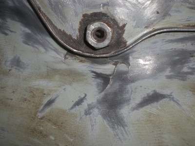

I did unearth this little surprise too, a few cracks in the floorpan near the middle of the car
On looking inside the car they are near the drivers seat mount!
Thankful I spotted them at this point as very easy to weld the cracks and plate them over, much more so than if they'd appeared once it's back together.
With everything welded the outer seam sealer went on, inner rear arches are now mostly sealer :D

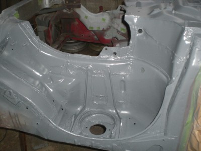

This afternoon the plan was a simple one, clean up the front inner arches and strut towers then seal and prime them.
Of course life is never that simple..

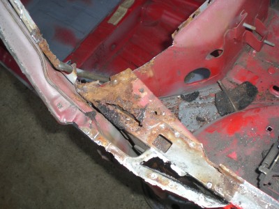

For some reason I'd missed a rusty section right in the middle of the drivers strut tower reinforce where it sits to the chassis rail. A big of digging and a 3" x 4" hole needed filling in! Luckily some 3mm sheet was to hand so a strong plate got welded in to finally finish of the structural welding....he says with crossed fingers!

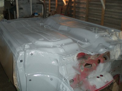

Time at last to seam seal all the repairs..
Then etch prime...
Before getting the whole underside coated in stoneguard, at long last!

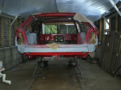

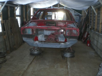

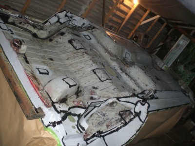

With the underside all but finished and all the (lots & lots of) studs cleaned of paint etc it was time at last to get the shell off the tilter.
Sounds easy but is a tricky process as it sits quite high to enable it to be rotated, which means it's higher than a normal trolley jack will go to.
Handily enough Jim has a couple of high lift jacks so a bit of teeter totter and it's back on axle stands.
The repairs that I ddi to the boot floor could be cleaned up and sealed now that the frame is out of the way.
Doesn't seem like a big deal but it's one more step towards getting the shell prepped...

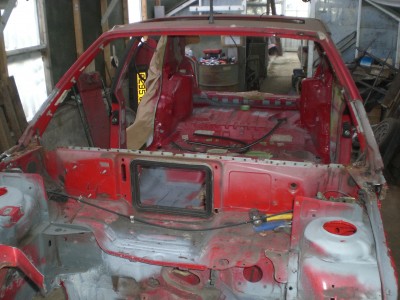

Just the 'screen surround to change and a scetion of the roof along the back edge to do...
With the week off work and other cars on the fleet needing more urgent attention the poor old integrale has been sat patiently wondering if it'd be getting a look in

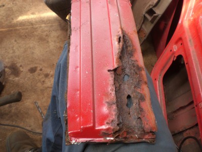

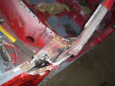

The last big task to do was the windscreen surround/scuttle top needing replacing.
I'd already bought a very good used one a few years back, from a RHD HF turbo that was being chopped up.
Bonus with changing the whole thing is that I'll get the wipers facing the right way too

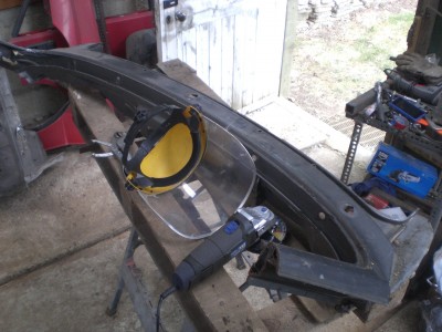

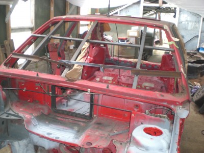

First job was to make a frame for a few reference points. Not everyone bothers but I'd like to have half a chance of it going back in the right place and things like the 'screen fitting!
Not ready for a banger race.....
After a bit of careful measuring the cut line was marked out up the pillars and a plan of action of where to remove the sections from the car and what to leave, making sure there is plenty of staggered joins to keep the strength. I've seen people just cut the pillar through the whole section and weld in one straight joint, not ideal!
Passenger side is in very good condition, hardly anything to repair...
Drivers side needs a bit of work but nothing much compared to what's been done so far!
Glad I decided to change it all though rather than repair the upper rusted sections and corners, the underside of the internal part was terrible.
