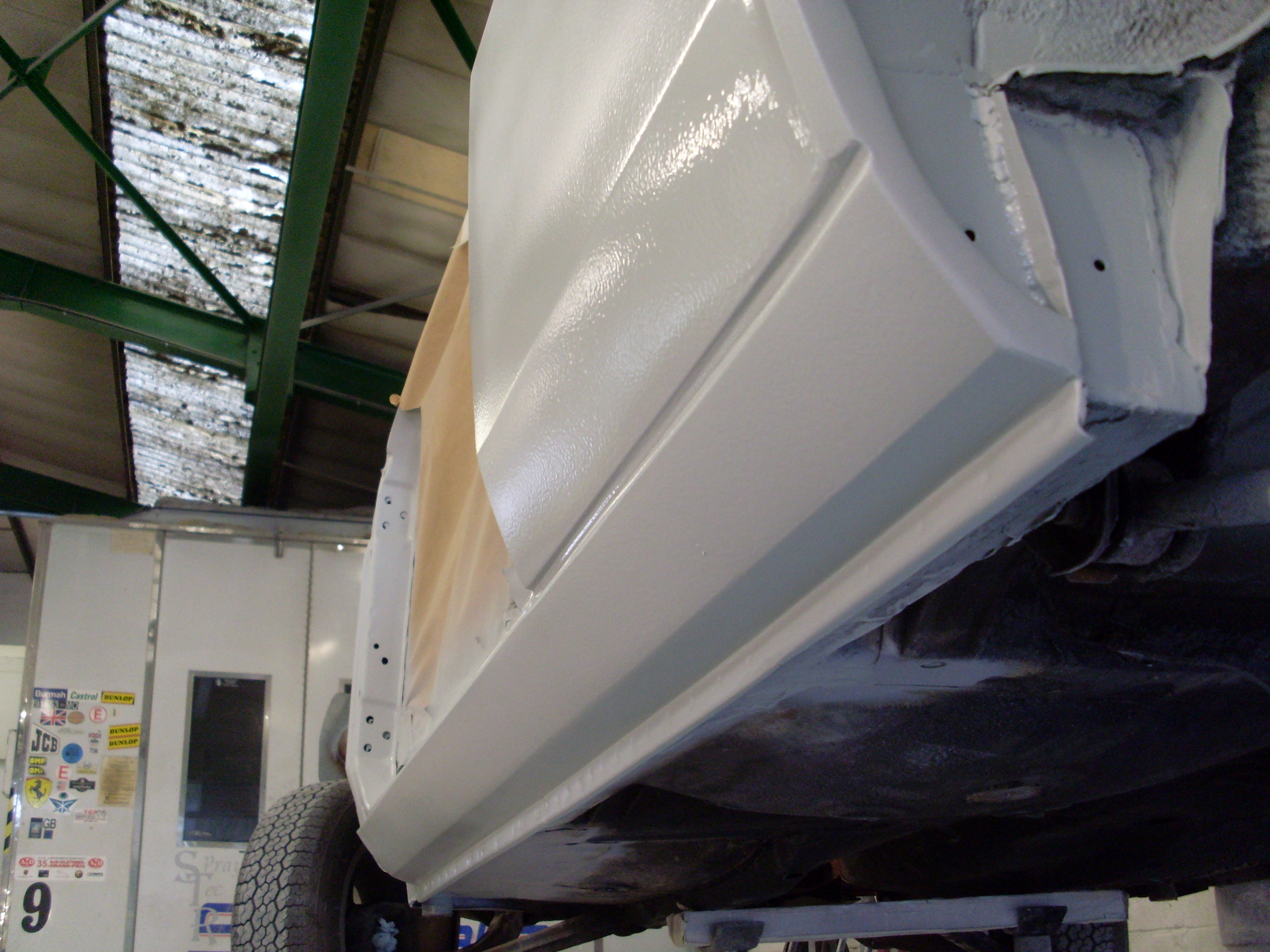

I like to masking tape the borders of the seam, gun the bead on, then brush it in for thorough sealing and final shaping. Give it a few minutes to cure ever so slightly then de-mask to reveal lovely sharp edges to it.
Looks very nice and professional this way, and to repeat Keith its quite paintable too
As for Keiths method, you can see just how bloody awful his technique turns out!
Nice tip from keith, never had to do that but sounds a good option for long runs that might start stiffening, fab!

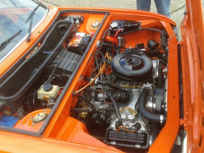

I don't know how you dare show it Keith,
shameful!
shameful!
Re: Seam sealer
better than the factory did it
Re: Seam sealer
That engine bay is like the rest of the car Keith - amazing!

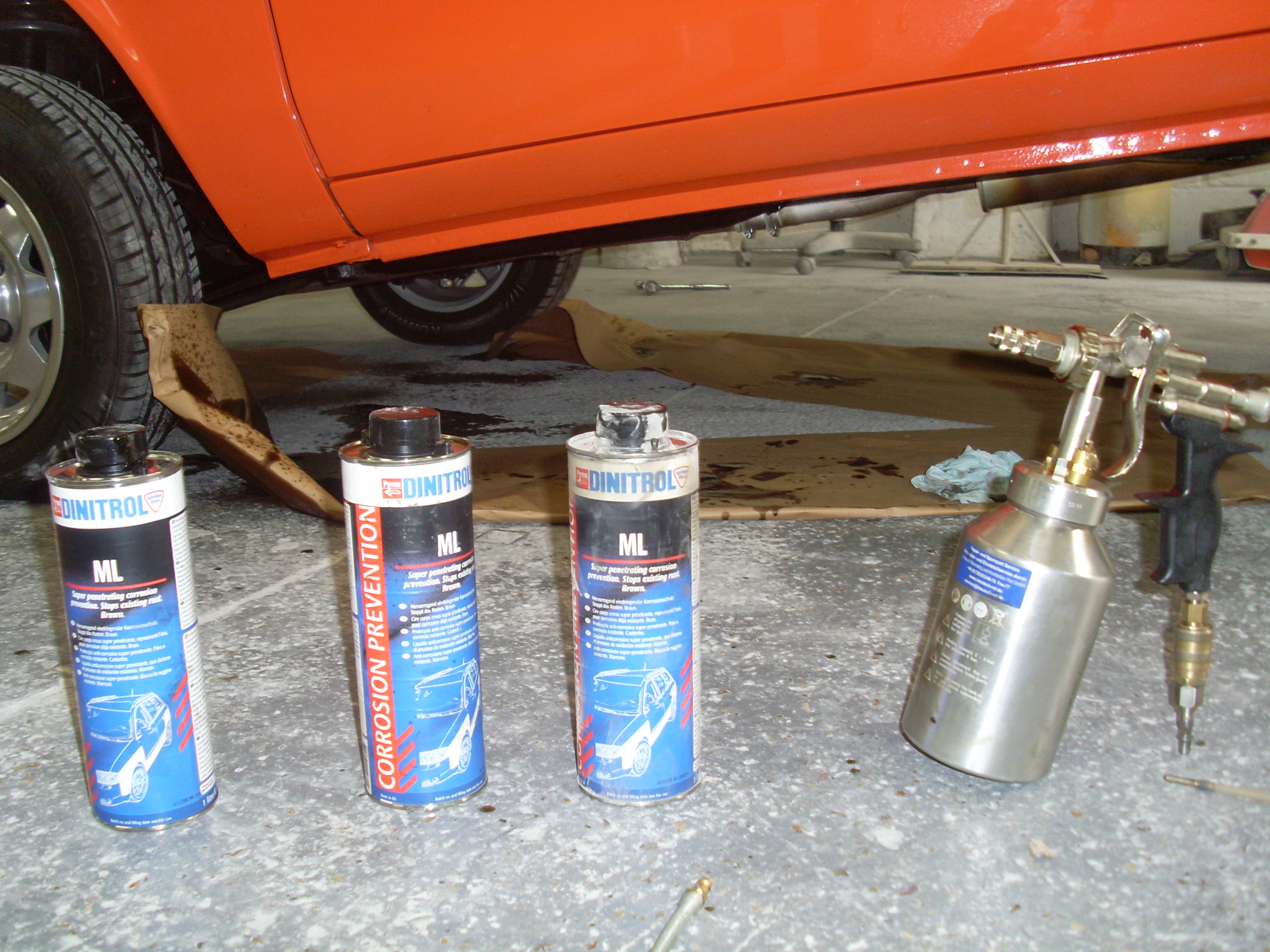

Hi Lou,
I used Dinitrol as I find Waxoyl is too thick and hard to get right inside box sections no matter how hot you get it.
If you have a pressure fed under seal / stone chip gun with an attachment wand (a length of washer tube will do on a shutz gun) you can get Dinitrol to spray through it as it has the consistency of old diesel engine oil
If you block off the end of the tube with ,say a bolt, and cross drill a few holes in the pipe, it will make it spray out sideways. In the sill section I just slowly pulled it out as I kept spraying. I also drilled two holes either side of the inner sill flange in the wheel arches so I could get at both side of the inner strengthener (rotted out so had to replace it). Then just fit a rubber grommet/bung. Remember to mask over the big holes inside the car. It will mist everywhere so like you say, after paint work, but if possible before the fit up. It rains out of the gaps but then sets like waxoyl. Easy to then wipe off but you will see that it travels a lot further into the cavities.
