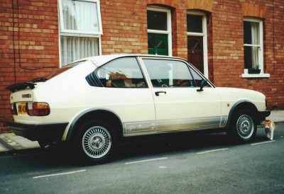

That bare metal rear quarter photo shows what a beautiful design the sprint is, doesn't look dated even today in bare flesh.

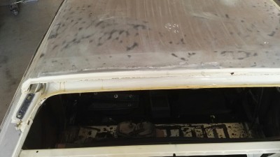

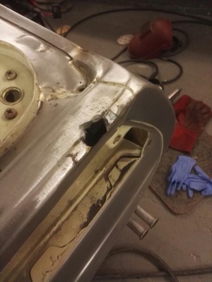

The bodywork restoration moves on apace.
As we saw earlier, there were some pretty hideous previous 'repairs' to the rear section of the roof discovered when the car was taken down to bare metal.
At first, it was decided that a full-width contoured steel panel could be fabricated by hand to satisfactorily repair the carnage but then it was discoved that it'd be easier and somewhat cheaper to let in a section from a similar scrapped car. So that's exactly what we've done. A rust-free roof rear section has been sourced from Peter at Alfasud Parts Online and this will be used to produce a hopefully invisible repair.
The rear panel had also suffered from a lot of corrosion over the years and again at first it was hoped that some hand-crafted repair panels could be made up.
Similarly, it was decided that the holes and other corrosion to the tailgate slam panel could be repaired cheaper and easier by salvaging repair sections from a used but rust-free complete rear panel. So, we're well on the way to achieving a rot-free fully sorted bodyshell repaired using as little or no filler as possible, which is what I want in order to be able to enjoy my Sprint for years to come without having to worry about rampant rust!
Three litres of Dinitrol have been ordered to keep it that way too!

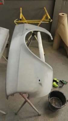

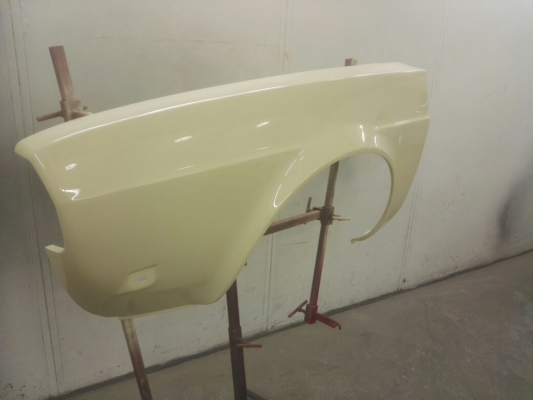

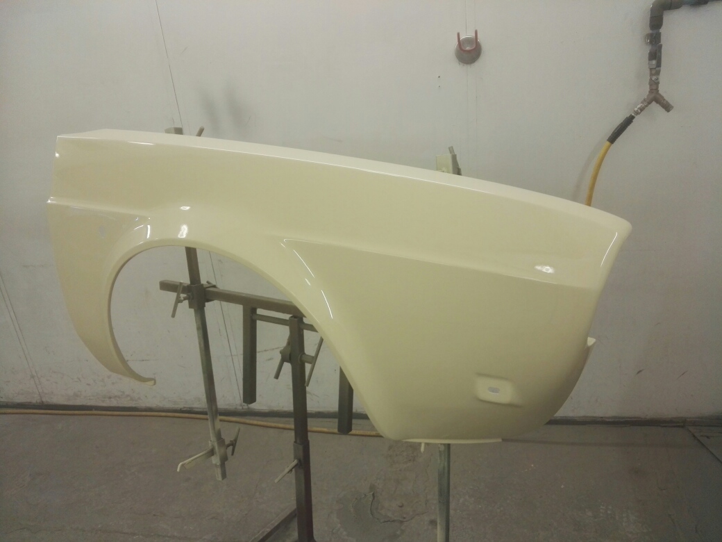

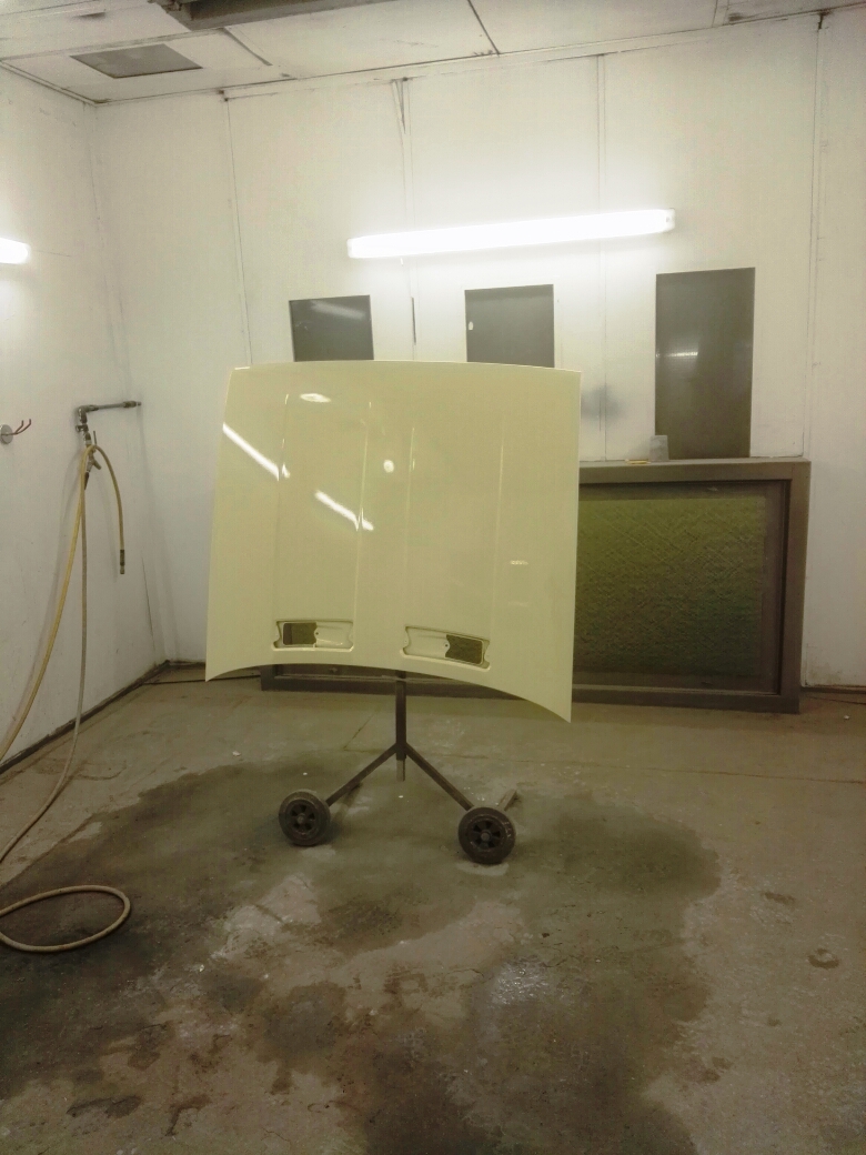

Progress continues.
Having had the new replacement front wings taken down to bare metal a while since, it was established that they were in sound rust-free condition. They were subsequently primed to keep them in good condition while work continued on other areas of the bodywork.
The bonnet in particular needed lots of attention as taking it back to bare metal had exposed a lot of damage and minor dents caused by stone chips. With all of this remedied, the bonnet was primed. It's since had its final prep and rub down and has now been painted!
With this done, the front wings have been rubbed down again and had their final prep before the top coat is applied.
They're now ready to receive top coat. Excellent work by the bodyshop!
We're getting closer......

So, joining the finished bonnet, today we have both front wings and Alfie's front panel and valance in top coat!
Work has now begun on the o/s front door and all the rusty metal has been cut out ready to receive the NOS repair panel:
I'm smiling!
I'm smiling!

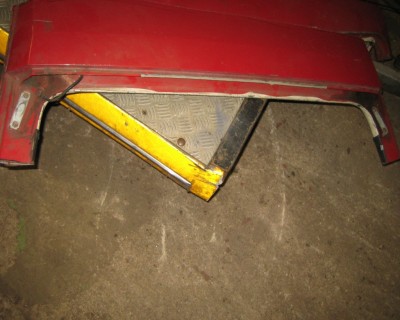

Will there be anything left of that rear panel after they have cut out the sections needed ?
If it's still usable but with the odd hole I'd be interested as a just in case spare for my racer, especially after a nob punted me off last year.

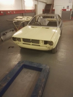

I had a little bit of a dilema Keith after Alfie was taken back to bare metal. The Speciale was available in red, black, silver, metallic green or ivory. I could have picked any one of these colours for the respray and would still have been keeping originality but in the end, I kept it Ivory. Like yourself, I like it and it reminds me too of a previous Sud I had in the same colour and from the same period many moons ago.Kegsti66 wrote:Cooking on gas now Colin.

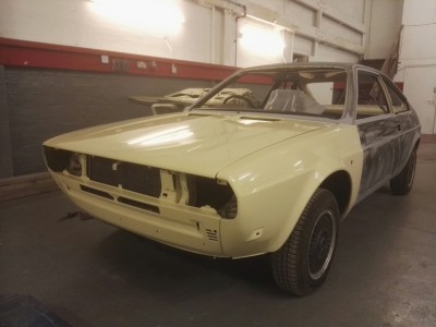

Good to keep it the original colour I think also from a history perspective. I always liked the early sud and sprint metallic green, but the speciale green was lighter/paler ?
Ivory suits it well with the stripe contrast.

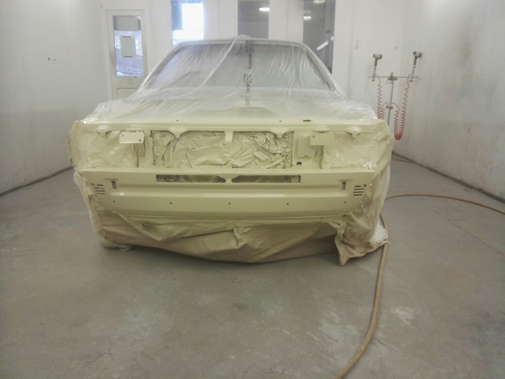

The paint finish looks great Colin
I had an Ivory 95bhp Ti

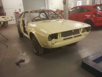

Re: It begins...
Quudos to the sprayer .Great work

Progressing very nicely Colin.
Avorio (AVOO), available from 1980 model year, is a very elegant colour for a Sprint. Great that you're keeping the original period colour.
Will you be fitting reproductions of the black decals along the belt line, and if so how have you gone about getting copies made up
I am about to get reproduction stickers made for my Super resto, so very interested in other forum members experiences and tips on this topic at the moment

I've got the very last original set in existance so I hope that I don't end up having to have a set made up!Alfasam wrote:Progressing very nicely Colin.
