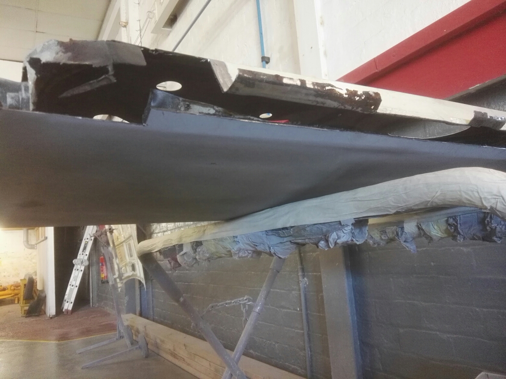

The bodywork restoration moves on apace.

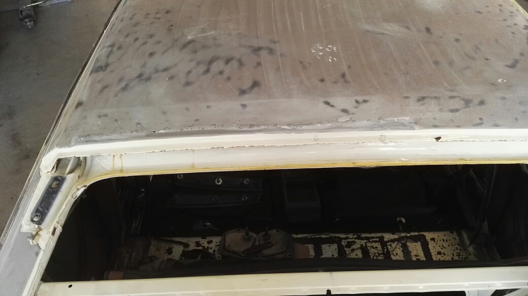

As we saw earlier, there were some pretty hideous previous 'repairs' to the rear section of the roof discovered when the car was taken down to bare metal.
Look what removing paint and 2" deep layer of filler exposed! Eek!
At first, it was decided that a full-width contoured steel panel could be fabricated by hand to satisfactorily repair the carnage but then it was discoved that it'd be easier and somewhat cheaper to let in a section from a similar scrapped car. So that's exactly what we've done. A rust-free roof rear section has been sourced from Peter at Alfasud Parts Online and this will be used to produce a hopefully invisible repair.
Perfect rust-free roof rear section to be let in.

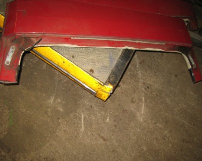

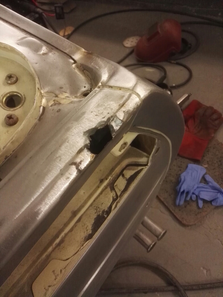

The rear panel had also suffered from a lot of corrosion over the years and again at first it was hoped that some hand-crafted repair panels could be made up.
Corrosion to the tailgate slam panel and rear lip is actually worse than it looks.
Similarly, it was decided that the holes and other corrosion to the tailgate slam panel could be repaired cheaper and easier by salvaging repair sections from a used but rust-free complete rear panel.
The used but rust-free rear panel complete will be used to carry out the necessary repairs
So, we're well on the way to achieving a rot-free fully sorted bodyshell repaired using as little or no filler as possible, which is what I want in order to be able to enjoy my Sprint for years to come without having to worry about rampant rust!

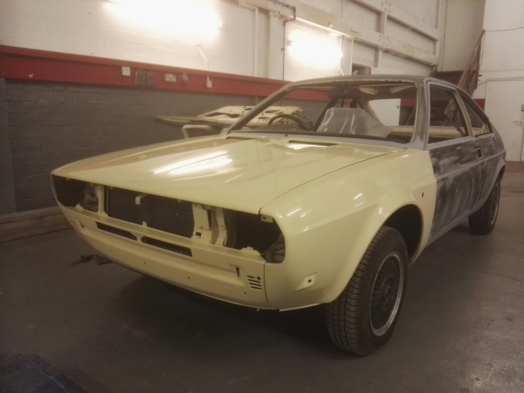

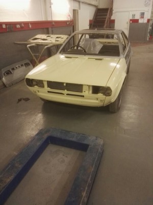

Progress continues.
Having had the new replacement front wings taken down to bare metal a while since, it was established that they were in sound rust-free condition. They were subsequently primed to keep them in good condition while work continued on other areas of the bodywork.
The bonnet in particular needed lots of attention as taking it back to bare metal had exposed a lot of damage and minor dents caused by stone chips. With all of this remedied, the bonnet was primed. It's since had its final prep and rub down and has now been painted! :D
Bonnet is now finished in Ionian Ivory top coat!

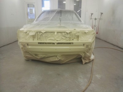

With this done, the front wings have been rubbed down again and had their final prep before the top coat is applied.
Both front wings during final prep
They're now ready to receive top coat. Excellent work by the bodyshop!
Ready for top coat next
We're getting closer......

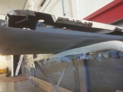

Work has now begun on the o/s front door and all the rusty metal has been cut out ready to receive the NOS repair panel:
Rusty metal cut out ready for the repair panel to be let in
