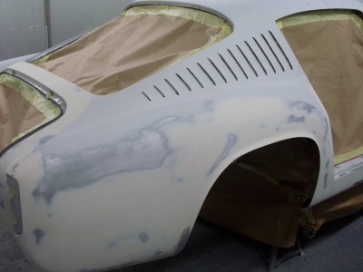

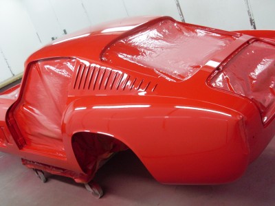

Believe it or not, that video clip was when it came back on the market.
I then did this to it :o :shock:
Sorry, enough of my trumpet blowing, it is just nice to share with friends who appreciate what you do.
I do enjoy this forum. :D

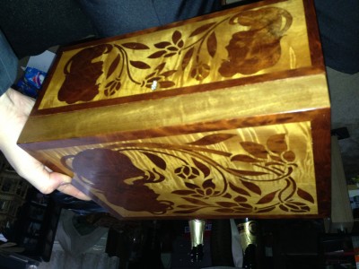

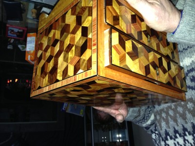

Yep totally agree . I come from an antiques background. I used to French polish before I could spray. And skills my dad's got with marquetry, in lying the veneer and other talents .Will be gone with him . No one does or understands it .These days :(
Oh my god there must be hours and hours of work not to mention patience in there. Total respect to your Dad.

Thanks for the kind comments guys, Shrew is right though, I am cheap :lol: :lol:

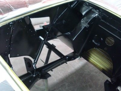

From start to finish i probably spent 450 - 500 hours on that car. All underneath is also painted. It has a work of art chassis (well I think it is) After all, it is Italian :D

Yeah a few hours ;) when I was younger ,I hated furniture. But I do respect it . Plus some of the pieces we worked on .Where stunning .
Wow the car is a work of art . Stunning 8-)
Everyone loves a classic Alfa :D
Very impressed with your Dad's marquetry. long and patient hours have gone into those pieces.
I enjoy seeing almost anything that shows someone's talent.
Thanks man
Back in the day ,we used to make card table, tea table pairs. Sold them across Europe and one pair sold in Sotheby's New York. I'll have to get a photo of them as they made it into there book that year :D love joy had nothing on us :lol:

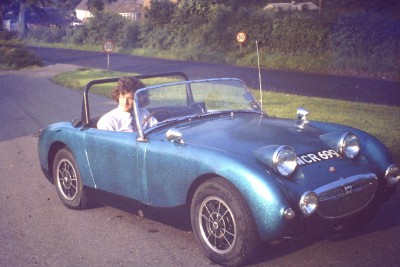

Thanks Shrew - My first spray job and I got the Flake - "Magna Metallic Jewels" from JA Pierce in London. It was a mix of red and blue flakes in clear Acryllic. Two coats of flake then three clear coats, gently flatten, two clear coats, gently flatten repeat four more times until the flakes were completely covered- the paint was about 1/8" thick! The fumes were horrendous in my parent's garage.....Three years later I did it again, having gone back to bare metal, with the Blue/Green flake job as shown.
Spraying flake is a lot of work . I bet it did look cool in the sun 8-)
