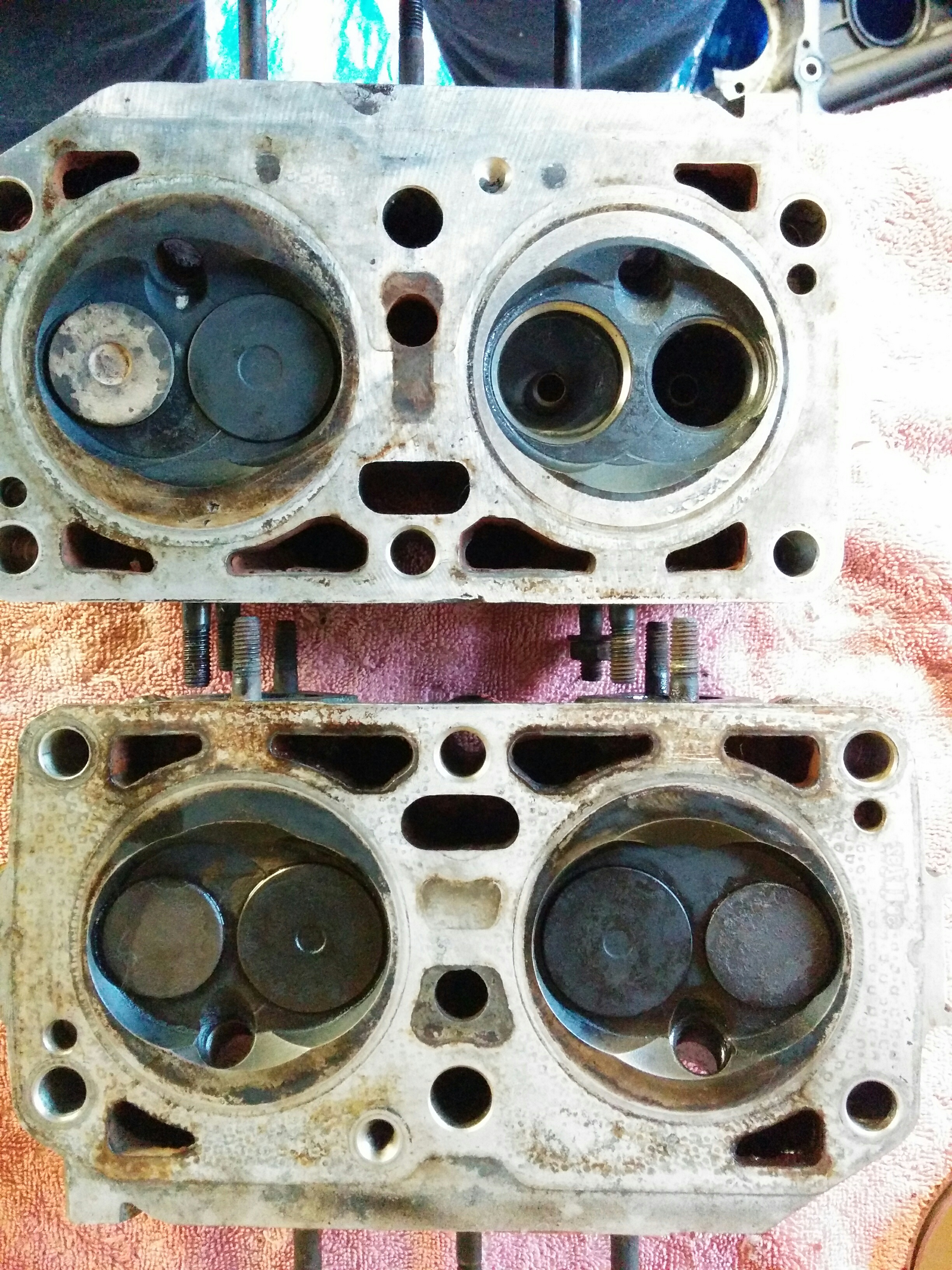

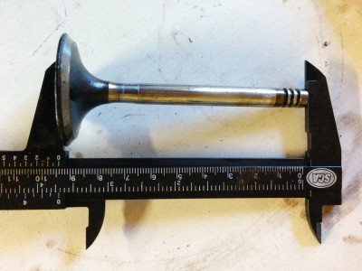

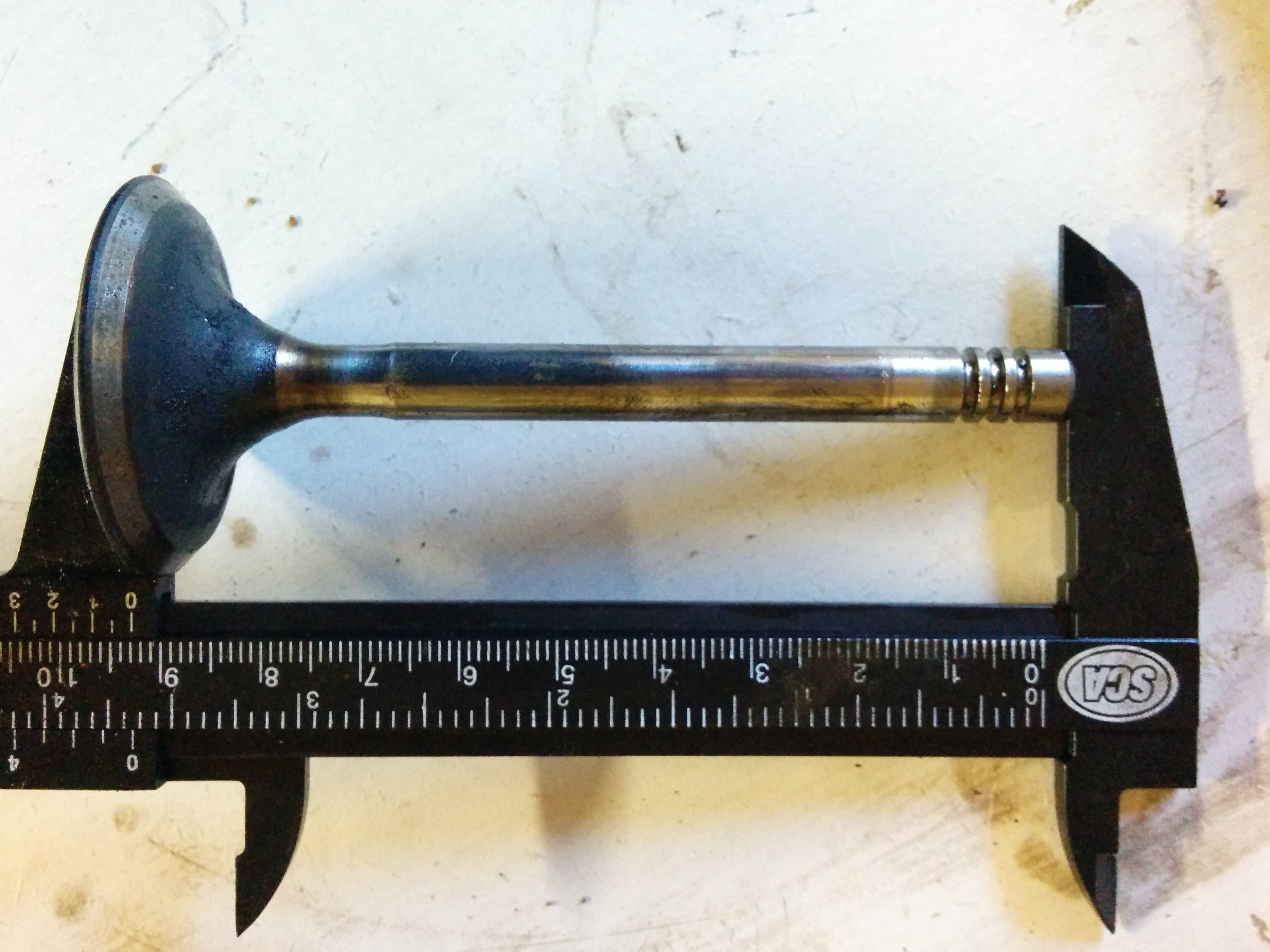

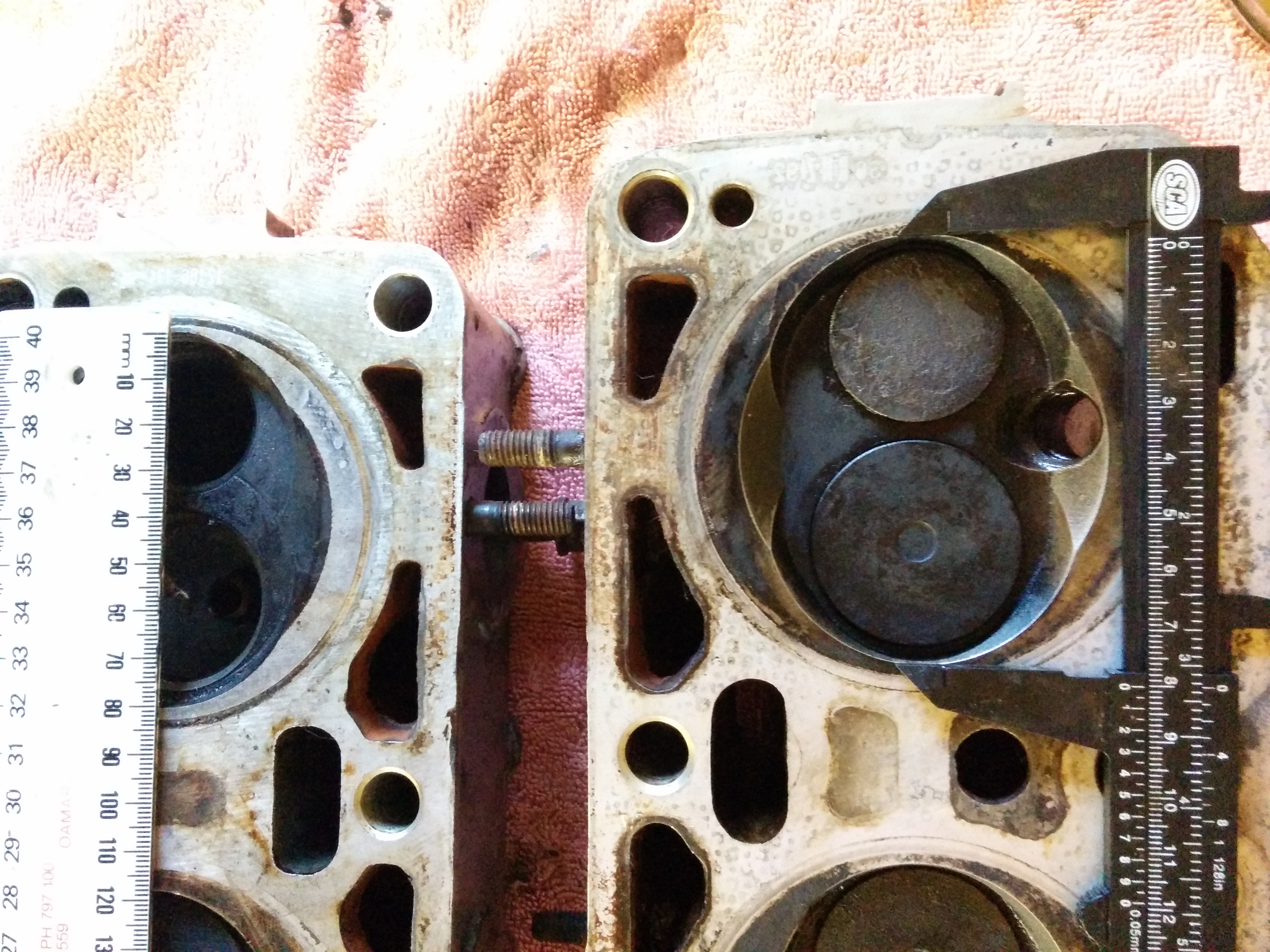

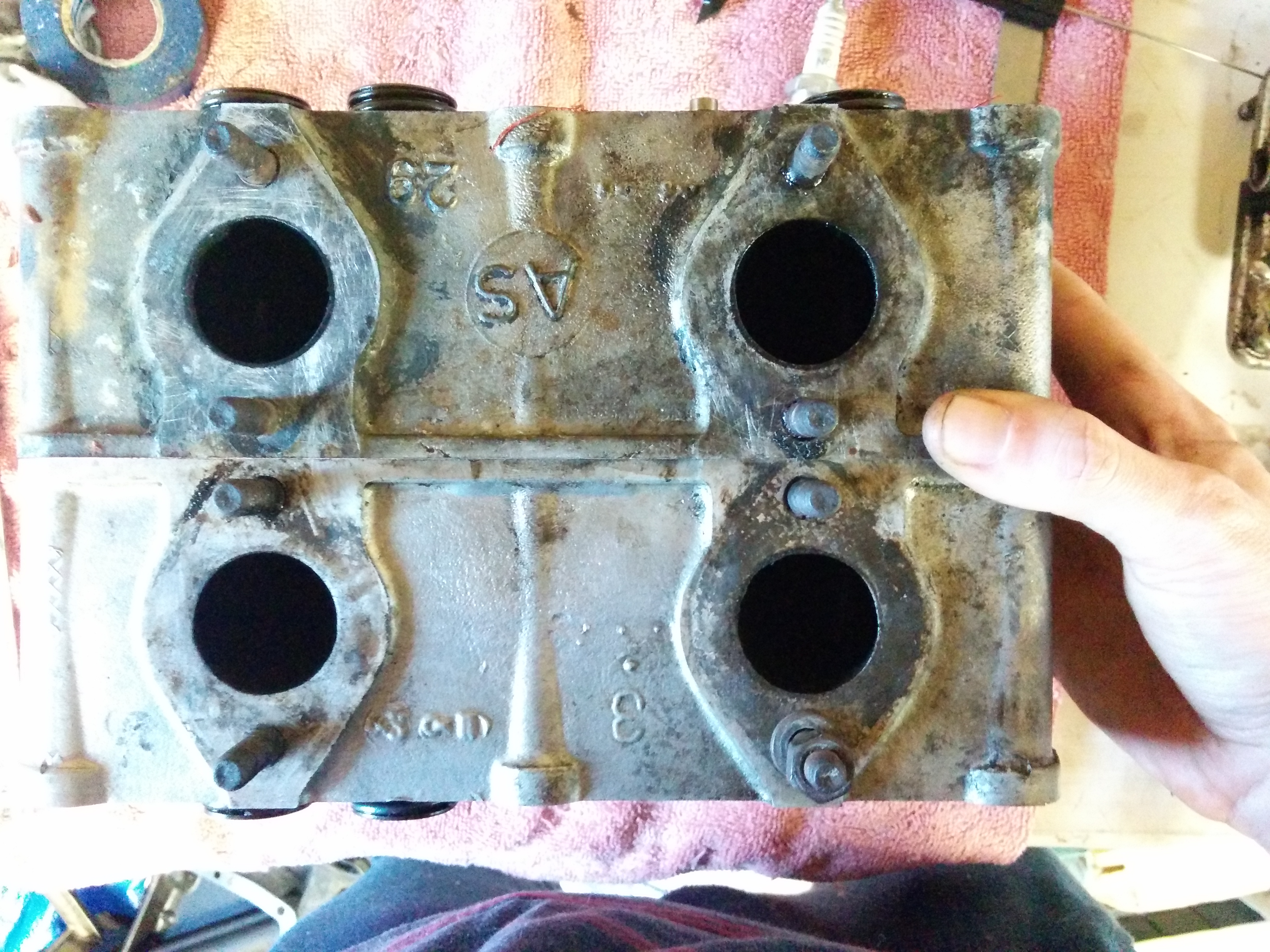

Here are some pics hopefully showing the comparison. You are right, the valves are slightly longer in the 1500 head by about 1mil.
It looks as though someone has had a go at opening the intake ports on my 1700 head. he have a slightly more radius on the lip where they meet the inlet manifold and another strange additional opening that doesn't match the gasket or inlet ports. Not sure what the point was.
Posts: 797
Re: Rebuilding my 1.7 8v
Is the strange opening for use with injectors???

That could make sense. The engine came complete with carbs when I got it but it may have had parts swapped at some point.
bobkelso
Posts: 41
Joined: Fri Mar 20, 2015 2:59 pm
Location: Italy
Post by bobkelso »
I think all 8v heads (1.3/1.5 and 1.7) from '89,
and all heads 1.7 (from some years before)
were produced with the predisposition for iniectors
also if they were used also on carbs model..
it seams there is a unique alfa code for 1700 head,
so a recent (90-94) alfa 33 1700 head could be
a possible spare for a 1700 Sprint for example..
in 90-94 heads the slightly more radius on the lip where
they meet the inlet manifold (about 2-3mm at 45 degree enlarged)
is standard, is done by alfa,
it helps to have carbs intakes duct mounted on the in-let port
without steps and without being worried about the precision
of the mounting screw/holes of the inlet manifoild,
mounting screw were positioned in the head "by hand"
and sometimes are positioned wrong about
1-1,5mm from one head to another..
Thanks really for the images, this comparaison
helps with many small doubs about boxer engine versions!
From photo it seams the 1500 head is not "inferior" to the modern 1700 head,
so a possible direct swap to mech tappets..
More, it seams that your 1500 head have bigger intakes
(non considering the initial enlarged lip on 1700) ??,
if it is original it could means it was a quite extreme head
(for higt rev, according with the more revvy camshaft the 1500 had),
and instead the 1700 head intakes was slightly reduced for more torque
al lov revs.

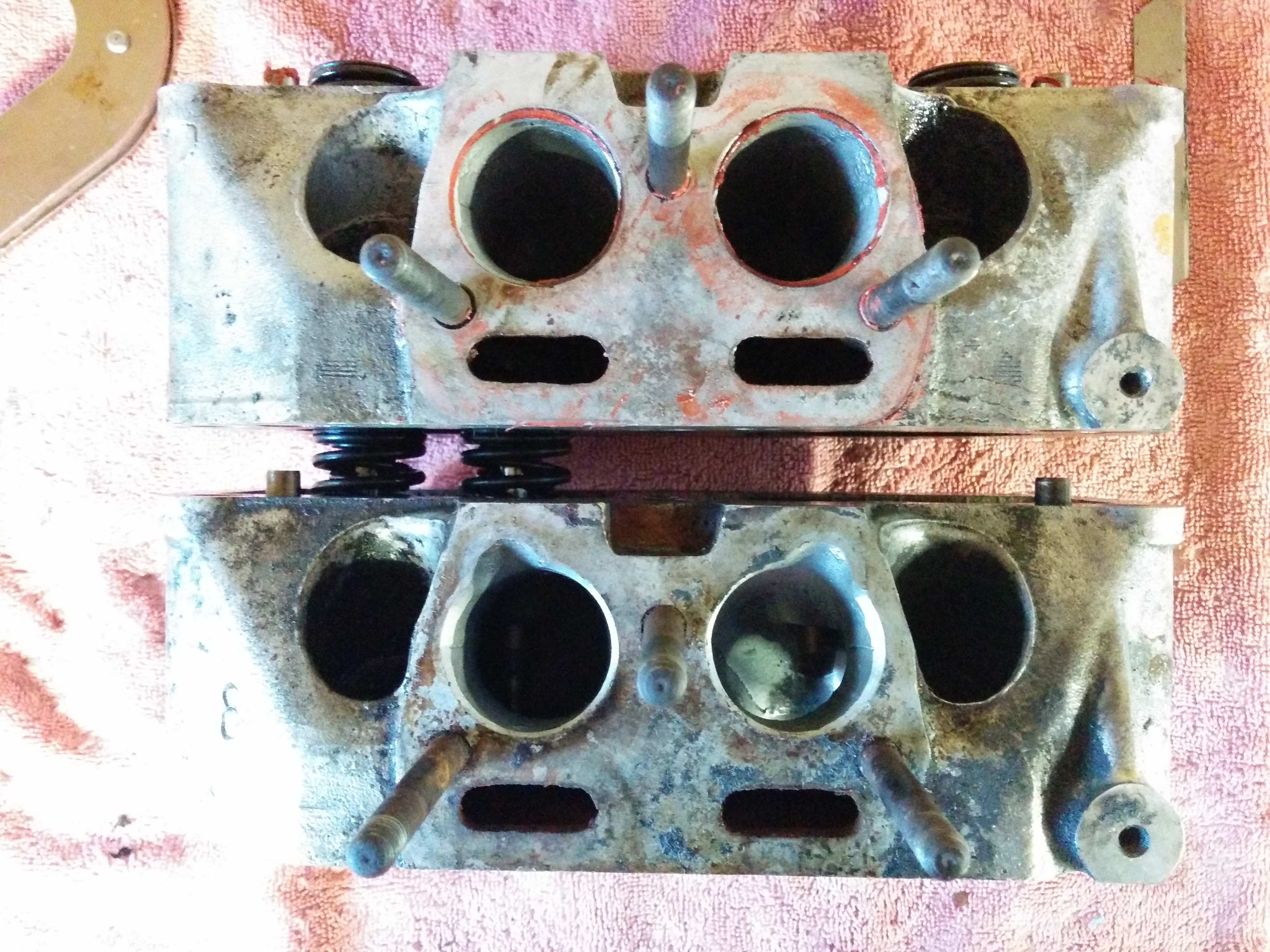

that is interesting about the hand positioning of the inlet manifold studs.
i forgot to attach the pic of exhaust ports

Incredible, with these engines it's like a Lego,
many possible swaps/combinations.. :mrgreen:
Positioned "by hand" I mean, they surely used
a mask-tool to have the 3 stud in the right relative position,
but the head position during the process was not so precise
(and it was not thinked to be necessary probably), for example
if you see in your photos you see the 3 intake stud in the 1700 head
are slightly (0,8mm??) decentrered to the right respect the ideal position,
..in one 1991 1.3 head I repaired I found also a bigger (1,2mm)
intake studs position "error"..but still it was not a problem,
inlet manifold diameter is a bit smaller than the diameter
of the enlarged lip on heads inlet..
Ps.: also the height of the heads you have is spot-on equal?

quite right they are ever so slightly out. Perhaps I should take the sharp edge off the 1500 head's inlet ports like the 1700 has.
Yes the heads are identical in height.

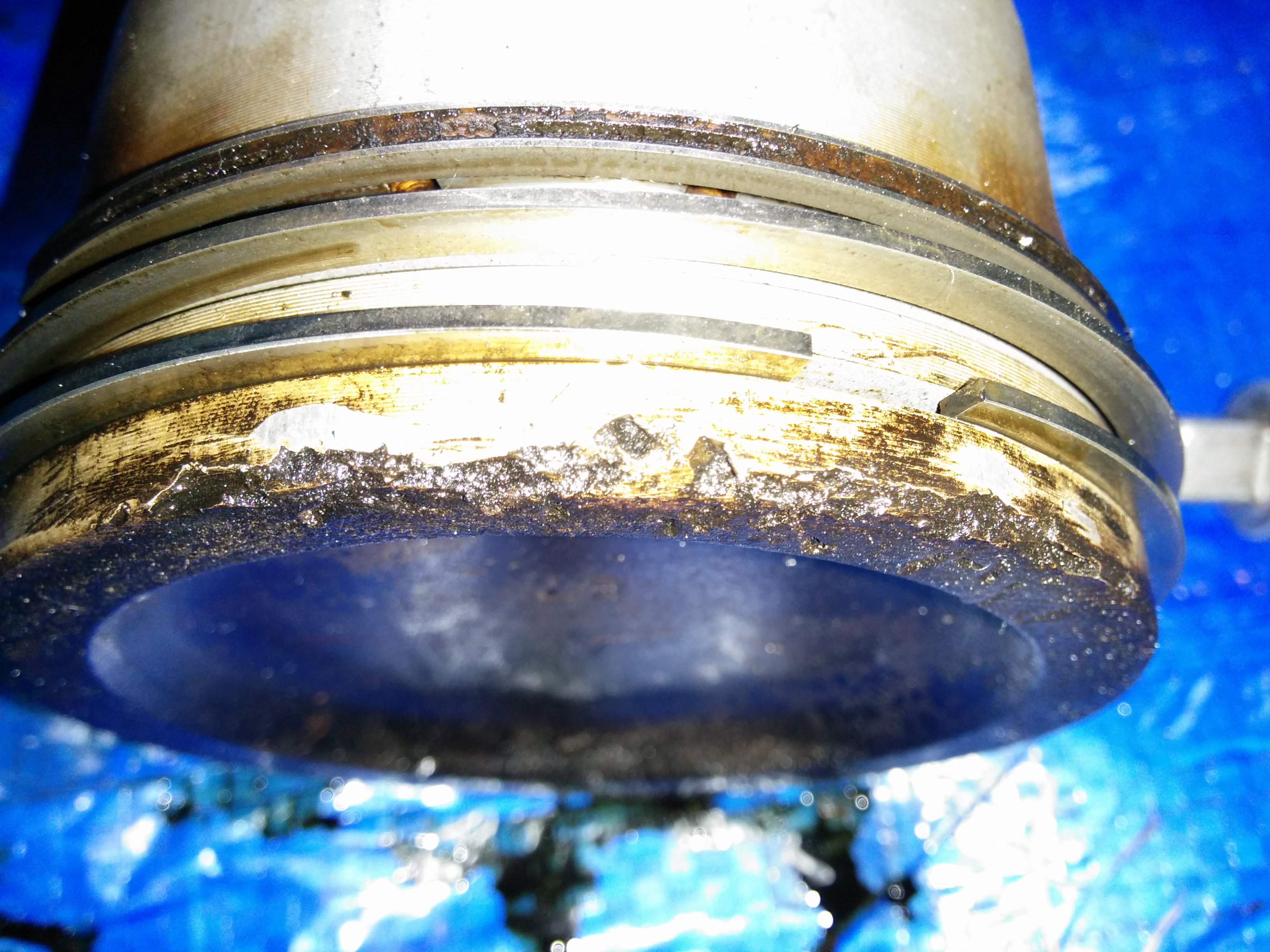

Is this Piston ok to reuse? Its quite pitted in one spot. It looks like its been that way for some time. Im a bit apprehensive about putting it back in.
more experienced guys will no doubt have a better idea but I'd say not, the little pockets are probably caused by detonation and being still there they'll promote further wear in that area and may cause damage to the bores
streamz
Posts: 53
Joined: Thu Jan 30, 2014 11:39 pm
Location: New Zealand
Post by streamz »
I thought as much. I don't really want to risk reusing it. Unfortunately 87mm Pistons are not easy to find though.
