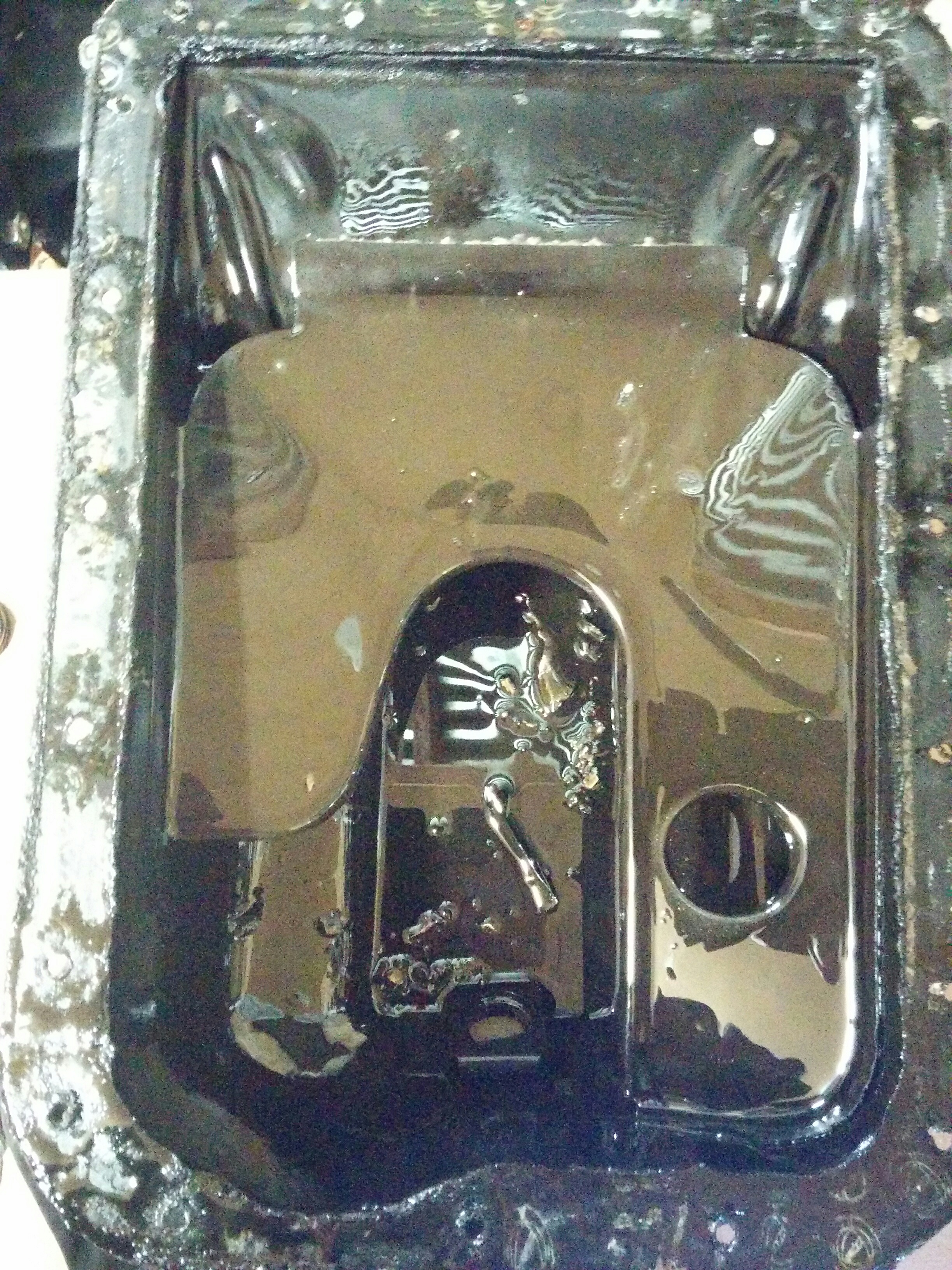

So I took the Sud out for a track day and on the last run of the day I gave my little 1.7 a bit too much of a thrashing. I was sitting at 8000RPM up the hill and something let go. I came into the pits with what sounded like sheet metal being dragged under the car. Something is definitely loose in the sump.
Nothing has come out through the block. Any guesses what I'll find when i take the sump off? Hopefully its rebuildable.
The engine is the 1.7 hydraulic tappet carbed motor out of a 33.

Con rod bearings/shells?
Surprised it didn't lock up though
Could be busted rings but I'd go with shells.

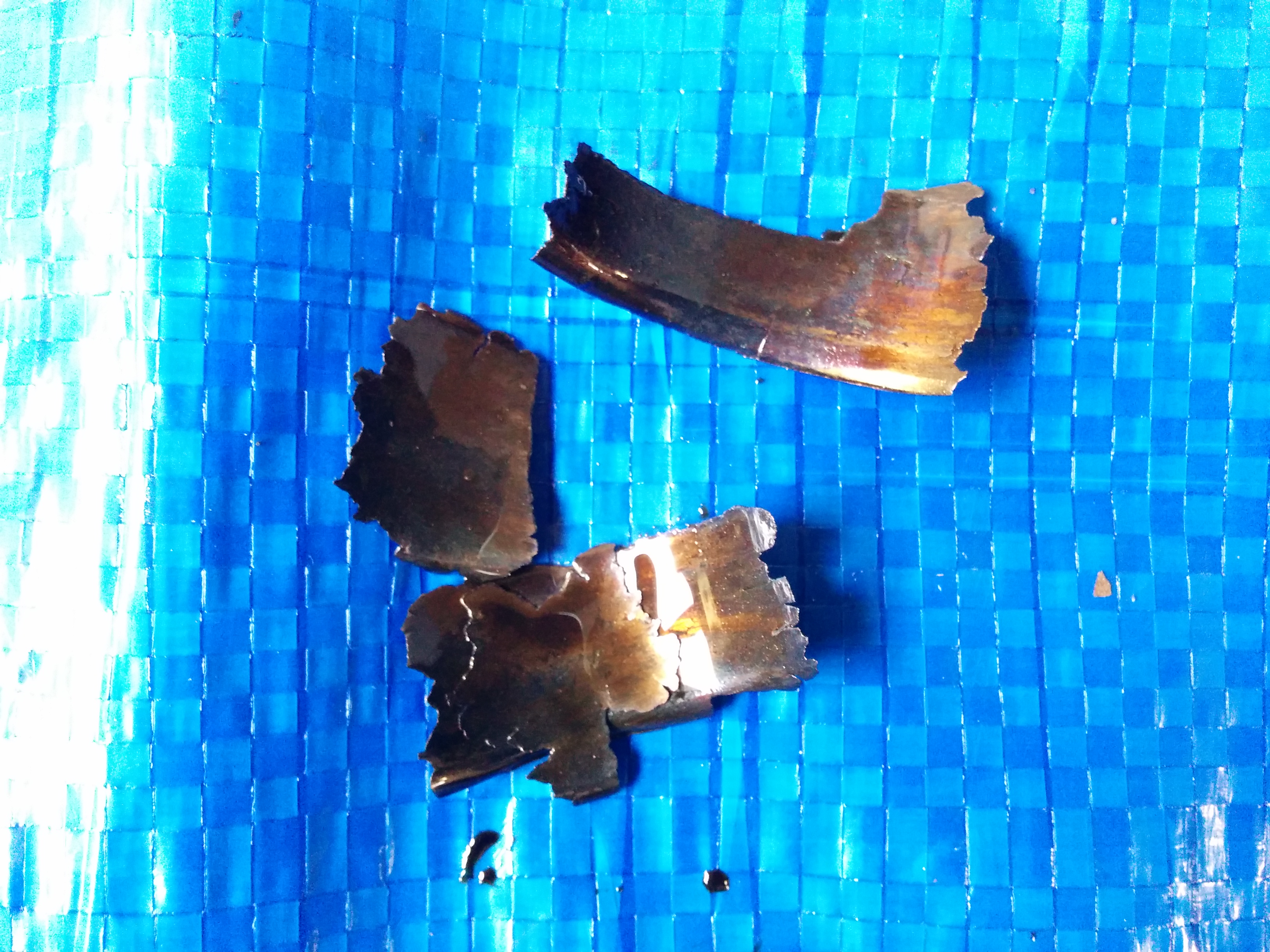

Re: Took the sud for a track day...
correct!. Curiosty got me and I opened it up tonight. Bearing shell remnants in the sump. Nothing else looks damaged. Whats the recommend course of action. Pull it apart check tolerances. Will the crank need a regrind?

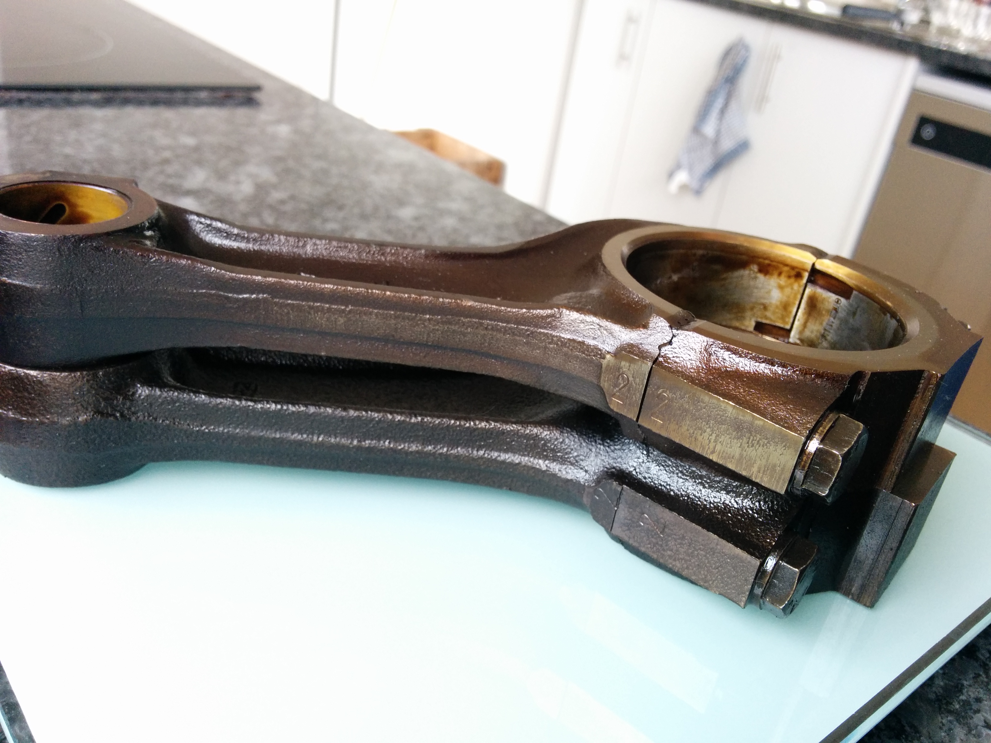

hmm...slightly optomistic on nothing else damaged.
whichever shell failed, expect a crank regrind (polish minimum) and a con rod ruined.
hopefully no piston hitting valves depending if the shells overlapped in the conrod.

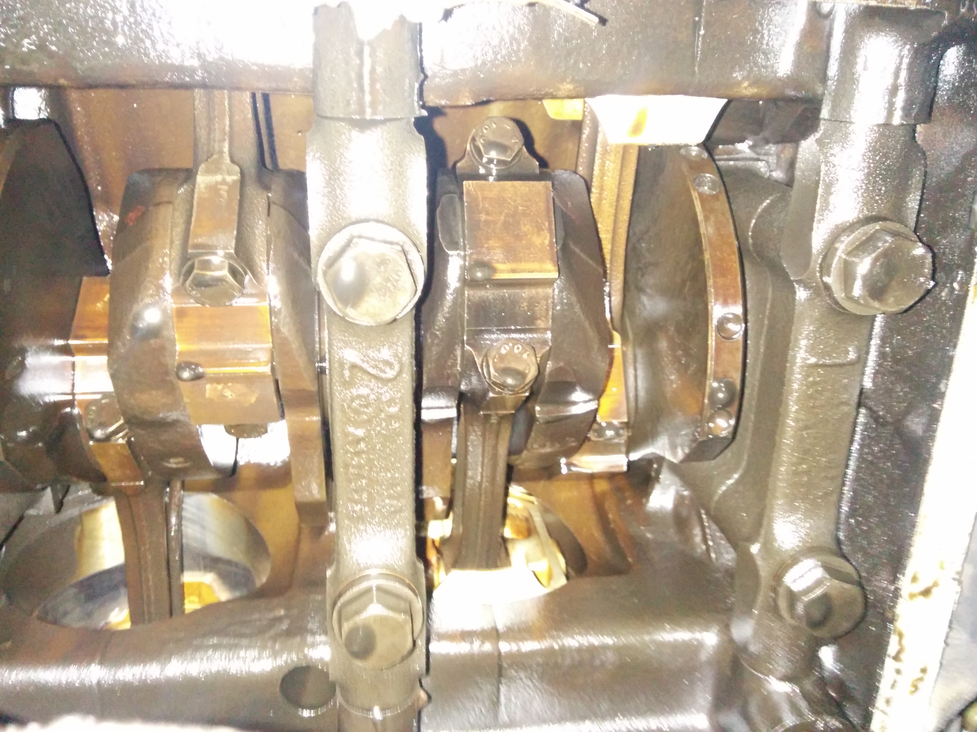

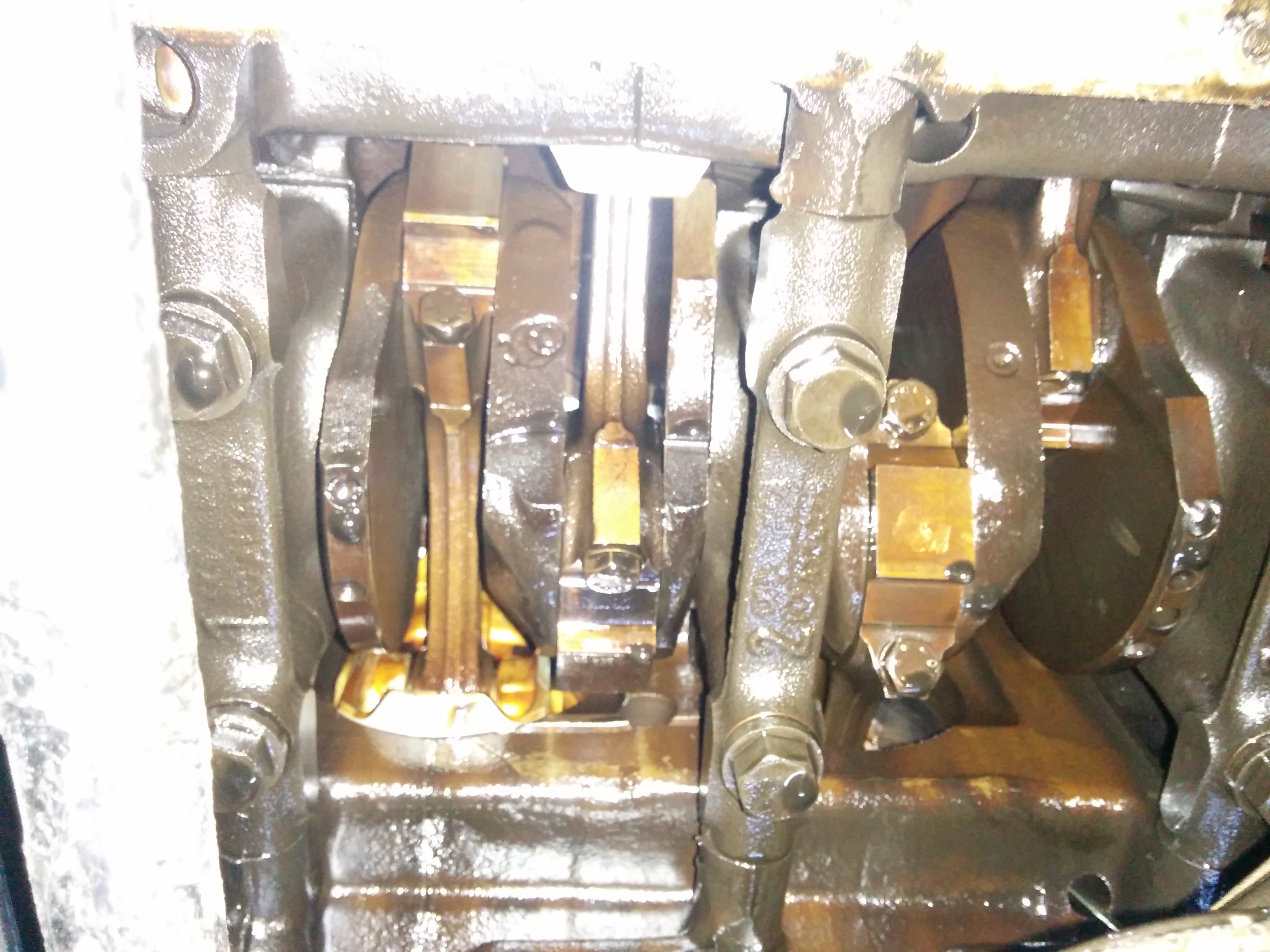

Everything looks remarkably intact apart from the bits of metal in the sump. You must have caught it quickly. Do keep us up to speed on each step of your investigations and thanks for sharing so far.
is it just the angle of the pic or does con-rod No.1 look bent?
agreed with above, could well be nasty once the caps are removed but equally lucky that everything is still bolted together!
thanks for the comments, i'll keep you updated. I'll start stripping the engine down tomorrow. What's the availability of conrods like? I have two spare 1.5 motors. Is anything interchangeable from them?
I think its just the angle of the pic that makes the conrod look bent. It all looked straight when I was under there.

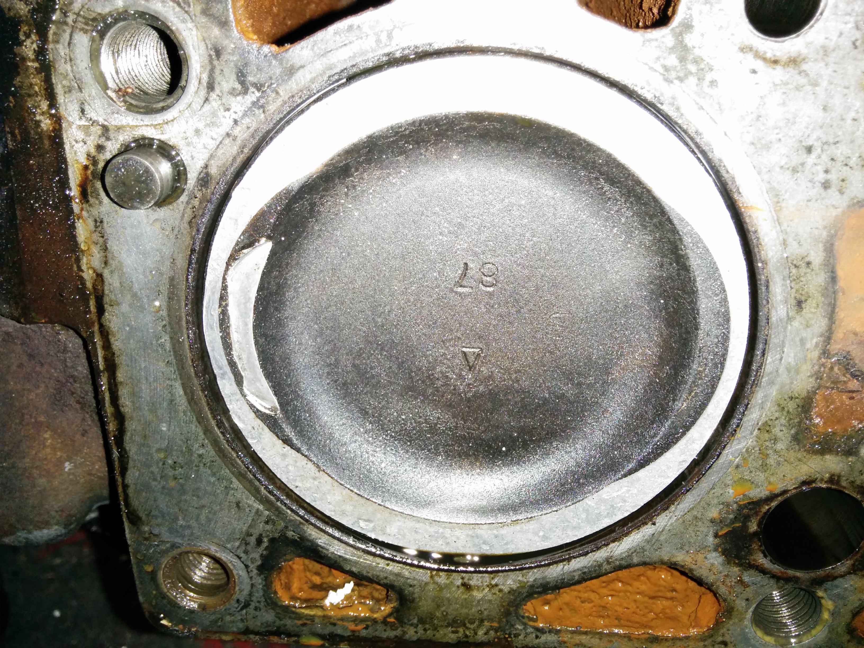

got the engine out and heads off today. Not good news the inlet valve is bent on the cylinder with the failed bearing.

1700 Pistons in a 1700 block, they are larger than a 1500 (87mm 1700, 84mm 1500).
The piston looks like it will clean up in the pic, is it badly damaged?
Ok so 1500 crank in 1700 block with 1500 standard size crank journals. 1700 pistons and conrods will make a 1600 engine. No need to deck the block to adjust compression?
The piston has a groove where it contacted the valve. Should I just smooth out the rough edges?

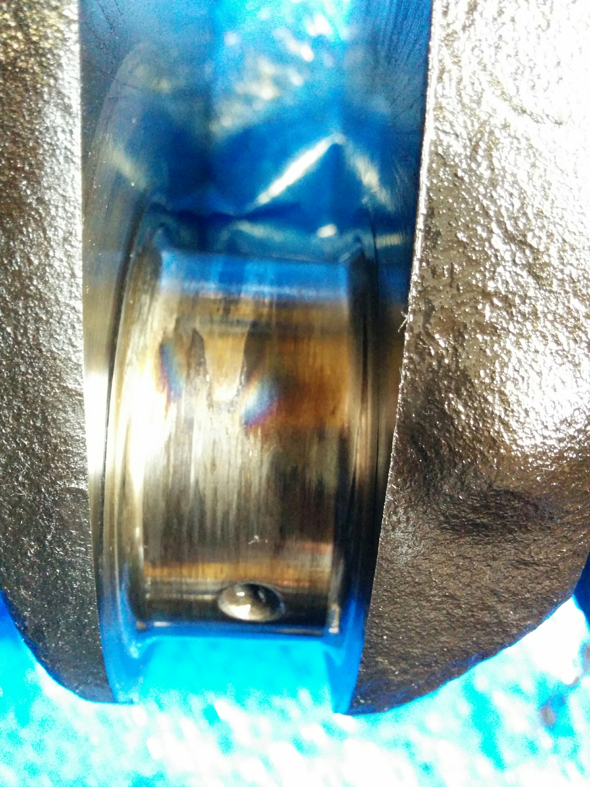

Engine is dismantled. Pretty nasty damage on bearing number 2. There wasn't much left of the bearing.

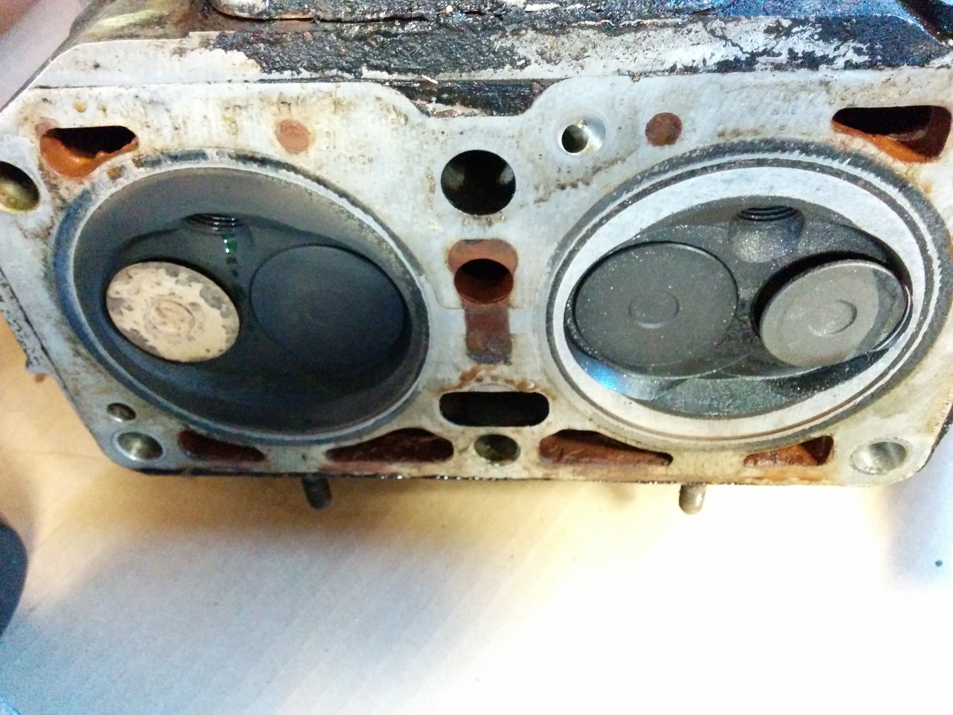

Re: Rebuilding my 1.7 8v
Today i removed one head from my 1500 twin carb motor and compared it the my 1700 head and as far as i can tell its identical. Even the valves seem to be the same length and size.
I checked the valves to make sure they have a good seal by filling the combustion chamber with fuel and blowing compressed air into the intake and exhaust and there were no bubbles in the fuel so I think instead or replacing the valves and valve guides in the 1700 head I'll just use the 1500 head.
Yep the Mech tappet 1500 head is the same as the 1700 hydraulic tappet head. I measured the exhaust ports and they are the same diameter. Same combustion chamber design, diameter and depth. I havn't looked at the camshaft in the 1700 cam box yet.
