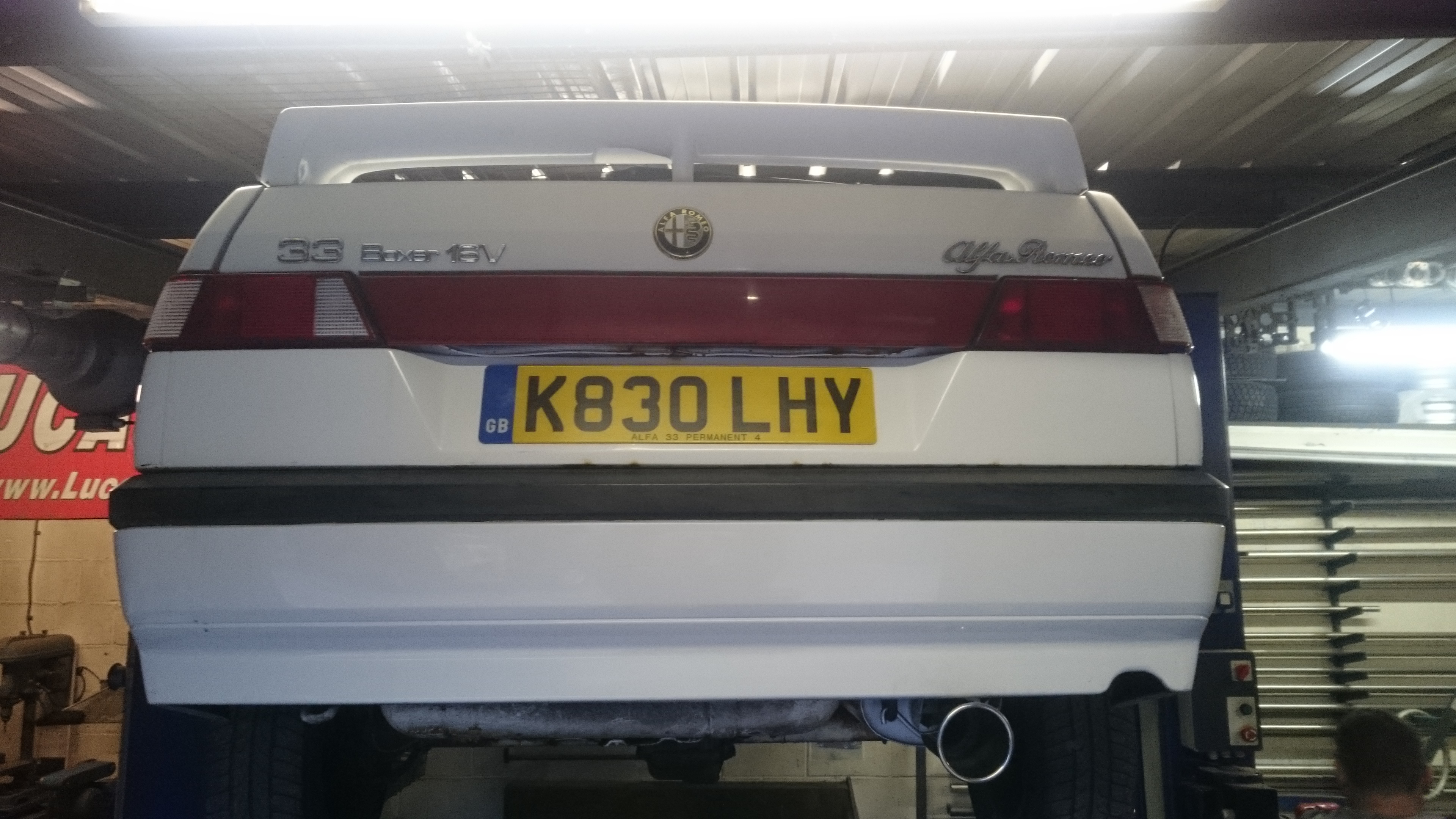

I spent yesterday in Shrewland having a new exhaust fitted to the White P4 Matt used to have until I bought it :D
Bit of a long day as the M5 north bound was closed so decided to go the long way around through Stow on the wold and the fosse way (forgot what a lovely road that is).
By the time I got there the front pipe was on and looked amazing.
A few hours later and another one of Shrew's friends met (hopefully he is going to sort the wing mirror supports for FMJ) and a friendly Rottweiler "pup" all was done and ready to fire up and listen.
Only problem being that I cocked up the photos and can't get the video to play :oops:
SO hopefully Shrew can post some pics.
Here's one of the P4 anyway

And so, a pretty unique exhaust was commissioned to kick this off.
H actually requested a 4into1 manifold type thing, which was quite fortuitous, as i had a race built manifold sat in the workshop, so all i needed to check was whether it would fit around the P4 layout of parts, but of course, where theres a will, theres always a way :P
H is also, as we all know, a lover of vivid colours, and likes to make a bit of a statement with his motors, si the manifold being mild steel rather than our usual stainless, allowed me to indulge that for him, so once fitted up and checked, i painted it with a nice bright vht red to show it off and preserve it too
H also likes volume, so a single rear silencer and large rolled back tip, was sure to give it a nice note, with plenty of oomph and tone, and taking into consideration the future body mods, we also decided to straight the run out the back and avoid the puny allowance alfa afforded us, so this will be blanked out before the paint hits.
