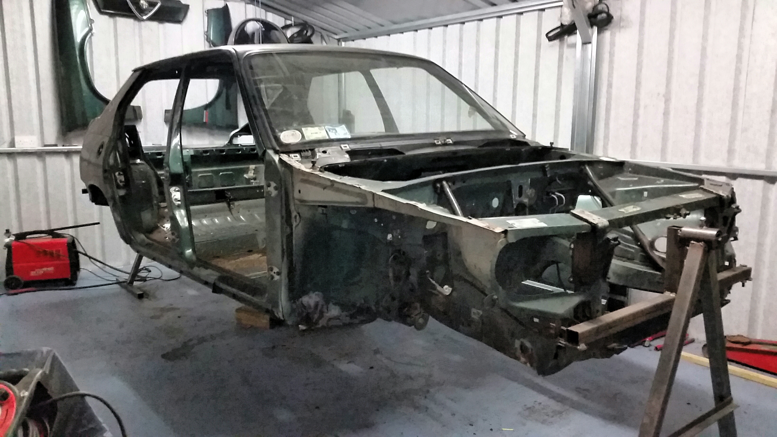

Hi folks,
I'm in the middle of a fairly major restoration on my 33. (Taster below) I've just finished patching up the cills and floor pan and am thinking about how to protect it.
I'll be using dinitrol in the cills & cavities but for the actual floor pan, I'm looking for something similar to the original underseal/stonechip protector.
I was wondering if those who have been here before have any recommendations? I want to stay away from the bitumen based stuff as I'd like to paint the underside once it's finished.
Any pointers appreciated!!

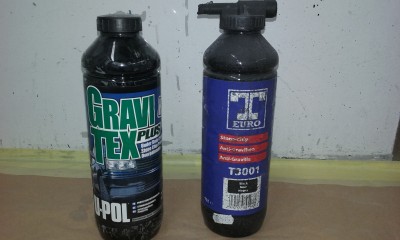

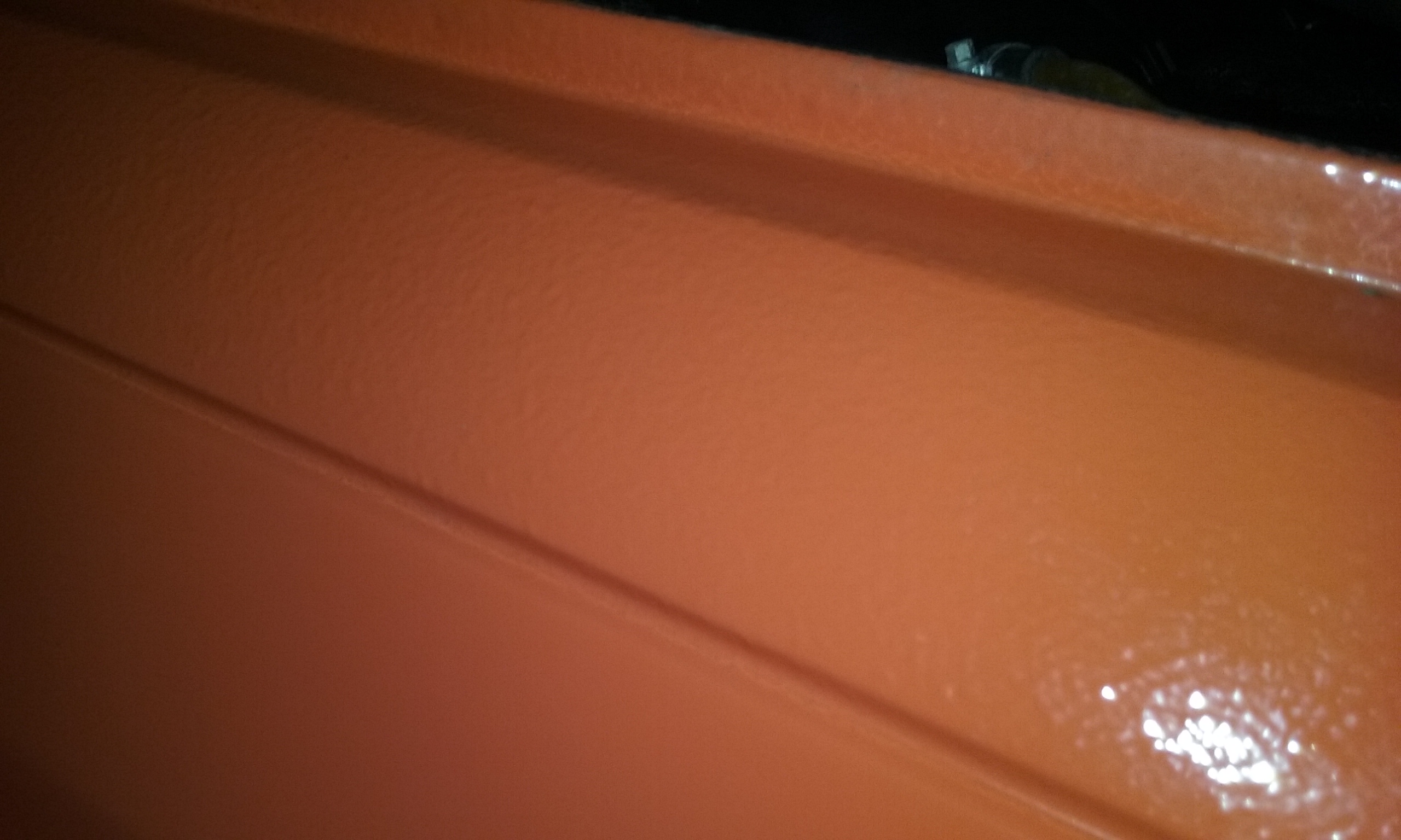

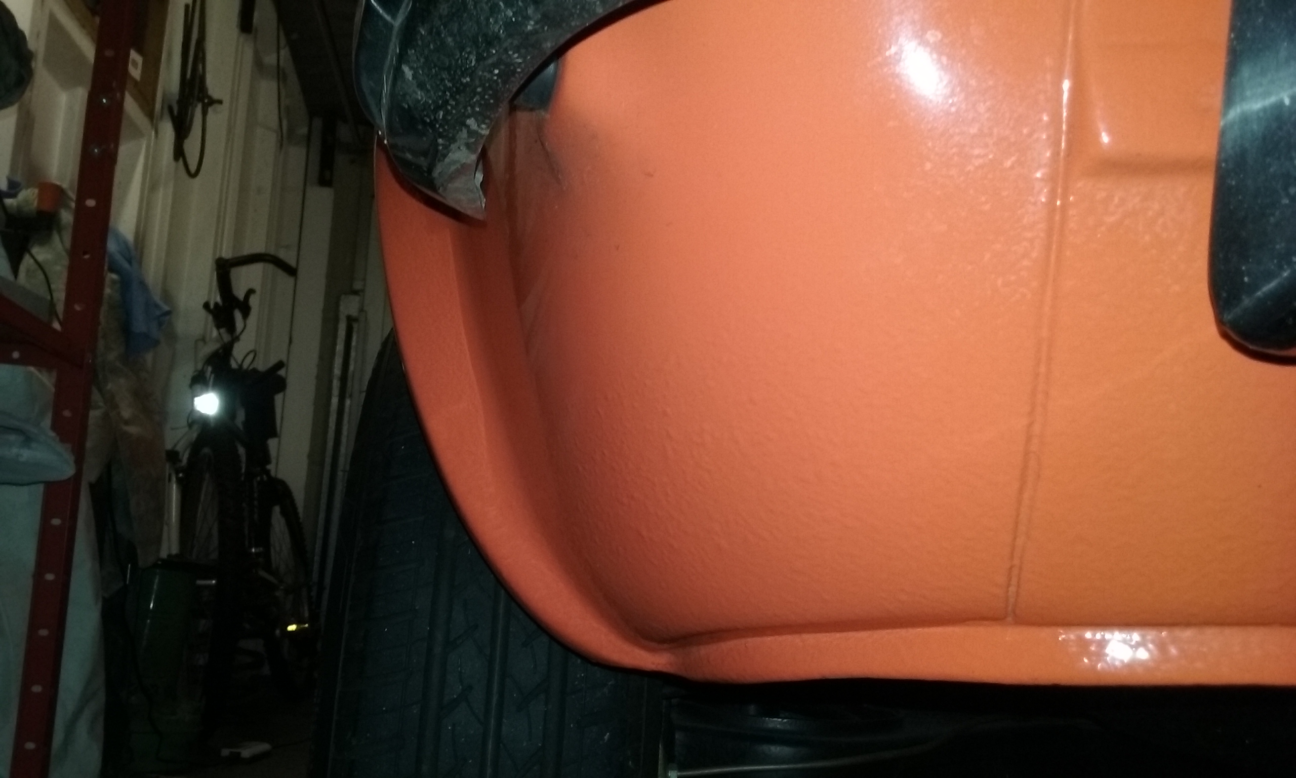

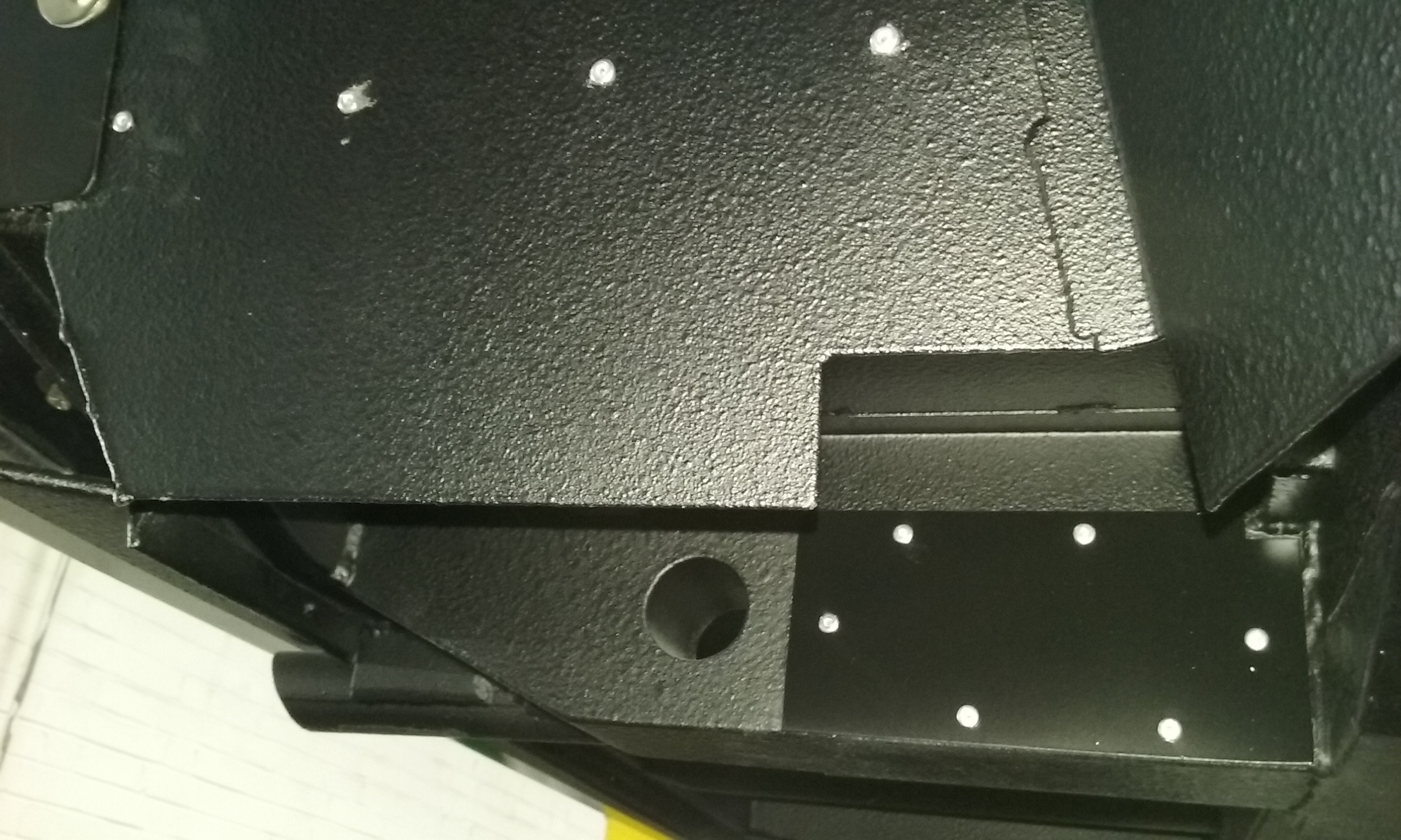

Another option is Upol Gravi Tex.
Like Simon said with Raptor, it is painted over when dry.
There is also a trade stone chip that seems to be just as good.
Photos are under a job at work with satin finish black 2k paint. The other is how I did my car. Sorry pics are a bit iffy the light isn't that good. :D
Hope it gives you some more options.
