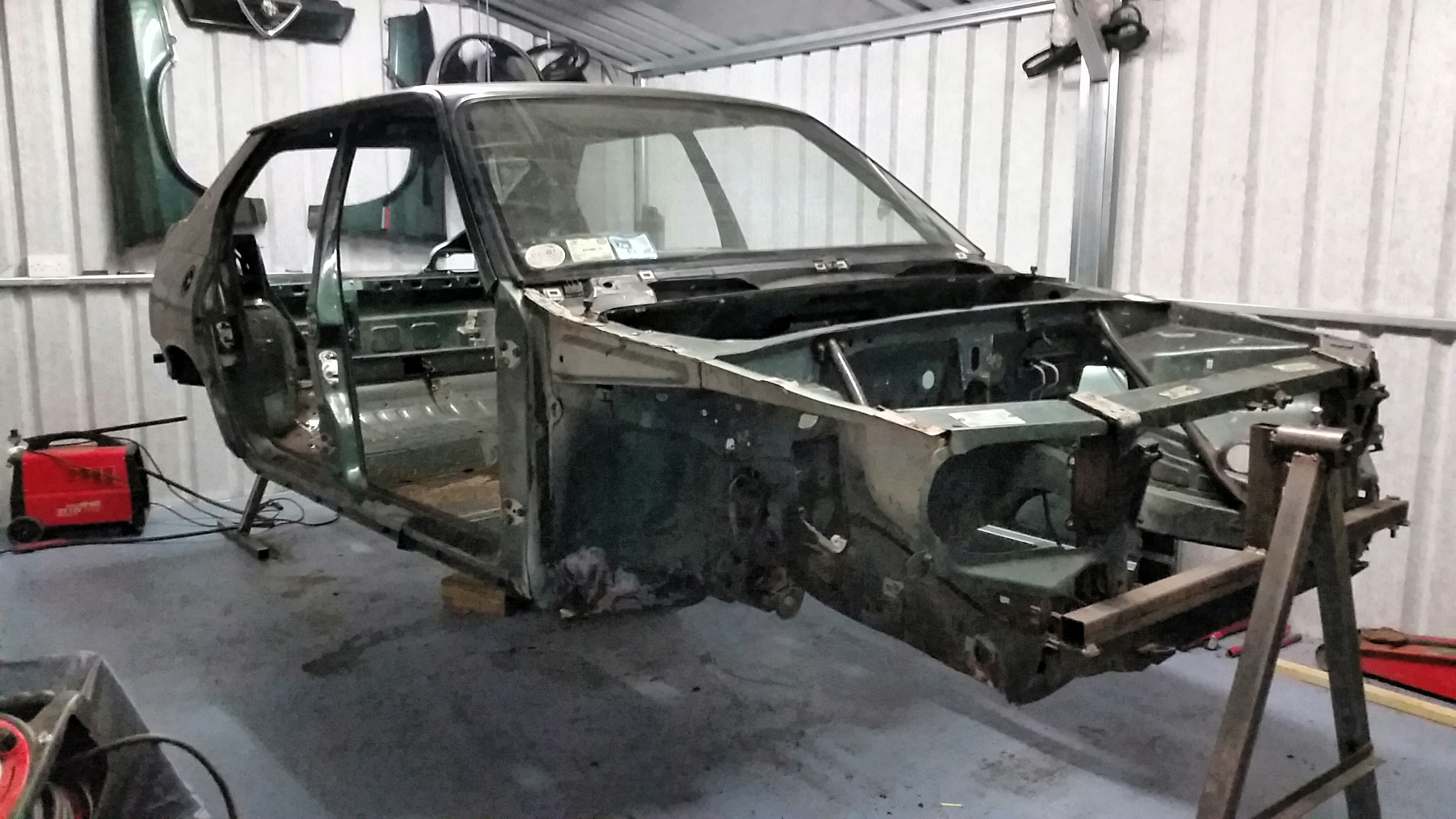

I'm in the middle of a fairly major restoration on my 33. (Taster below) I've just finished patching up the cills and floor pan and am thinking about how to protect it.
I'll be using dinitrol in the cills & cavities but for the actual floor pan, I'm looking for something similar to the original underseal/stonechip protector.
I was wondering if those who have been here before have any recommendations? I want to stay away from the bitumen based stuff as I'd like to paint the underside once it's finished.
Any pointers appreciated!!

Wow, that looks serious. Good luck with it all. Sorry no knowledge on underseal.

Left hand drive?
Anyway. Sorry, sidetracked!
I quite like Gravigard, particularly for areas to be body coloured like sills, front and back panels.
It takes paint very well, and so far as i know, very tough and resistant, served me well to date at least

Thanks, ill check it out. I'm looking for any pointers at all so it's much appreciated.petrolhead wrote:Left hand drive?
oh and it's rhd, I mirrored the picture for a before/after I was doing and no one picked up.on it before now, You can claim your prize!!!
Re: underseal recommendations?
I thought it looked weird. But if I'm honest, i didn't know whether any of the other European 33s had right hand side fuel filler anyway?
It just struck me as different looking and the tax discs on that side too.
I'm clearly an anorak of some measure!
