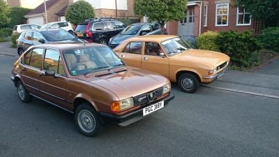

Baby oil. honestly, try it! Check my bumper!
Chris
Re: Restoring black plastic trims etc
Baby oil does work well on clean bumpers, smells nice too! Lol!
Can it restore crusty old ones too Chris?
I've used Plasbak many times to recolour even some nasty crusty, but straight, trim and bumpers.
