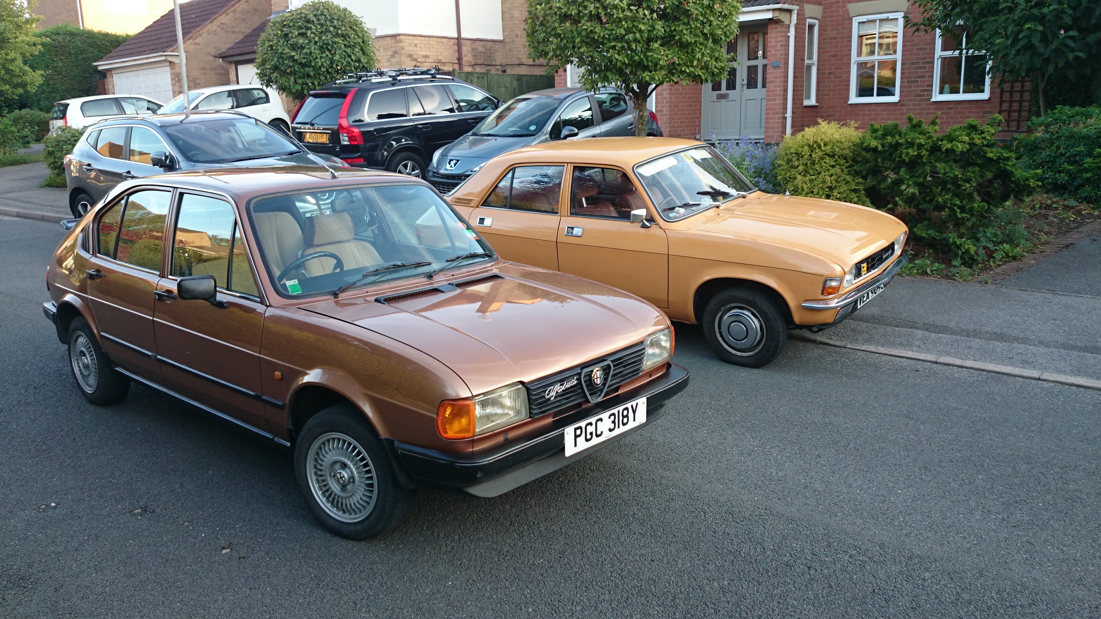

Baby oil. honestly, try it! Check my bumper!
Chris
						Chris
Re: Restoring black plastic trims etc
Baby oil does work well on clean bumpers,  smells nice too! Lol!
