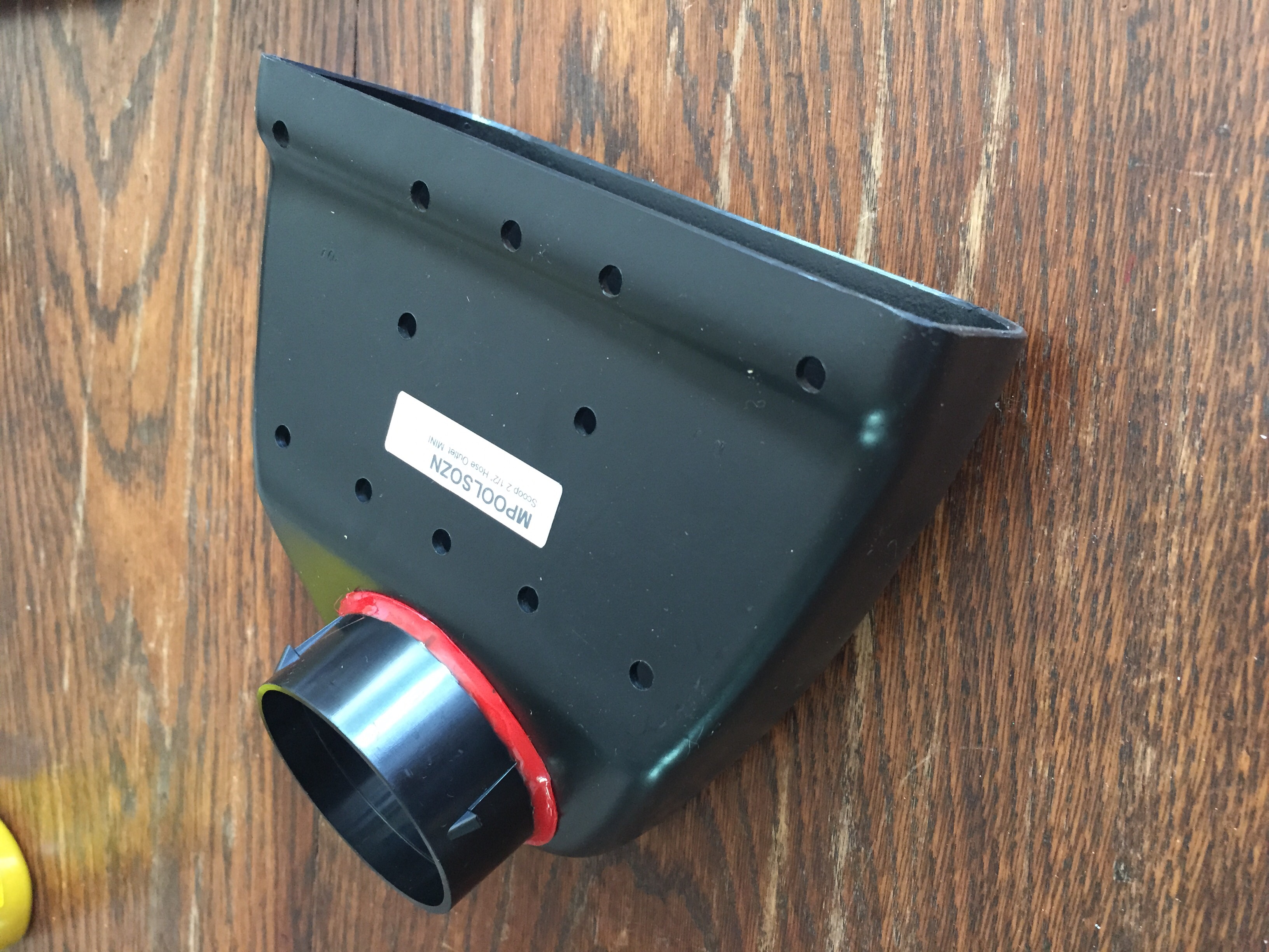

The SC felt good but the brakes do not give me the confidence that I get from the Sprint with the outboard 33 set-up with cooling ducts.
The brakes started to fade after a couple of laps so a lot of lifting and coasting, particularly through Craner Curves in order to have the brakes at the top of the circuit for McLeans. The real killer for the brakes though was the combination of the Fogerty Esses, Melbourne Hairpin and Goddards as the brakes were just not able to cool in time.
Ducting will be the first job once back home, un-vented, inboard discs in very close proximity to the manifold seem to quickly lose their edge!

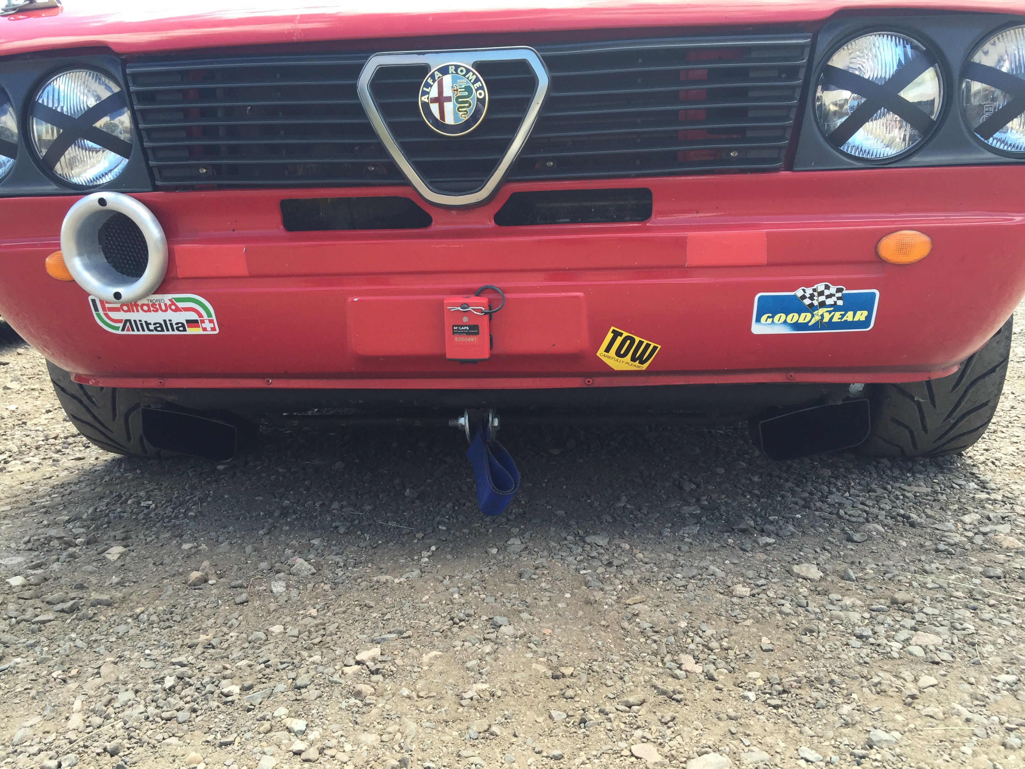

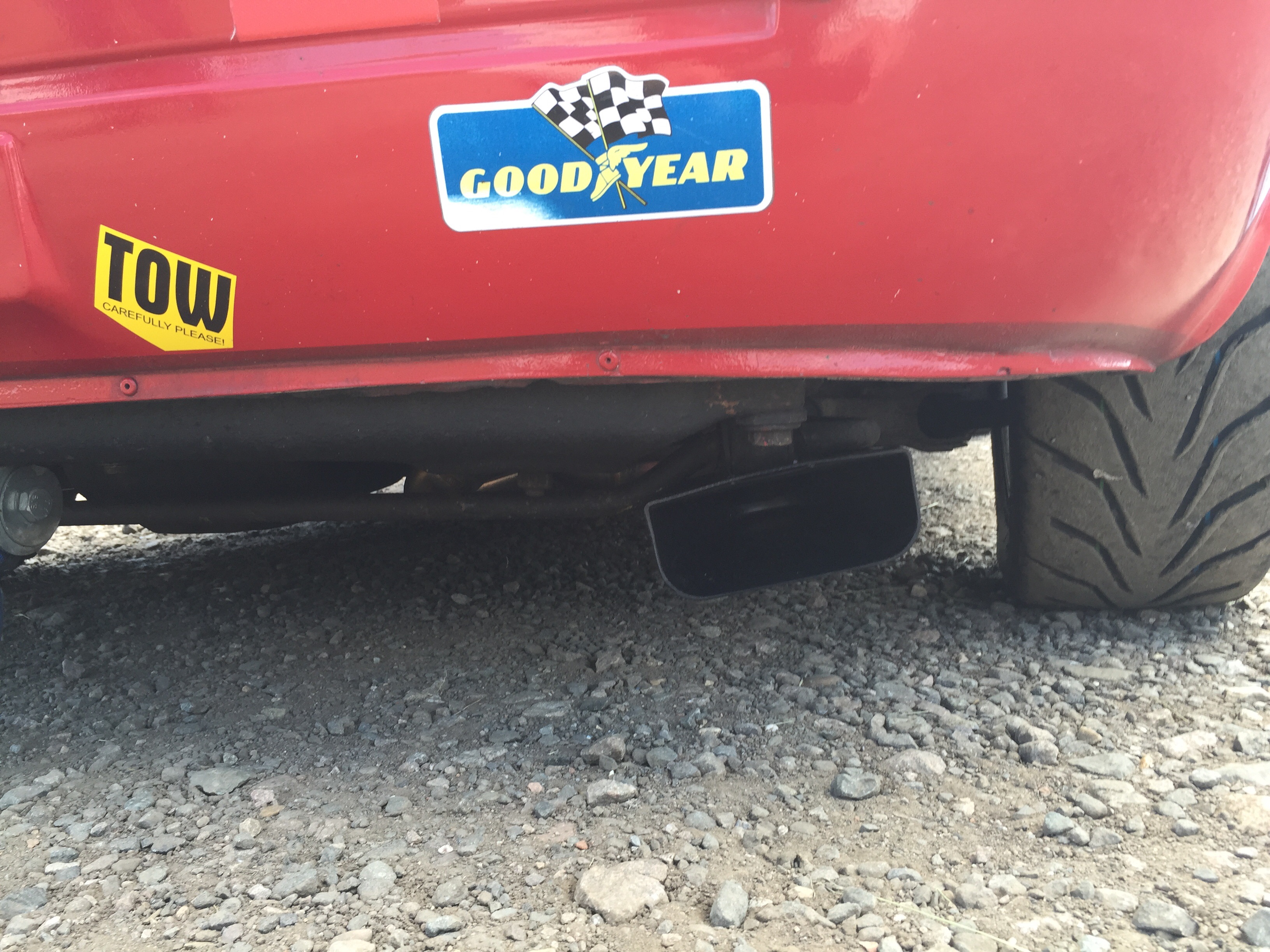

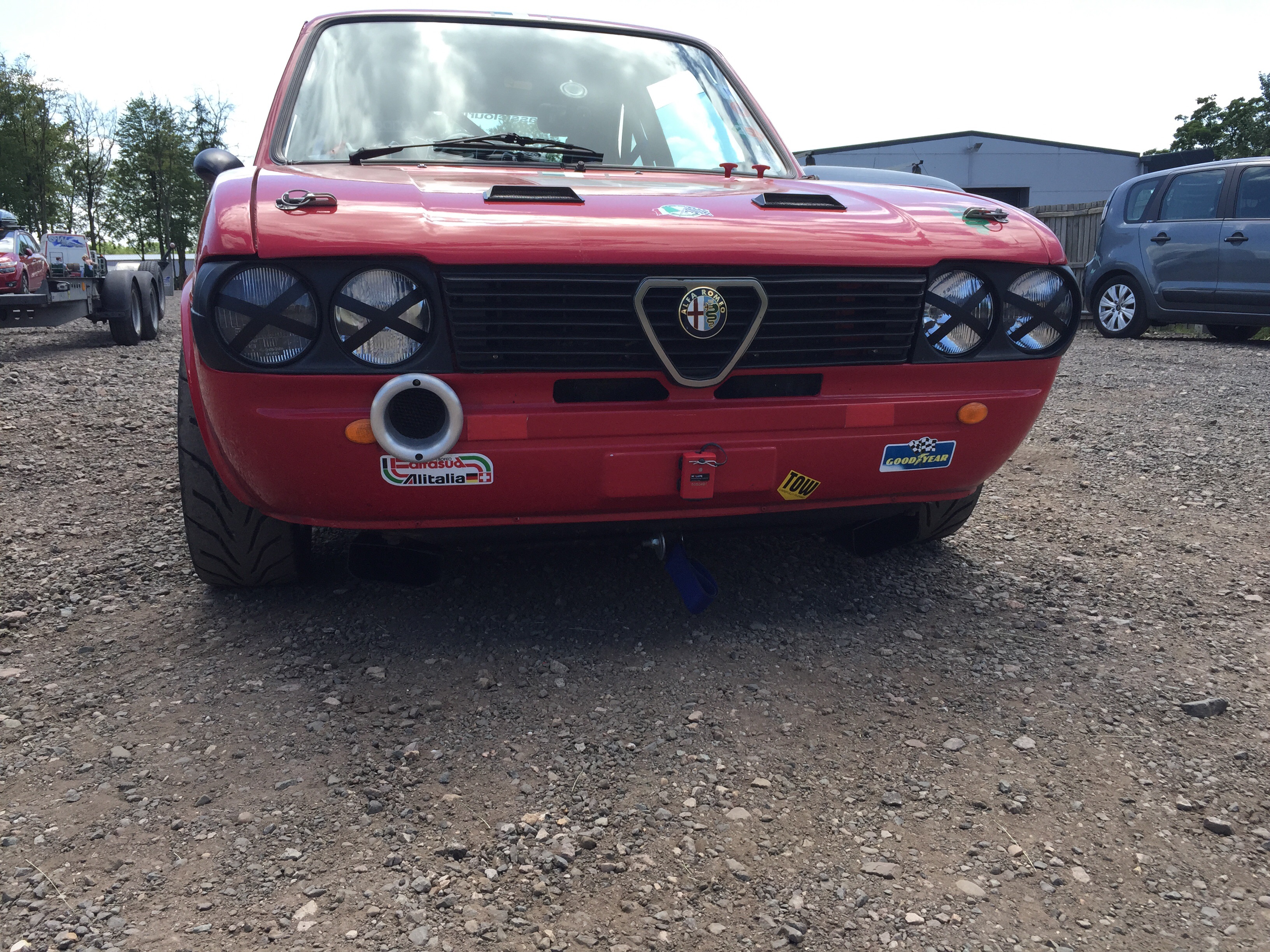

Simon very kindly fitted some cooling ducts on the SC before the second race , this made quite a difference and the brakes were much better right up until two laps from the end when some smoke started filling the cockpit. No flames visible so carried on while looking out for any marshalls waving frantically.
Had a bump from the CRX half way through the race while braking for McLeans. Bit of a dent in the rear valance so not so straightforward to pull out.
Thanks to Simon's ducting I was able to improve 3 secs a lap in race 2.

Hi Guys,
I was very slow at Donnington so I am going to skip over that.
Here are details of our inboard disc cooling system:
Great to see the Orange Ti Keith. Lovely job.

Are the inboard discs on the SC the (rare) upgraded vented discs or the standard solid disc and calipers? What pads did you use?
Simon - donington is a much harder and technical circuit to learn than it looks, take credit your lap times were faster than mine the first time I raced on the GP circuit and it will take a couple of more visits to get it right.
I still can't get all the lines right :D
Posts: 976
Re: Donington 6th/7th June
Post by Marlow Sud »
Hi Tim,
The pads in the 1.5SC are DSUNO no less.
http://www.ferodoracing.com/products/ca ... ds/ds3000/
The discs are the standard thin solids and standard ATE calipers.
Brake fluid is AP Racing Radi-CAL R4 with a boiling point of 340deg.
In your Sprint, have you got inboard 265mm ventilated discs (cut down) with 6 pot lightweight calipers per chance?

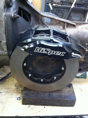

I have a plan. I am going for big vented discs with four pot calipers all mounted inboard. Also, a more capable brake master cylinder.

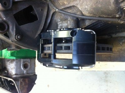

Big inboard brakes.
Here are a few pics that Rodger (Alfascozia) sent me of his setup:
The 1.5 SC goes to HiSpec a week tomorrow to have inboard brakes like this fitted. HiSpec have advised the cost will be <£1000.
8-)
That's a snug fitting caliper. Looks good.
