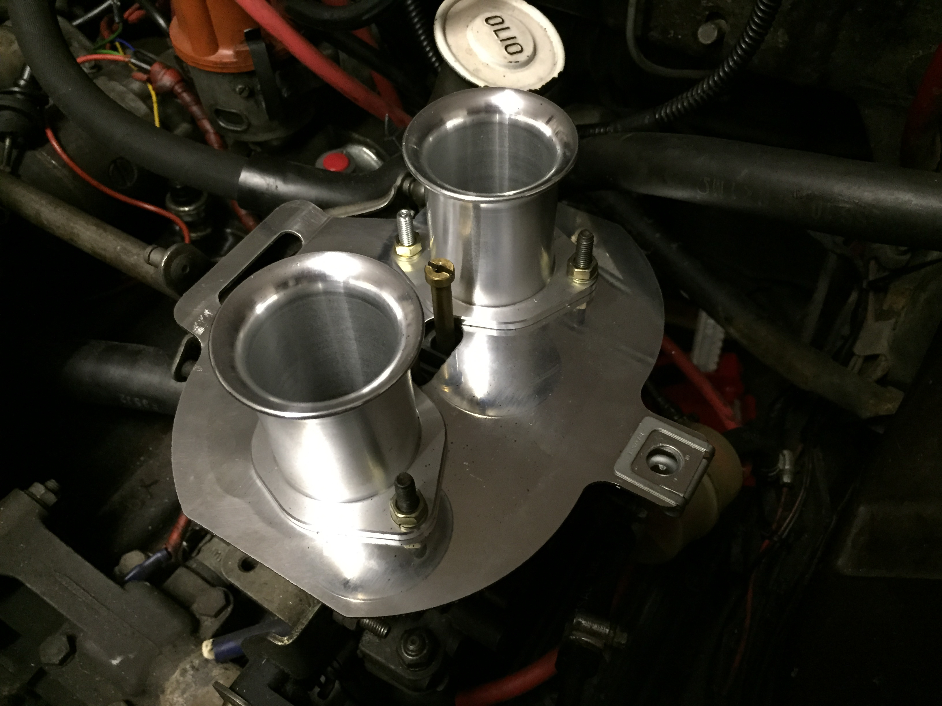

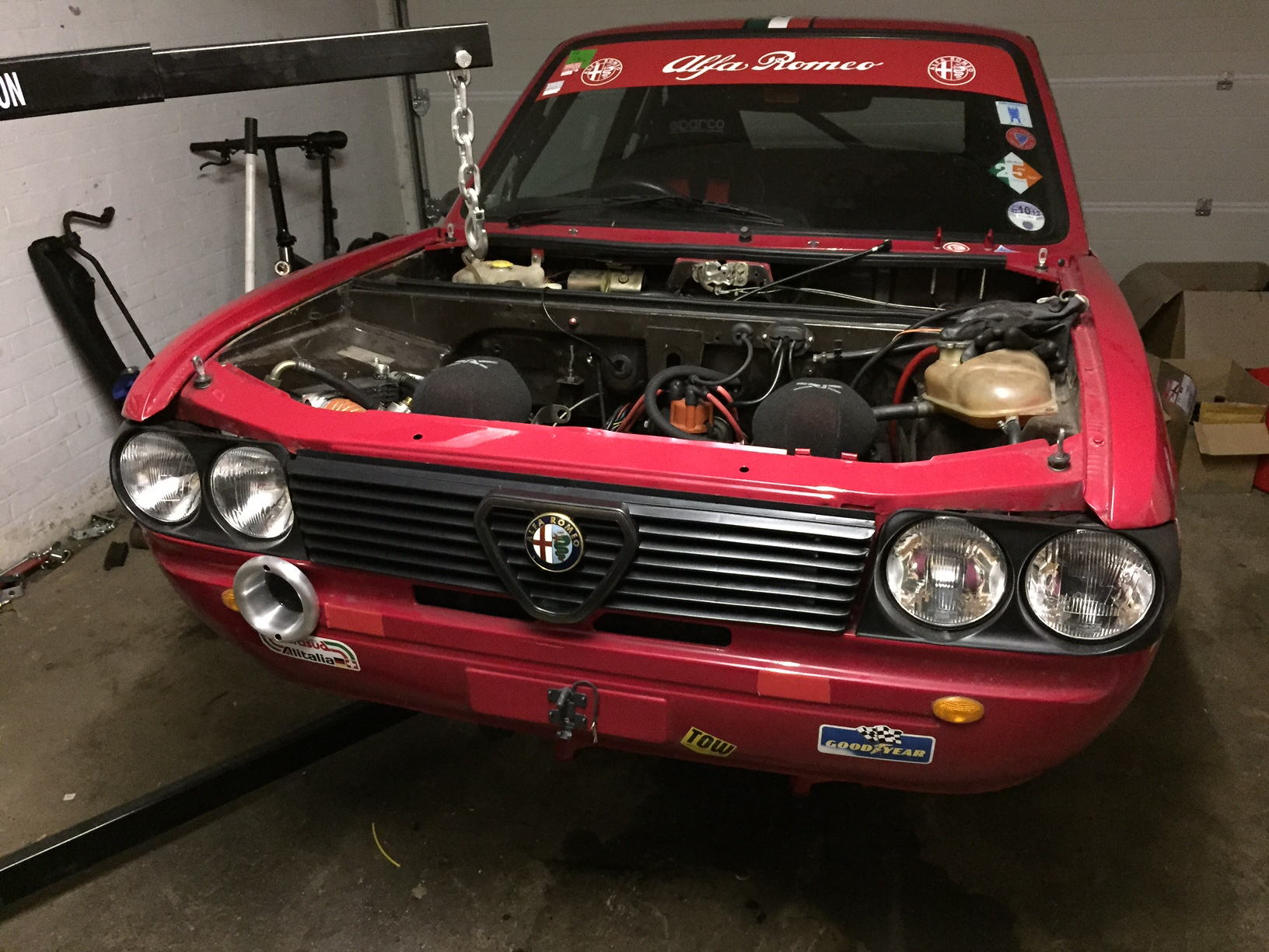

I think that at the minute I am focussing on getting the cars on the track. The Sprint is ready. BLS are sorting the Trofeo and the 1.5 SC is in the garage with the engine going back in after a gearbox change. Tom at BLS took the Quaife LSD out of the old box and put it in the overhauled 1.2Ti gearbox. I fitted the gearbox and lifted the engine back in tonight. I will be trying some Ferodo DSUNO pads. How the hell do you get those for a Sud I hear you ask? You buy pads from Demon Tweeks that are the same height and cut the width to that of the Sud pads.
The light units on the car were S2 backplates with S3 plastic trim and Capri lamp units. They fitted so badly that the car looked quite sad. I got two complete new LHD S3 light front light clusters from a fine gentleman on this website and a new grille from Italy and the car is starting to look much better. It should breathe better now. The exhaust gaskets were not cut to fit the larger exhaust ports and the intake trumpets were fitted with one stud and were offset and impeding flow. The carbs were stripped and an overhaul kit fitted as well as drilling and tapping for a new stud for each trumpet. New trumpets (shiny!) and new piper intake filters.
- Posts: 976
Re: CTCRC Classes for Alfasuds
Looking much prettier.

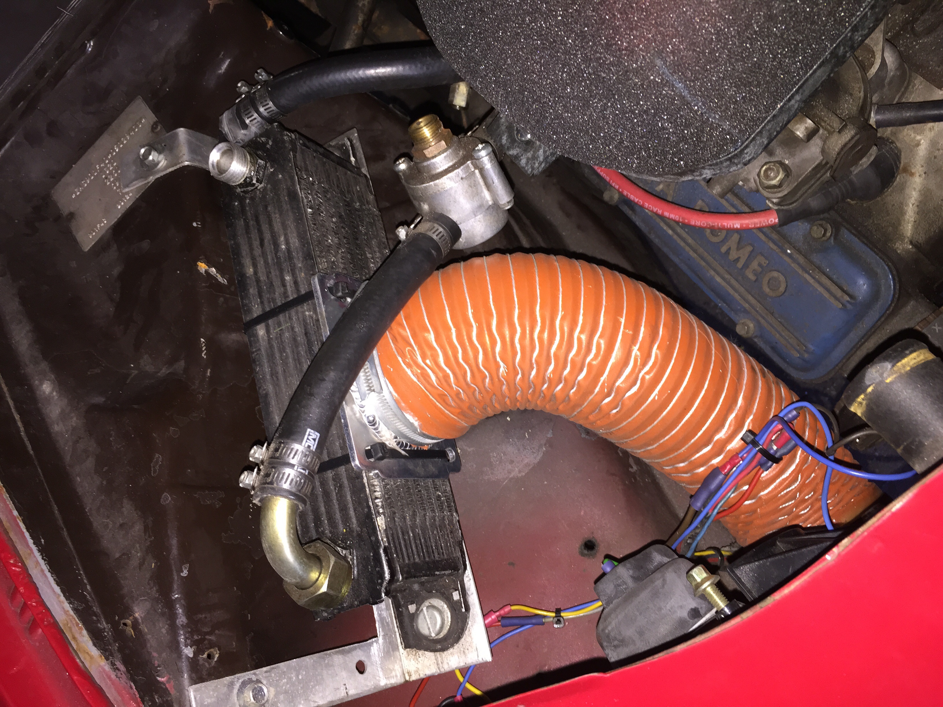

Good to see you are getting the SC back together - what is the intake trumpet in the front panel feeding?

The intake at the front is air to the oil cooler. Not my setup. I inherited it.
