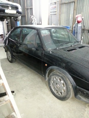

I'm sure most of you already know the story of my Sud...

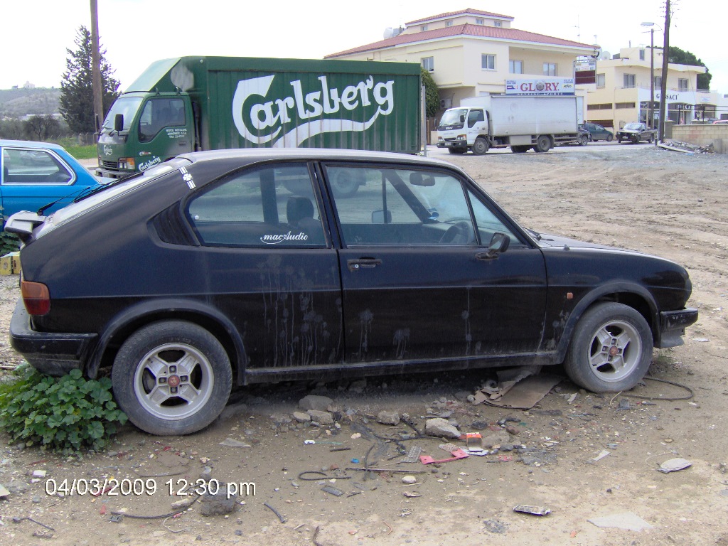

To cut a long story short, I'll create this thread by putting down the facts, so here goes:

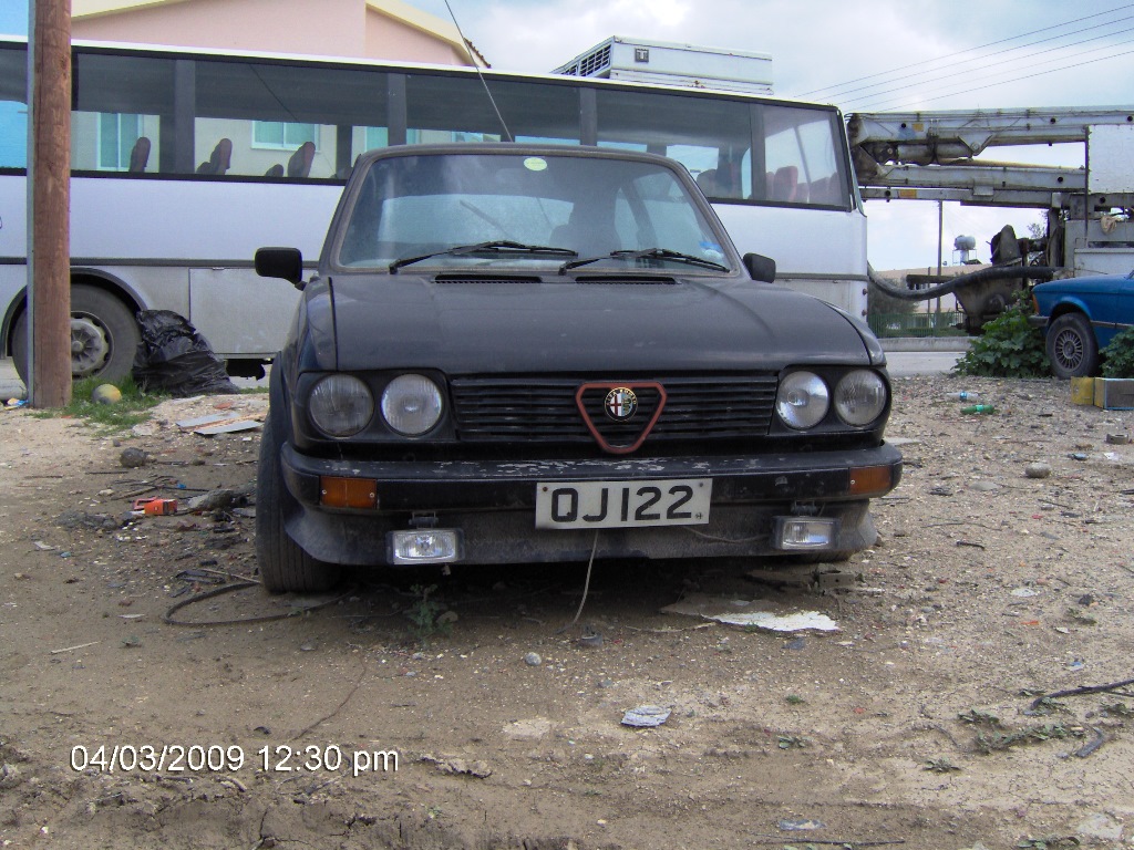

1 - Kev put me up to it and I found one luckily
2 - It was abandoned outside an electricians shop because they couldnt get it going
3 - Car had issued papers to get scrapped, so I paid the owner the amount he would get for scrapping it and bought it
4 - Went to tow the car home, found out that it had diesel in the tank rather than petrol, so towed it 200metres to the petrol station, filled it up, fired it up and drove home.

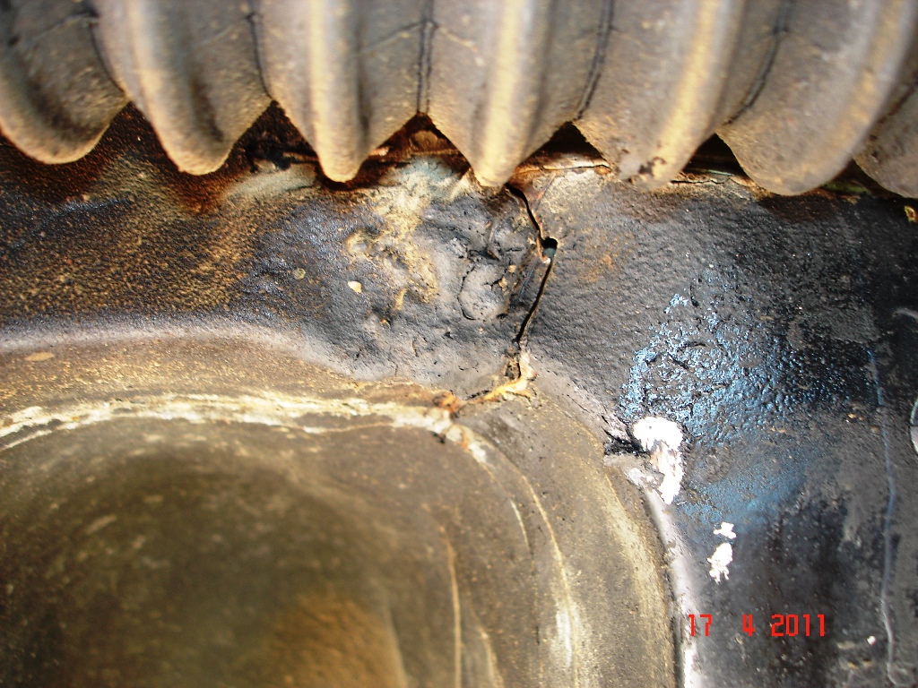

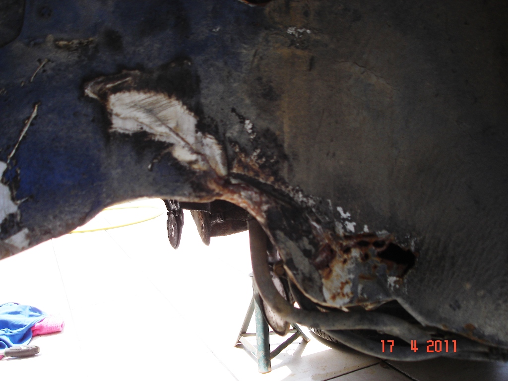

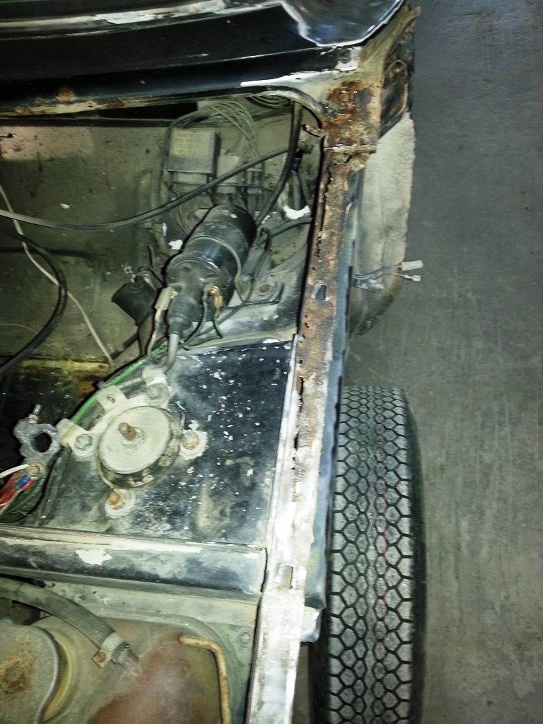

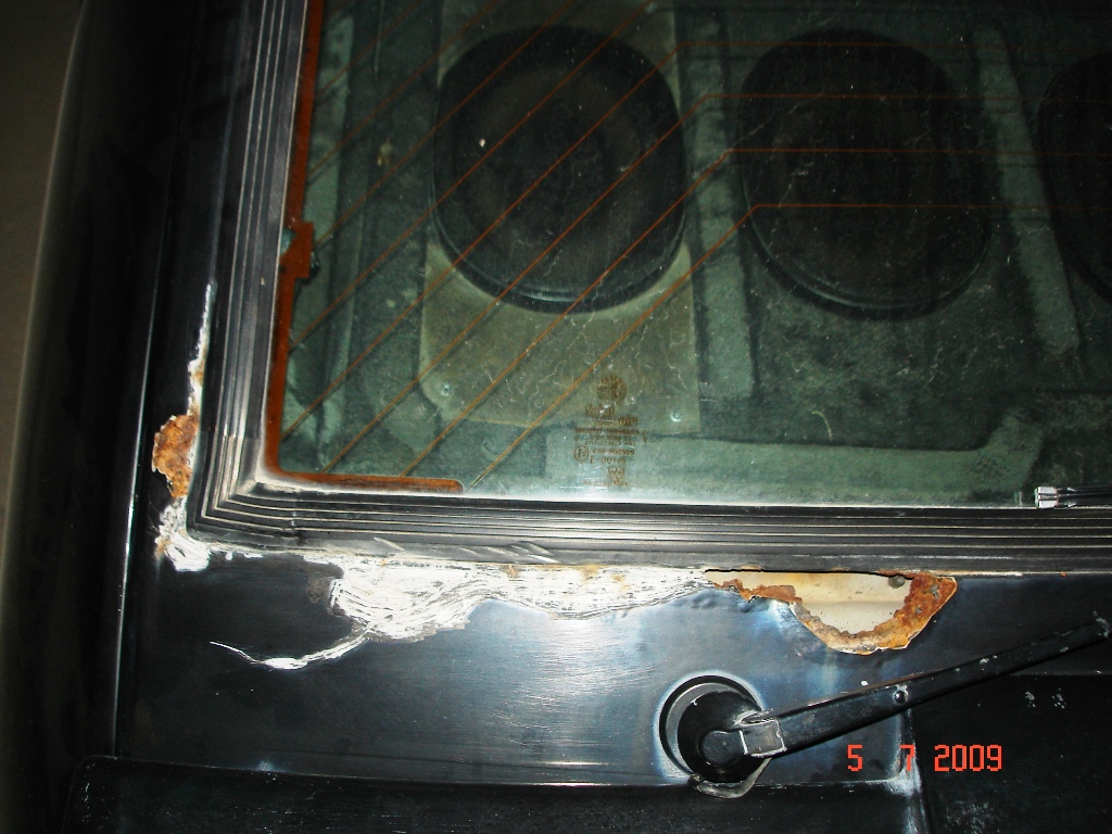

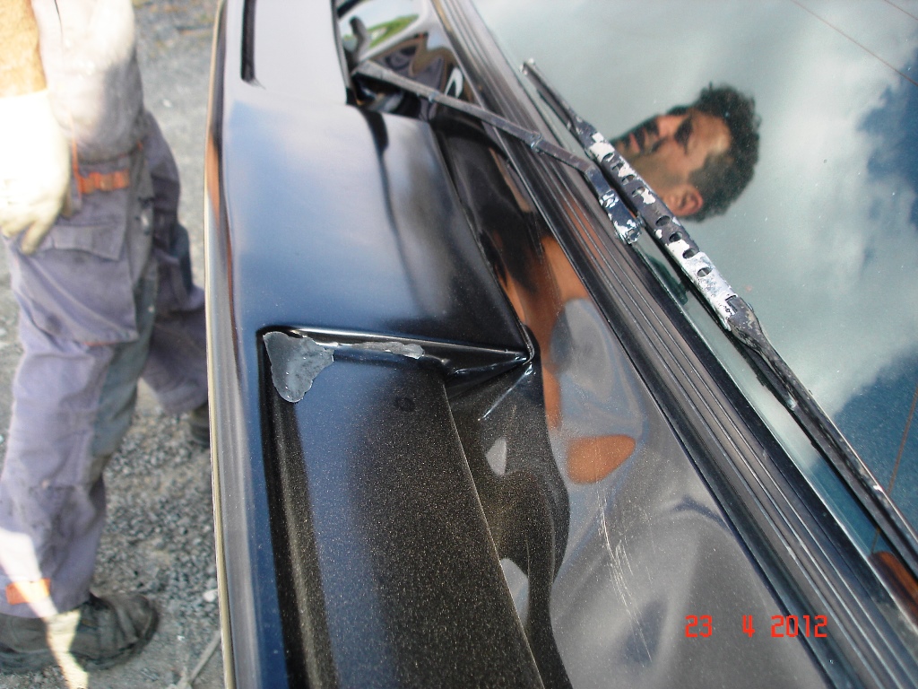

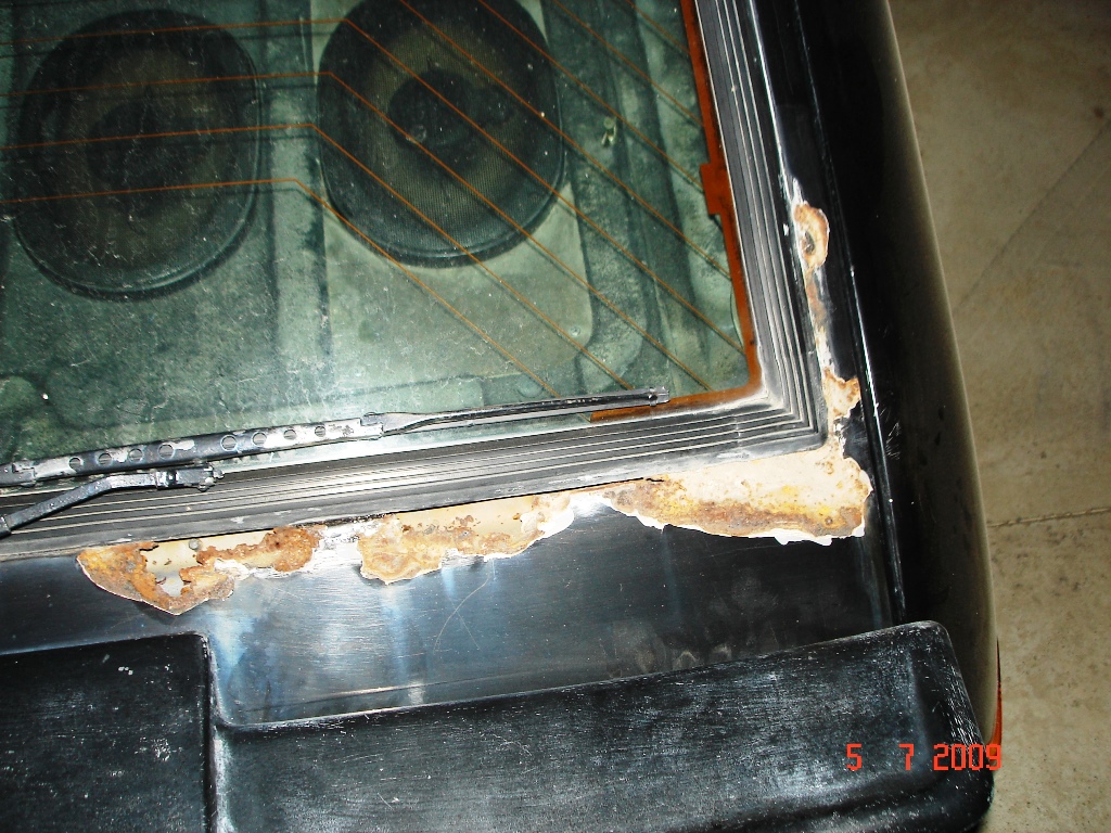

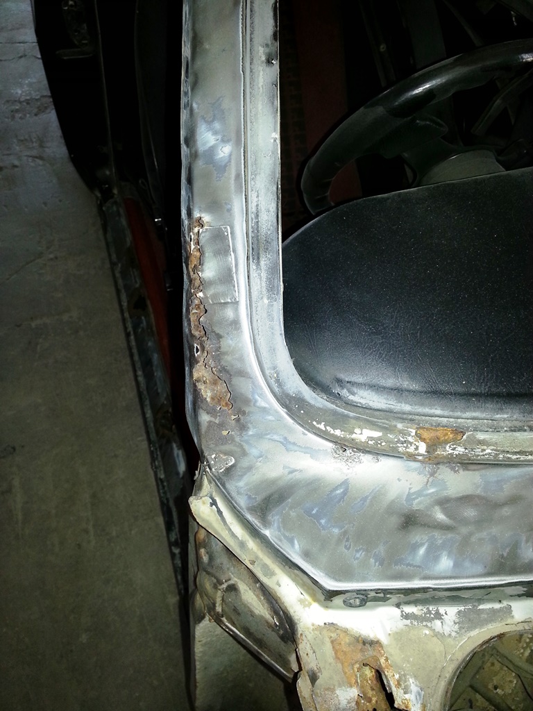

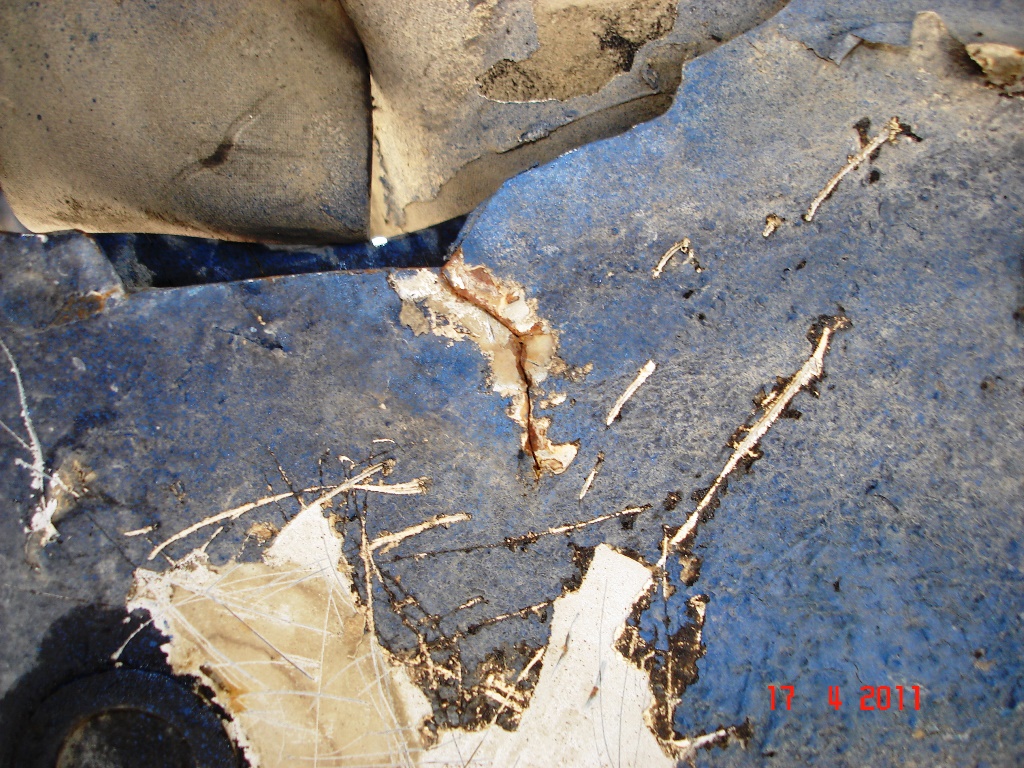

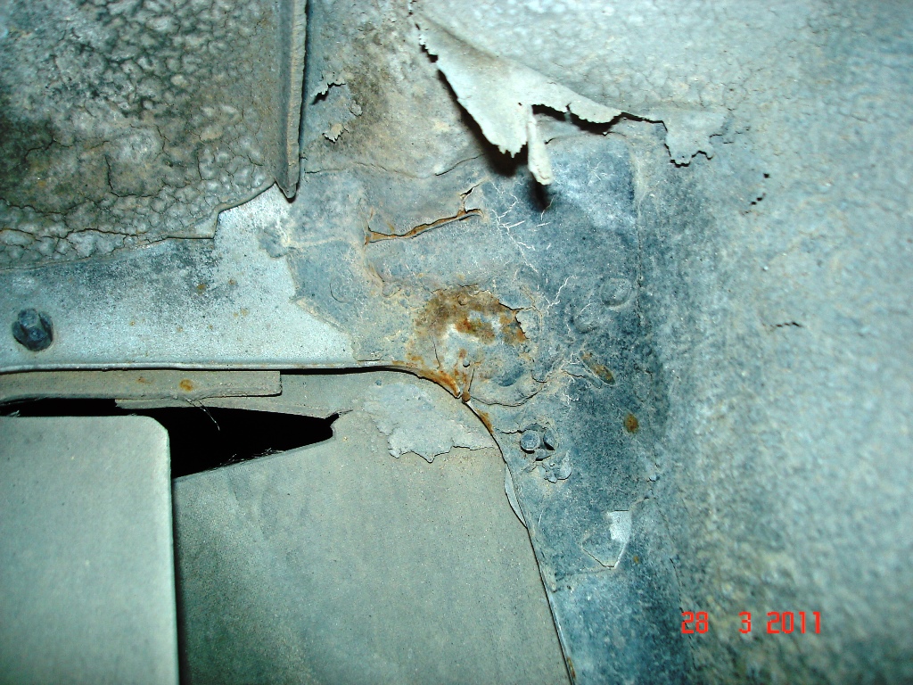

Soon after, I started looking for panels and focusing on the bad areas of the car

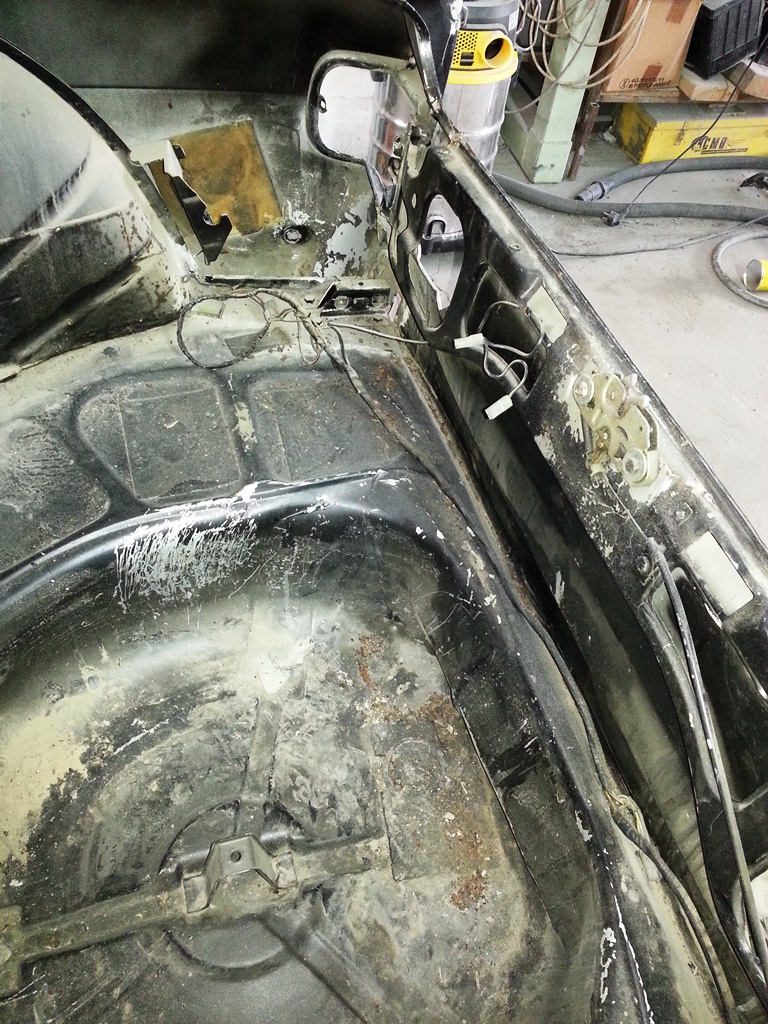

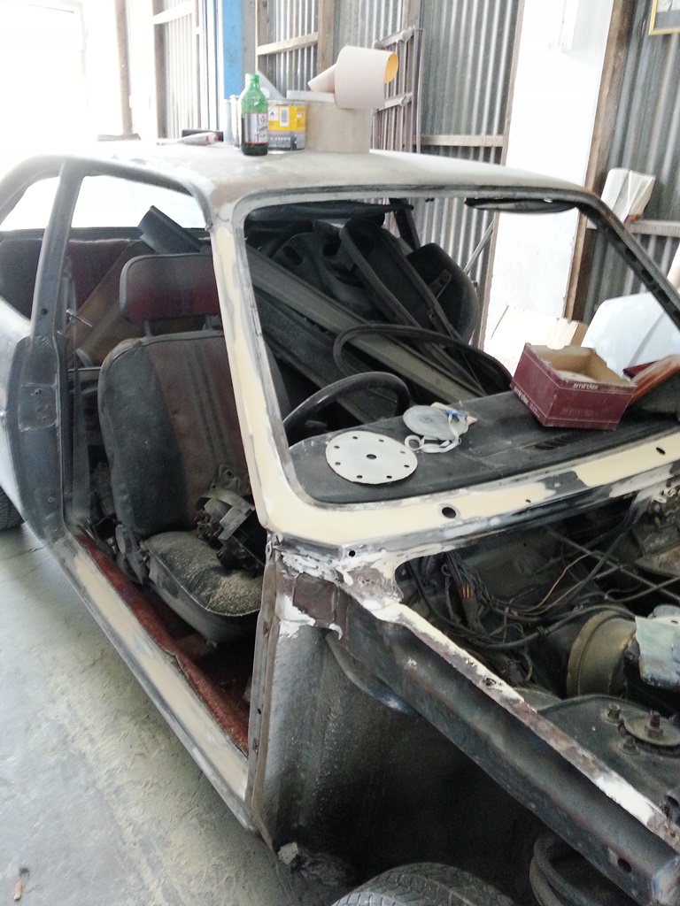

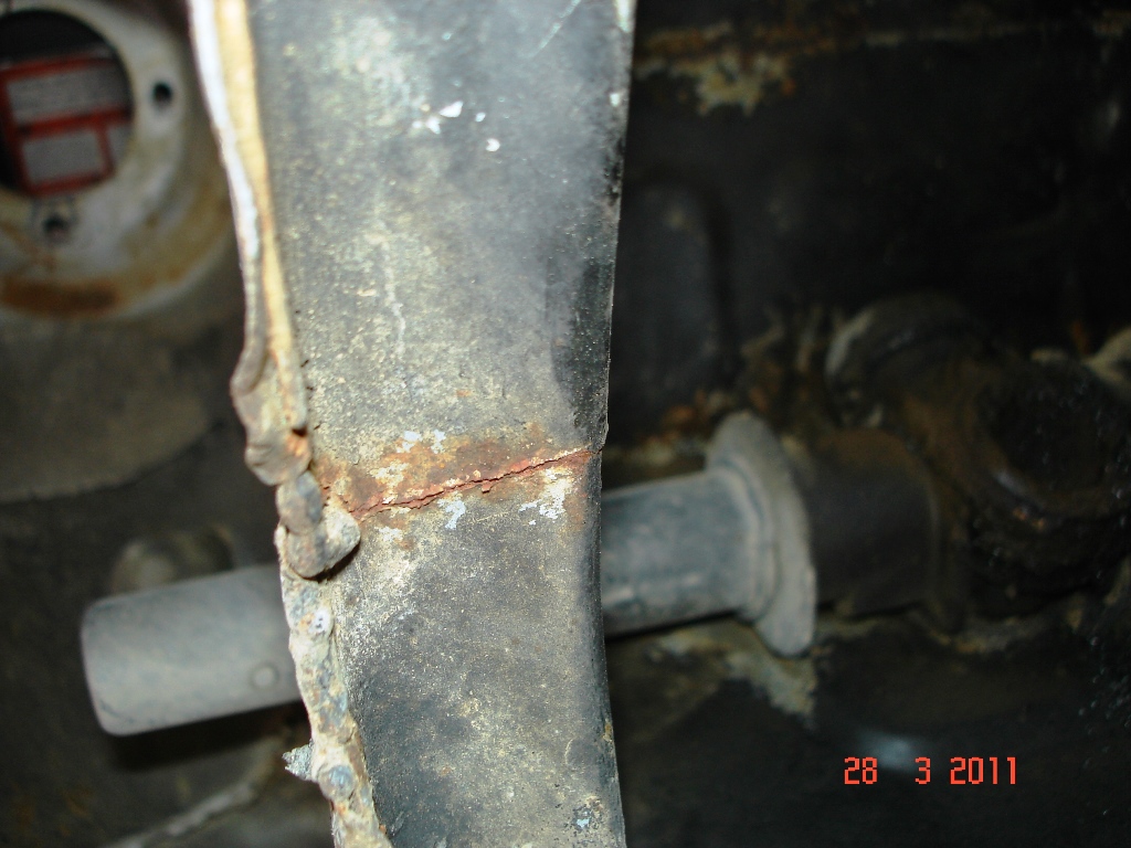

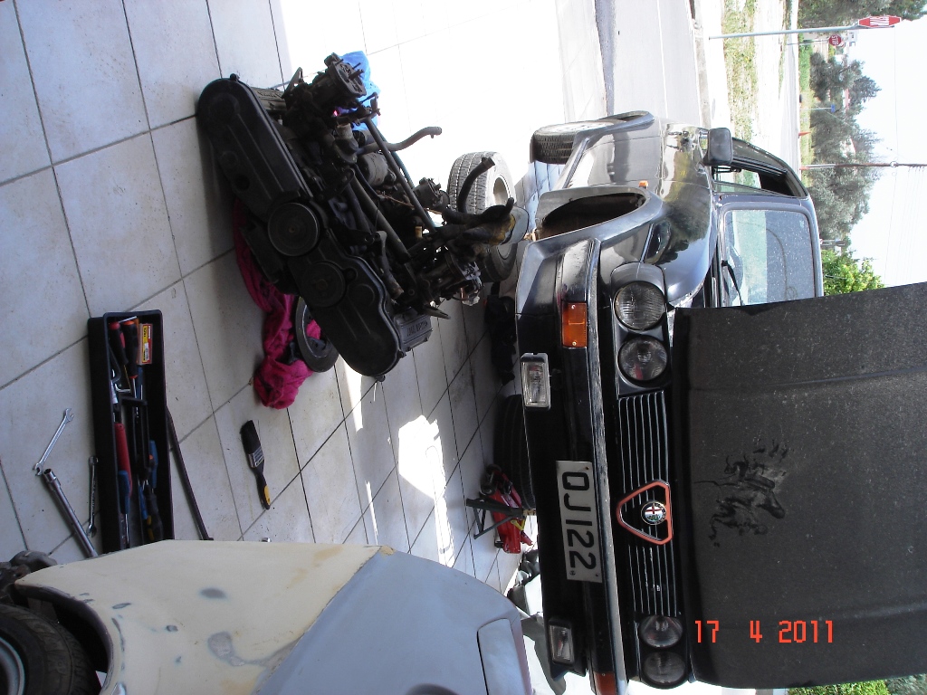

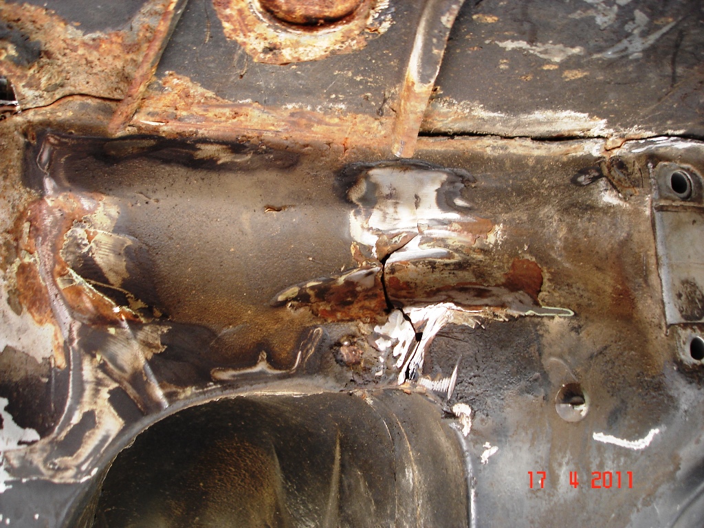

The engine was no good, so had to swap it with a good one I had.
Engine removal revealed other goodies

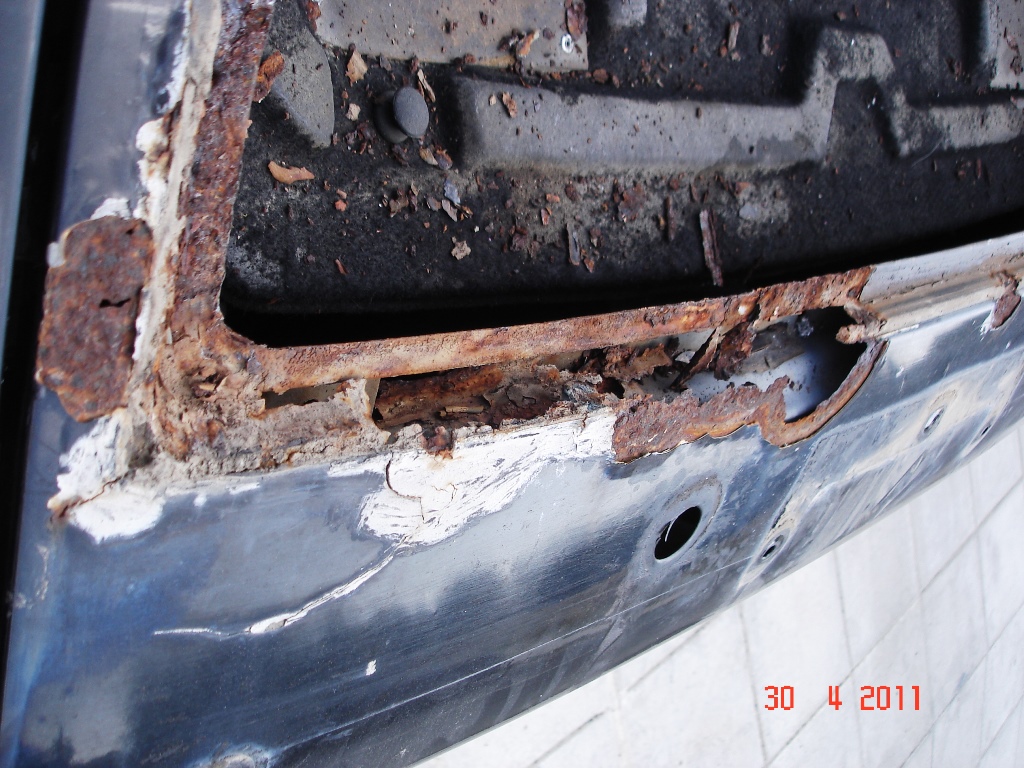

By that time it had been long enough, so I thought I'd start fixing some stuff before the restoration could begin.

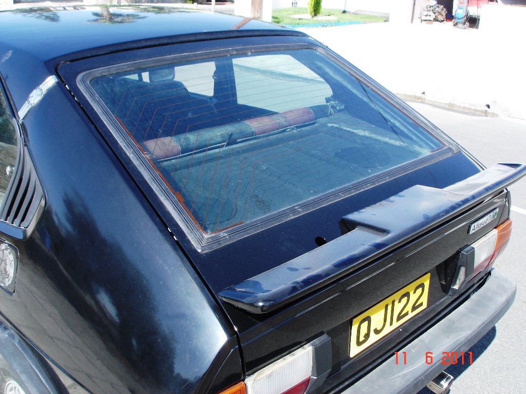

Changed the rear hatch to a good enough used one I bought from Mark in UK, changed the front bonnet to a perfect condition used one I found locally, and rebuilt the front calipers while I was at it, so I could pass it through MOT and tax it

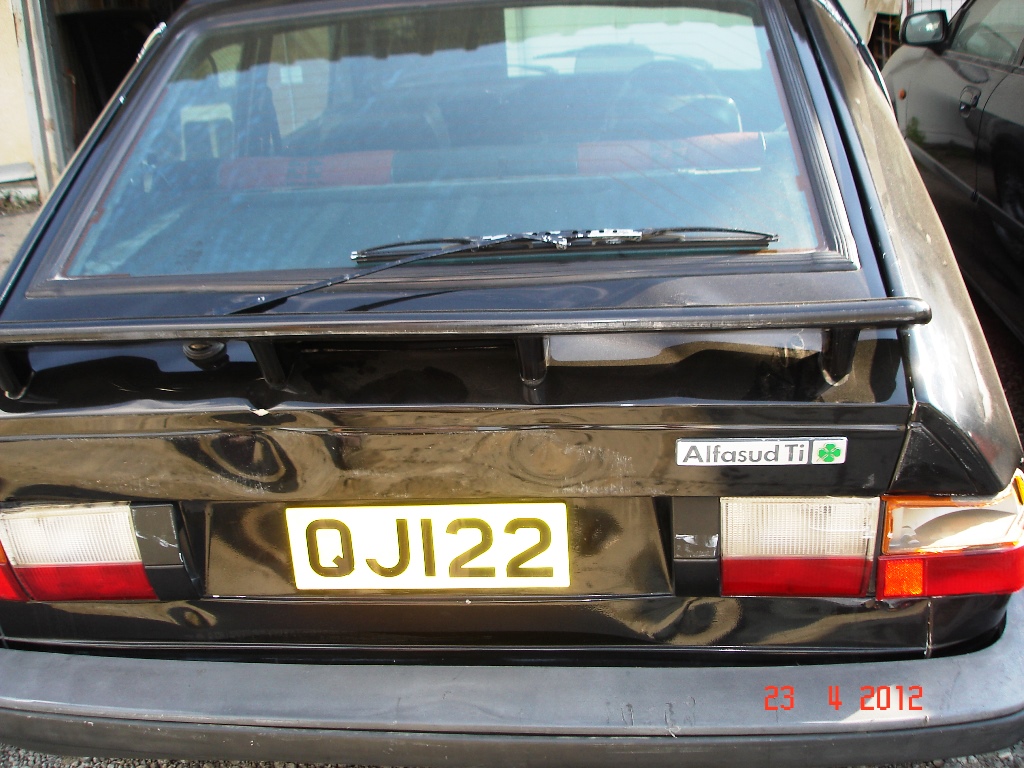

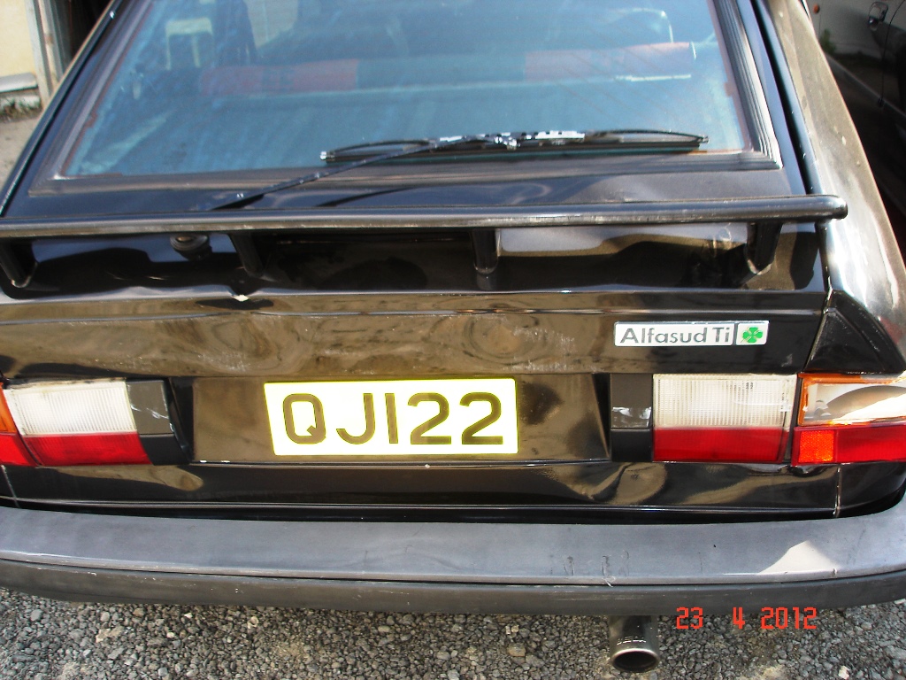

Then, just when I was about to start using it - already used it at a trip we had we the club and I was trying to fix the suspension- I got rear ended by a butcher's truck (literally)... putting my poor SUD in a TOTAL LOSS status from the insurance company...
I asked for the car to be listed as "Salvage" so they paid me 400 euros for the damage
and if I wanted I could pay the rest to get it fixed if possible

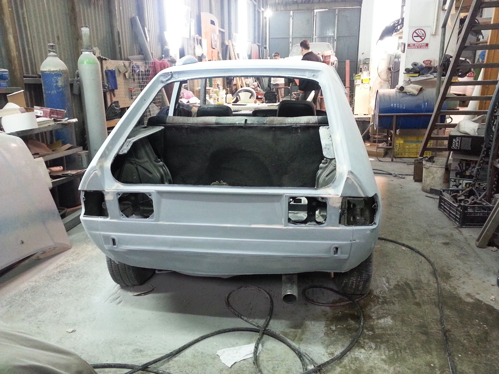

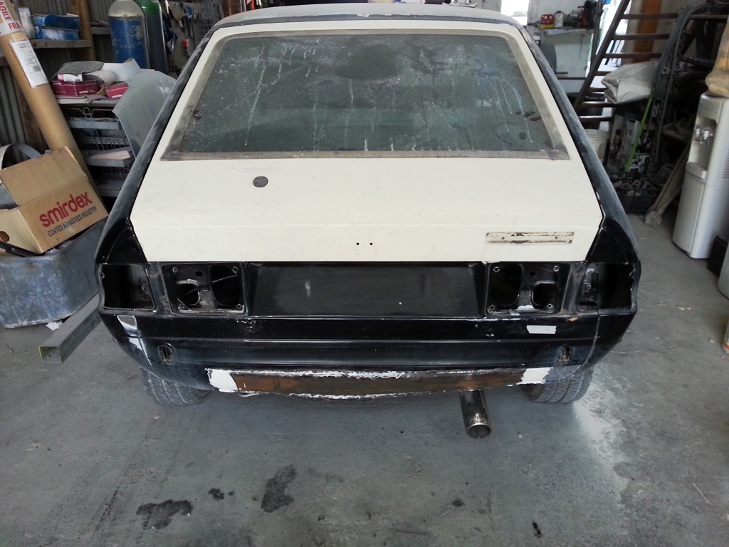

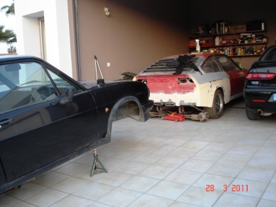

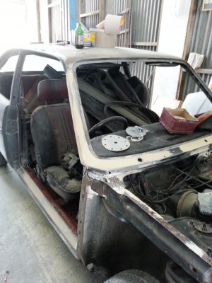

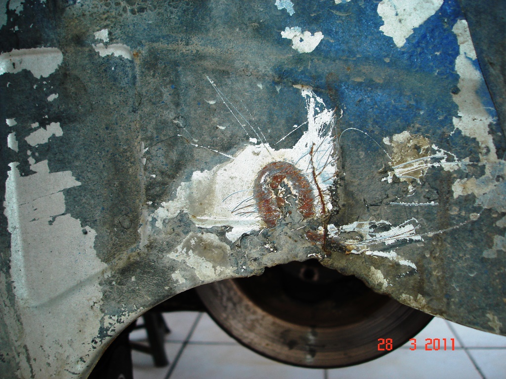

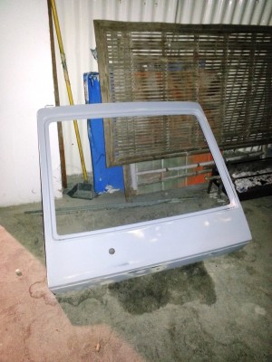

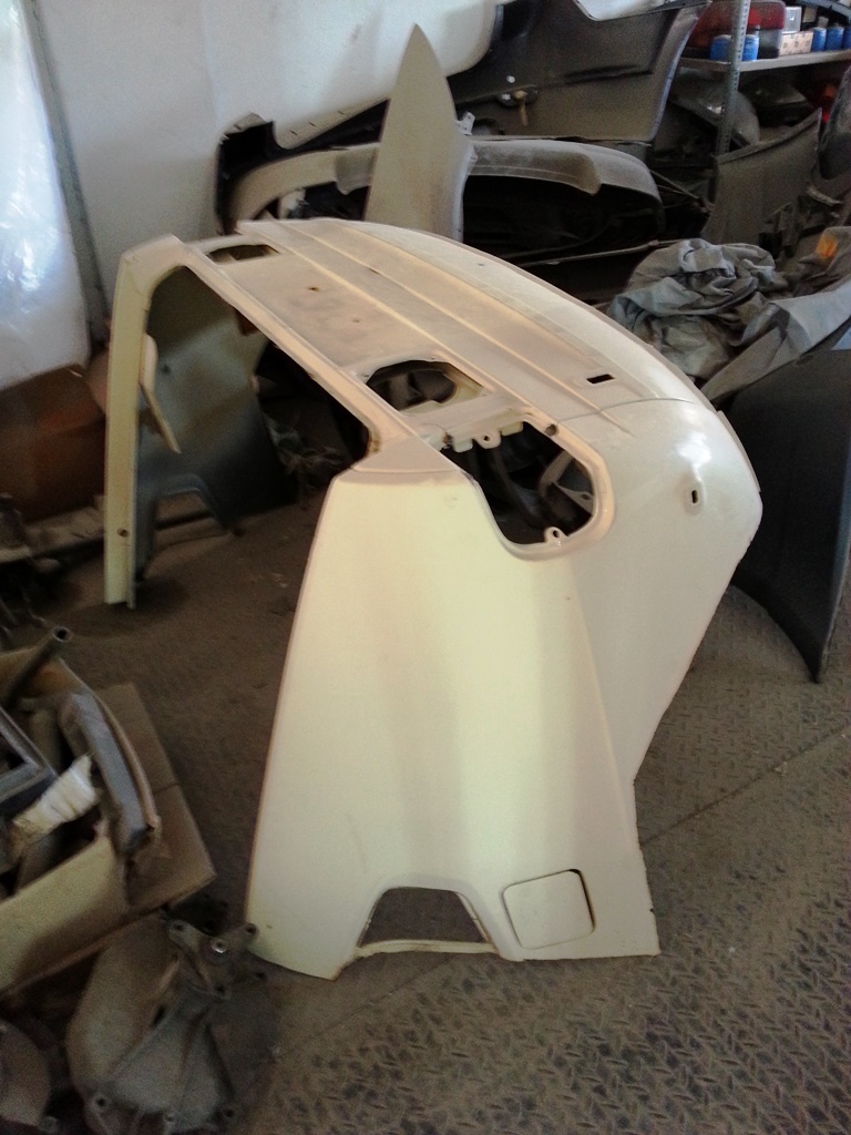

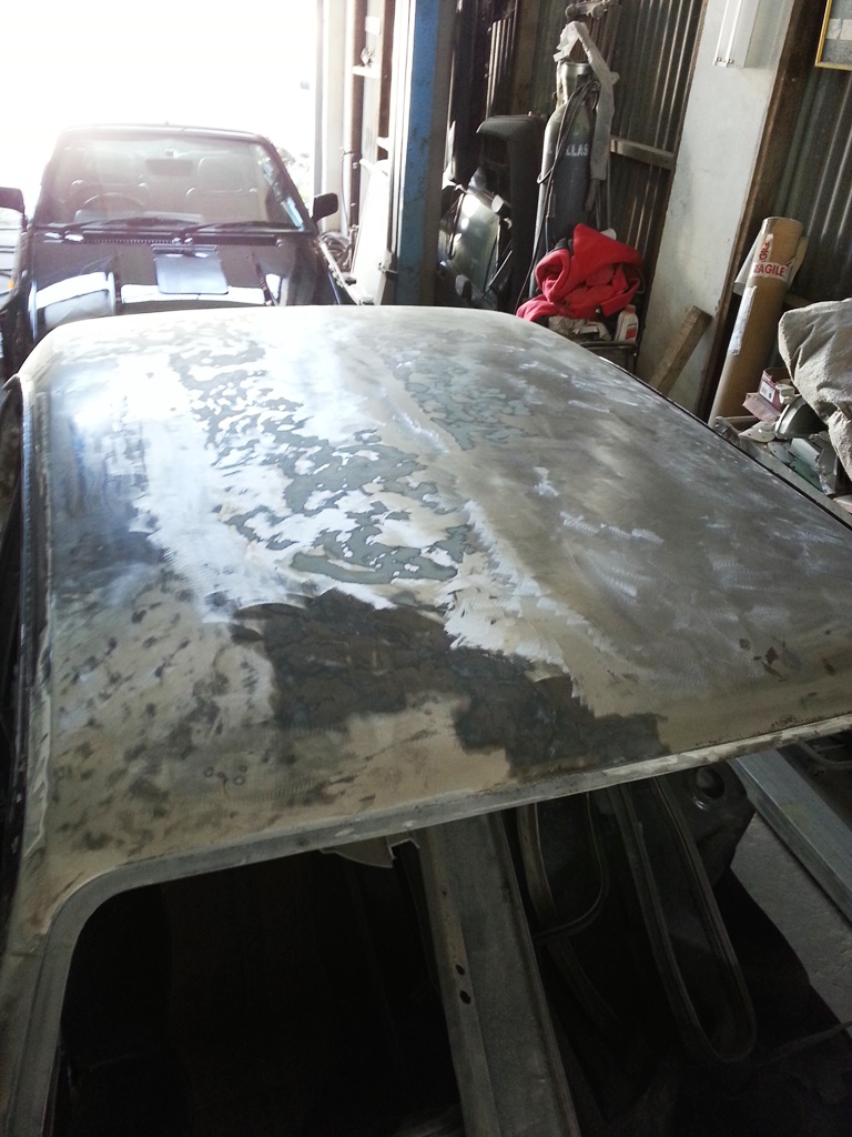

Took it to my friends Mario's body shop, where we started to fix it and fix it good this time...
A donor Sud was most welcome, although a 4 door S2, the parts I needed were there.
New rear spoiler from Jan as well as some front lights
Rear hatch from donor Sud
Rear end from donor Sud
Wheel arch repair kits from UK

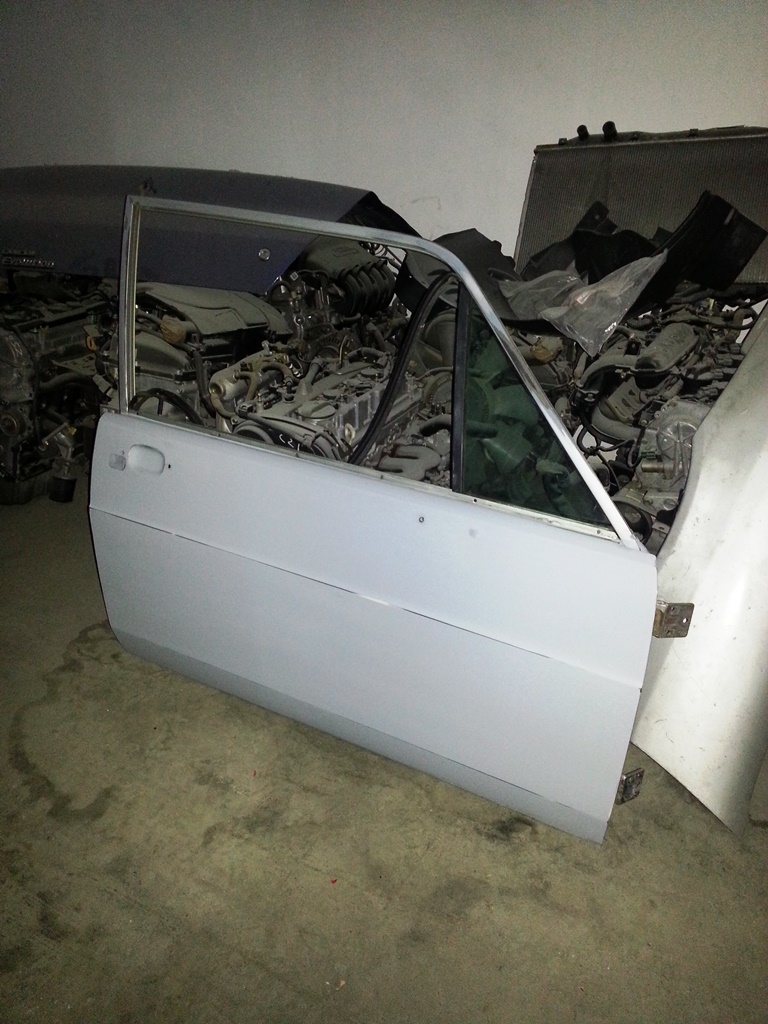

Front doors from old stock locally before they threw everything for scrap metal

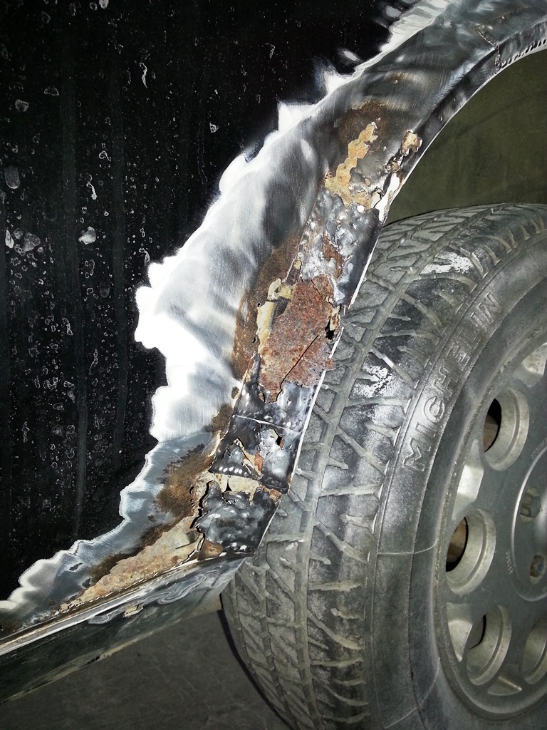

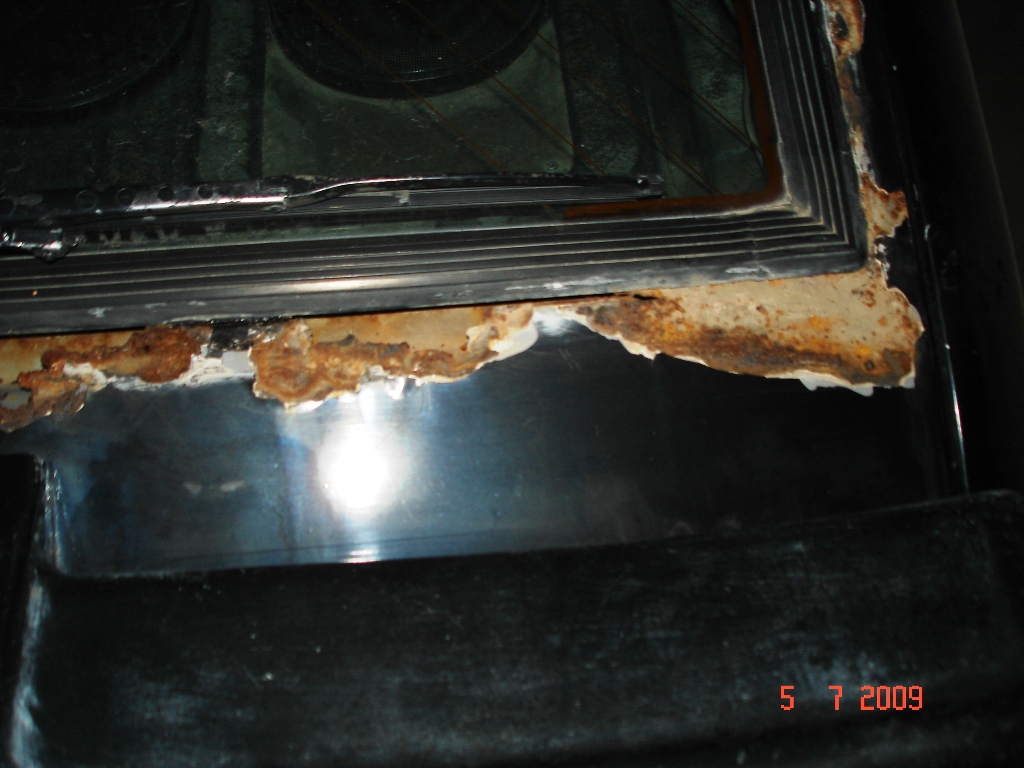

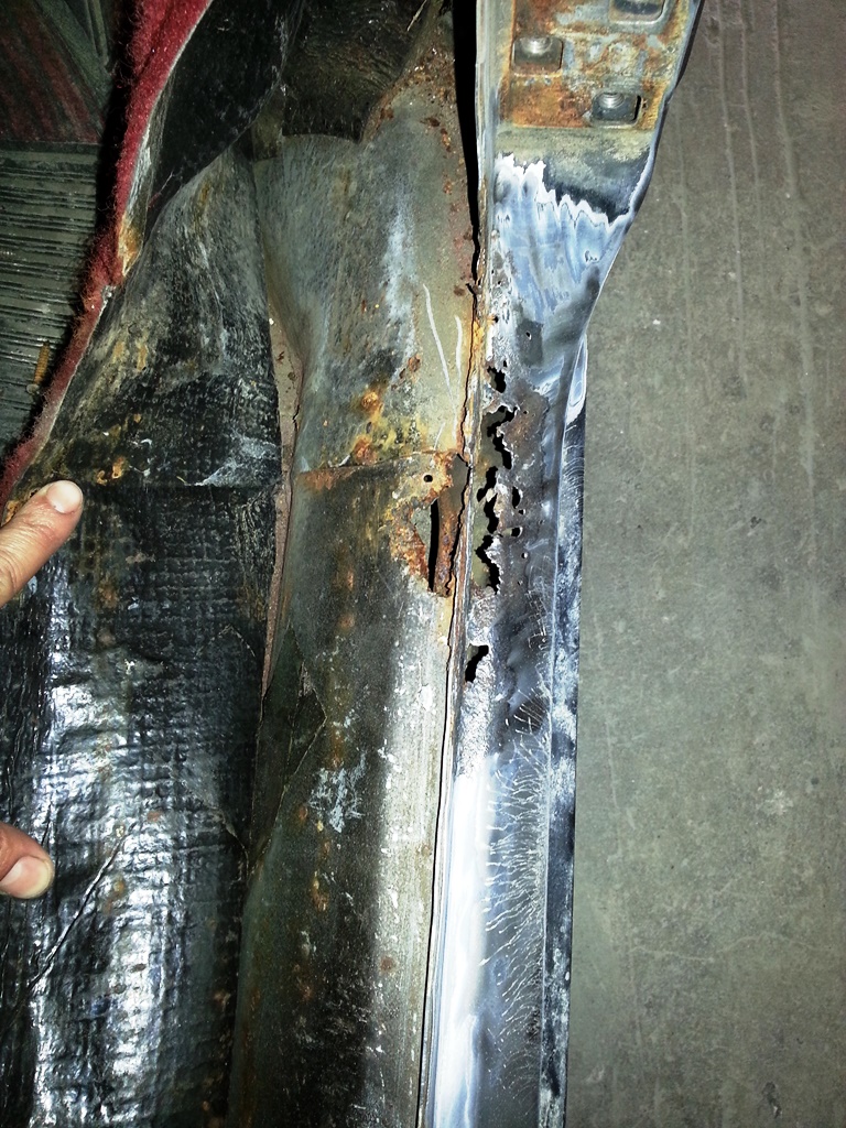

Removing the paint and stripping the car, would you believe it ? I found some more issues with it :p

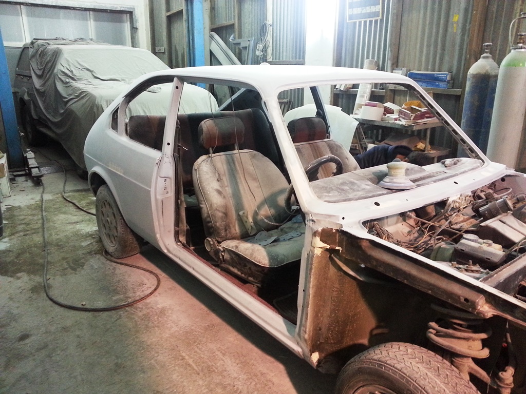

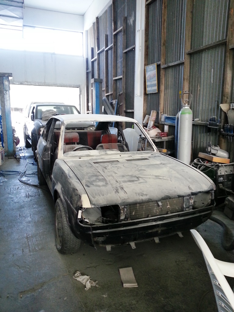

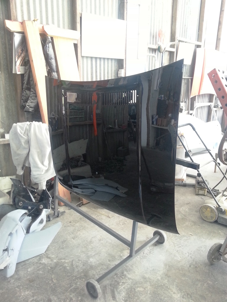

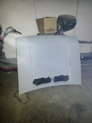

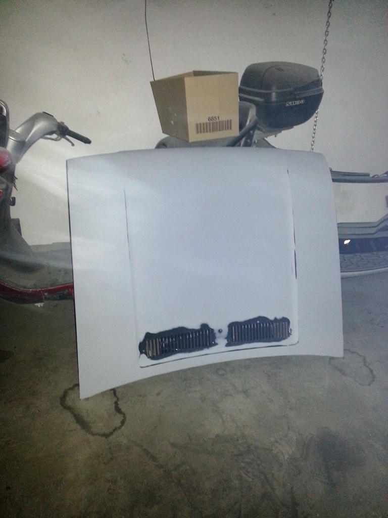

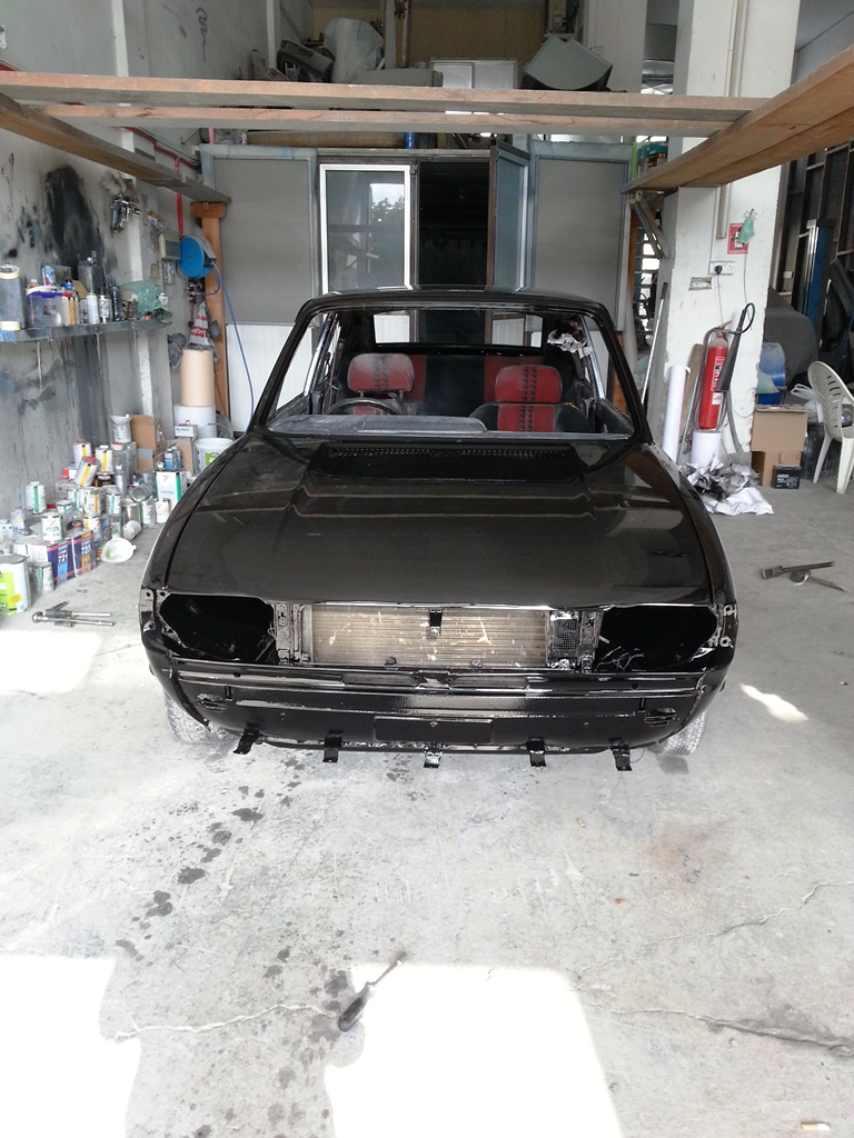

Two years after the crash it started to show some actual progress
2 front wings added to the new parts, galvanized reproduction ones from Italy
Doors, wings, rear hatch, rear spoiler, front bonnet to be painted today
Rest of the car to be painted on Thursday

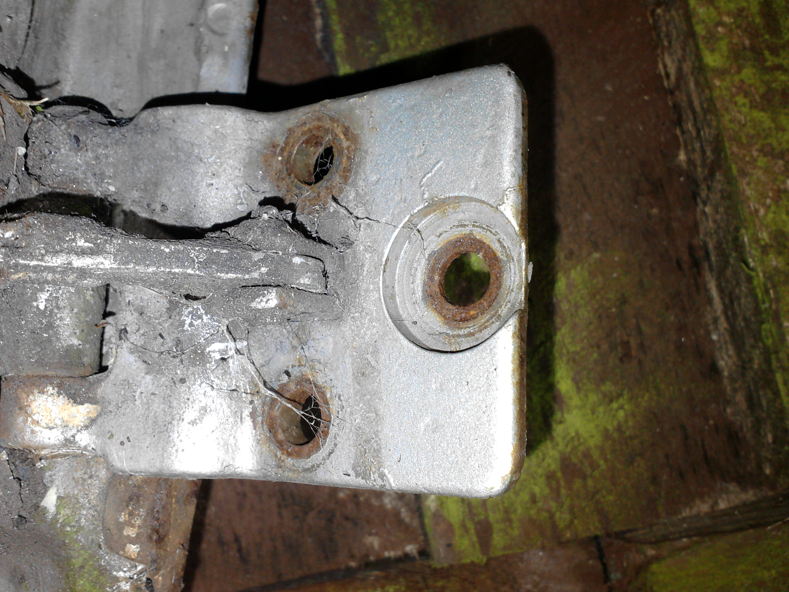

Speaking of which ... does anyone know where I can get those secure clipping nuts which are used to bolt the front wings on ?
Also, are the door hinge bolts the cone type allen key ones like the Sprint ? or Hex ?

later suds had hex bolt heads for the door hinges, early ones had the tapered/allen key type ones. guess that if your hinge brackets have a flat or concave mount will tell which you need

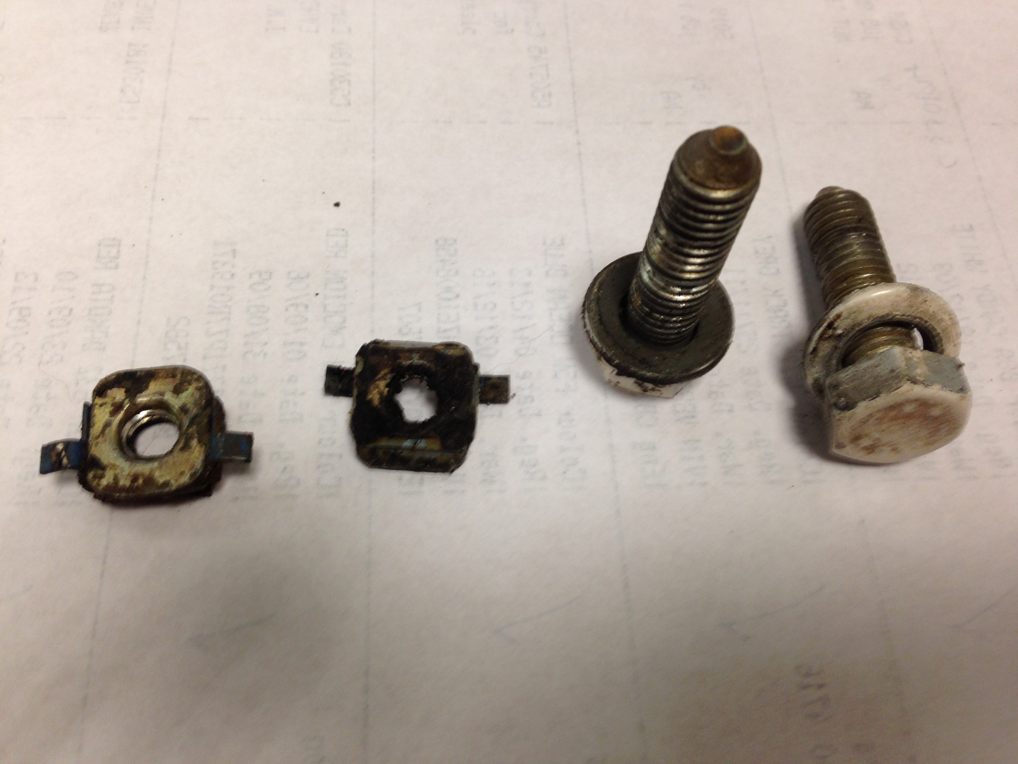

Here is a picture of the wing mounting captive nuts and the door hinge bolts The captive nuts were still available new from Alfa - came in a packet of 10 but not too expensive when I last ordered them - they are used in a few other places in the Sud as well - rear wiper motor fixing,inner door armrest fixing
The door hinge bolts are just a standard 13mm head bolt

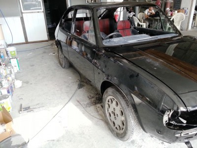

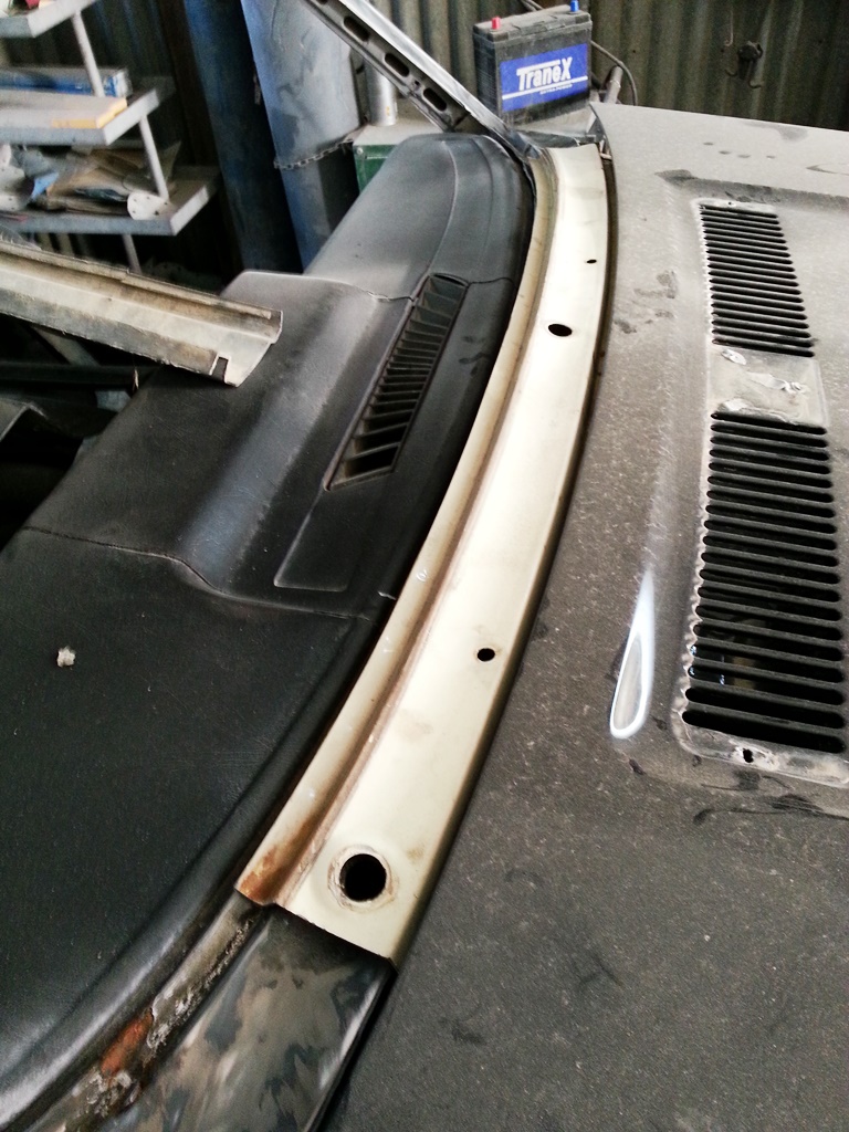

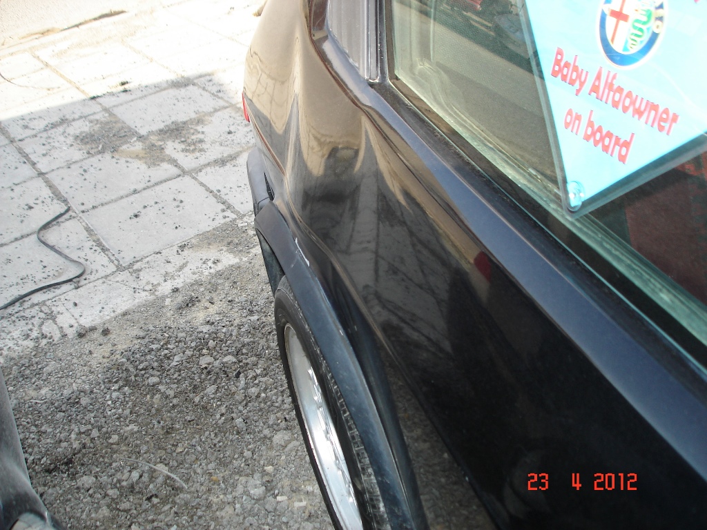

Re: Me Sud

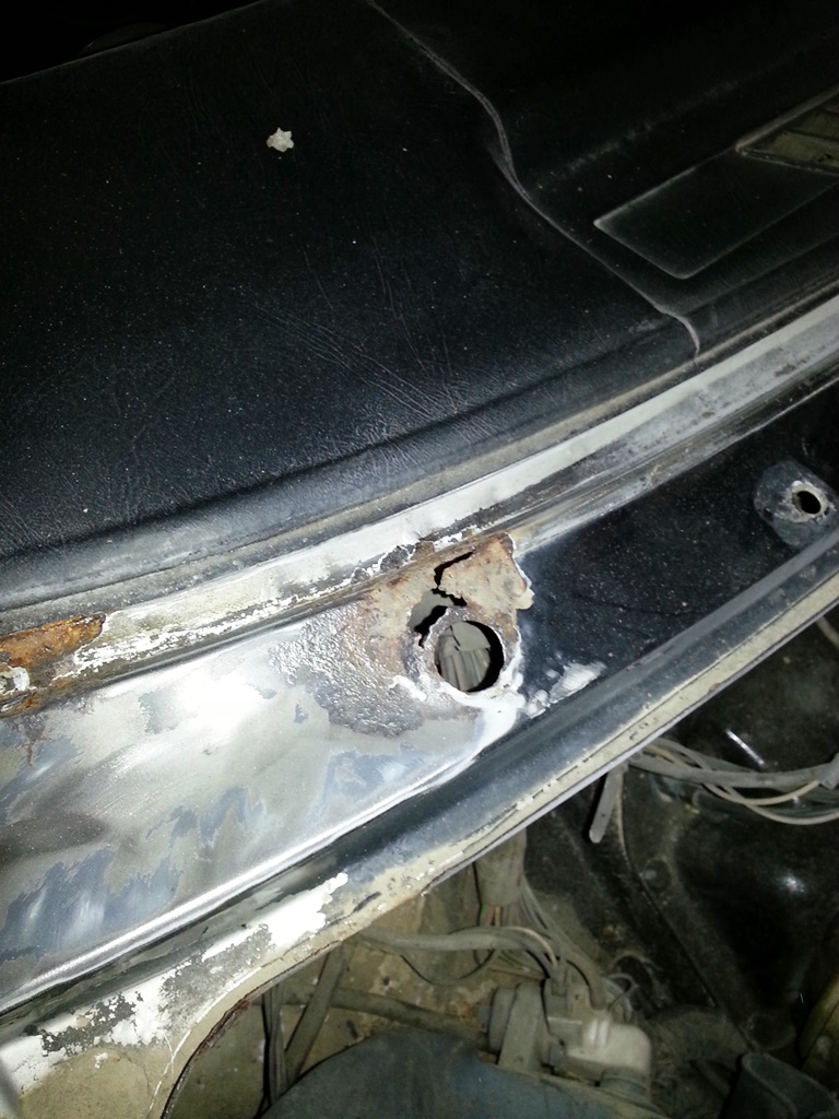

Bad News:

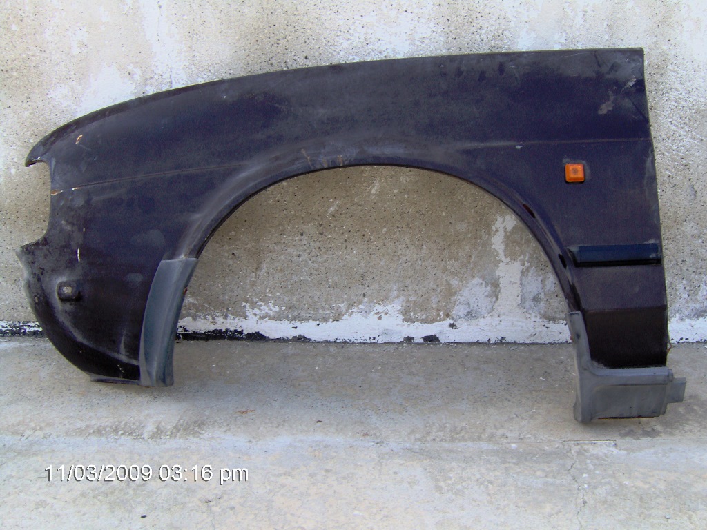

Someone forgot to close up those holes from a different version of the SUD. This is getting off again and painted again tomorrow without the holes of the trim.
Interesting news ? :
Well whats interesting to know is that the new galvanized aftermarket wings that are currently in the market, are 5mm shorter than the genuine ones
Neither I or Mario noticed this when test fitting the panels on the car prior to painting them.
Now that we were fitting the doors and wings etc, the front right wing would not align to the edge of the bonnet.
If you pushed it forward to match, the gap between it and the drivers door was massive.
So I left that with Mario to play with the door and wing and split the difference so its not that noticeable.
Not a tragedy, but good thing to have in mind in case you are buying aftermarket front wings
Re: Me Sud
Looking very nice mate
Re: Me Sud
paint job looks great mate, shame about the holes
Re: Me Sud
Black is the way forward . Looks great
Re: Me Sud
Just because its yours Chris,
Its poo!
Mario wants his bumps bumping a bit more into a lump!
Terrible paint, the panels are crap, you should stick to Sprints, leave the proper cars to us blokes!
Hows that for a pep talk?
Now stop whining about a little hole and a few millimetres, and get the best car you own sorted.
Ok mate
