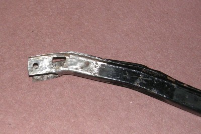

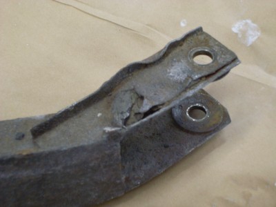

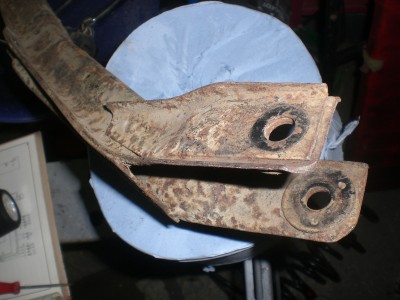

Hi all, quite a large bang last night as I pulled away from an island, followed by a bit of a wobble and bit of metallic noise, limped the last mile home and just had a look in daylight... drivers side transverse arm has snapped! Ouch. Wheres the best place to get one, and is it a feasible diy job? Or is it a get part and then take to garage. I guess bushes are my concern.

do you mean the main lower suspension arm? stick a picture up so we can see, one of us will have one at hand for sure, I have probably got one although it would probably need rebushing
Re: Help! suspension snapped!
Not pretty!!!

that's a real weak spot on the front suspension, i've seen many that are badly corroded there, ones just waiting to snap like that.
as far as i can see from the ones i've taken off they are not sided so that's one good thing, i will most likely have a useable spare in the shed if you need one.
going to the pint & pizza meet thursday evening? i could have a look and bring one along...
as a bit of a heads up to all sud/sprint/33 owners it's probably a good idea to check yours over over the winter

I appreciate you need to fix the old girl, but if one has gone could be worth checking the other side.

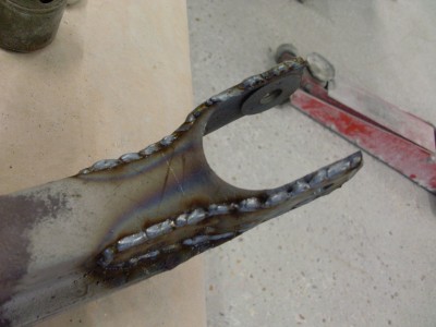

I beef'd mine up with plug and seam welded plate.

Hi guys, cracking upgrade and great story! I have checked the other one, it is in good condition and seems to have extra strengthening strakes along it? An upgrade perhaps, will have a really close look when I change the other one.

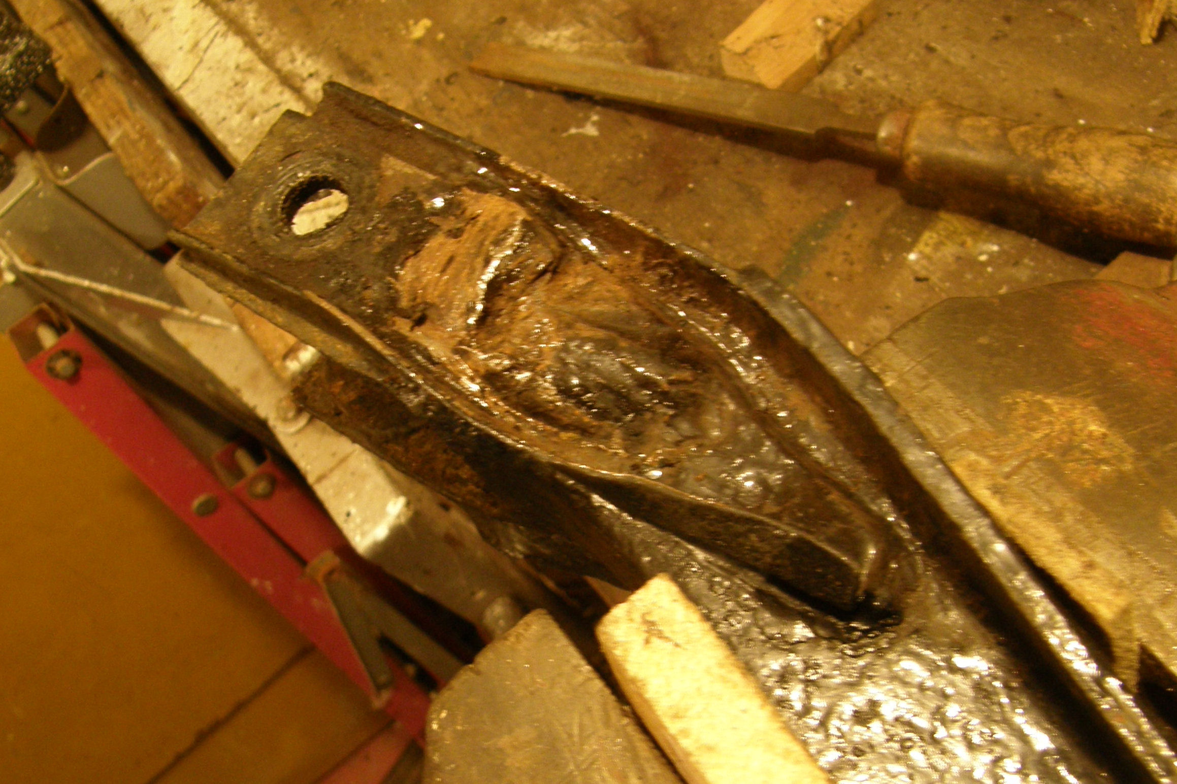

Well, mine's not as bad as Chris's disaster but while working on the front suspension I noticed the swelling on the offside transverse arm.
So whipped it off and after a bit of work with the angle grinder I've got a hole!
It's off at a mates now for welding.
Should be up and running again next week!
Rob

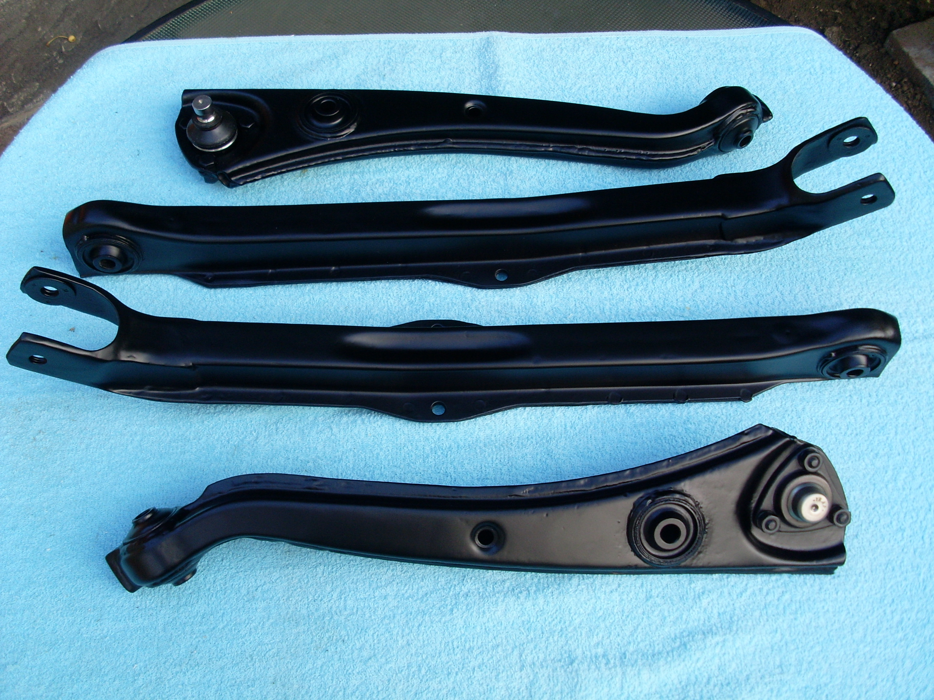

If folk are finding that these arms are now becoming a certain age to start becoming a problem, maybe its time for a bit pf preventative refurbishment?
I've already sorted a set of my own, by shotblasting, welding up, and then powder coating, and i'm confident they'll last another 30 years at least!
Nice to know that there is a strong set of arms under me, i certainly wouldn't want a failure mid corner!
