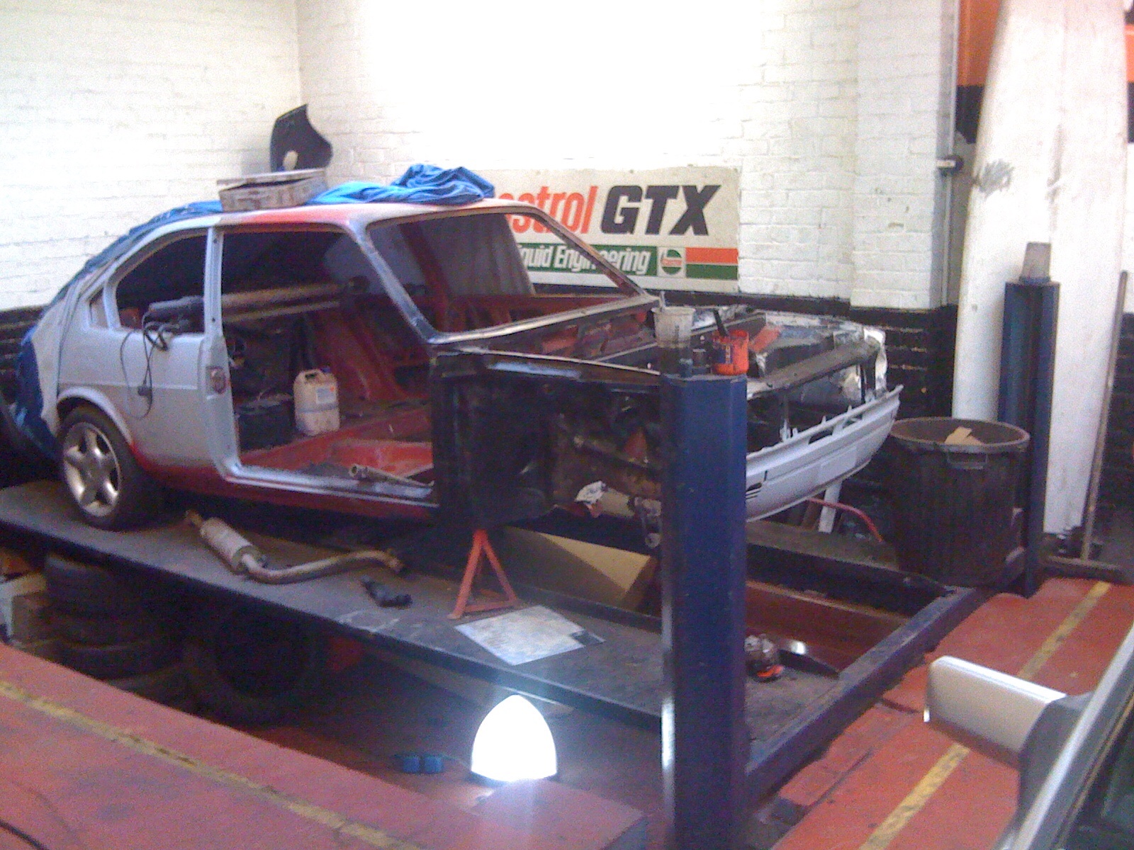

I've had my Sud since I was 18 and had it on the road for about 6 years in that time I rolled it so had to but on a section of roof and restored it then . I took it off the road to do some welding and repaint it I got all the welding done and bare shell it but children came along and car went to bottom of the pile of things to finish . I finally got work to let me use spare ramp so most lunch breaks and odd evening are put to good use .

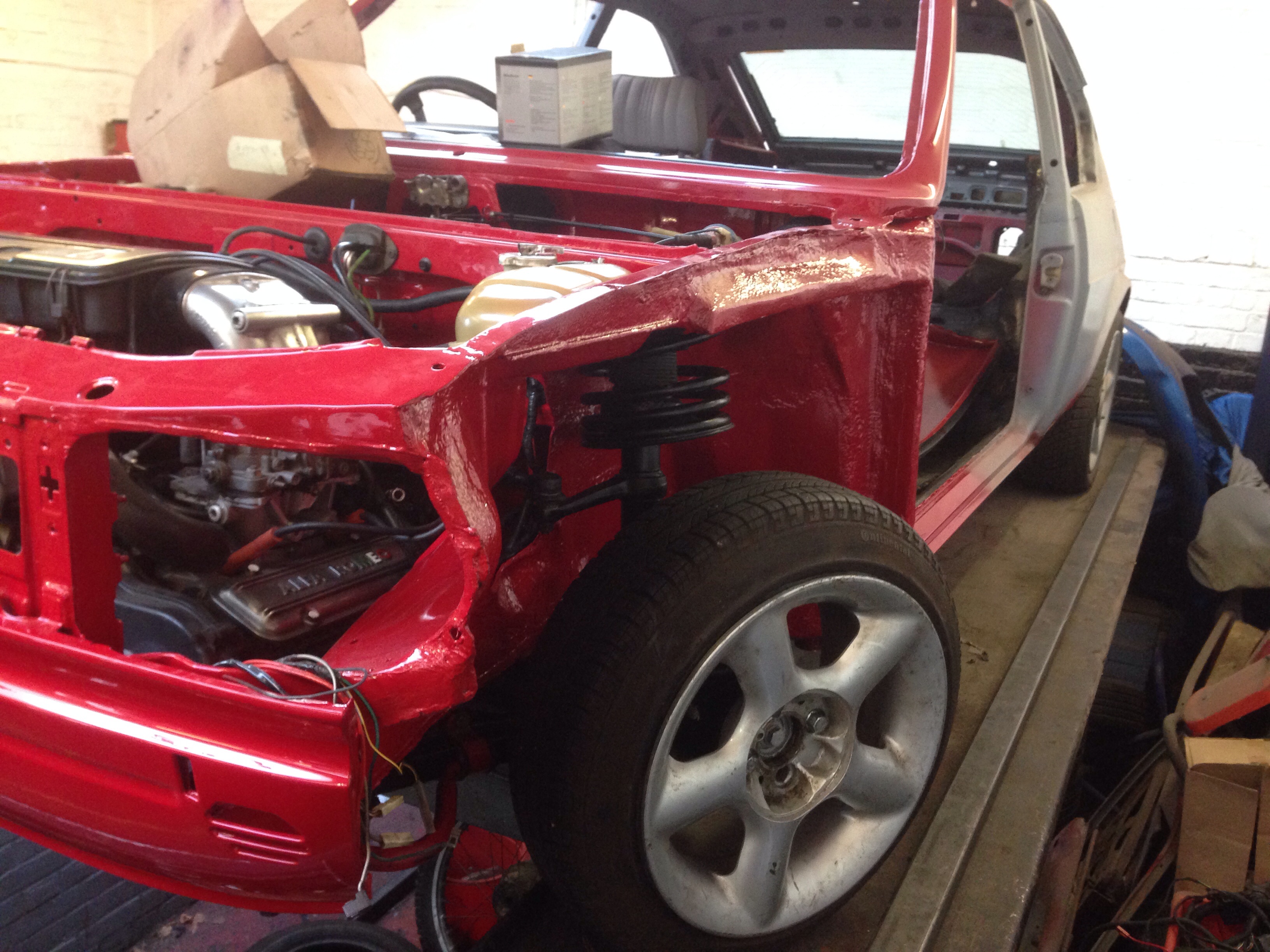

Post by Simonsud »
Today's progress back on its wheels it has taken me a couple of attempts to get the springs and top mounts right I stripped both sides and painted them forgot they are handed when I put them back together but I did have a nice surprise in finding I had koni adjustable inserts they came from a sprint I had for spares I only used them because they felt stiffer than all the others I had

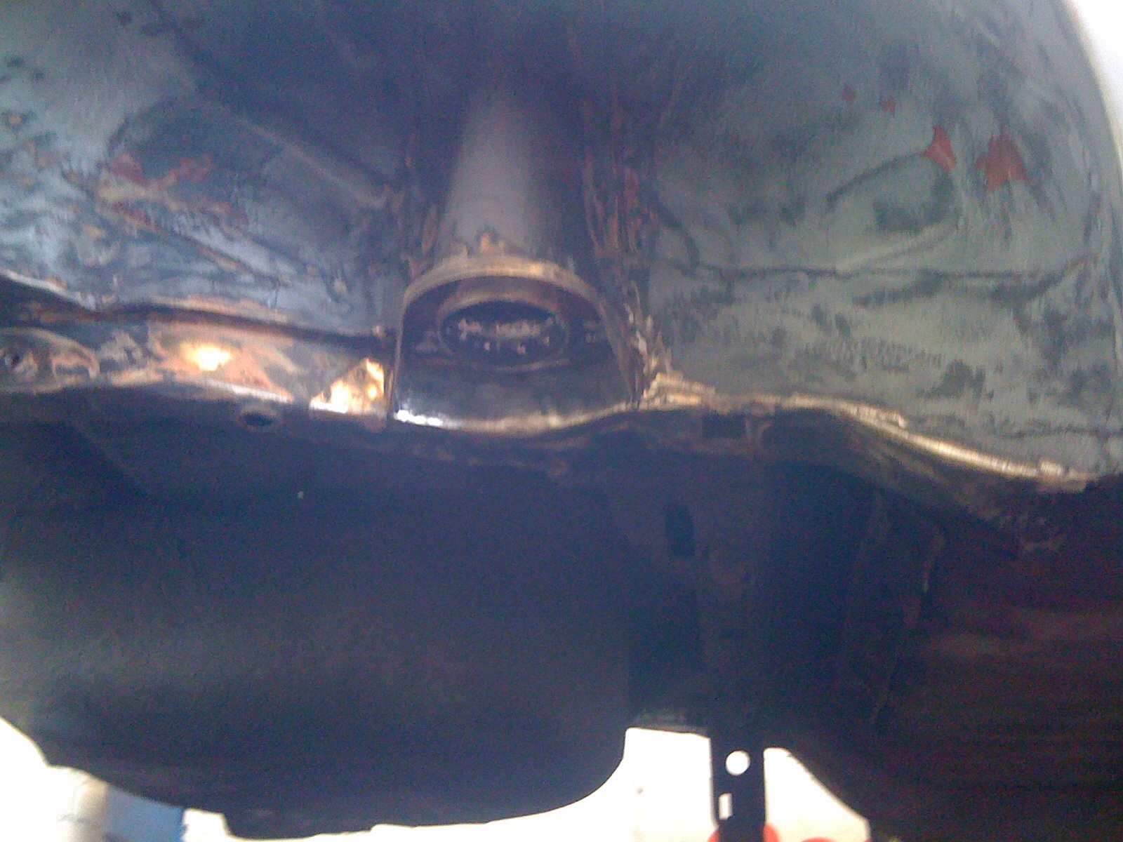

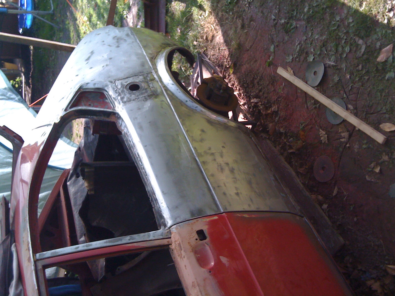

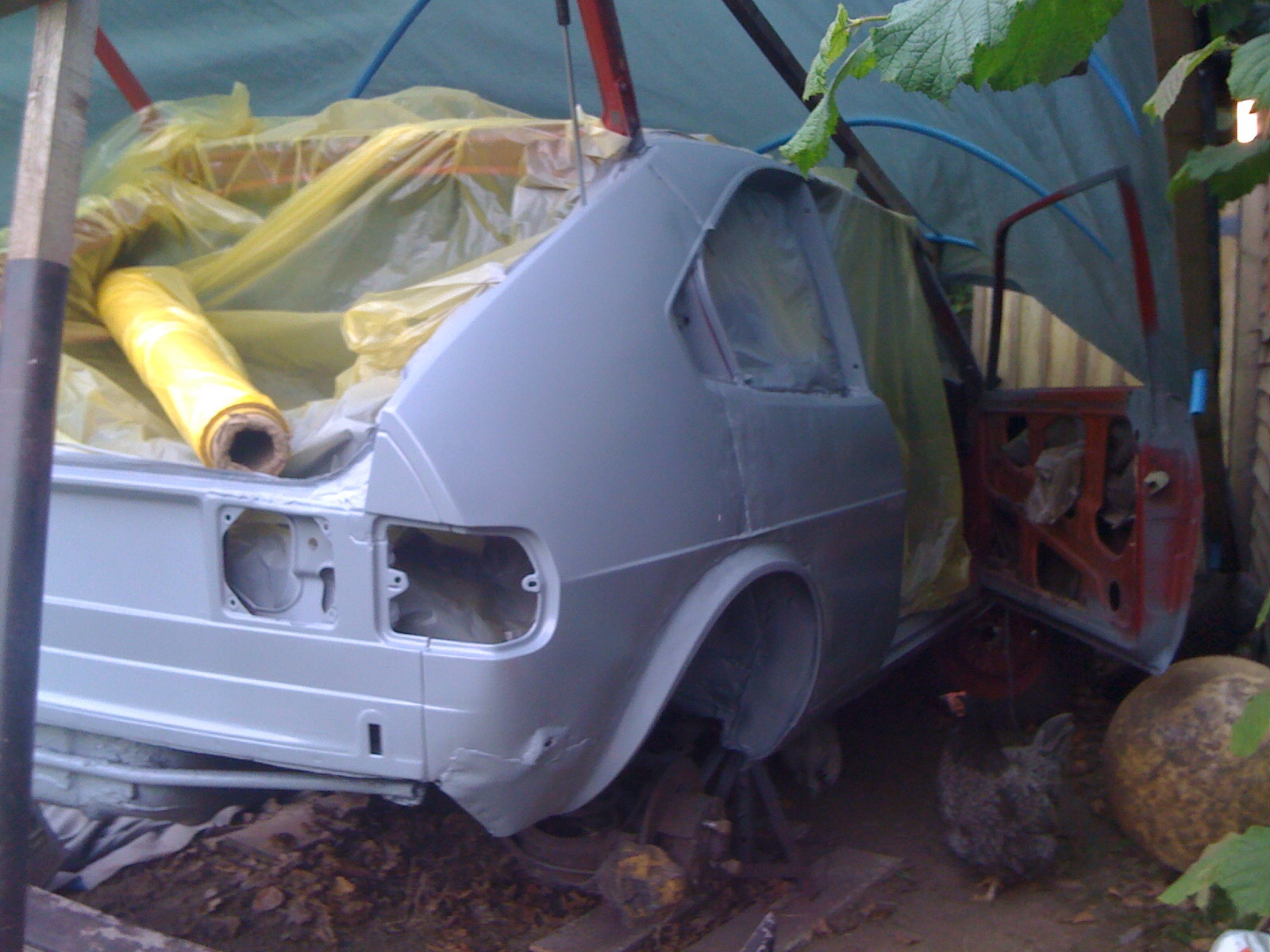

Car two years ago starting to bare metal in back garden not ideal, I done all the welding in my dads garage but when I lost a bit of interest he kick it out when he got a Morris minor so I had it down the side of my house for about 3 years . About once a year I would uncover it and start it .

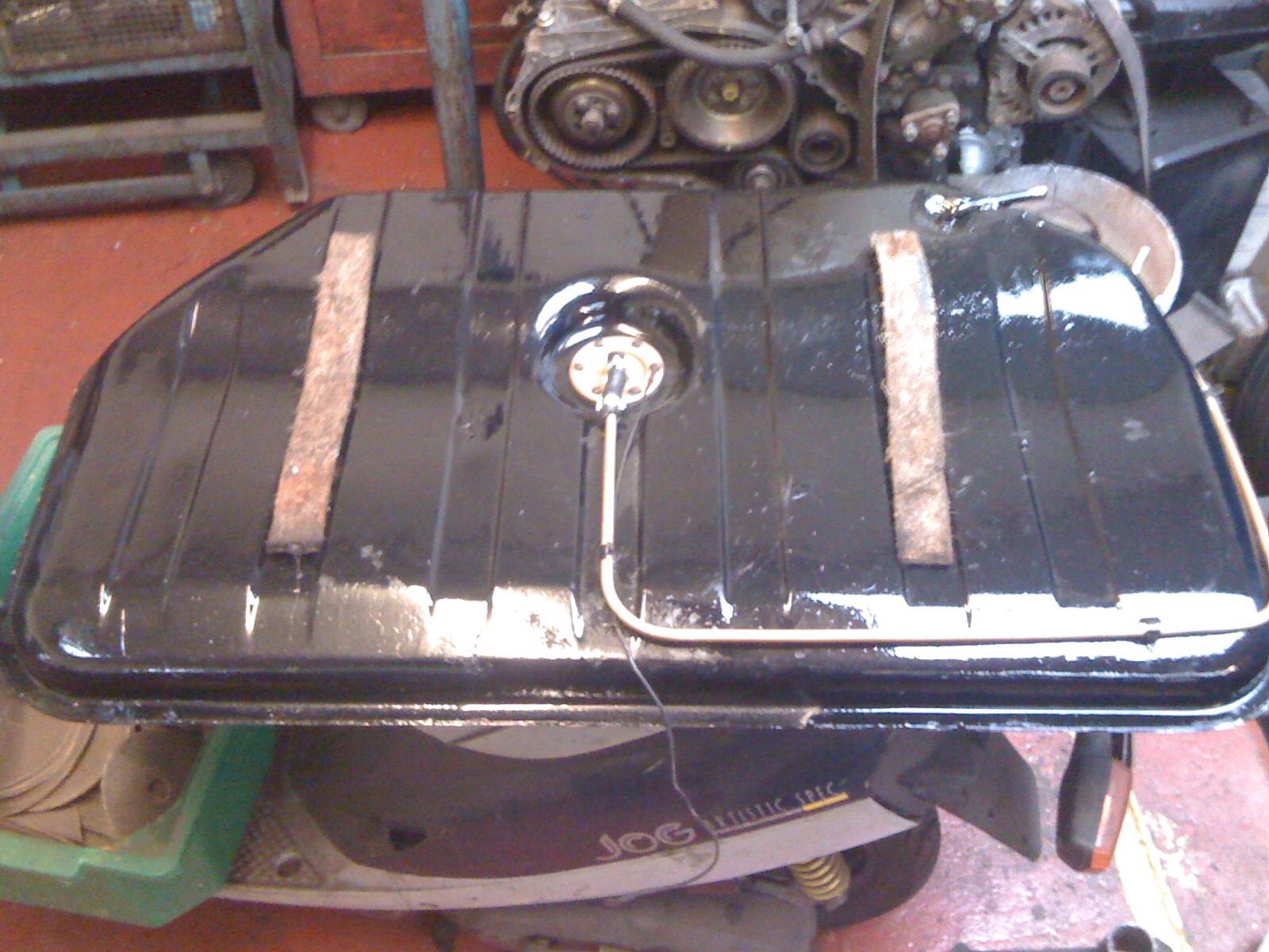

Repaired fuel tank need welding on vent area treated with Vactan rust convertor and painted black

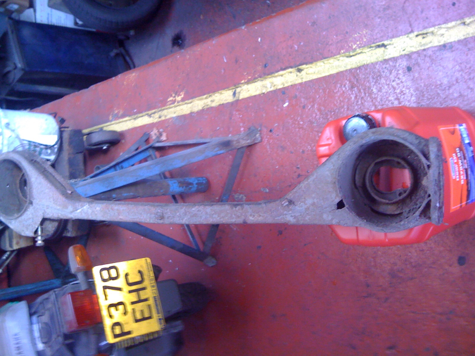

Re: TIX
Post by Simonsud »

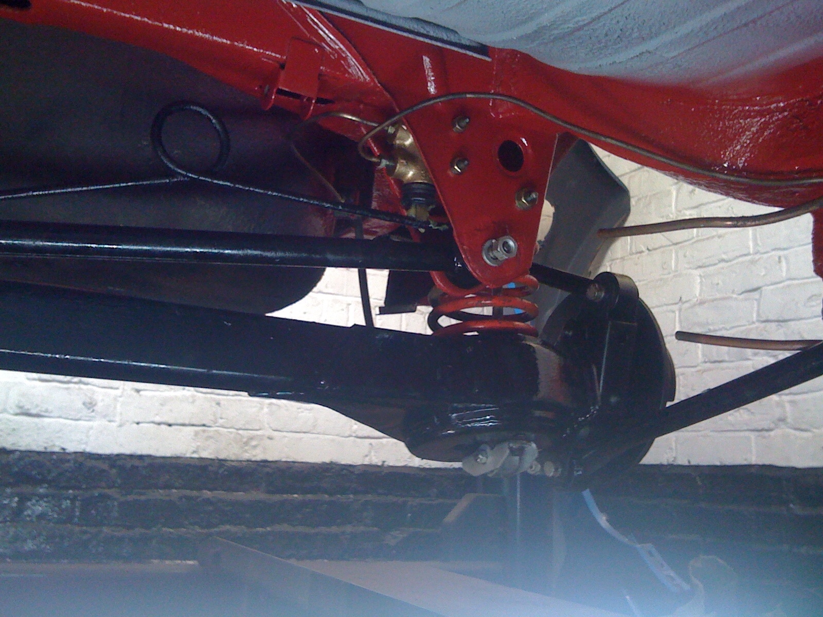

Rear axle ,suspenion and brakes before repairs and repaint
When I got car on ramp I started at the back and worked my way along the floors

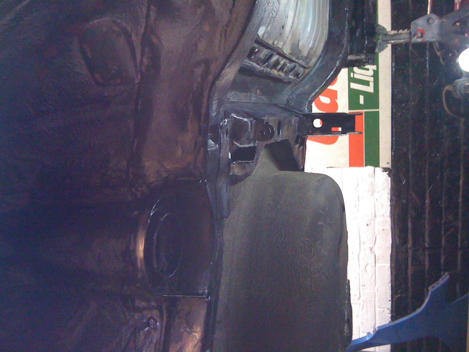

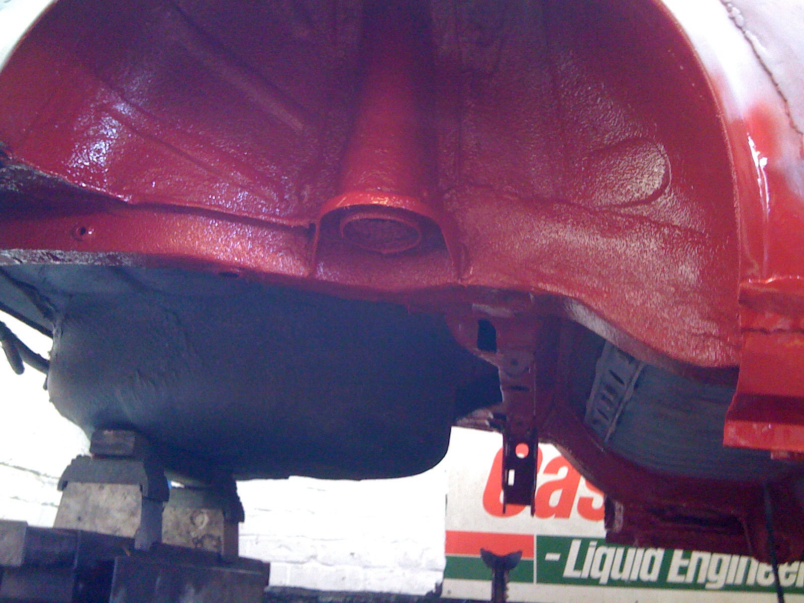

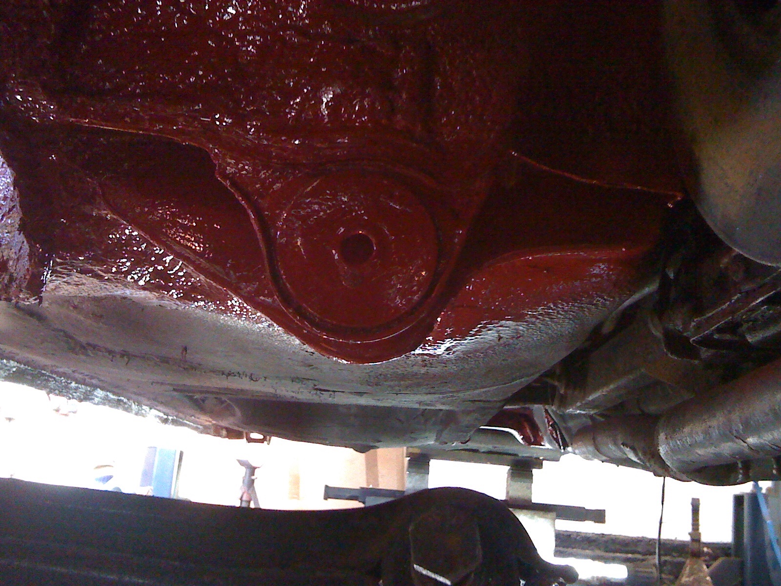

Bit of welding rebuilding and paint , all rust was removed with wire wheel on grinder then treated with Vactan rust convertor then painted black

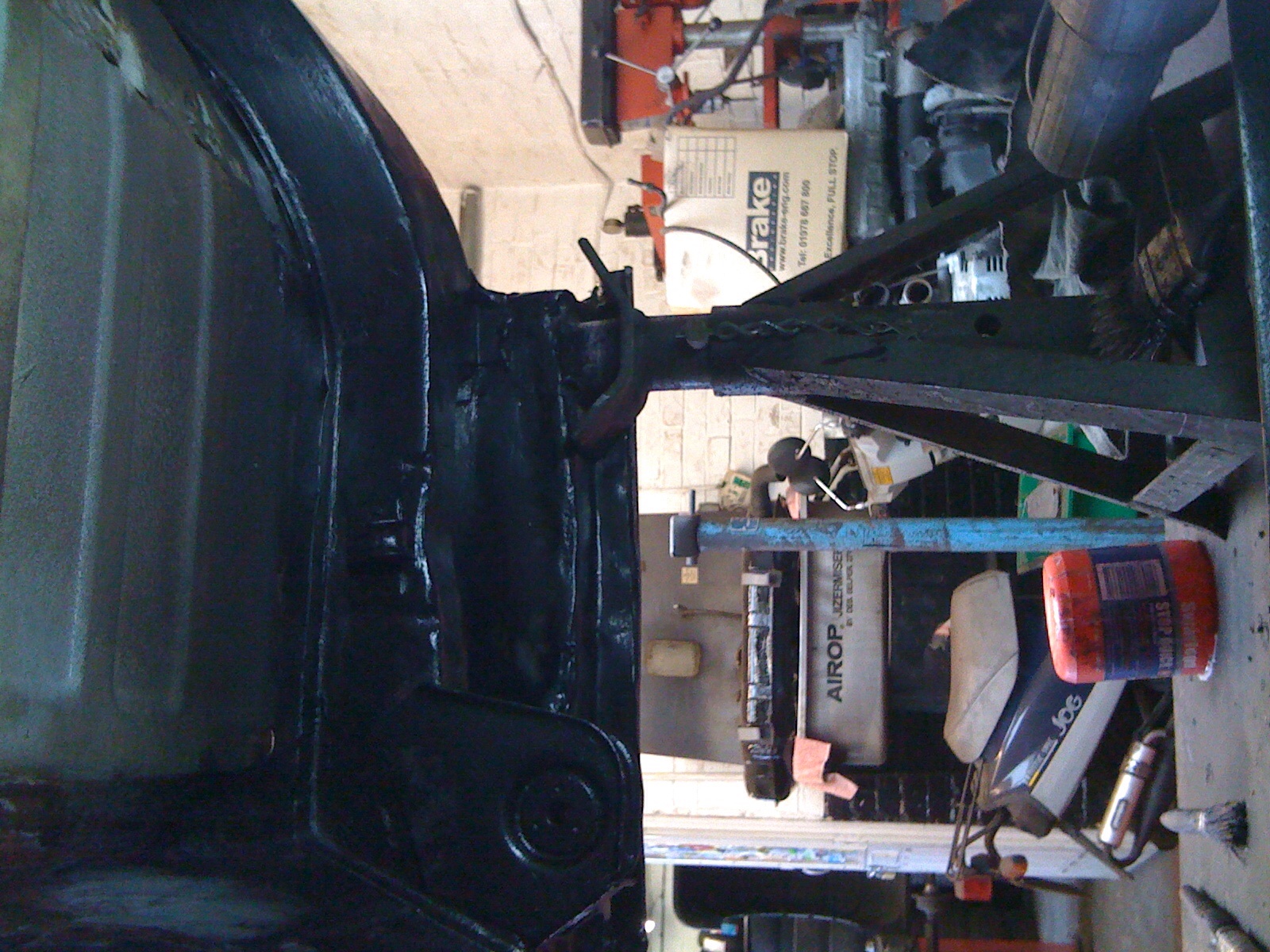

Some rough old repairs to clean up and more bare metalling and treat with Vactan

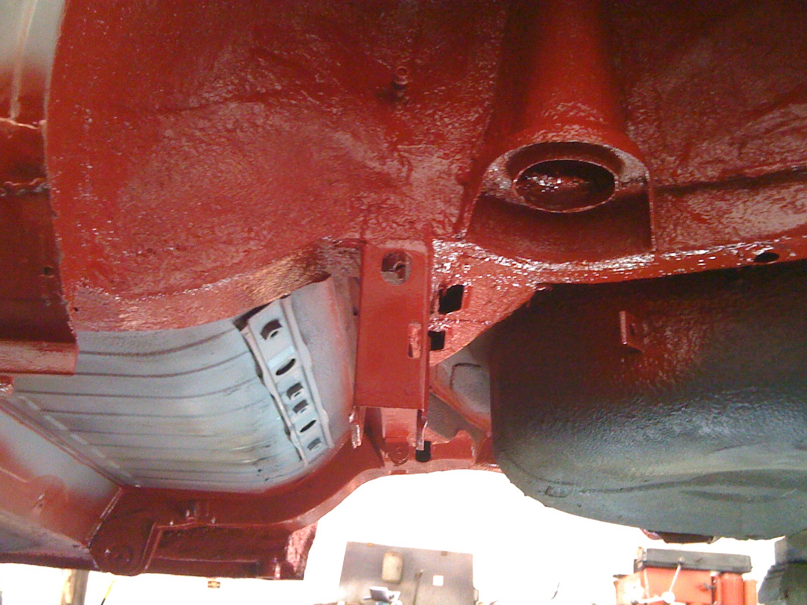

Rear end all cleaned up nearly ready for paint had to weld inside spring area but most repairs I had done at home years ago so just had to grind down all welds and generally tidy things up

Some spray sealer and paint and looking good I always like to have body colour in the arches and underneath . I can drive a rat look vehicle on the top but the engine bay and underside need to be clean as same goes for interior

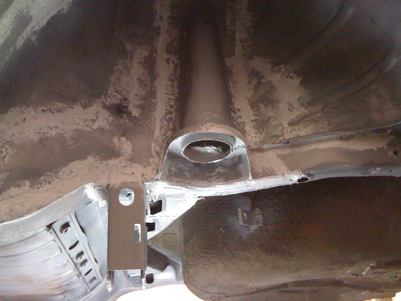

Simonsud
Posts: 331
Re: TIX
Post by Simonsud »

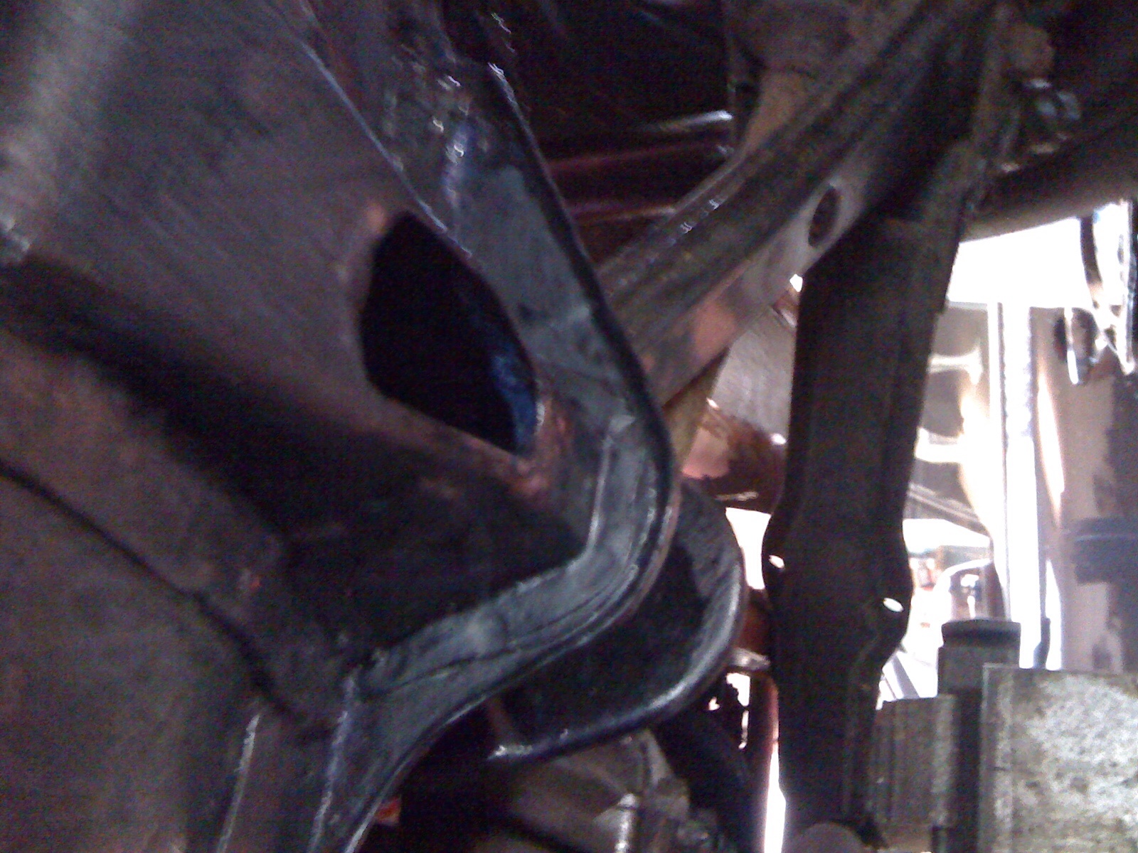

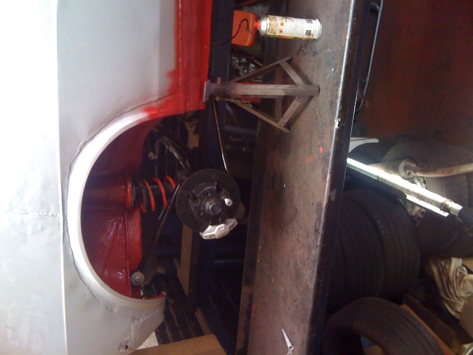

Last picture of front suspenion mount is something I was not happy with too much sealer same goes for engine bay that I thought was done . But I ended up bare metalling the engine bay but that will come later

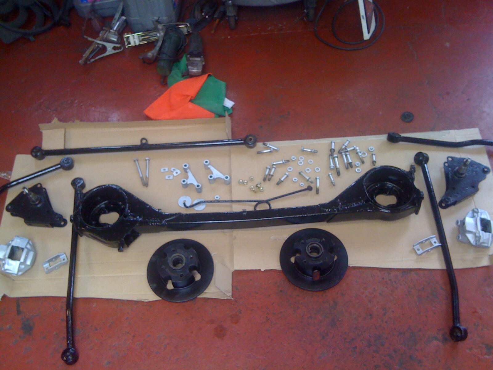

Rear end all painted and going back together

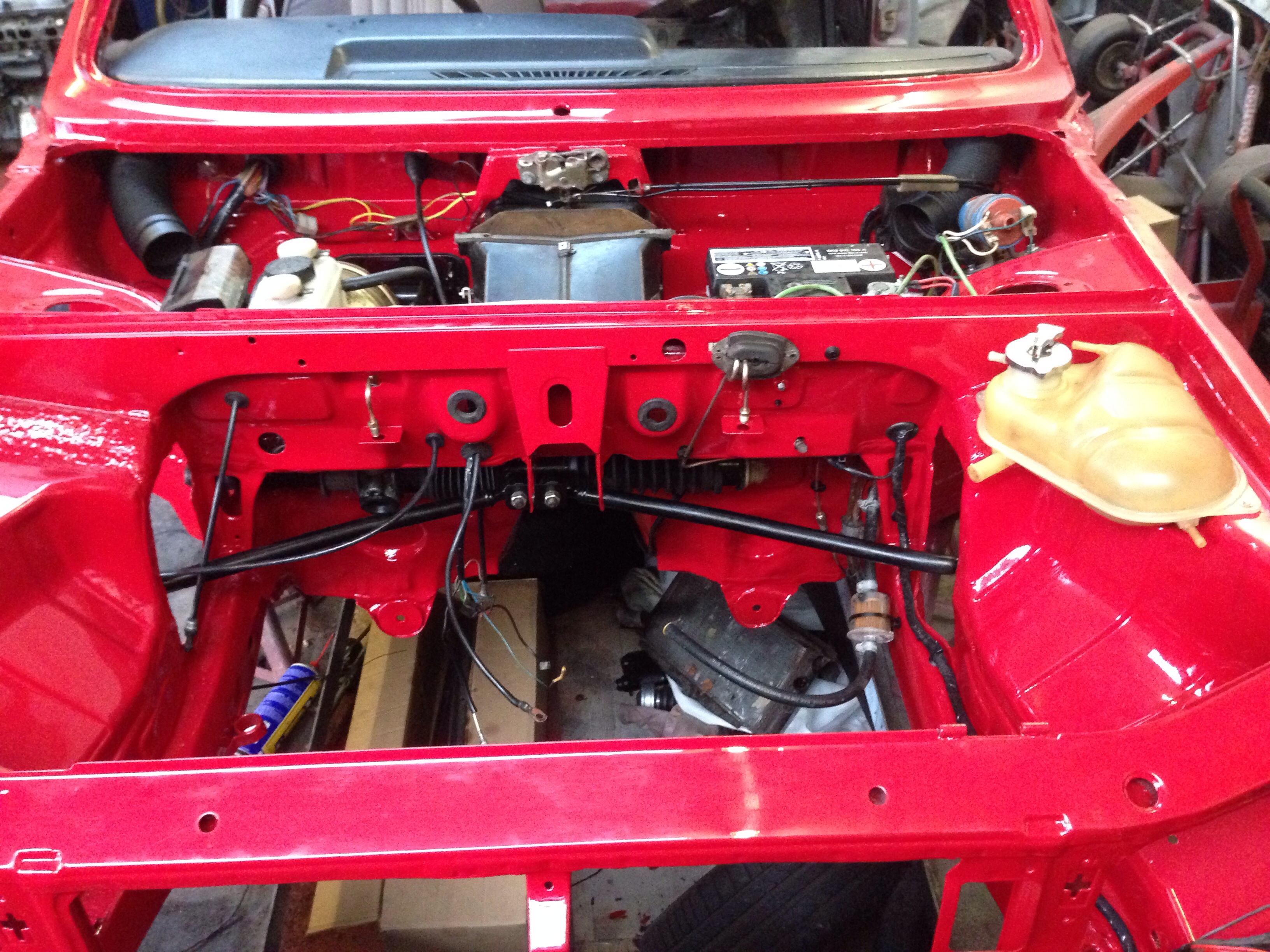

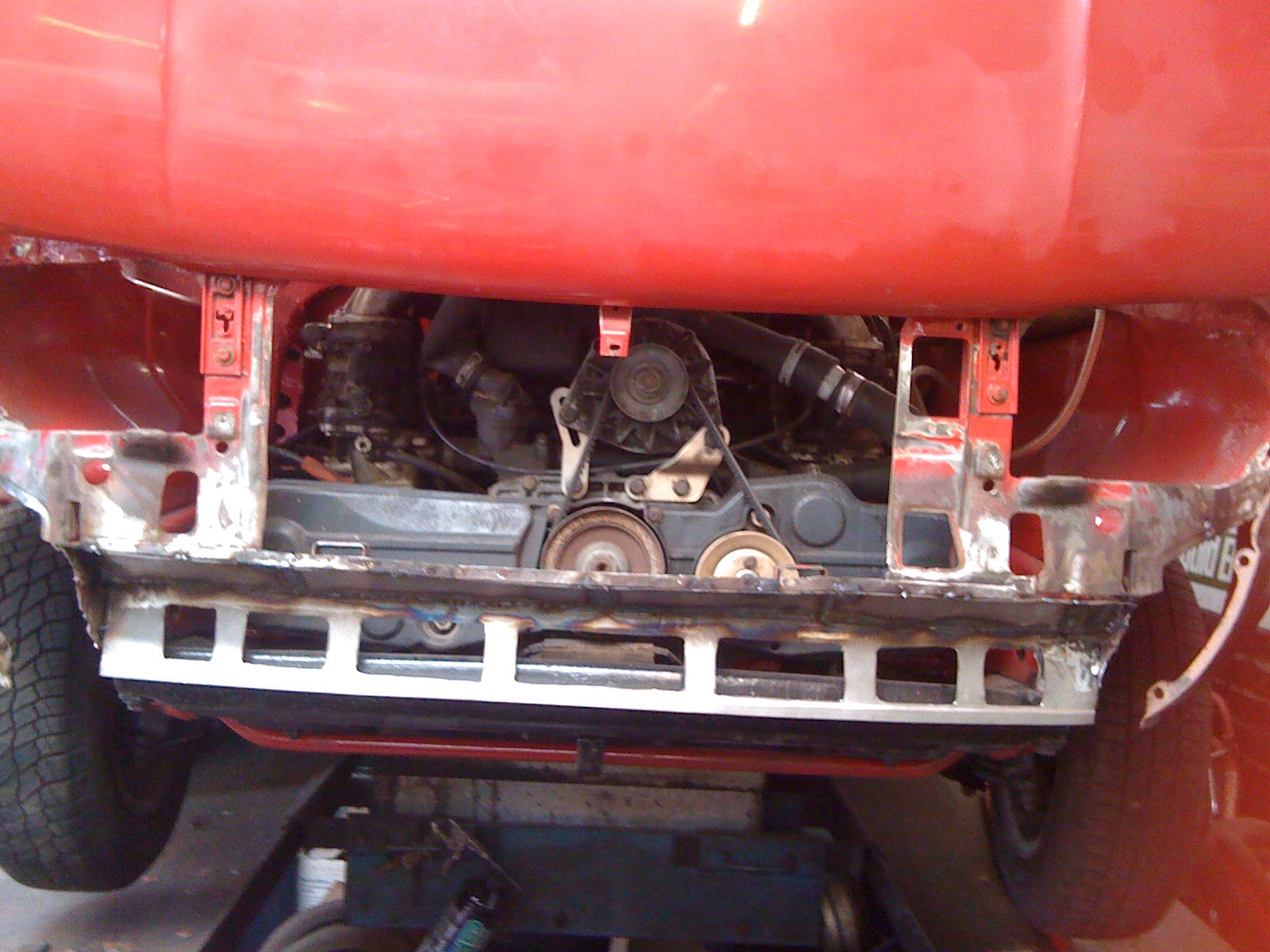

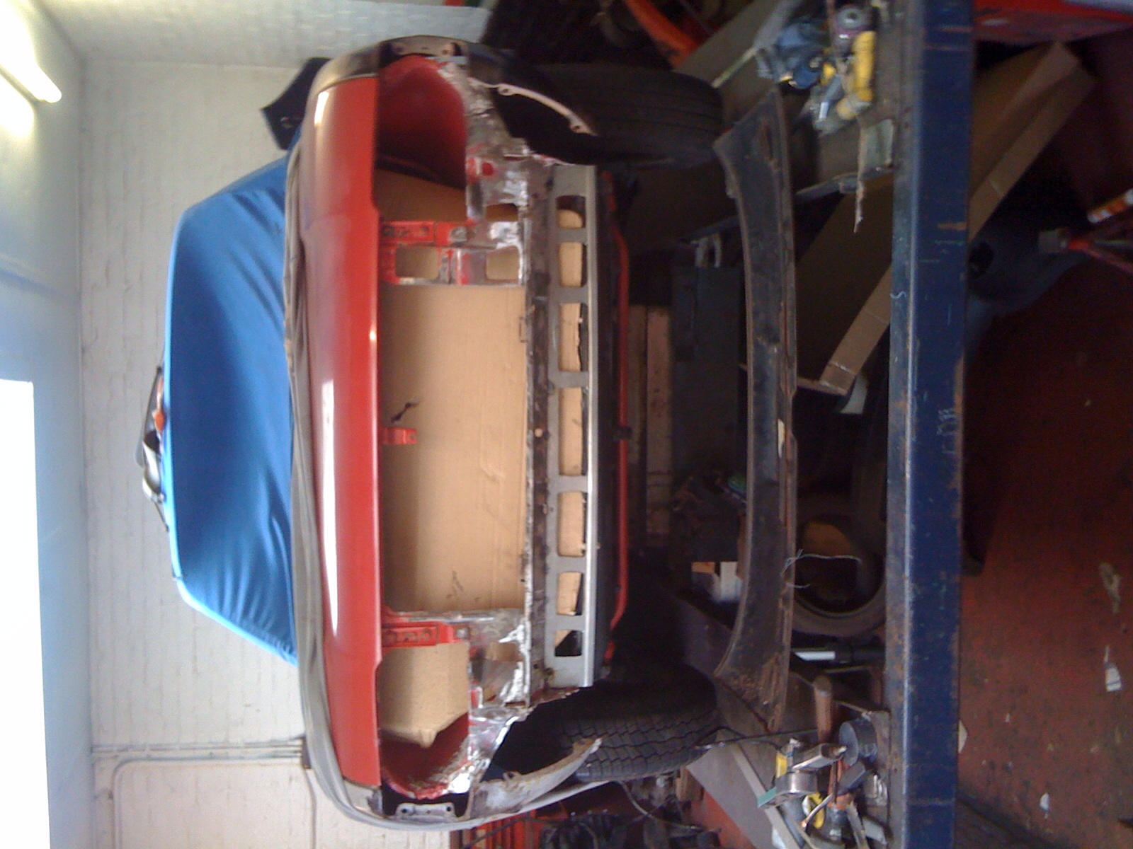

on to the front panel finally got a front panel from mat in Bognor he also had front rad panels but thought I could do with out a new one wish I got one at the time as when I got round to fitting front panel and realised rad panel was beyond repair he had sold them all so I had to make one. While front panel was off I fitted new water pump and cambelt as at this stage wasn't going to remove engine as I had done engine bay before

Inner rad panel in and front panel welded on
