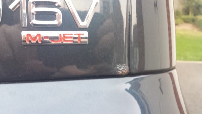

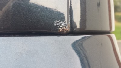

very difficult to erradicate it for good without surgery.
at best it needs taking back to bare metal with a shot blast gun but the corrosion will most likely have spread from around the edges, either from the bumper side or the rear 1/4 join. so any treatment to the face would be short lived without treating the source of the issue.
maybe JB will come along with a more possitive solution
Re: Need A Bit Of Advice
To be fair, its been like it for a year or 2, .. but I haven't paid attention to it given I wasn't expecting to still have the car. The plan was to have the Graemes company car when it came out of lease ( this month ). However I have had to take a year off work, so it wont be happening now. So its time to tidy up the old boy and invest a few quid ( again ). Apart from the rust issue he is going in for Clutch and DMF next week, new injectors the week after and a Cam Belt and W/P the first week in December. Seem to be at that point when I'm spending a ton of cash again. In the last few months its had 2 rear Shockers, top arms , bottom arms and drop links . I reckon ive spent over 10k on this car in the last 4 years!

On the rust spot, i'd spot blast back as kev suggests, see how far it really goes, remove what you can see, Jenolite or POR15 treat the exposed area, and then a little skim of filler and smart repair.
