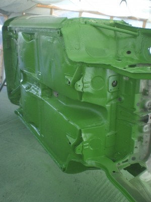

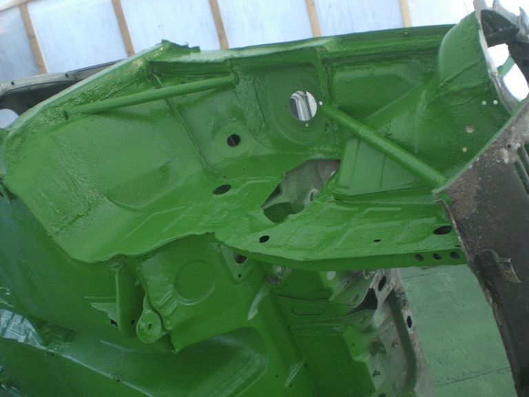

next stage
After this there's a bit of a wait as trying to source someone to tackle the top side begins

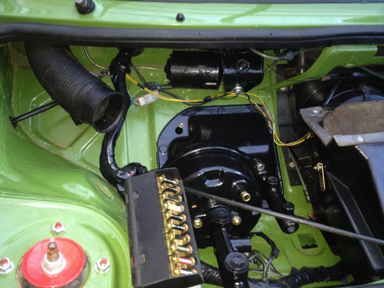

Found some pics from Kev
Re: FMJ820Y
Anyone notice the slight "problem" that kept Kev awake for days ???

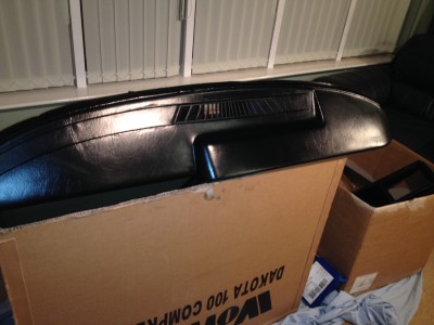

Don't know why it keeps posting two of the first photos ?

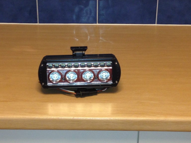

But here's my Very late birthday present Couldn't find any "as new" spots around so opted for these - ain't cheap but have daytime running lights as well

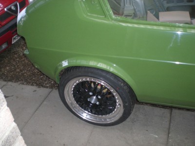

The rear arch fouling the back of the rear tyre?Kermit wrote:Anyone notice the slight "problem" that kept Kev awake for days ???

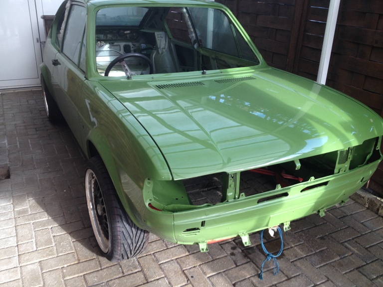

No, oddly enough no problems thereMufasa wrote:The rear arch fouling the back of the rear tyre?Kermit wrote:Anyone notice the slight "problem" that kept Kev awake for days ???
it's more to do with the colour
Re: FMJ820Y
I really love the colour!
05Alfa1662.0GrigioGeo-Daily
00Alfa1662.5Sporto-Verde Argo
Re: FMJ820Y
Spot the differenceMufasa wrote:I really love the colour!
Re: FMJ820Y
The top colour (photo) is much nicer….
Re: FMJ820Y
Edward wrote:The top colour (photo) is much nicer….
Oddly enough the top colour is the WRONG colour - don't even know if it's an Alfa colour at all
Trouble is, I'm with you Ed I do prefer that colour too

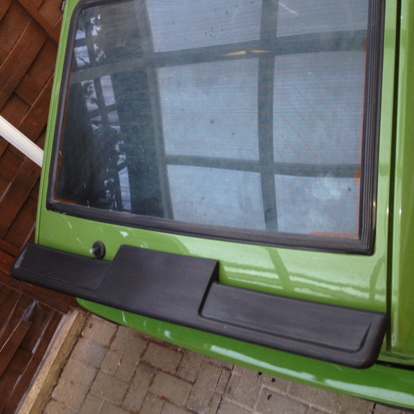

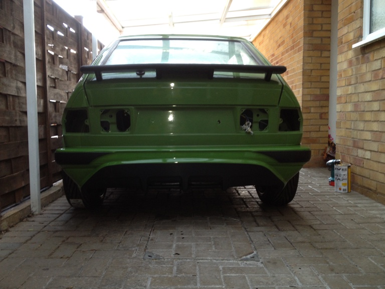

Just to show Shrew I'm not sun bathing
Re: FMJ820Y
you're cracking on mate
looking better with the contrast between the blacks now, rear spoiler looks good, a close up would be nice for the folks who've not seen it

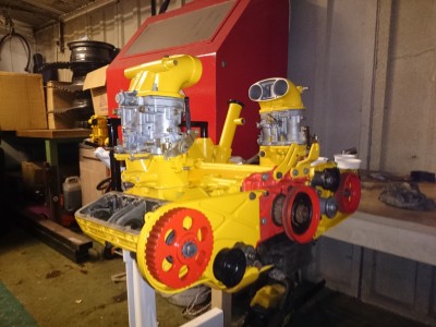

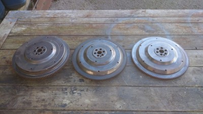

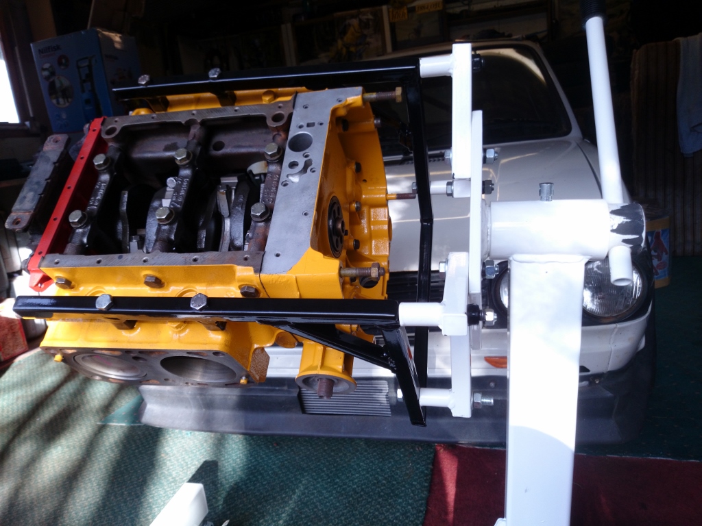

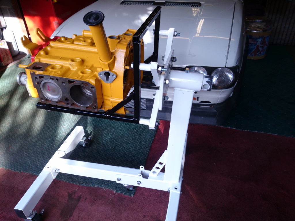

Now would probably be a good time, whilst your all discussing the "chocolate lime" contrasting colours of the bodywork, to introduce you all to the busy end of things.
This morning i managed to get the block back onto my adapted and largely home made engine stand, so i could continue rebuilding it, ready for hanging in for building the exhaust soon.
for those of you who missed out on earlier stages of Harvey's car thread, to bring you up to speed with this bit at least, we are rebuilding here a 1712cc 8v, cleaned up throats and ports, and a set of Holbay fast road cams with vernier pulleys.

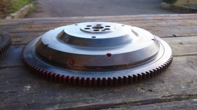

Whilst ripped down, i balanced the rod/piston sets, crank, clutch, and my own lightened flywheel, all as individual components, and then as a lined assembly.
heres a few pics of flywheel, from left to right, stock (still with clutch attached), then a BLS fast Road flywheel, and then my own
taking a que from the BLS design, i stamped it up for Top dead centre, and then increments of 10/20/30 and 40 degrees advance.
and once this was in, i carried on with rebuilding the rest of the motor, to the point where i realised the cam belt kit included the wrong belts! 2 teeth too long!
so this is where we got to, although the brand new 40's are mostly on top as a dust guard for now!
