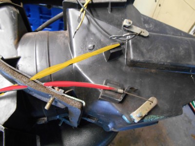

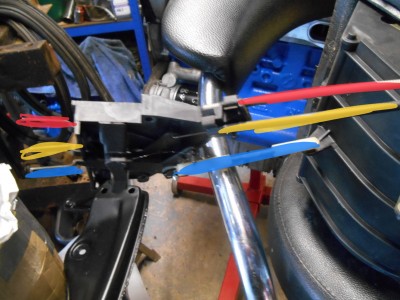

For anyone suffering from “Heater control confusion”. When putting your Sud back together.

Thanks Lou
Once again the Oracle speaks
Re: Sud heater cable layout
You’re welcome ade. I thought I’d post it in case it helped anyone else out. Remember that the Sud doesn’t use a heater valve. The coolant constantly runs through the core. All heat and distribution is controlled by flaps

Thanks for that. The fixing points on the air box have broken on my car and now I know how it should look.
