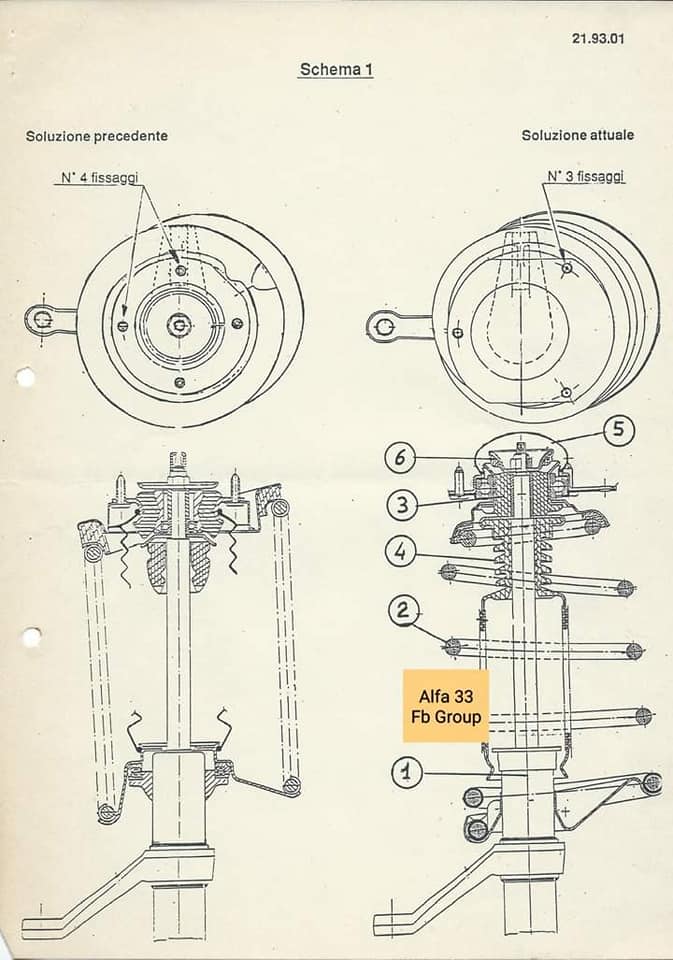

GAZ built me some struts for the rallycar. They just need some donor struts for the steering arms and the mounting plates.
I know at some point on the S3 they went from 4 point fixing to 3 on the strut top.
Re: P4 Front Suspension
You got it! I think they were all the very late Imola cars and done away with the bearing in the lower spring platform I believe ??

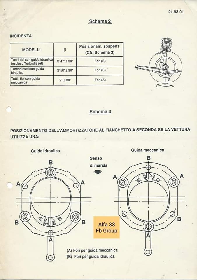

This pages where posted from a user on a Fb discussion, they are from an official alfa bulletin about modification from 4 to 3 bolts front suspension system on alfa 33:
