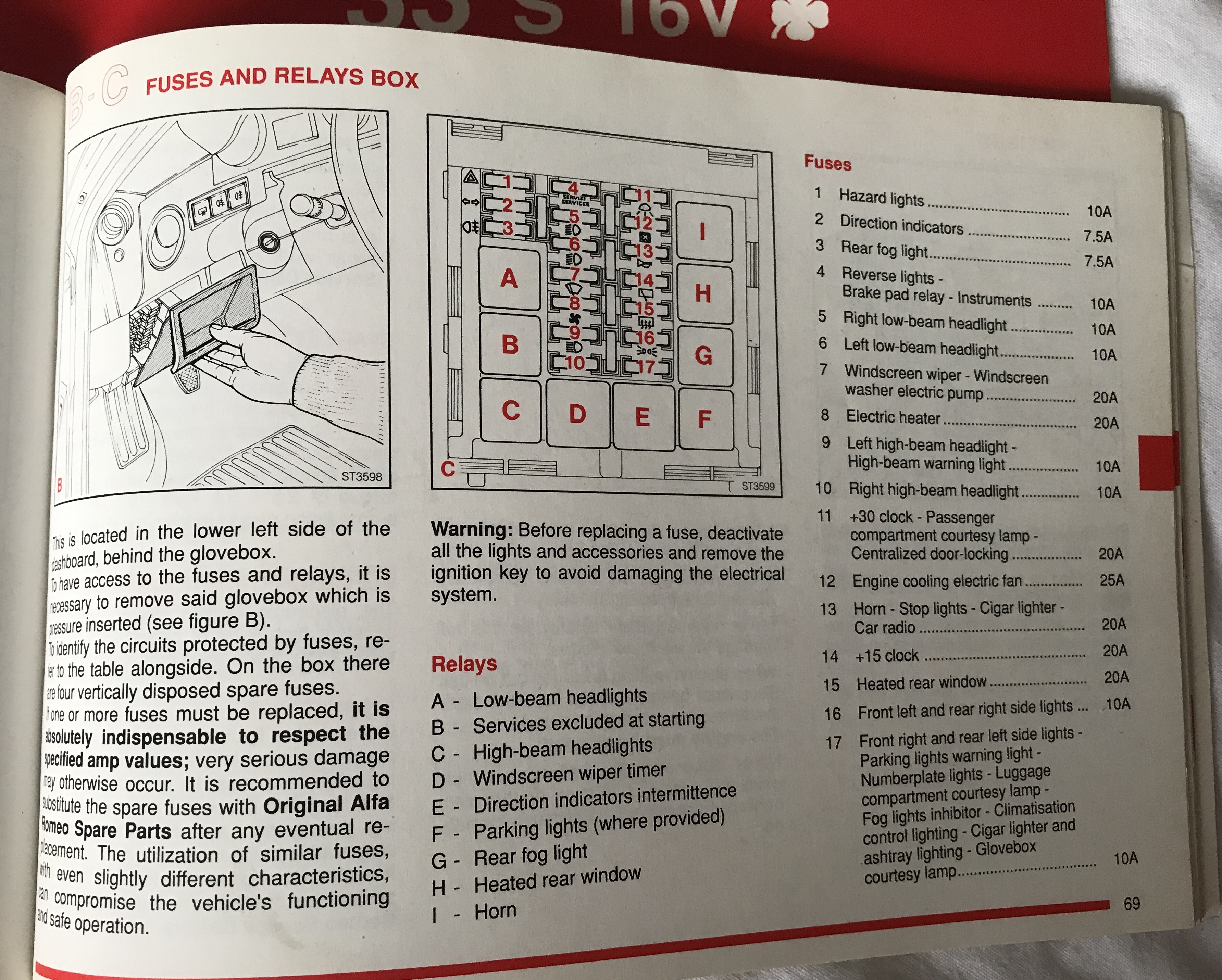

Hi Kerry.
I’ve had a look and all
I can find is the following page from the handbook. However I’m sure I’ve seen the relay and it has a fuse built into it.
This doesn’t appear in the handbook but I’m sure from memory I’ve seen the relay and it has a green fuse which is a 30A.
Hope this helps

The relay (with fuse) is under the bonnet next to the battery not in the fuse box. I too can't find anything on it's specs.
