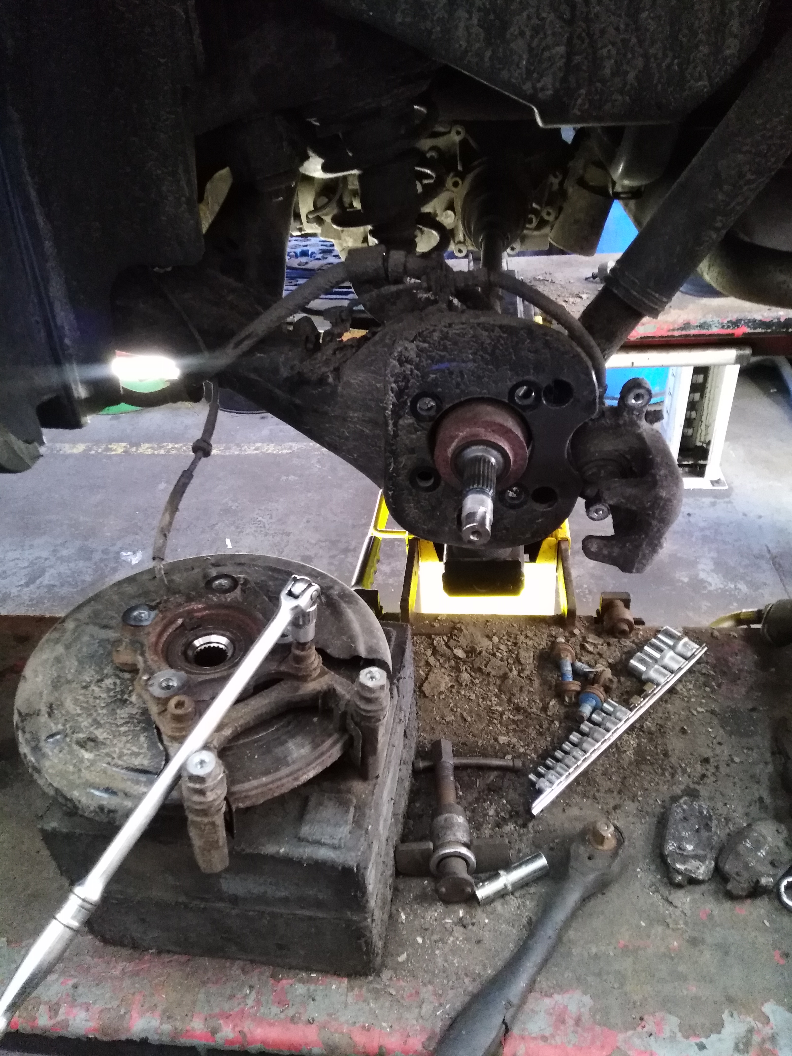

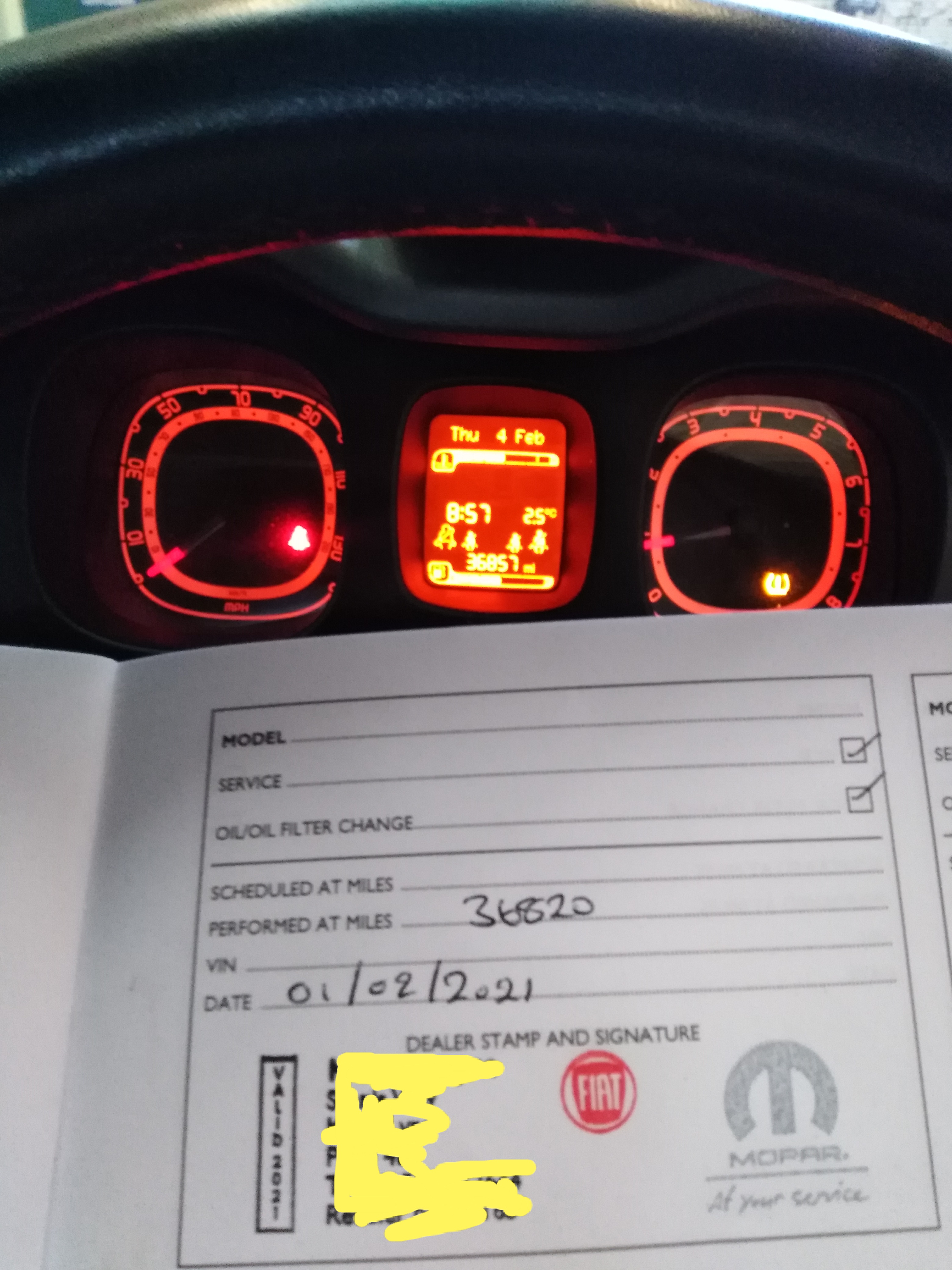

Had a Panda 4x4 in today, had actually been serviced on the 1st only a handful of miles ago at a Main Dealer whose name I've spared to prevent any nasties. But really....
Came into us with the complaint, still that the brakes were making grinding noises.
Needed front & rear discs & pads, plus 3 tyres and tracking.!

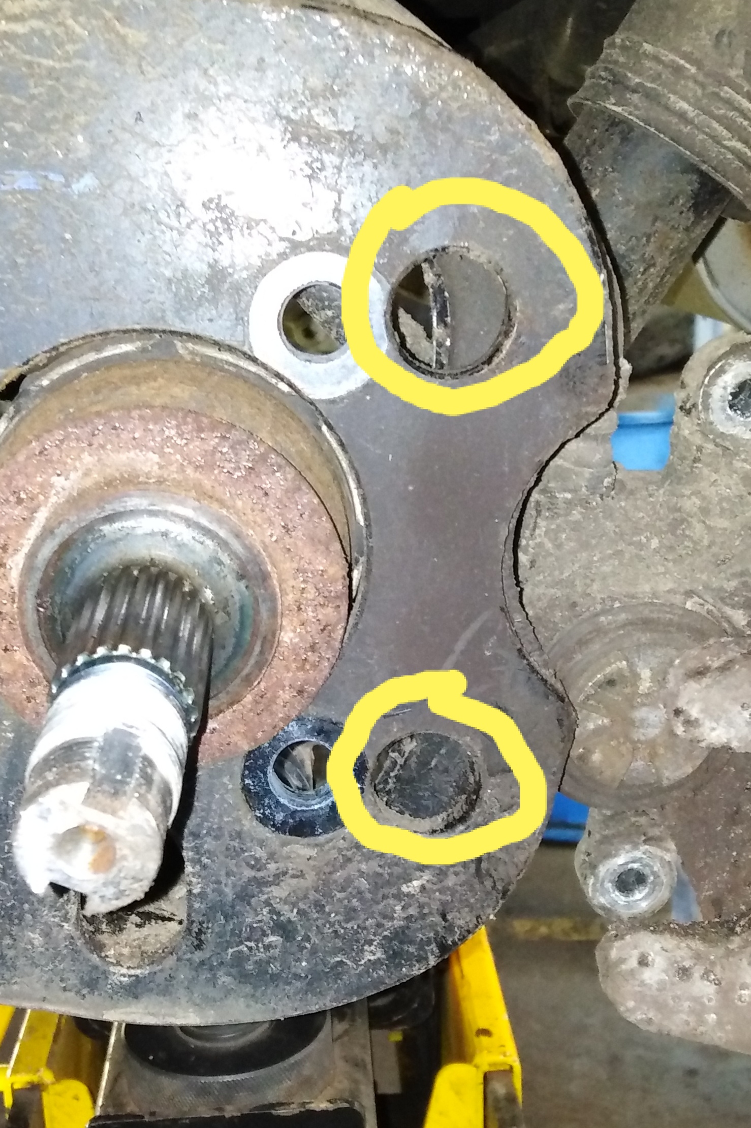

Being the 4x4 the rear discs threw up an odd one, the pad carrier bracket fixing bolts were hidden by the extra material that the rear axle has. So to take the disc off you needed the pad carrier off, which you couldn't do as the bolts were hidden!
So the method is to undo the driveshaft nut then drop the whole rear hub off by removing 4 fixings bolts, first gaining some slack in the ABS sensor wire so as not to damage it.
The bolts sit in these recesses that for some strange reason are blocked off at the back side so you can't get at them! :roll:
In reality it was no big deal, but just shows that car designers still haven't learned to think ahead..
