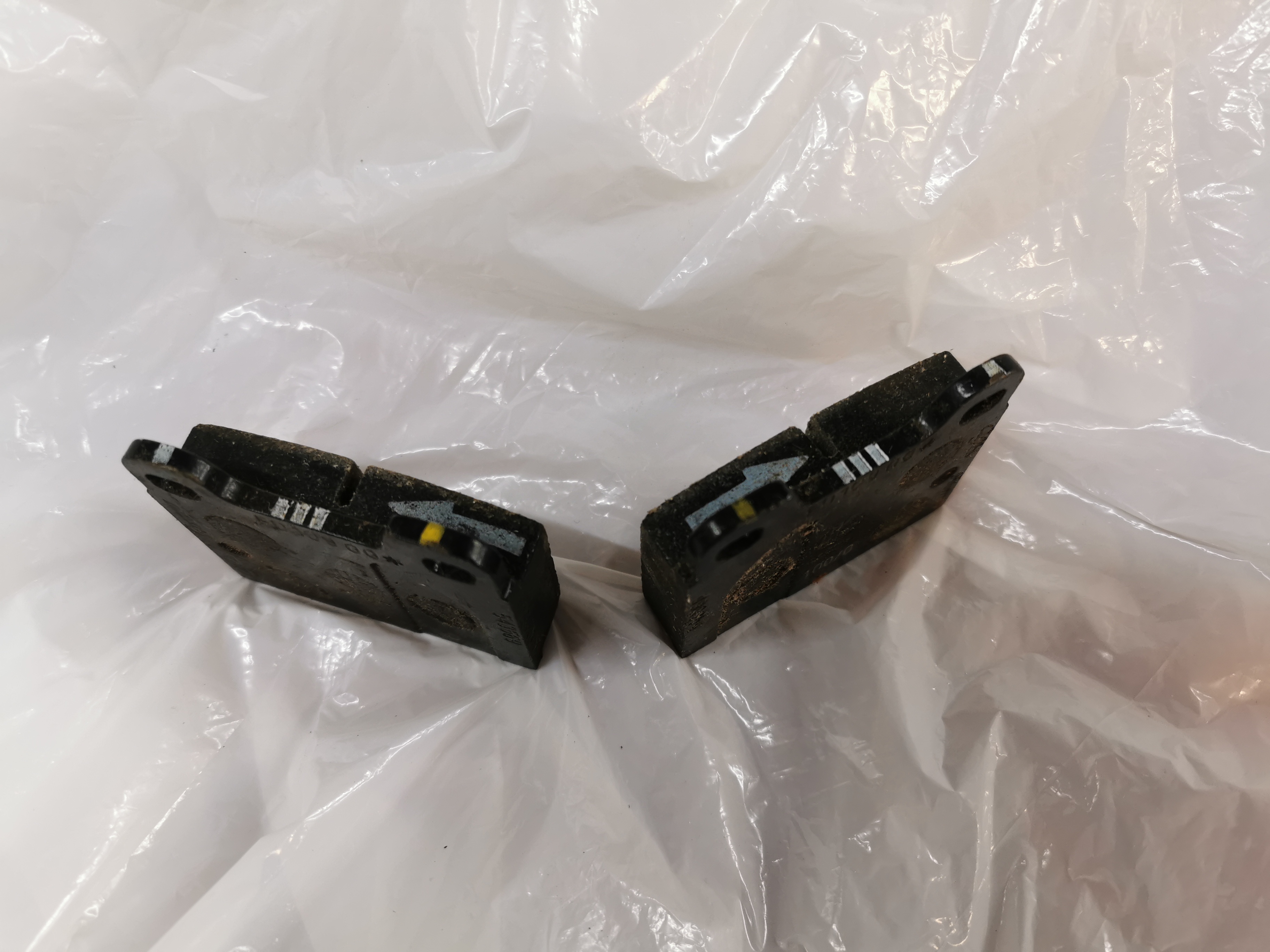

I understand the way the pads go in ,but just wondering if the knife shaped cut out has a purpose ? And why the pads have to go in a certain way? Bit random ,but it's gone quiet on here since I'm getting no serious problems to post . Oh speedo still ticking even though I greased inner cable thouroughly with cv boot grease . Could it be speedo itself?

The cut out should go towards the rear of the car
An old set of original pads

Not sure, but I think the cut is to help gas forming on hot disk surface
under strong braking to exit a bit more and so retard brake fading?
Drilled disk I read they have the same function, help eventually forming
gas to quit surfaces avoiding they can do air cushion between pads and disk

The cut out is to even up the pressure on the pad face, you get an effect called servo effect where the rotation of the disc helps pull the trailing edge of the pad onto the disc, hence the cut out being on the trailing side of the pad. It effects drum brakes more, particularly on the leading shoe, which is why you get twin leading shoe drum brakes, more efficient !
