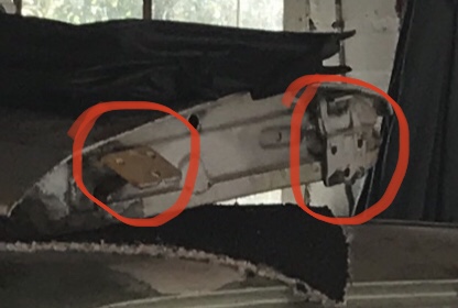

Wanted.
One pair of RH Door hinges. Tbh I’m not sure they’re handed. I need the part that bolts to the car (Both Upper and lower hinge) I don’t need the other half. That’s welded to the door At the factory and isn’t removable. Lou
