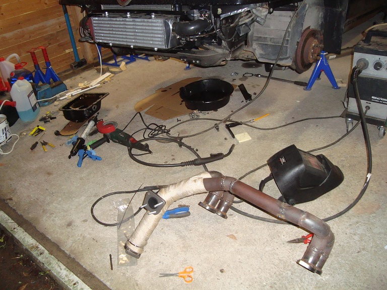

Charge piping was done from 51mm exhaust pipe bends. Oil dipstick pipe and engine side support rod had to be modified to get enough room for turbo stuff. Catalyst is stock, and so is rest of the exhaust system from there. Megasquirt is attached to stock engine wiring harness with an adapter harness. There is also an additional wiring harness for the wires that I didn't have on the stock engine wiring harness.

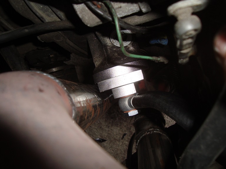

You are correct, I mounted the turbo above the engine block. It's in about same location where the pipe between stock air flow meter and air filter used to be.
I have seen some turbo installations on 8v boxers in same location, but in my case the bigger 16v heads made it more challenging. Even after changes to oil dipstick and engine side support rod the space was very limited, because the tie rod requires a lot of space. Oil filter was relocated to front RH corner behind bumper to have more space for turbo stuff. Wastegate was installed on the empty space between exhaust manifold and downpipe.
The oil feed to turbo is from the new oil filter housing. Oil drain from turbo goes to oil pan. I was able to weld a fitting just above the splash plate. It's not as high as I would want it to be, but it seems to be working in practice.
Exhaust manifold is 4-2-1 design. Equal length 4-1 manifold would probably be better, and I have seen some photos of a Malesian (?) built 146 which had it like that. Then again I'm not building a race car, and Impreza WRX has same firing order and same design for the exhaust manifold as I have, so how bad can it be?

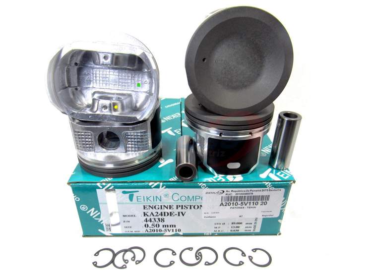

At the moment the Oem nissan pistons so economic
(kit of four with rings and pins was at 75-100e
because used also on some 'humble' nissan pickup)
seam a bit less easy to find on-line, I think due to lockdown,
I hope they will return more available in few time,
but yes, there is a version without the lateral skirt and that have the head
really similar to the Alfa pistons 8v very (only the 1mm difference deck height):

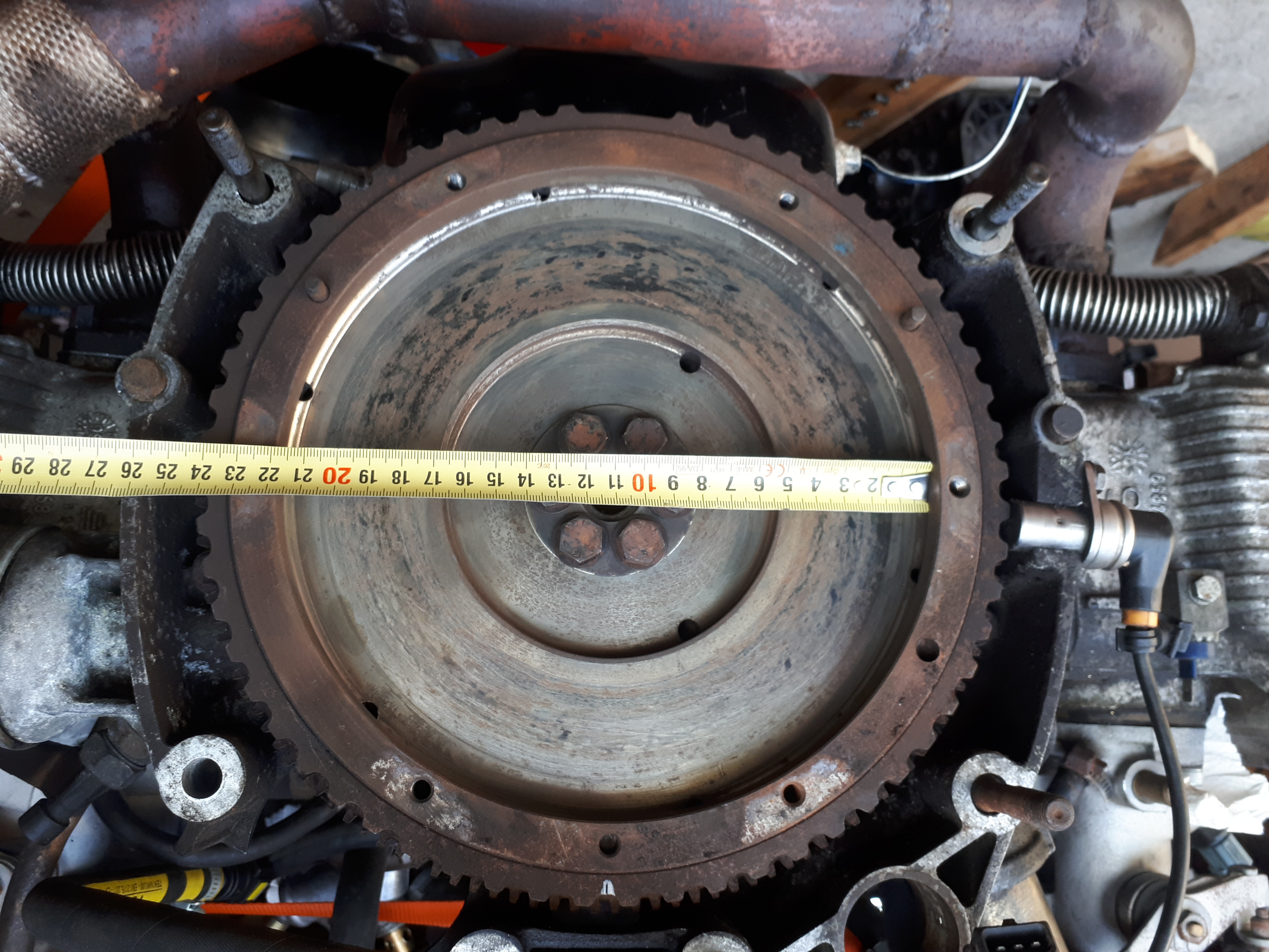

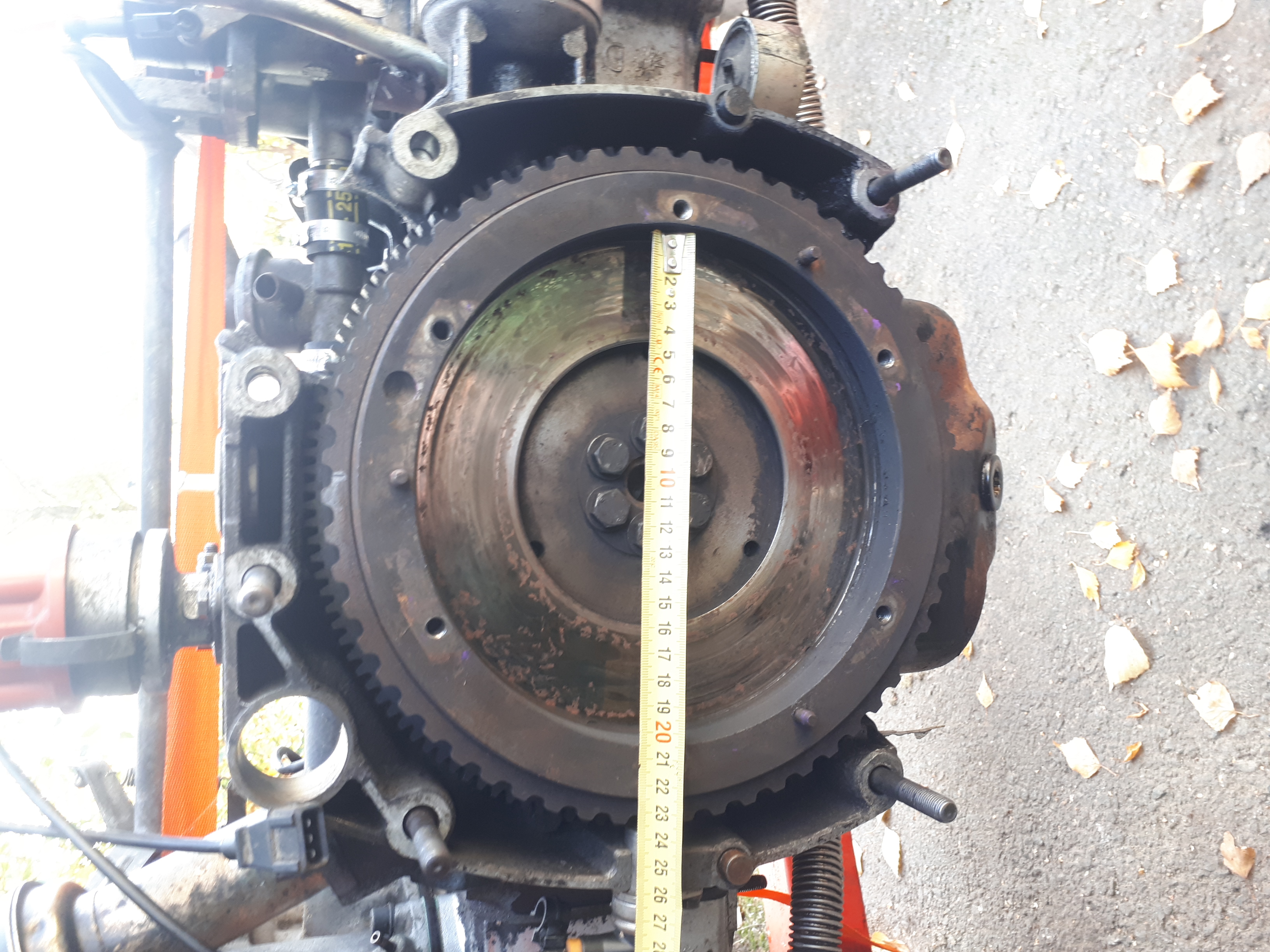

the flywell on alfa 16v use 200mm alfa clutch disk, but have space
for a 220mm clutch disk (surely there is this predisposition
on the alfa 145 boxer 16V flywell (also if alfa didn't use this predisposition
to fit bigger clutch disk, they just stopped to produce the boxer models )
but If I remember probably also the 33 16v flywell could be already ready
for a bigger 220mm clutch disk).

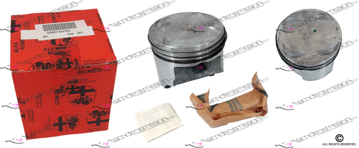

Hi, I don't know if is a reliable option to lower a bit compression ratio,
but searching for engine spares I walked in these
"lowering CR" heads plates for alfa boxer engines:
http://www.alfasud-parts.co.uk/catalog/ ... 2&refprod=
I remember also on some discussion someone reporting an AHM suggestion
it was possible use pistons from 1.7 8v boxer to lower CR on a 1.7 16v turbocharged,
I imagine probably it will need more work, i.e. probably it needs mill pockets
for the valves in the external crown of the piston,
same doubt as using some types of the Nissan pistons on a 16v head
I put a link about this to another good image that was realised by Bert308,
he directly compared section of alfa 33 1.7 8v and 16v pistons:
https://www.alfaowner.com/threads/8v-pi ... 25&slide=0

I haven't been spending much time in the shed lately, so there is not much progress with 33 either. However I had the time to compare the flywheels of 33 and 145. The missing teeth are in same location and there are no problems attaching the flywheel to the crank. 145 flywheel has indeed space for bigger clutch, even though the stock clutch plate is same size as on 33.
33 flywheel
33 flywheel
145 flywheel
145 flywheel
Sorry for the orientation of the photos. I have no idea why they are like that :mrgreen:
The bolt pattern for pressure plate is different. I had to put the 33 flywheel back because I'm not replacing the clutch this time. If (when) the next time to take the engine off comes, I'll just might be prepared with a bigger clutch and change the flywheel.
If I'll be re-building the old oil burning engine one day, the Nissan pistons would be the most interesting option. More displacement and lower CR would both be a step to right direction.
