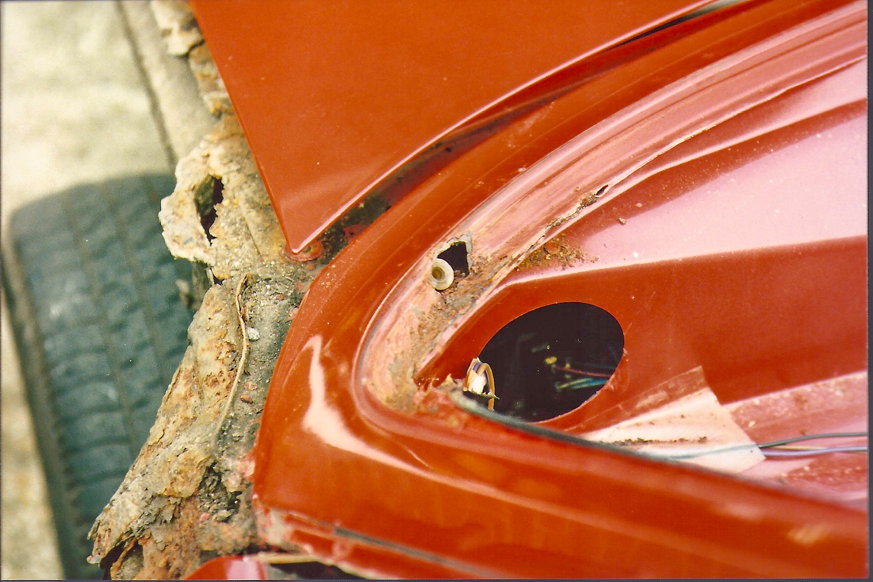

Afaik there are two drain tubes in the bottom of each corner of the Windscreen, they could be blocked or the tube missing.
Re: Raining in
Posted: Sat Jun 20, 2020 10:30 pm
by Splant
Is that there because they expect the rubber seal to leak
Re: Raining in
Posted: Sat Jun 20, 2020 10:42 pm
by KevJTD
It is, and it does :D
Usually rotted out.
