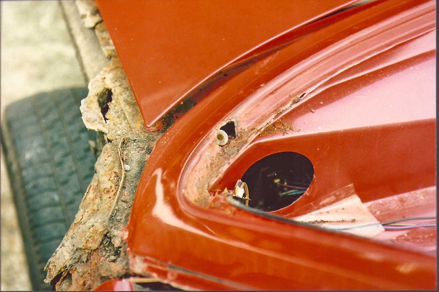

Corners under the scuttle. Can’t remember what causes it. I had a sud and I could hear water sloshing around bends under the dash. Found tank tape under the dash over some large factory made holes, pulled tape off and a sunami came out.
Must be some drain holes blocked but inner bulkhead corners and or under windscreen scuttle somewhere. .

Try sealing the wiper spindle grommets.
Then the lower screen rubber.
Then have a look under the bonnet in the bulkhead area.

Afaik there are two drain tubes in the bottom of each corner of the Windscreen, they could be blocked or the tube missing.

Is that there because they expect the rubber seal to leak
Re: Raining in
It is, and it does :D
Usually rotted out.
