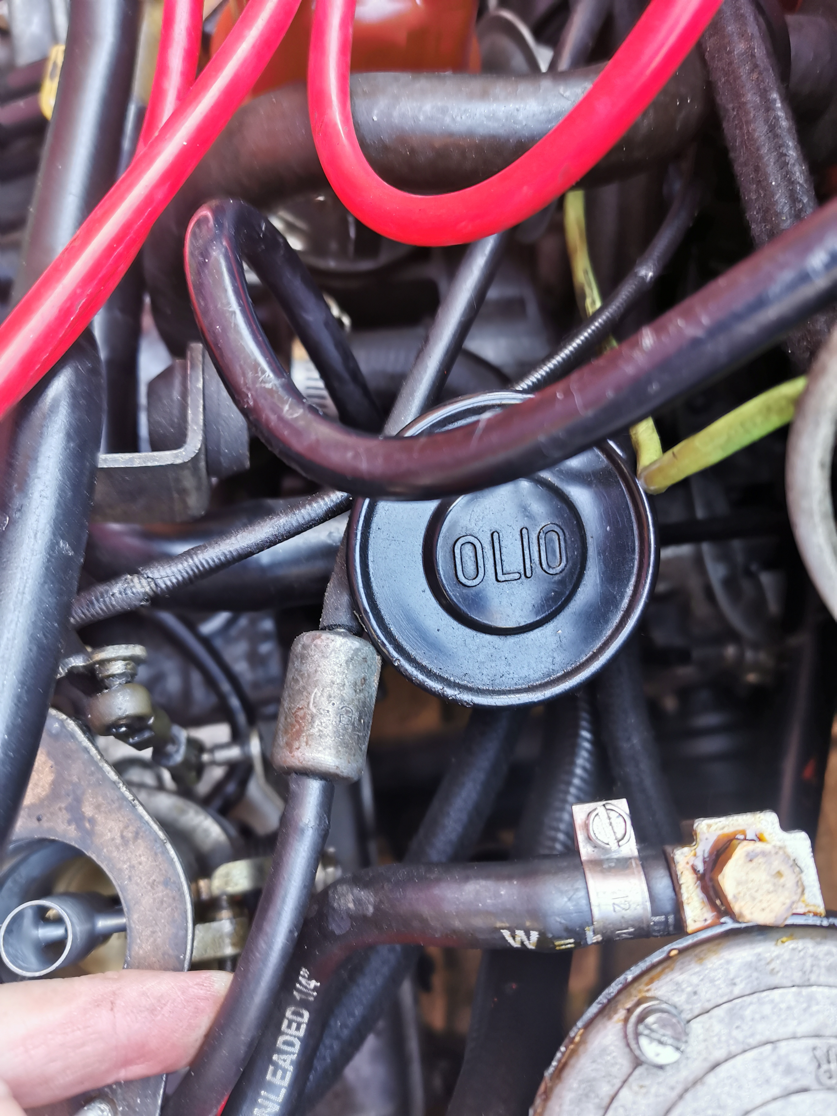

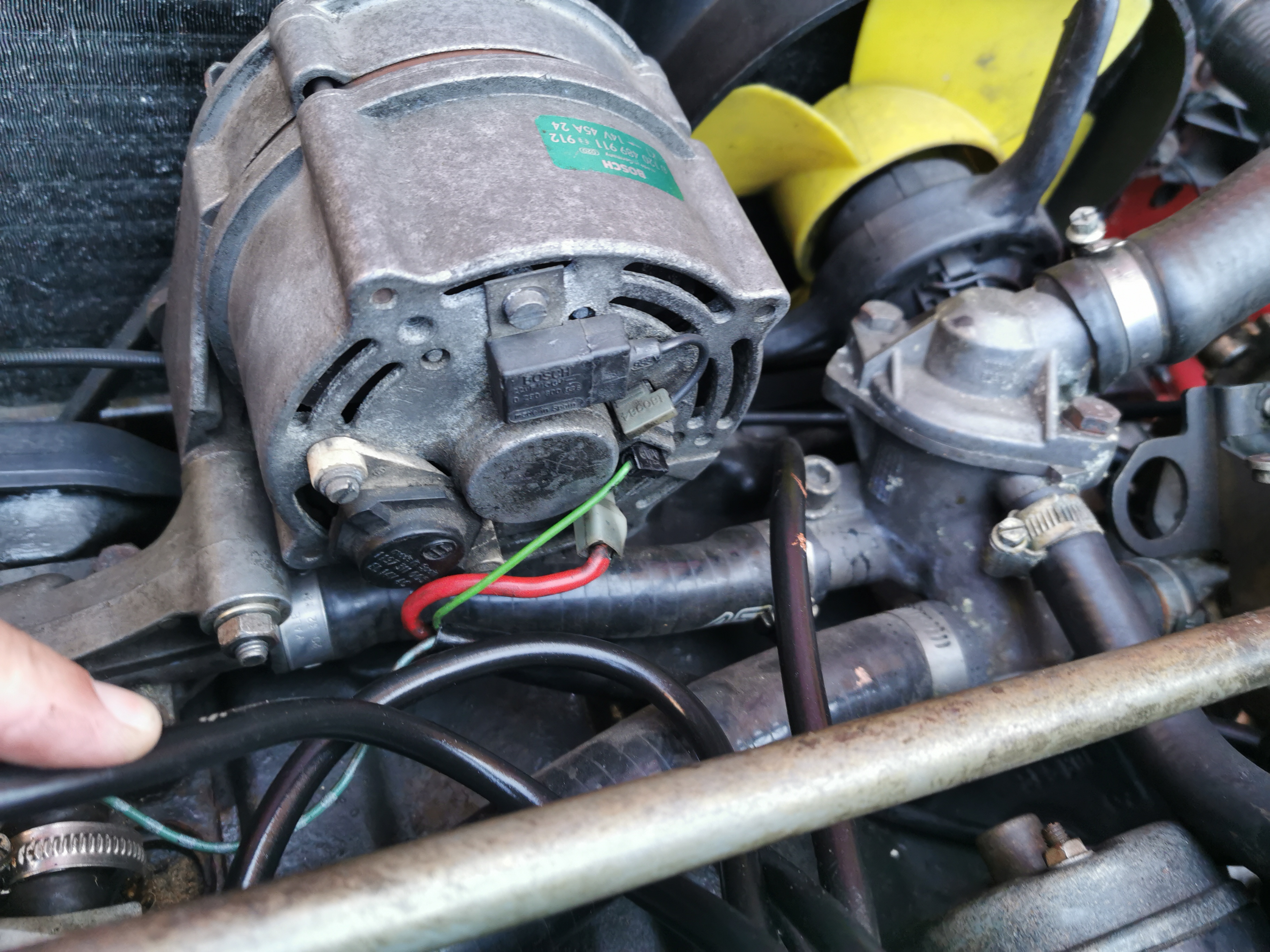

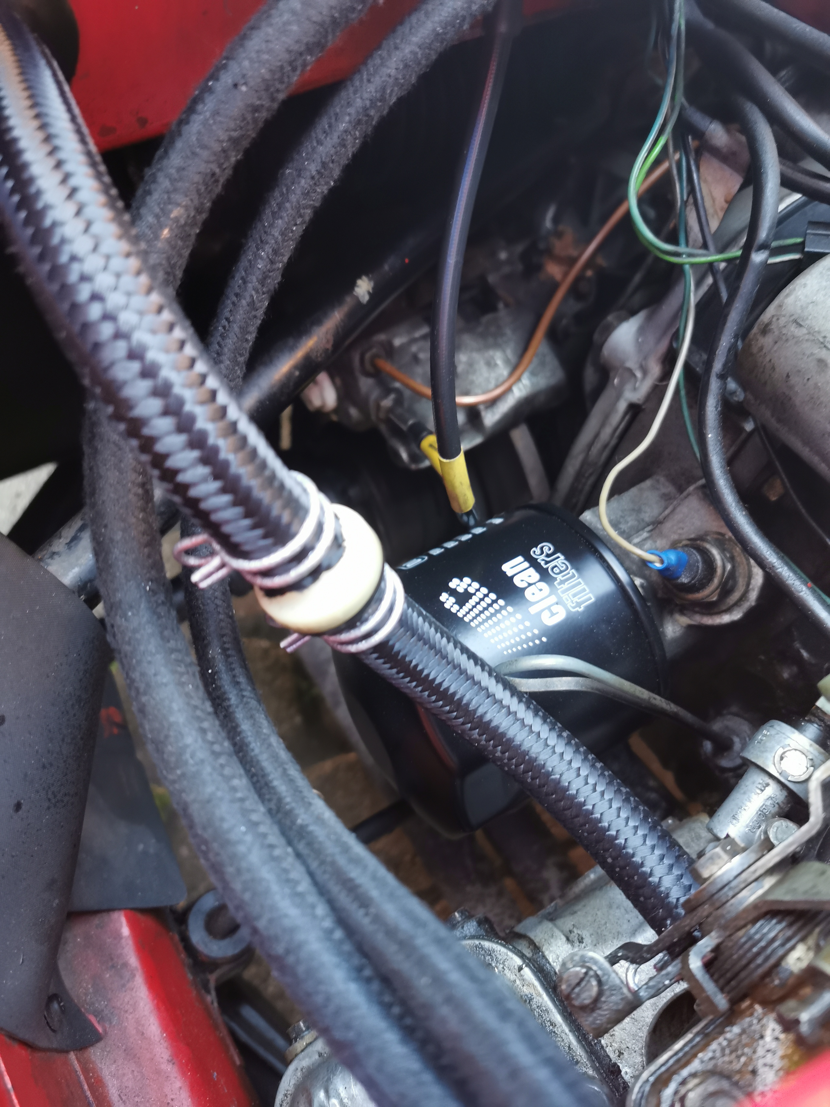

Reassembling stuff and unsure which way pipe went! Is the plastic thingy on the distributor advance pipe a one way valve ? (mine blows through either way but unsure if one ways easier) , same on the servo pipe as well!. Also my labels I had on all the engine wires at smudged to buggery! Does the thicker alternator one go to middle terminal on alternator and to the main live nut on starter motor at the other end? Cheers all.

On the dissy advance pipe, the metal one way valve has an arrow pointing to the carb.......lightly sand the face and look carefully.
On the servo, the plastic one way valve has an arrow pointing to the manifold......easily seen.
Regarding the wiring.....don't have a clue!
Did you take photos before you stripped it?
