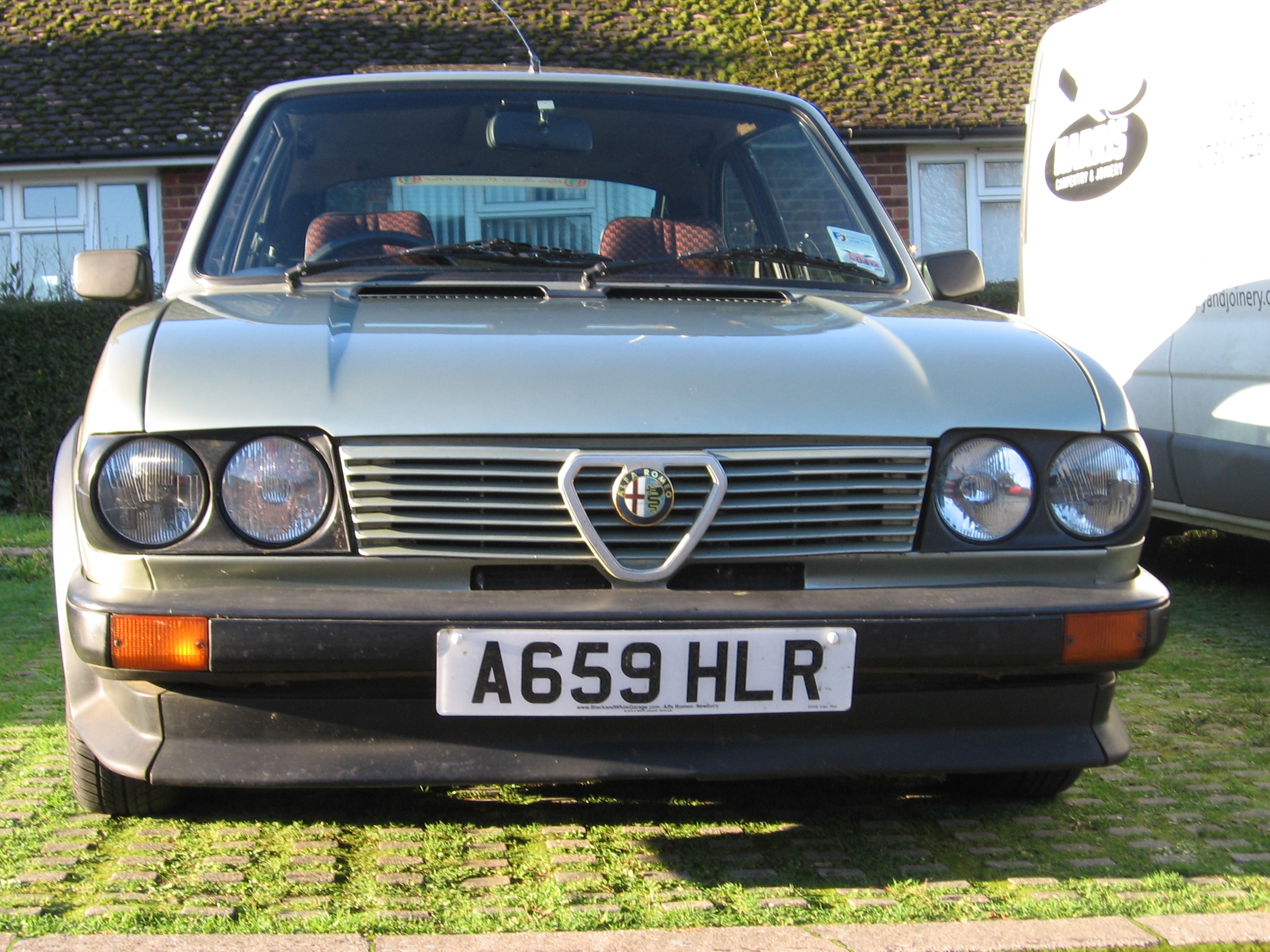

I've a road going 1984 Sud Gold Cloverleaf that is lowered and has too much negative camber up front.
Any reasonably priced solution for top mounts?
Or has anyone created adjustable camber at the bottom of the strut?
