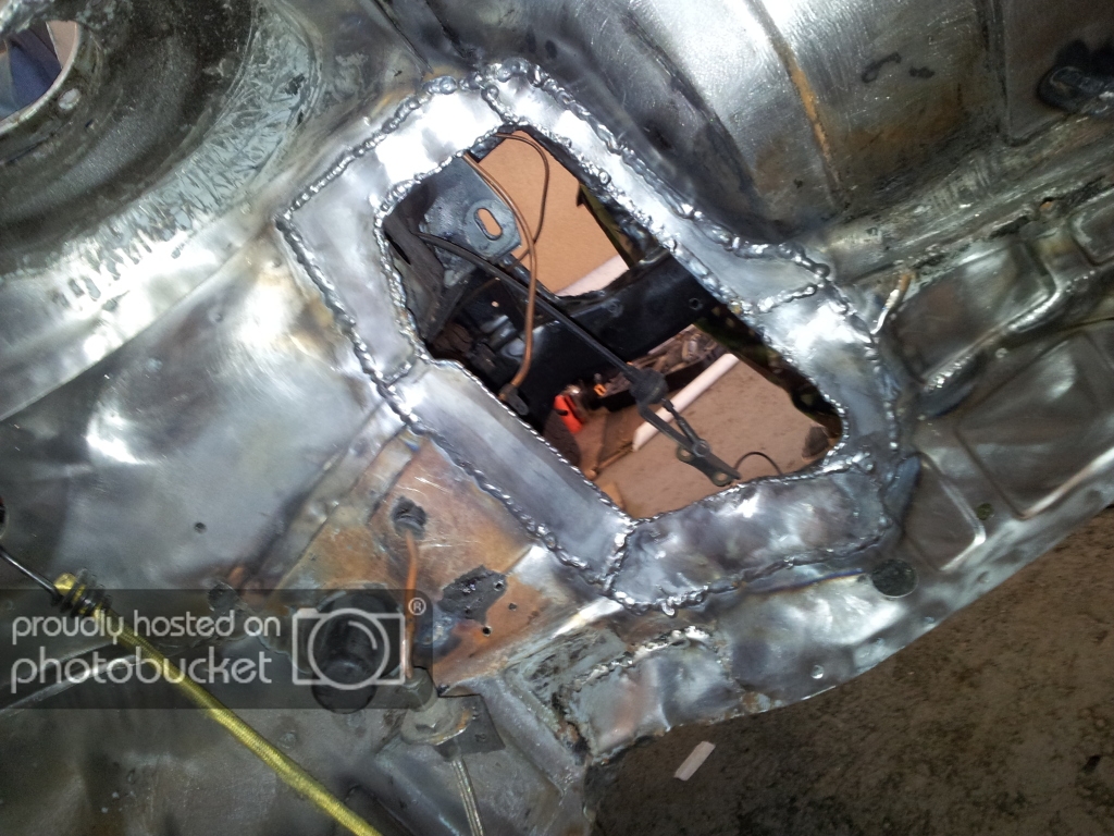

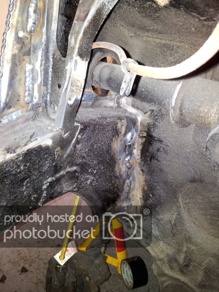

My car was showing signs of fatigue at the front end, there were stress cracks on the inner wings around the aperture where the steering-arms poke into the wheel wells so we carried out the following strengthening mods.
Plated around the steering arm apertures

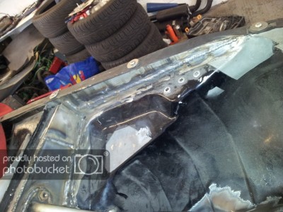

Welded in Alfa 33 braces which run from the intermediate bulkhead to the chassis rail.
Fitted a transverse strut brace and tied it into the intermediate bulkhead

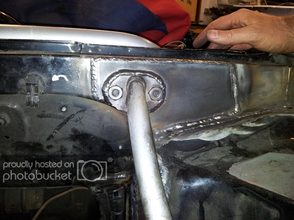

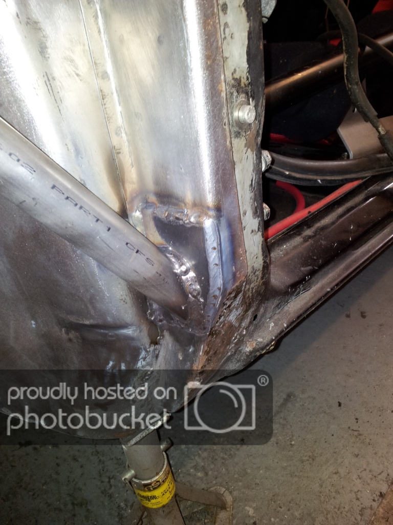

Welded in roll cage tube from the lower A pillar to the underside of the inner wing rails

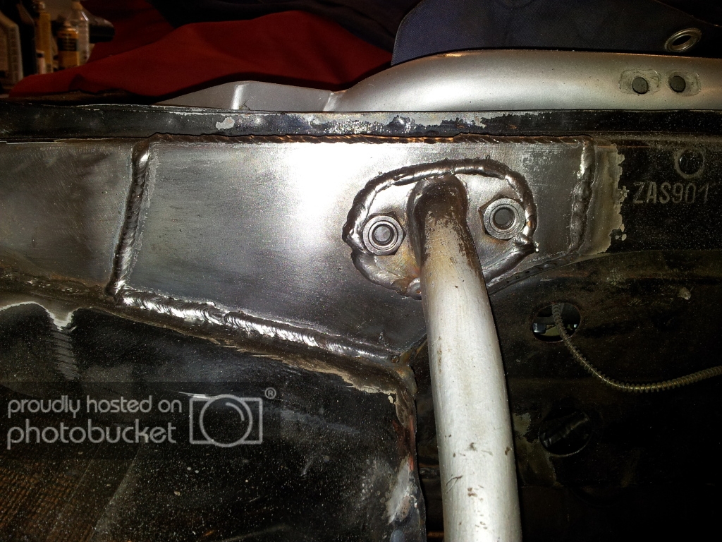

Ran roll cage tube through the fresh air vents to connect the roll cage to plates welded to the strut tops.

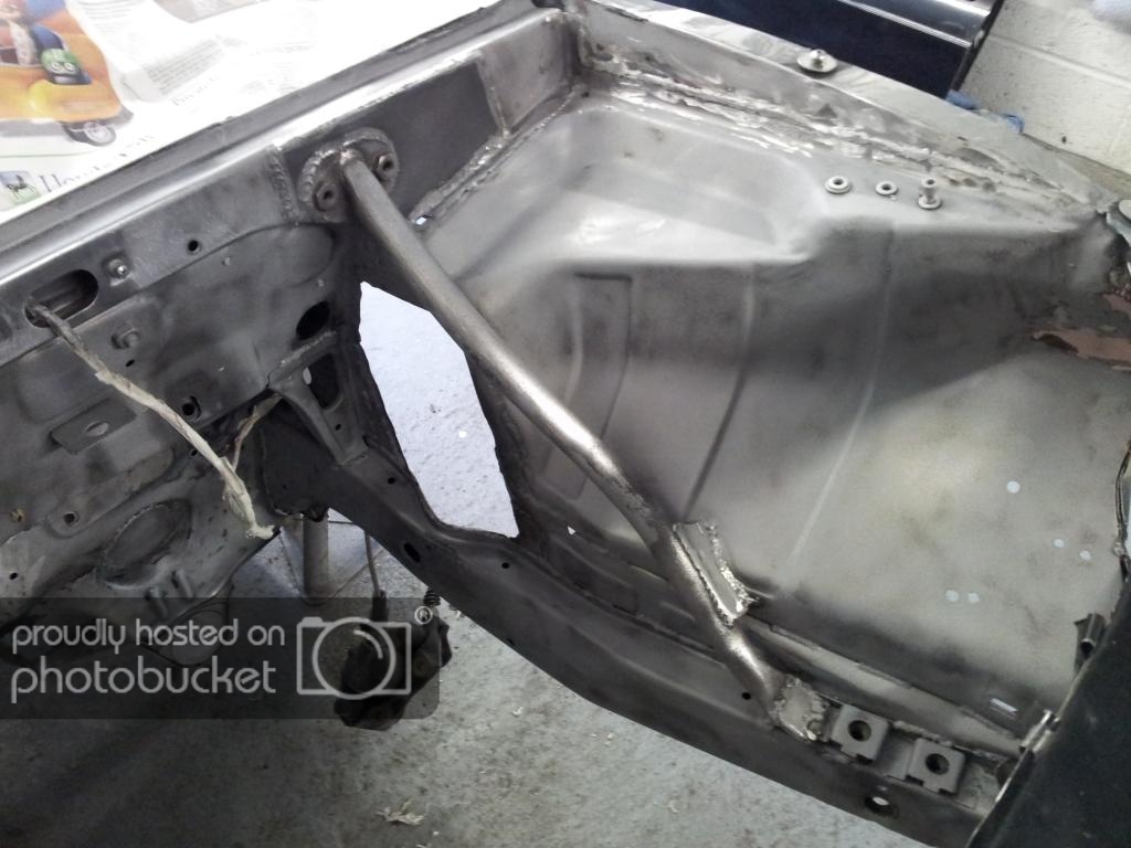

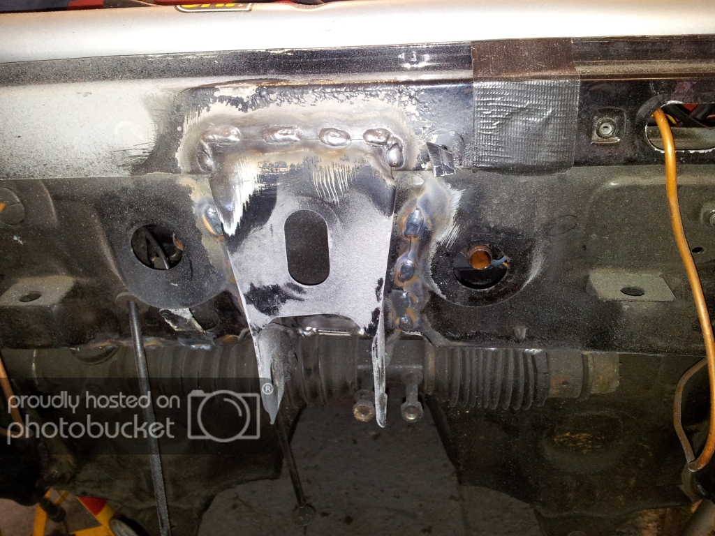

First two are around steering arm apertures where we found the stress cracks

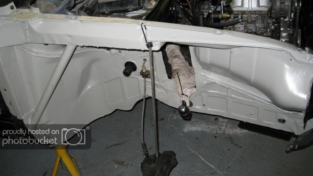

Next four show how we attached the Alfa 33 bars including an additional plate on the intermediate bulkhead

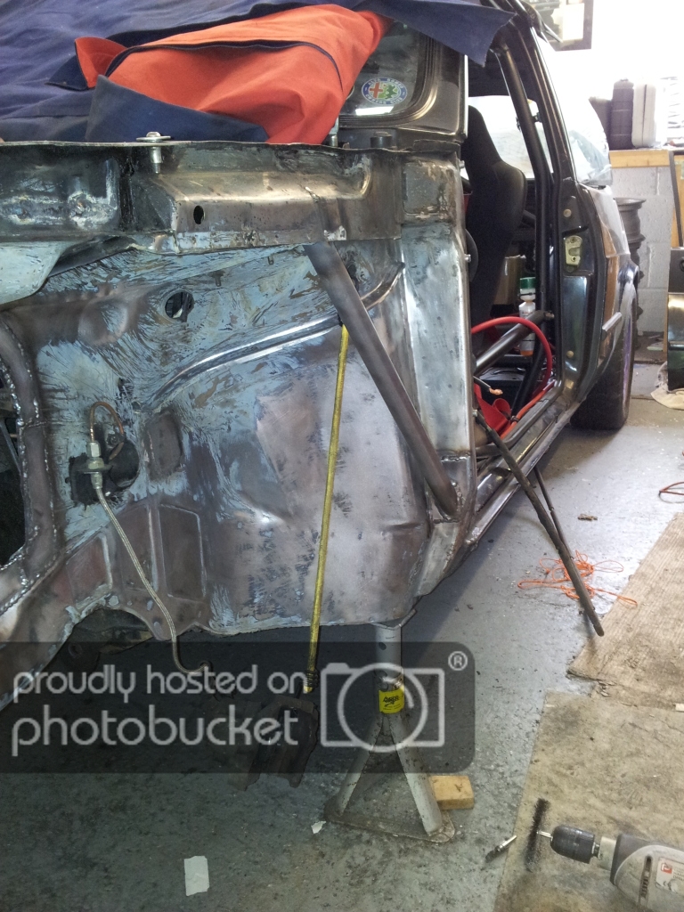

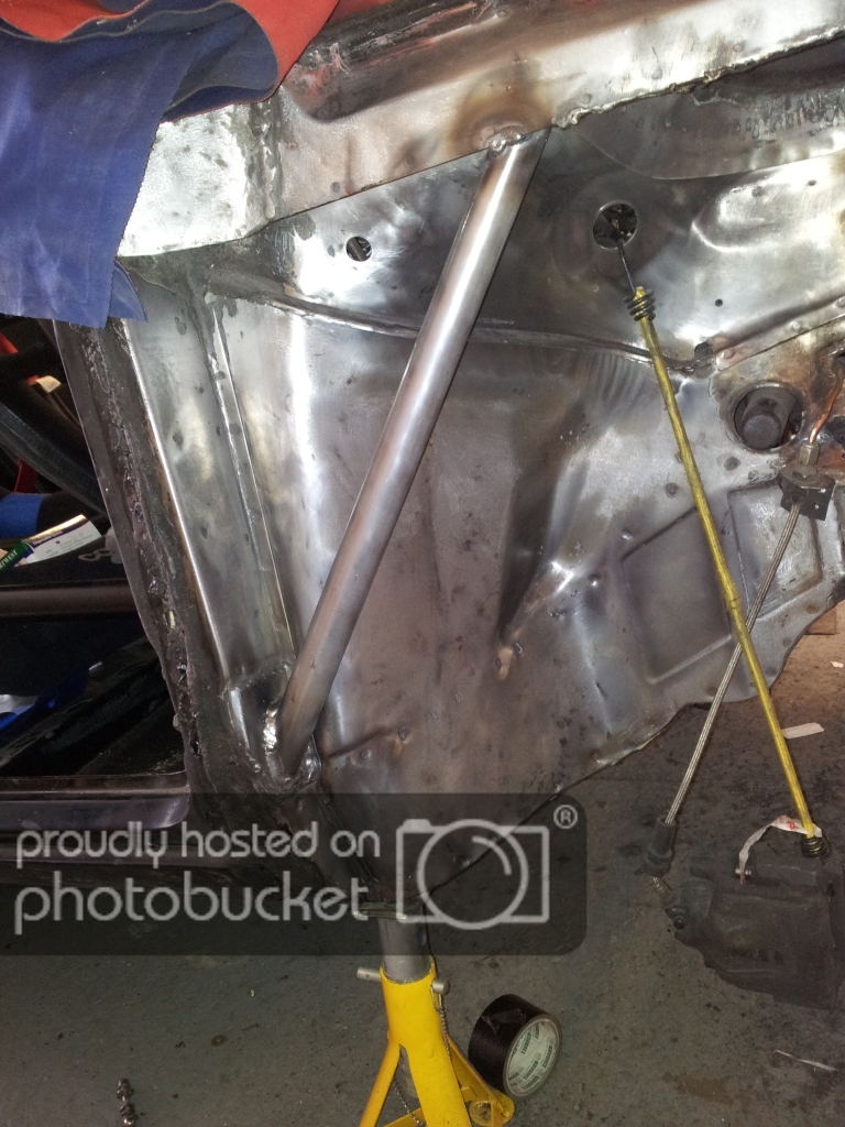

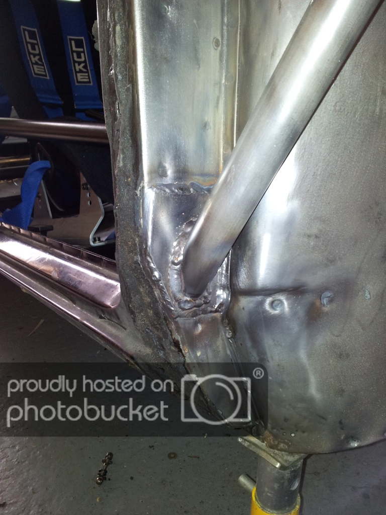

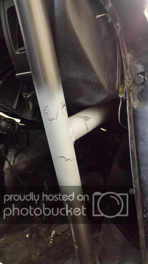

Next four show the roll cage tubing brace from the A-post to the underside of the wing rail
More to come.

Upper engine mount
Chassis rail

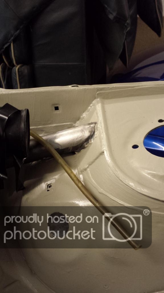

Cage extension to strut tower - attached to a plate attached to the tower
Cage extension view from inside the cabin - it did not go through the fresh air vent as I mistakenly said before, we made a new hole.
We also seam welded along the engine bay side of the inner wing rail and where the inner wing attaches to the intermediate bulkhead
It was all then coated in two-part epoxy sealing paint.
