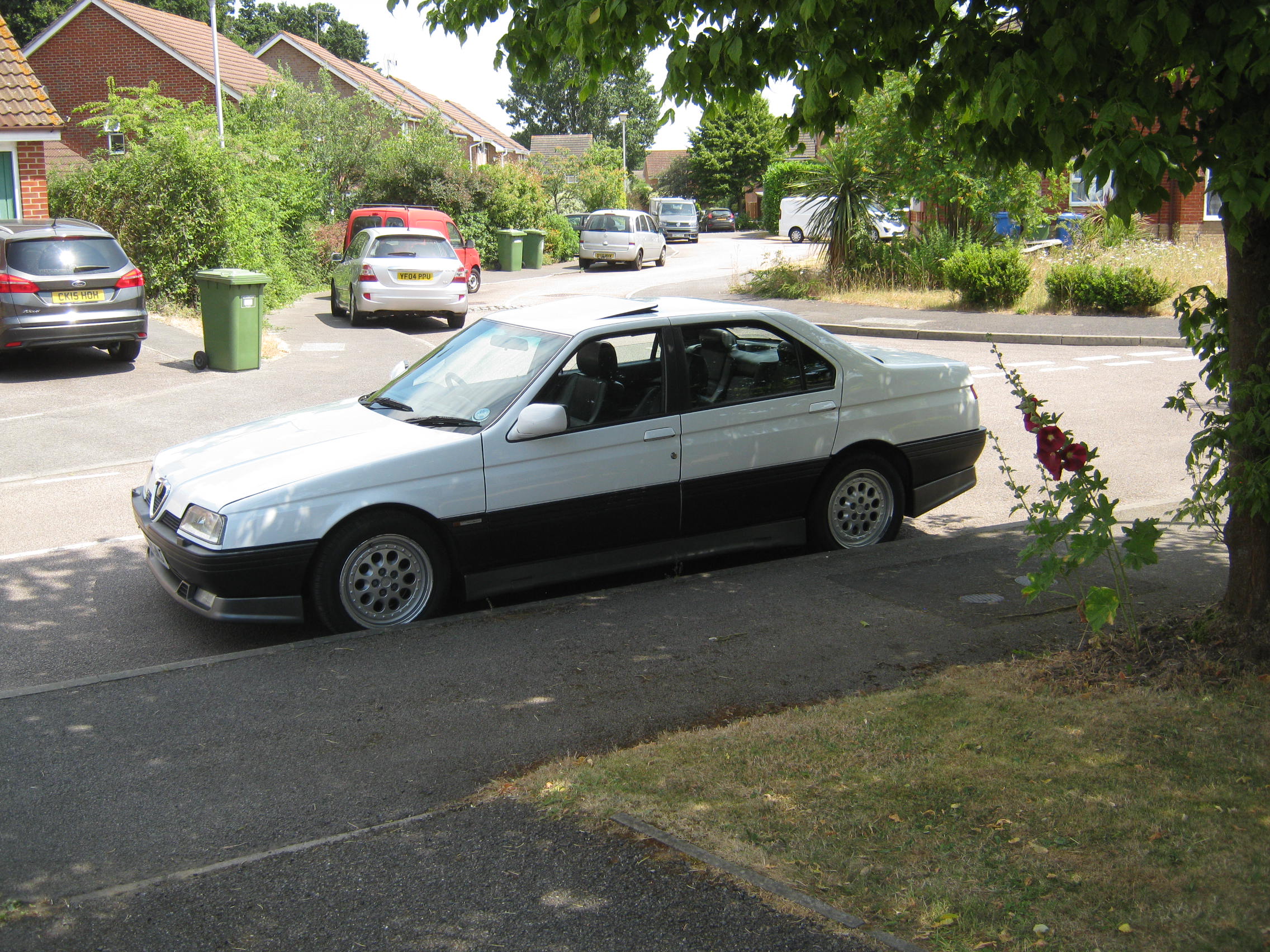

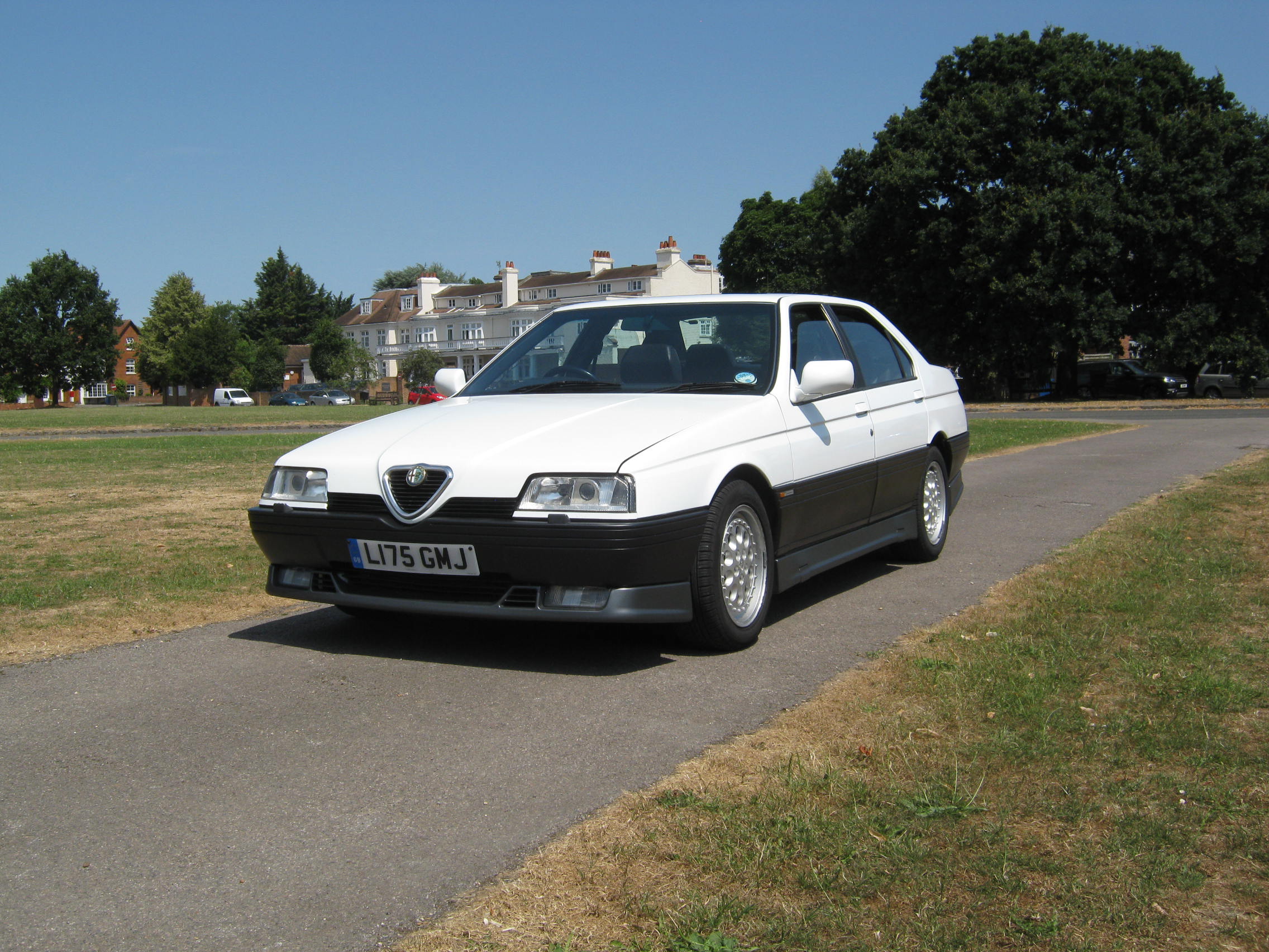

Hello Everyone,
Hope you are all well and enjoying a 'fruitfully-Alfa summer' midst all this gorgeous weather (can this really be England?).
Apologies big time for the long absence from the forum. I see there haven't been any 164 postings since my last one so presumably I'm flying the 164 flag alone these days? I keep hearing that there are only around 6-7 Cloverleafs currently on the road (no idea how many are on SORN) but surely that can't be right?
Anyway, the absence was due to a very prolonged and involved conversion on my late mother's 1985 Opel Monza GSE from Bosch LE-Jetronic to Bosch Motronic fuel injection and although I know it's possibly tantamount to treason mentioning something Teutonic on this site (the car's affectionately known as the E-Boot, by the way) BUT at least it was named after an Italian racetrack (ok, the only defence I could come up with at short notice...).
Anyhoo...seeing as my 164 'Leaf has always (certainly for the last few years anyway) been undergoing what's jocularly known as a rolling restoration, I've been resigned to the occasional 'big, bad bill' every once in a while but Christ do they keep coming! Although she looks a whole lot better now after last year's makeover we always have to subscribe to the view that classic cars remain forever 'works in progress'.
MOT time Sept '17 threw up two areas which have turned into sagas with 'momentum'!
Firstly, more rust in the chassis! I suppose that me whingeing about the fact that these cars were galvanized from new won't cut any ice today, twenty-five years on! Presumably even galvanization has its own shelf life. Actually, it wasn't too bad - just some more attention to the N/S/F jacking point.

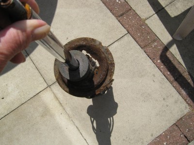

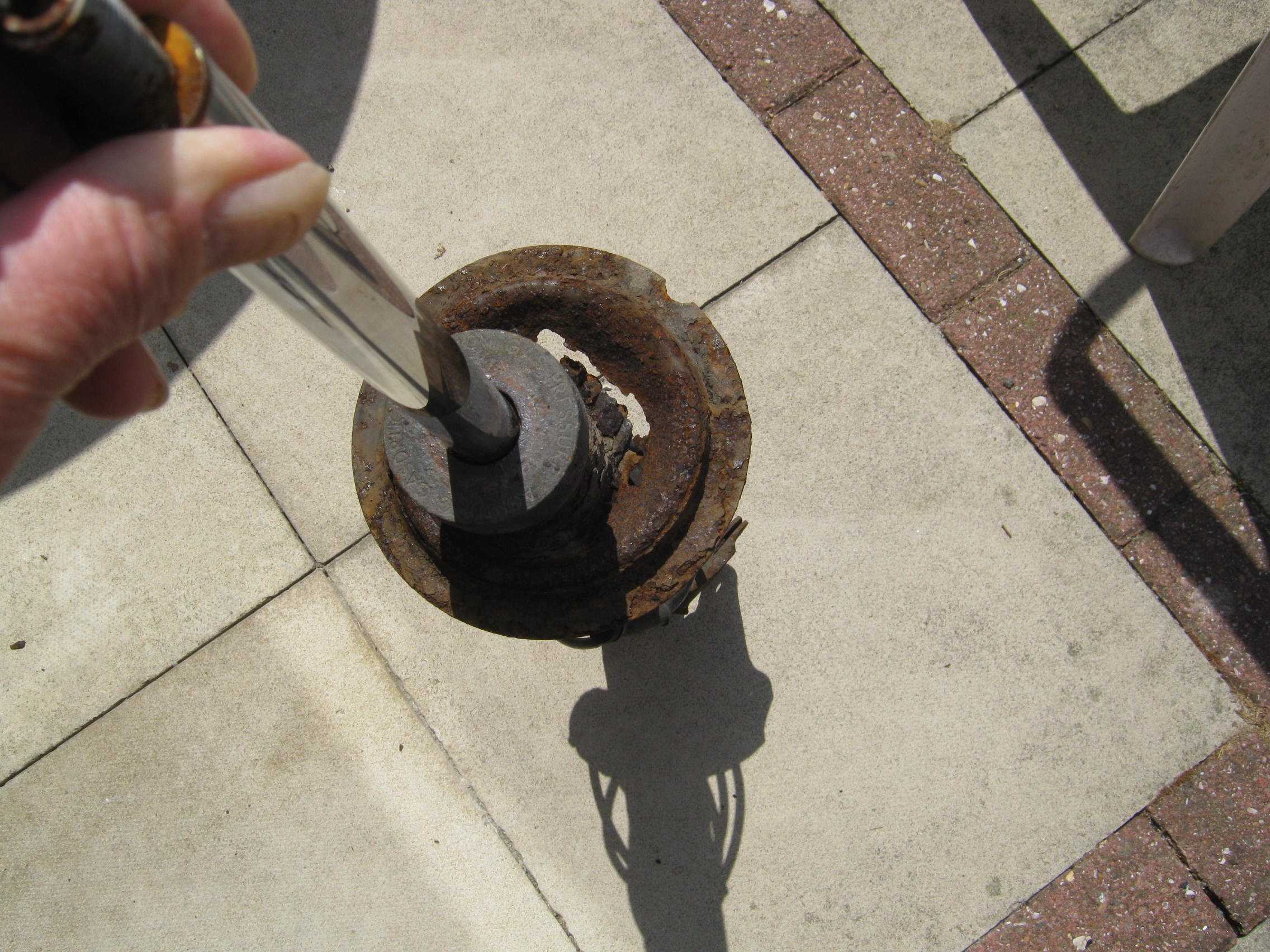

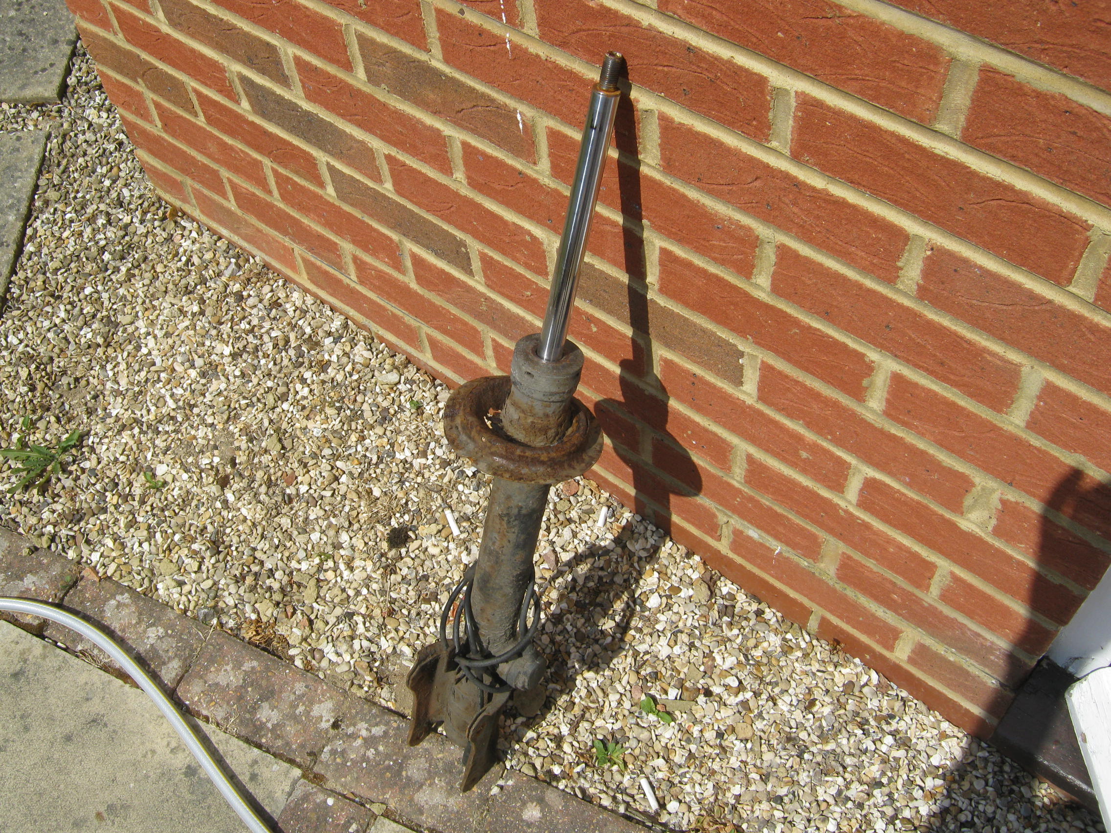

Secondly, shock absorbers!
God, the 164 Cloverleaf is a complicated car! Not only are they two-position electronic dampers (reasonably cutting edge at the start of the '90's, I suppose) but they are are also 'handed' left and right. Not only that but the fronts differ from the rears in that the spring mounting plates are separate to the dampers at the front BUT form an integral part of the rear dampers!
So, WERE you to need to replace the spring mounting plate on a REAR damper you're faced with cutting/grinding the old plate off and then welding a new one on in its place - welding a gas-filled damper? Not something I'd want to do! Now have a look at the attached photo of the O/S/R damper to see what I'm waffling on about. Pretty, isn't it.
Eight months later and it's the five-yearly cambelt change (I tell you, five years seems to come around in half the time these days) and up pop two more accompanying problems - surprise, surprise, rust in the rear wheelarches and a leaking shock absorber (this time the other rear).
Fortunately, a 'new old stock' rear damper was procured from Italy (thank you to Alfa Aid in Maidenhead for that) and, six weeks later (the Italian postman took ages) I've been reacquainted with She Who Must Be Obeyed (one day I'm going to learn how to write that in Italian).
Did I say the 164 Cloverleaf was complicated? Tell you what - if you ever glimpse one when it's up on a four-poster just take a peek at the underside. What IS going on under there?!! Looks like no car I've ever seen.
I would hazard a guess and say it's probably on a par with the late 1990's Maserati Quattroporte 1V in that respect. Other than one being RWD while the other is FWD I'd say there's not a great deal in it. Actually, if there's one machine that could really tempt me away from the 'Leaf it would be a late 3.2 Evo Quattroporte. In fact, there is one such car (and a super-rare six-speed manual to boot) in the classifieds as I write this BUT - however tempted I might be I feel the rolling restoration costs of one of those would makes my Alfa bills pale into insignificance by comparison!

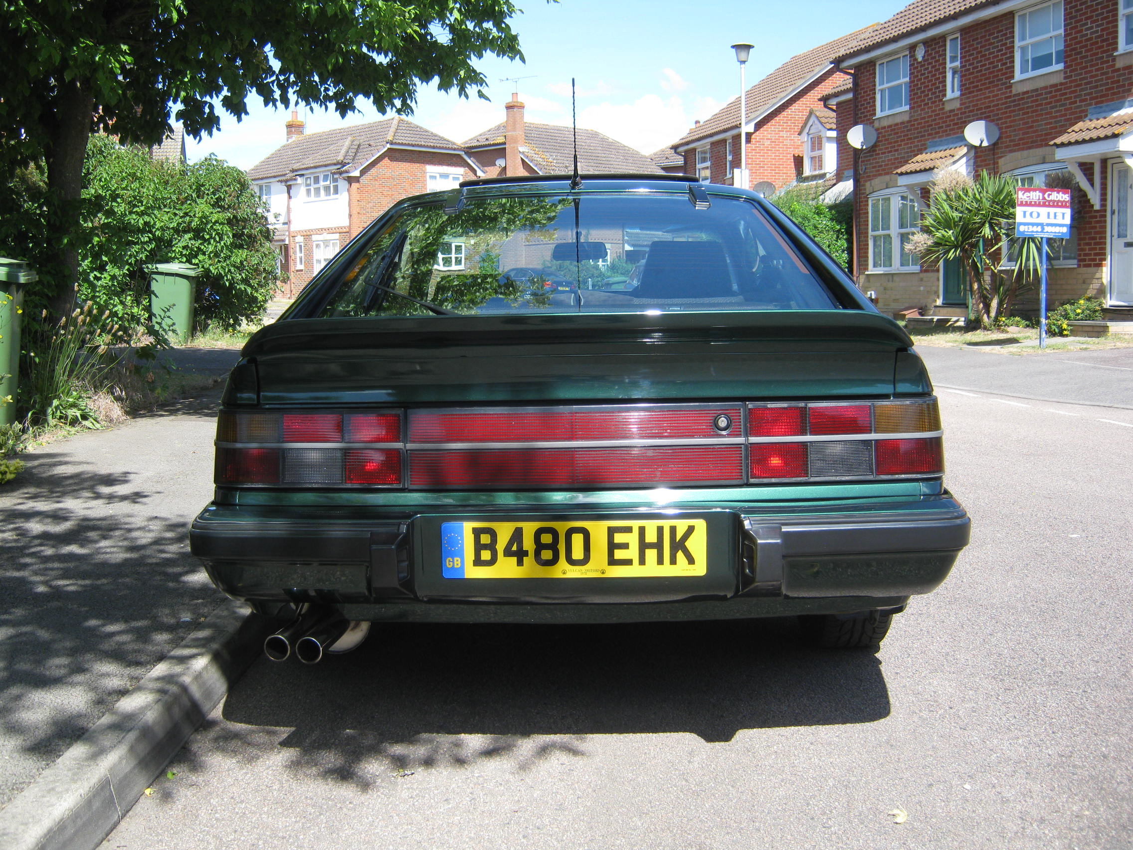

Thanks for the appreciative comments on the Opel Monza (another rare one these days).
I recall a red one campaigned, for several years actually, by a driver called Gavin Cox - particularly remember seeing him on the Lombard RAC Rallies in the early '90's. It seemed a big car to be throwing along forest stages in those days but Gavin knew the car very well and made a spectacular job of it. Not as noisy as that Commodore of Peter Brock, of course, but a good, grunty, angry sound nonetheless and being RWD, heavy and with a normally-aspirated straight six it was a great sight to watch. Found a couple of not very good photos of Gavin's car. Obviously needed a better class of damp start in two of them but they were all I could find!
Ari Vatanen's Manta 400 sounds great at full chat on that Manx Rally clip too. I've got the whole video "In-Car Manx '83" and what's also impressive is how fast Vatanen keeps going even when the N/S/F tyre is well and truly airless towards the end of the stage ("Keep your eye out for Jimmy" - co-driver Terry Harryman advises Ari - no worries!).
Almost want to cry at where we're going these days with diesels, hybrids and electrics when you hear proper engines at work!
Incidentally, upgrading the Monza to Bosch Motronic fuel injection (taken from the next generation Senator - with the cheese-cutter front grille) was really worthwhile as Mum's car now runs cleaner, more responsively, more economically and more rapidly too - a good all-round boost thanks to a Lambda probe and a much more sophisticated ECU. All that simply from more efficient combustion! So, much quicker than before but still nowhere near a match for the 'Leaf - especially where overtaking power is concerned. That 24V, quad-cam Busso makes the 164 a very dangerous opponent out there. And virtually no one knows what it is! Don't you just love a good Q-car?
