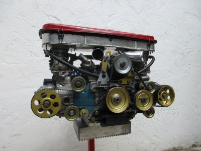

Some years ago I bought this 8V heads from Bryan Shrubb.
I took me some years to bring all the parts together I needed for a new 2000 cc engine.
It has a steel crank with 80,3 mm stroke, steel conrods, forged pistons for 89,0 mm bore, large capacity oil sump with mouse traps and a custom made airbox
A new custom made ehaust manifold was finished last week..
Now it´s time to get the car running..

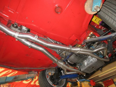

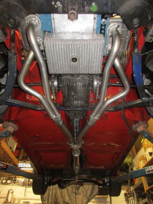

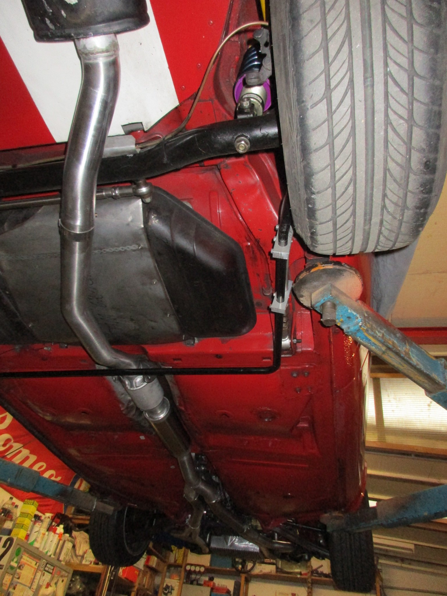

Hello Ali
Do you have any photographs of your complete exhaust routing?
I seem to remember that your exhaust (used to) run directly rearwards without going up and over the axle, however I am easily confused.
Thanks
Adam
902a
Posts: 85
Joined: Wed Feb 05, 2014 12:35 pm
Location: Germany
Re: 2000 cc engine
Post by 902a »
Using the 33 905 rear axle there is enough room underneath..
