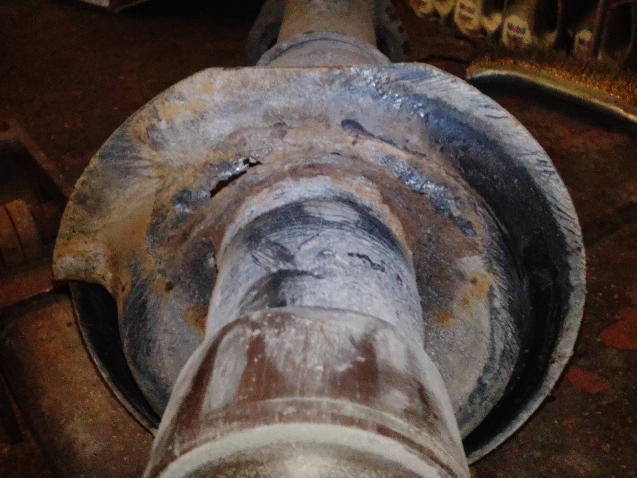

The bottom spring pan had completed rotted away from the strut!
Only the bracket that the anti-roll bar link mounts to stopped it causing real mayhem. The blue line shows where it should sit...
Once taken off tonight the corrosion was shocking, it must have been holding on by a thread all this time, only a very small section was clean showing it had been rusted for some time, hence the leaning to one side....

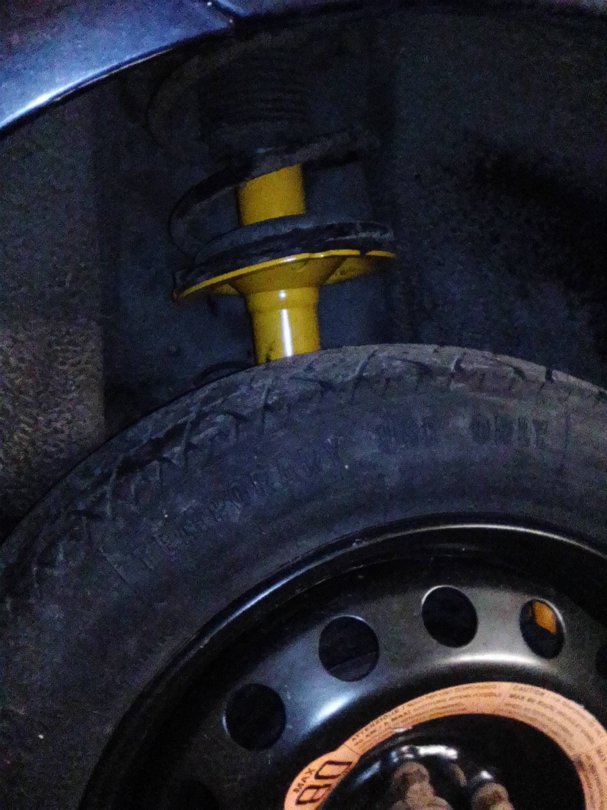

New one fitted, now sitting higher than the tyre!

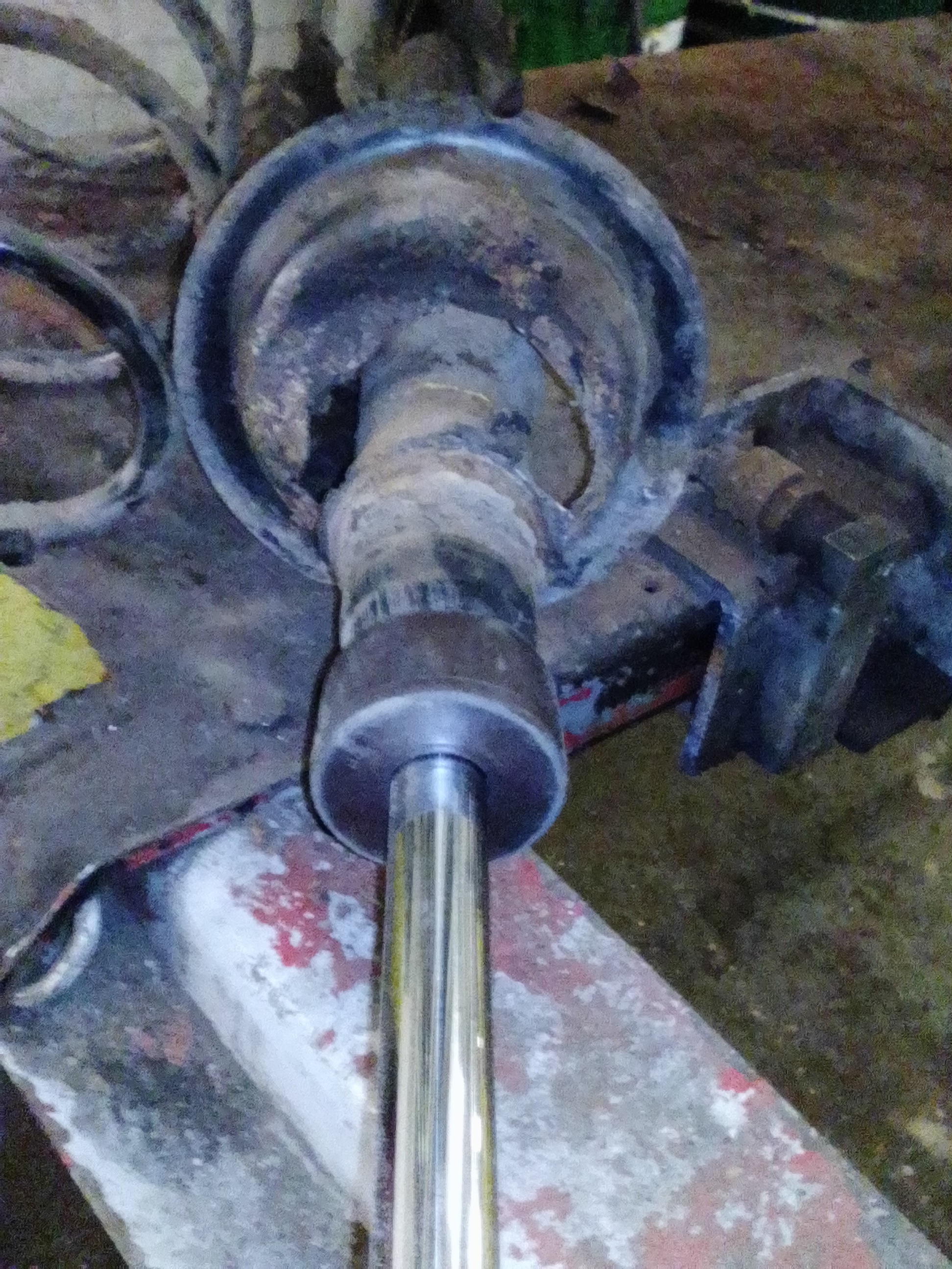

As the shocks were original thus the same age I wanted to change the pair despite the passenger one looking fine..
When I got it off and stripped down though the rust had started to get into that one too, cracks and rusty strips around a 1/3 of it too!
Glad I did them both, although looking under the car it looks like I'll be welding some sills on soon too....

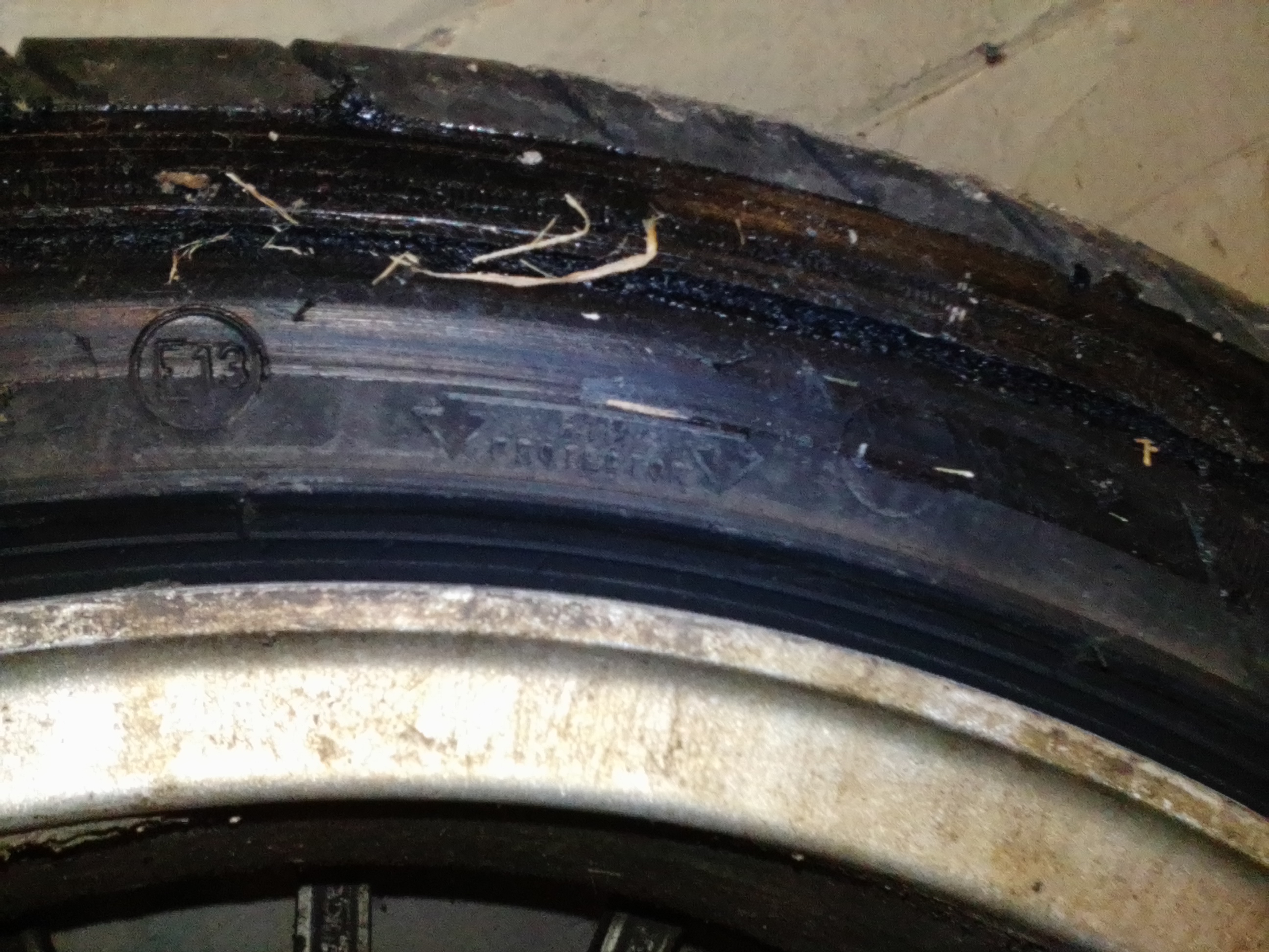

This ignoring of the potential problem though has cost me a decent Goodyear tyre, the spring pan grinding a groove in the sidewall :(
