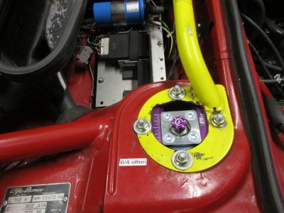

My new coilover struts..
Ali
Re: Suspension setting / improvements
That looks very nice.
Looks very nice. Whose suspension is it?

rsfruitbat wrote:Looks very nice. Whose suspension is it?
KW Competition

Expensive?

rsfruitbat wrote:Expensive?
Not cheap as custom built. Many woud buy a secondhand car for the money I paid for 4 struts
Just checked, a set for my integrale is about £1,600...just curious, not serious as only a road car.
They do have a good reputation for quality though.
