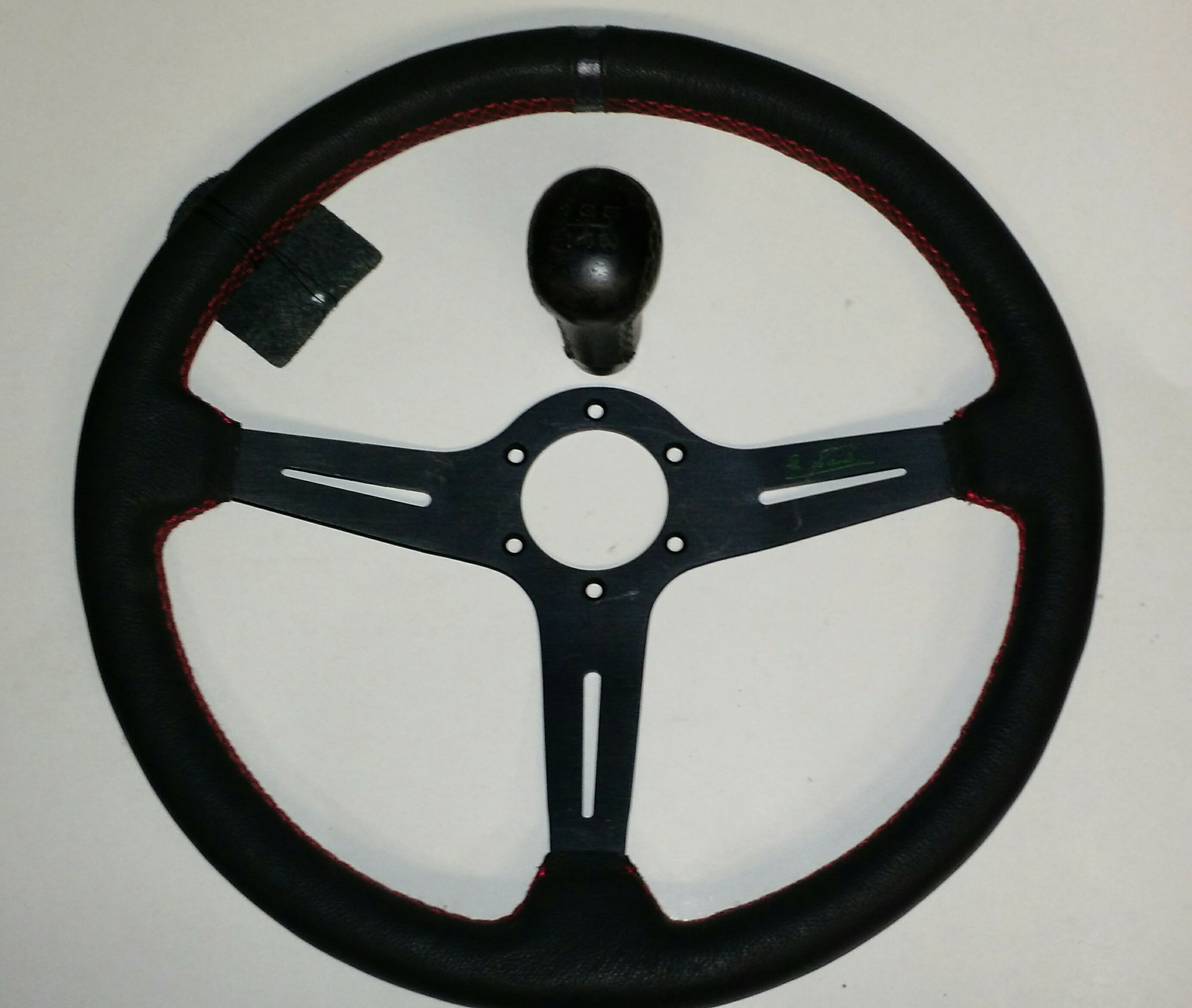

Does anybody know if thefiting for the steering wheel is different between the 33 and my S3 Sprint? I have inherited a lovely Nardi wheel which I may use with the Momo leather gear knob I had previously on another car. However I need to buy a boss kit and don't want to make another mistake...... I take it to get a fitment the measurements are the same as per a wheel i.e. centre bore, pcd/number of bolts etc. Also - what are the thoughts on the quick release style as I like the idea of these from a security perspective.
Or I also have the option of the wooden combo. Pictures of both attached.

33 and sud/sprint are different, yes.
The sud/sprint have a three bolt attachment whereas the 33 has the more normal spline system.
Your wood wheel will fit the sprint - 3 bolts.
The leather wheel will need a boss kit - difficult to find for the sprint but not as rare as hen's teeth.

I have the Nardi part numbers and they are:-
Alfasud/Arna (which presumably covers the Sprint)
4302.14.0101
4370.95.0101
Alfa 33 up to 1987
4347.00.0105
The one for the 33 is definitely different going by pics so I will rule that out. I presume if I can fins a universal with the correct 3 bolt fitment and PCD it should be OK. The OMP and Sparco look as though they may do the job.
I realise the wood one fits incidentally - just not sure which to use in my car so was looking for opinions. I quite like the wood but just not sure how it will fare in my car.

Note that the Nardi and Momo have slightly different "stud patterns" so don't get a momo boss kit for the Nardi wheel.
(I do have one boss kit with both sets of screw holes - fits both Momo and Nardi. Not sure but it might be the OMP brand?)

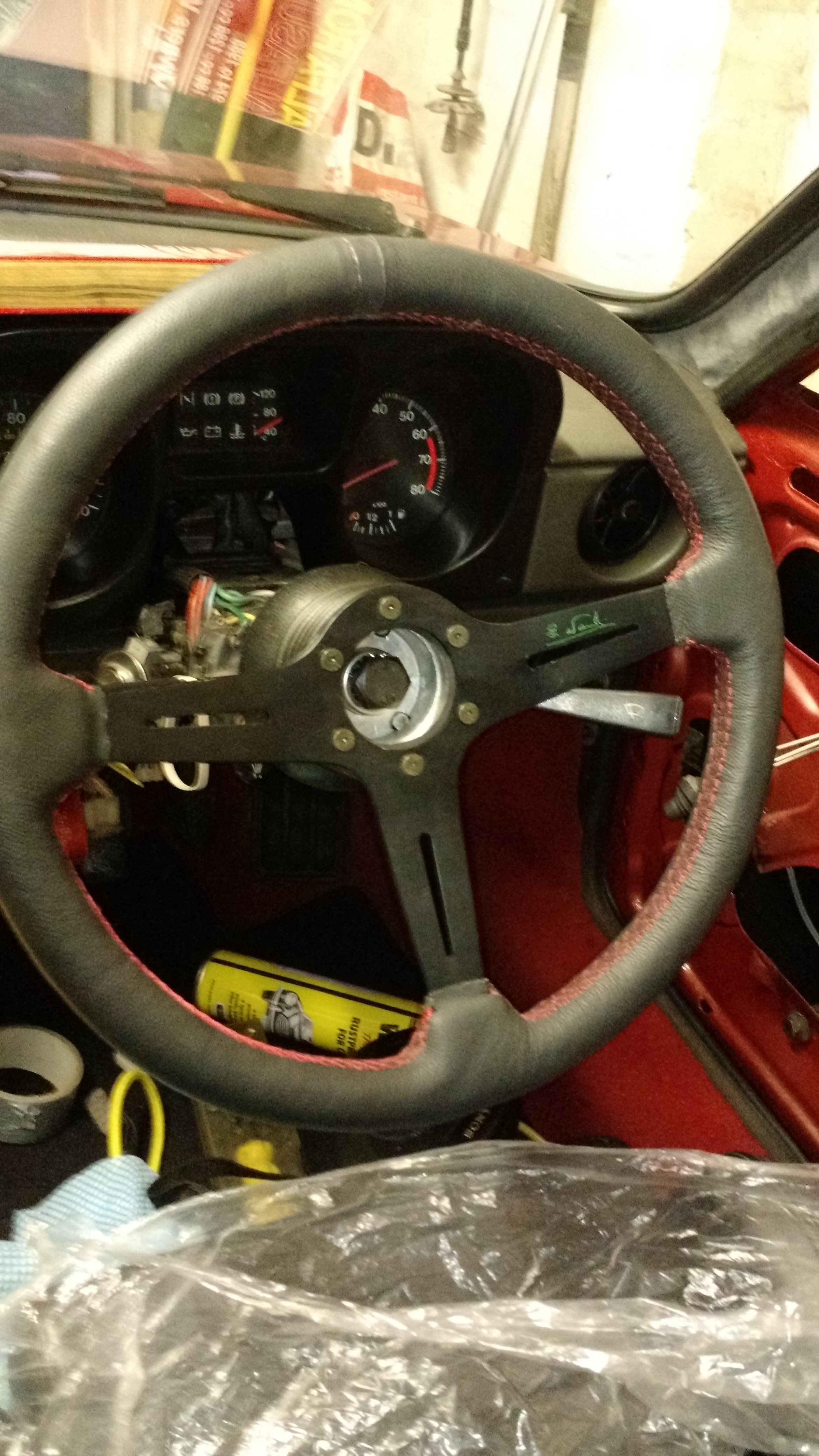

Just for the record, I have picked up the Luisi hub and it fits perfectly. Looks great too. Job done.
All I need is a badge for the centre of the wheel - I think a 159/Brera wheel centre should fit if I can get my paws on only 1.....
Si puo diventare Alfista
StescoG66
Posts: 298
Re: Steering wheel boss - differences
Post by StescoG66 »
Fits quite nicely I think :-)
