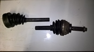

Did an event yesterday and had a driveshaft snap in the middle. I have had a CV let go and the splined end on the shoulder snap.
Anyone else had this happen?
Thanks for posting pic Shrew.
What do the racers use? one -offs or is there a better shaft to pick or does something from another car fit?
I have been told there is a larger outer CV shaft but when i tried fitting it to my setup the CV boot was catching the stirrup on the lback end of the leading arm. I may try fitting 33 front arms to see if this creates a bit of "air"
any suggestions on where to go appreciated

Where your driveshaft snapped there is normally a raised land. I can't see that on your failed driveshaft?
I don't think the driveshafts we are using when racing are anything special and we have big vented inboard discs with hi spec 4 pot calipers.
