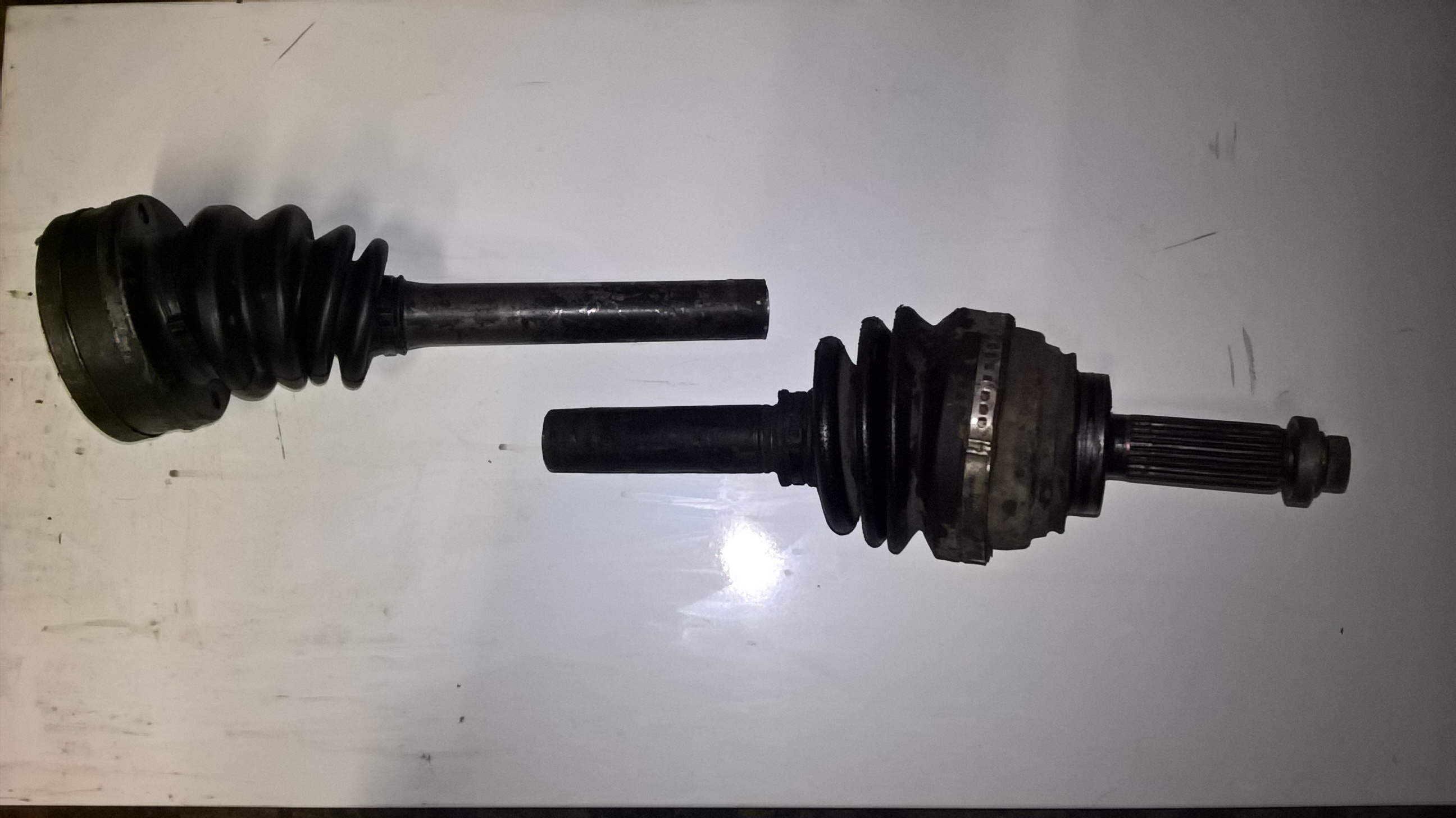

Did an event yesterday and had a driveshaft snap in the middle. I have had a CV let go and the splined end on the shoulder snap.
Anyone else had this happen?
Thanks for posting pic Shrew.
What do the racers use? one -offs or is there a better shaft to pick or does something from another car fit?

Where your driveshaft snapped there is normally a raised land. I can't see that on your failed driveshaft?
I don't think the driveshafts we are using when racing are anything special and we have big vented inboard discs with hi spec 4 pot calipers.

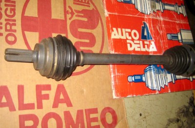

This Autodelta one advertised on Alfasud Parts has a slot cut in it.
I guess that if you screw a bolt into the end of the shaft the slot allows the splined section to expand and grip the splines?

That is curious. I know that Alfa changed the torque specification on the hub retaining nut, but I haven't seen this before. I would have thought the factory would specify some sort of fillet lock (you know what I mean, like thread locking compound for close-fitting parts) before doing something this radical.
That said, I can't imagine slotting the driveshaft at this point would make a significant difference to the overall strength.

That looks just like my one ! That has surprised me as I have found so many odd bits I just thought it was yet another.
Re: Driveshafts
Cripes I just looked at the price for an extra slot in the end. Hacksaw out in the morning I think.

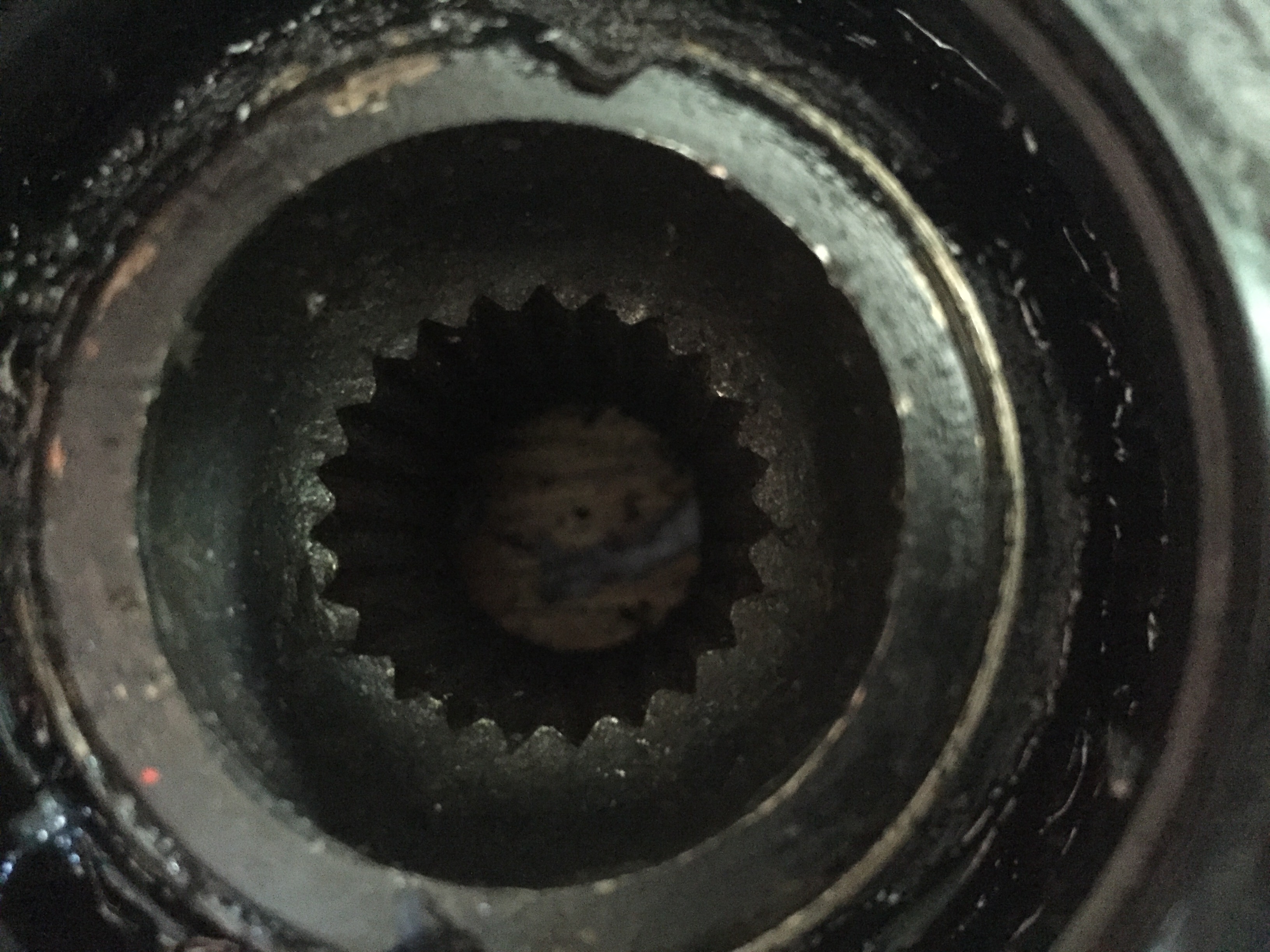

If anyone gets a chance can they count the number of splines / peaks on the pointy end of their outer CV joint please????
- Posts: 976
Re: Driveshafts
I make it 23 slots for driveshaft splines to fit into.

The hub is from a 1974 1.2 ti. Just in case there are differences amongst models.

Chatting to Dad today, he said that all very early Sud driveshafts had the slot - so beware that they may be upto 46 years old! He couldn't recall when the slotted version dissapeared.
Re: Driveshafts
23 splines on mine. Was autodelta stuff much better then back in the day ?
Re: Driveshafts
Autodelta was Alfa's in-house competition department - though the driveshaft slot wasn't an Autodelta thing, it was early mainstream production.

everything i have got is 23 outer splines as well

Just resurrecting this thread. Still having problems with driveshaft breakages.
Any suggestions on where to get updated versions from for inboard brakes. I have had inner c.v. Fail, shaft itself, but most commonly th splined section of the outer cv as it goes into the hub.
