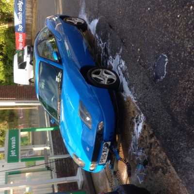

I got this back in May been collecting bits for it.......main dealer items the timing belt has gone
One owner from new
Totally std

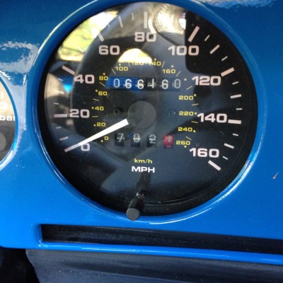

66k on the clock with history but belt change
Just had a spare head skimmed reseated the valves
Alloys will be back from refurb next week
The plan for it is black leather already had it, replace rear brakes, paint calipers red, replace exhaust as tail pipe is missing.
Engine will be getting new big end shells, refurb'do cylinder head, timing belt kit, aux belts with all pulleys, water pump and full service.
Get the few small dents and paint sort

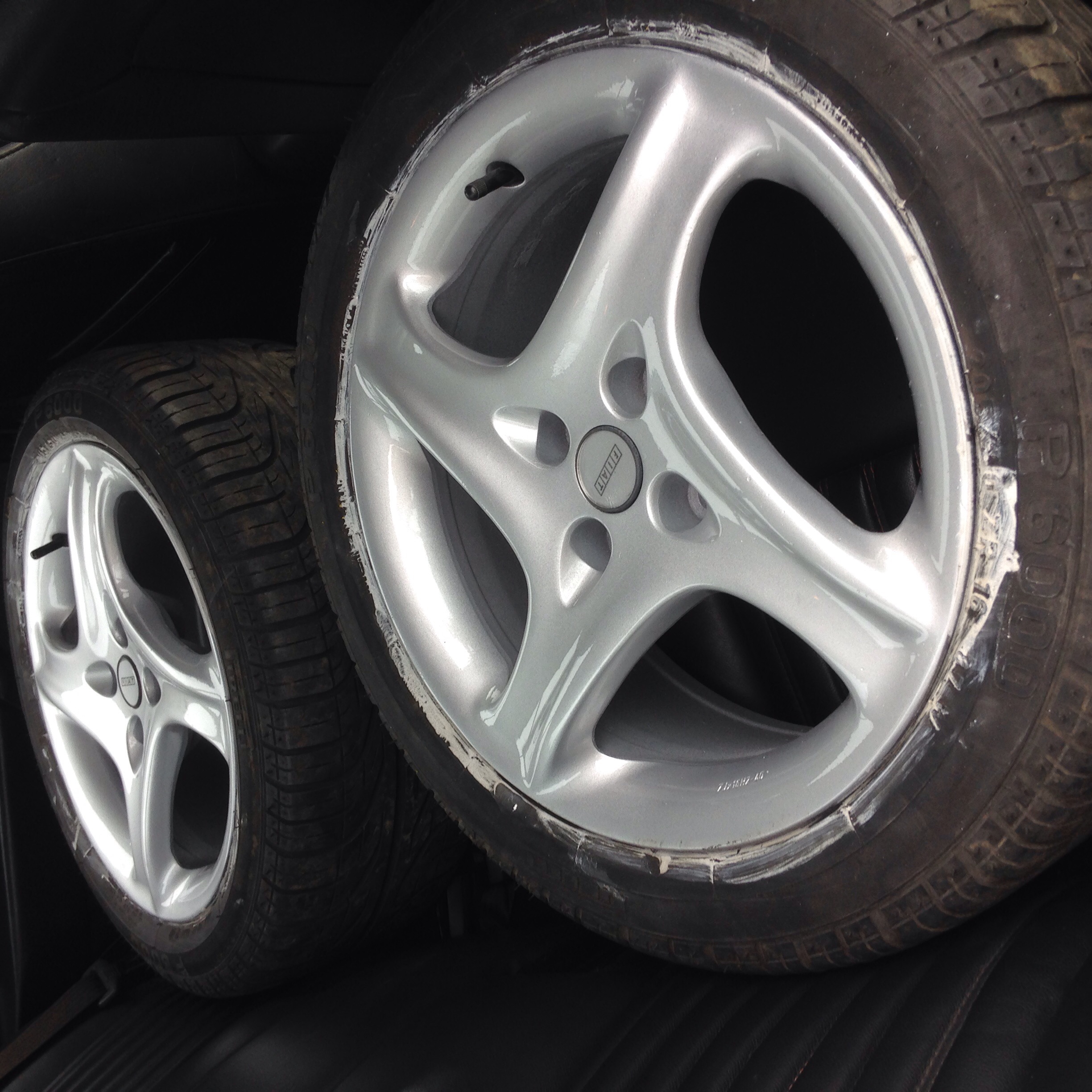

Collected wheels from being refurb last night

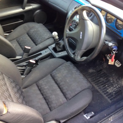

Fitted leather seats, front number plate, rear discs, rear pads, both hand brake cables, wiper blade, replacement rear light with cob light rings in them, refurb'd wheels on the back, bonnet gas struts, put front on axle stands and removed front wheels
Re: Fiat coupe 20vt
busy day there 8-)

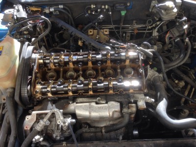

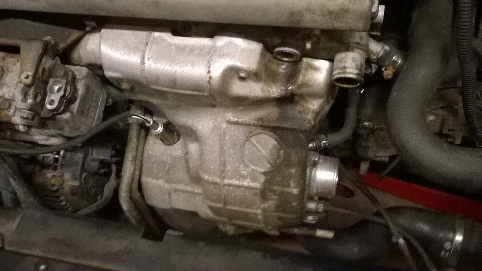

A couple of hours work got done on it today. All the inlet manifold, cam cover, cooling fans, water pipes, wiring, intercooler pipes & battery tray removed
Check the cam belt
Re: Fiat coupe 20vt
I'm guessing a new belt required then mate! :shock:

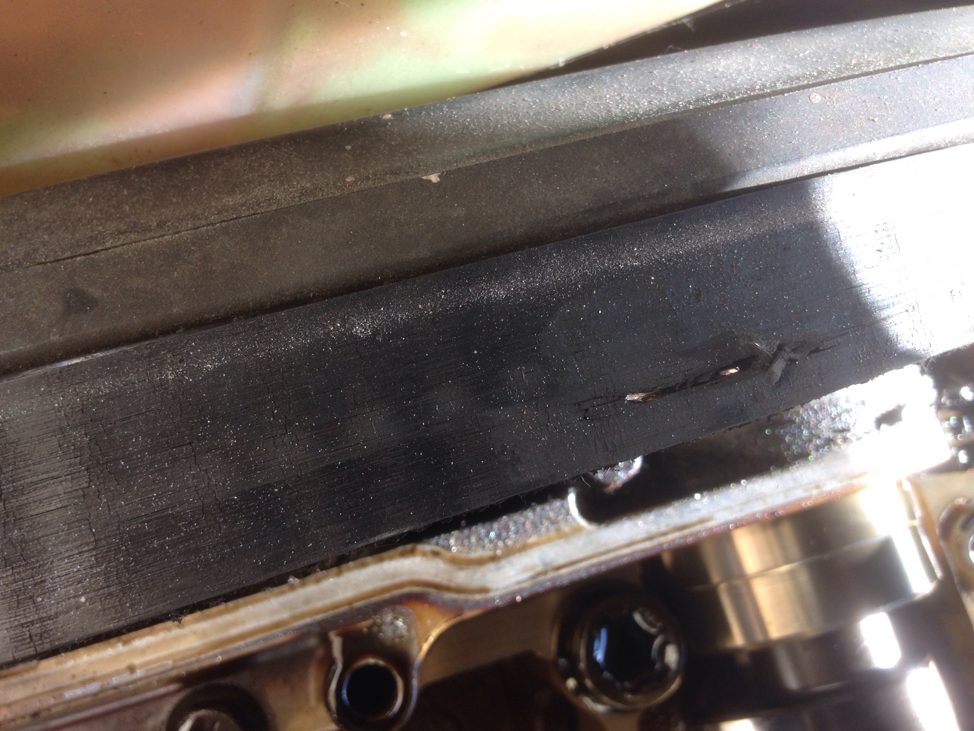

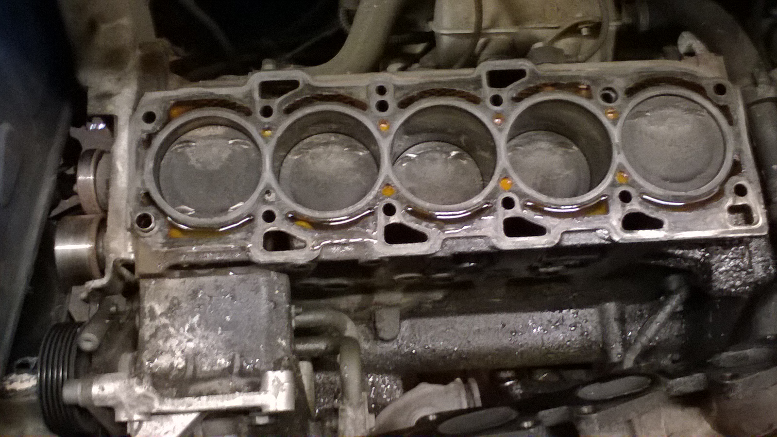

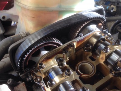

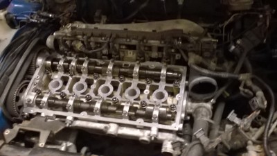

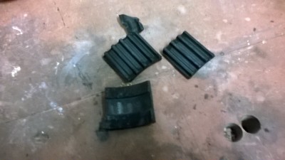

I had a few hours down the workshop yesterday morning got the head off the plastic tensioner had broken up and was in the timing belt cover.
Had to look after the kids in the afternoon so I rebuilt the cylinder head swapping over studs, cams, inlet manifold with injectors and new water pump then timed it up with cam locks
The exhaust manifold has a crack in it so will weld it for now as the spare one is 90 miles away in storage
Re: Fiat coupe 20vt
Productive day :D
Re: Fiat coupe 20vt
the 20VT's are buggers for cracking manifolds as i'm sure you're aware. I too welded mine up for the 145 conversion, as far as I know it's still on there so they can last a while after welding..

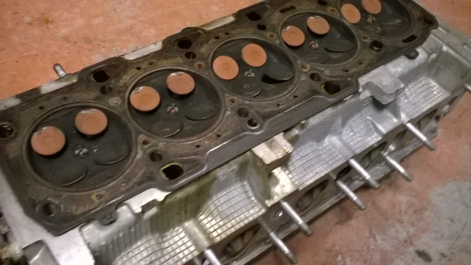

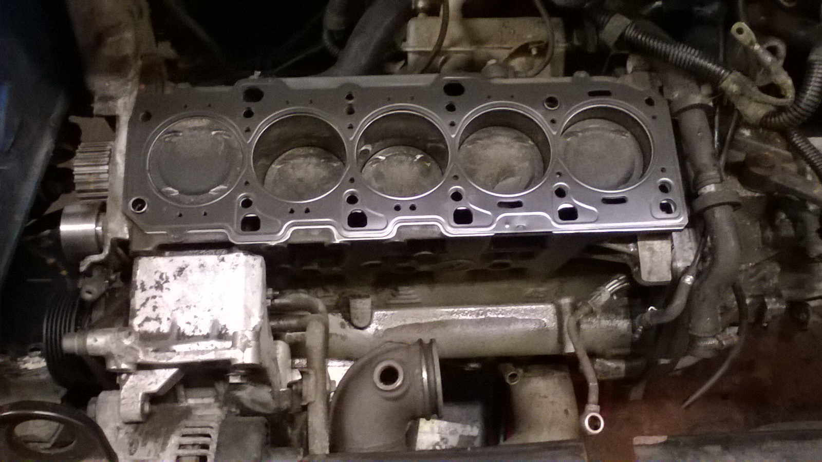

A few photos from Sunday
Re: Fiat coupe 20vt
bendy valves :)
alfachris
Posts: 489
Re: Fiat coupe 20vt
Post by alfachris »
KevJTD wrote:bendy valves :)
I was thinking that it was going to have more bent
