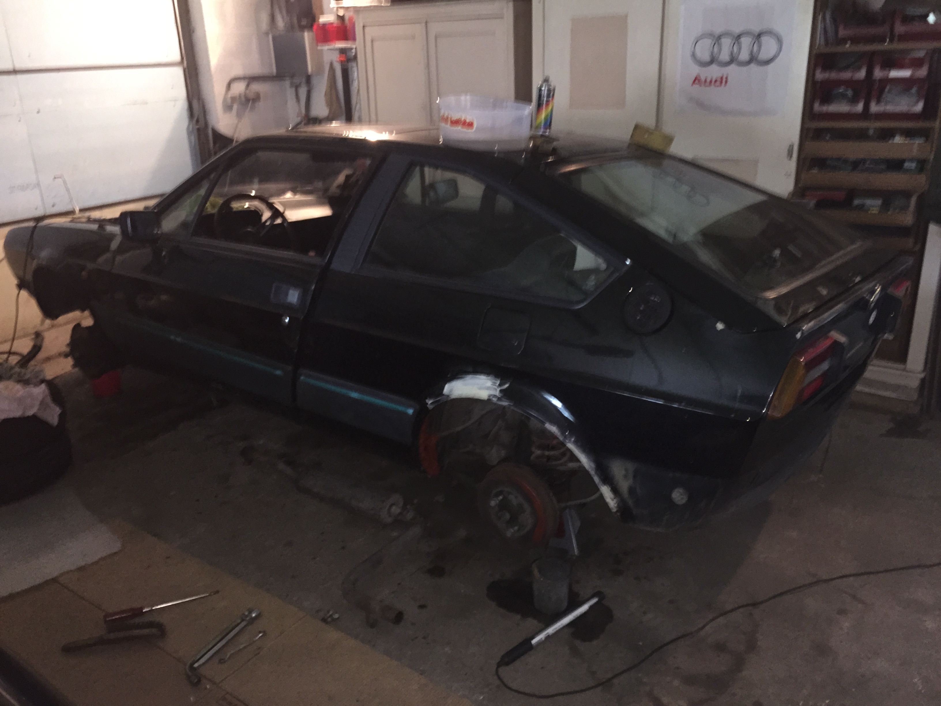

Picture: working on the brakes few months ago..
