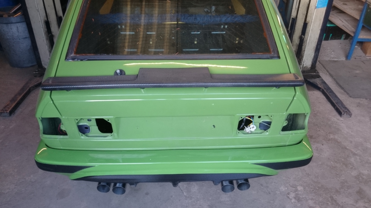

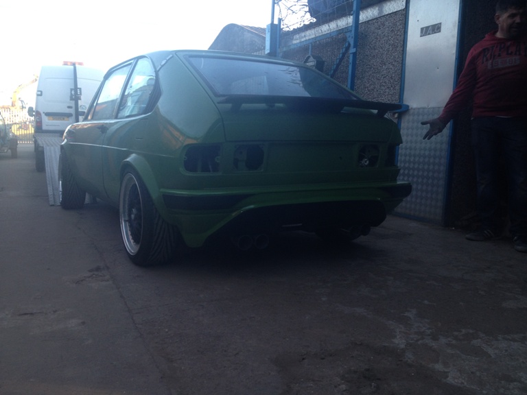

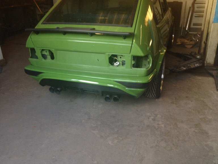

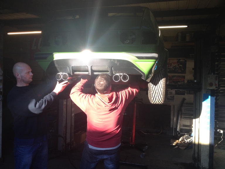

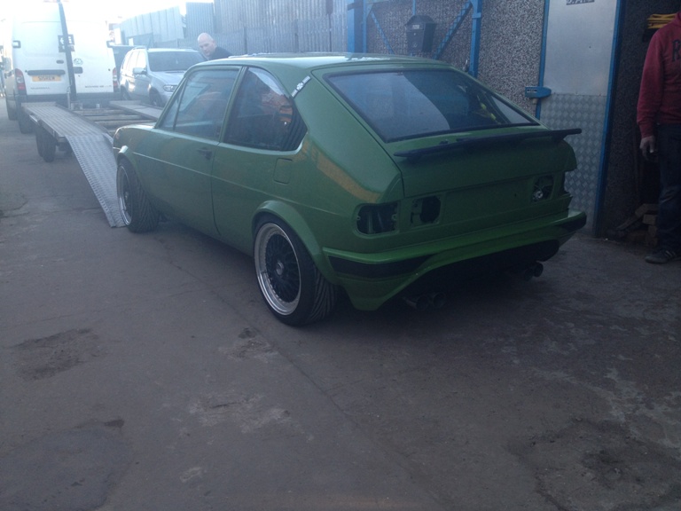

Hi Guys. got home 1/2 an hour ago
Can I just say a huge thanks to Shrew and Wayne for not only taking my mad idea on but for making it 10 x better than I thought possible :D :D :D
Shrew even bought me lunch :o :lol:
I will say one thing though - if the car was the colour Green that Shrews phone takes - I think I would of thrown up :mrgreen:
Only took a few pics as Shrew warned me that Wayne doesn't like "customers" around
Just to prove Shrew did get his hand dirty :lol:
And a couple more
The last couple were short of sunshine as by then it was 5.30Pm
All being well she's coming back here tomorrow, and hopefully get the ICE and brakes sorted (and get a local body shop to have a look at the paint) then off to the rolling road to get the motor sorted :D :D
Once again thanks Shrew and Wayne, I would recommend your work to anyone - some of those bends were amazing :!: :!:

ha ha!
that photo looks so staged! :lol:
I was busier and dirtier earlier in the day i assure you, you can't even make tea without getting sticky fingers, i assure you, tut :roll: that place!
ha ha! :lol:
besides, i wanted to stay relatively clean for our lunch date H!
something of note, Lauren in particular may comment on this one as i recall the Nova exhaust build elsewhere, but recently Wayne had reason to build a few exhaust for his own regular Autograss fraternity, but without the use of pipe collectors, instead blending the pipes smoothly as we did on Harveys manifold intersections today.
The engines in these cars, vauxhall red top for example, are built to regs, and performance return is quite a well known target and expectation, and previously recorded, and when dyno'ed with no more than the new exhaust, (same layout designs, replaced due to damage) there were small, but none the less noted gains here and there, namely in the midrange iirc.
It may take longer, but gains for gains sake, no matter how small really, are worth the effort, and so this method will very likely find its way onto all exhaust from now on.
Collector design has been debated many times before, and no harm in doing so again, but if Wayne has found some real world positive experience from this method, thats good enough for me to run with for now.

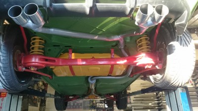

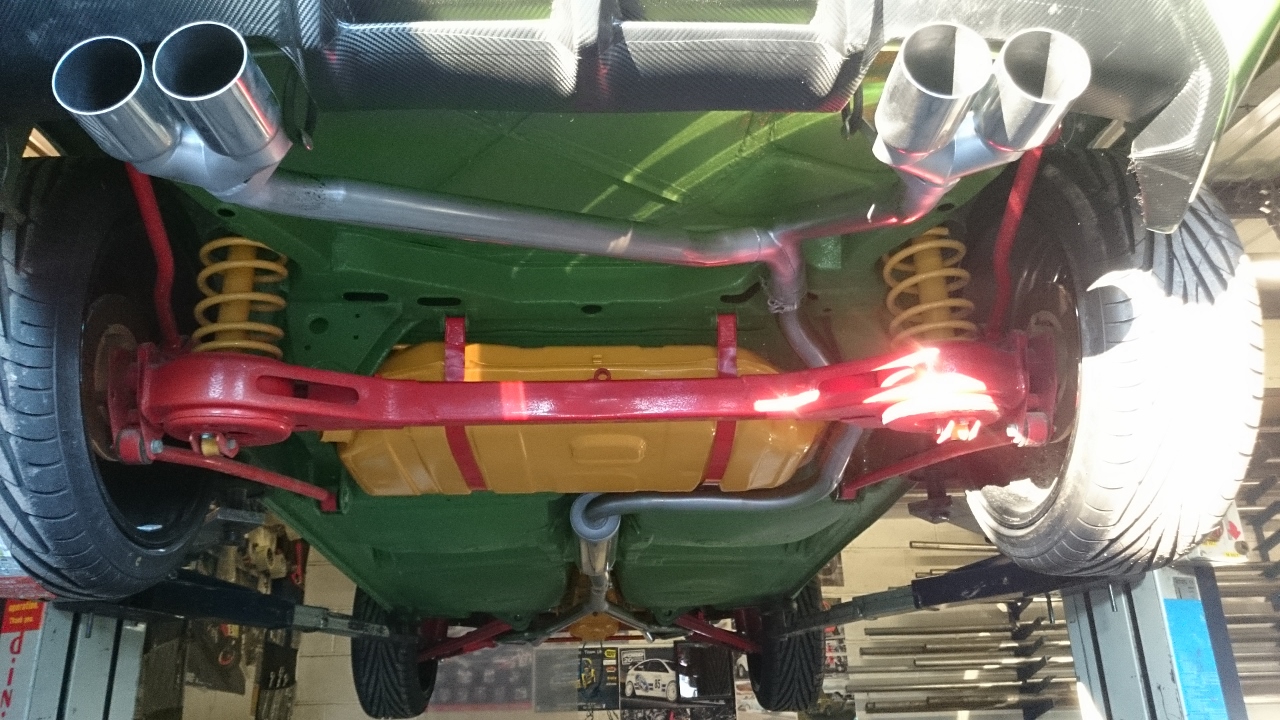

As for design style
I wanted M3 style quads
Shrew choose the size of pipes
Wayne came up with "stepping" the outer pipes back about 1/2 inch which then follows the curve of the bumper
So we all had a little input and the final results are top notch, just have to get her ready for "national Alfa Weekend" on May 10 - 11 :oops:
Now that would be a target :o
