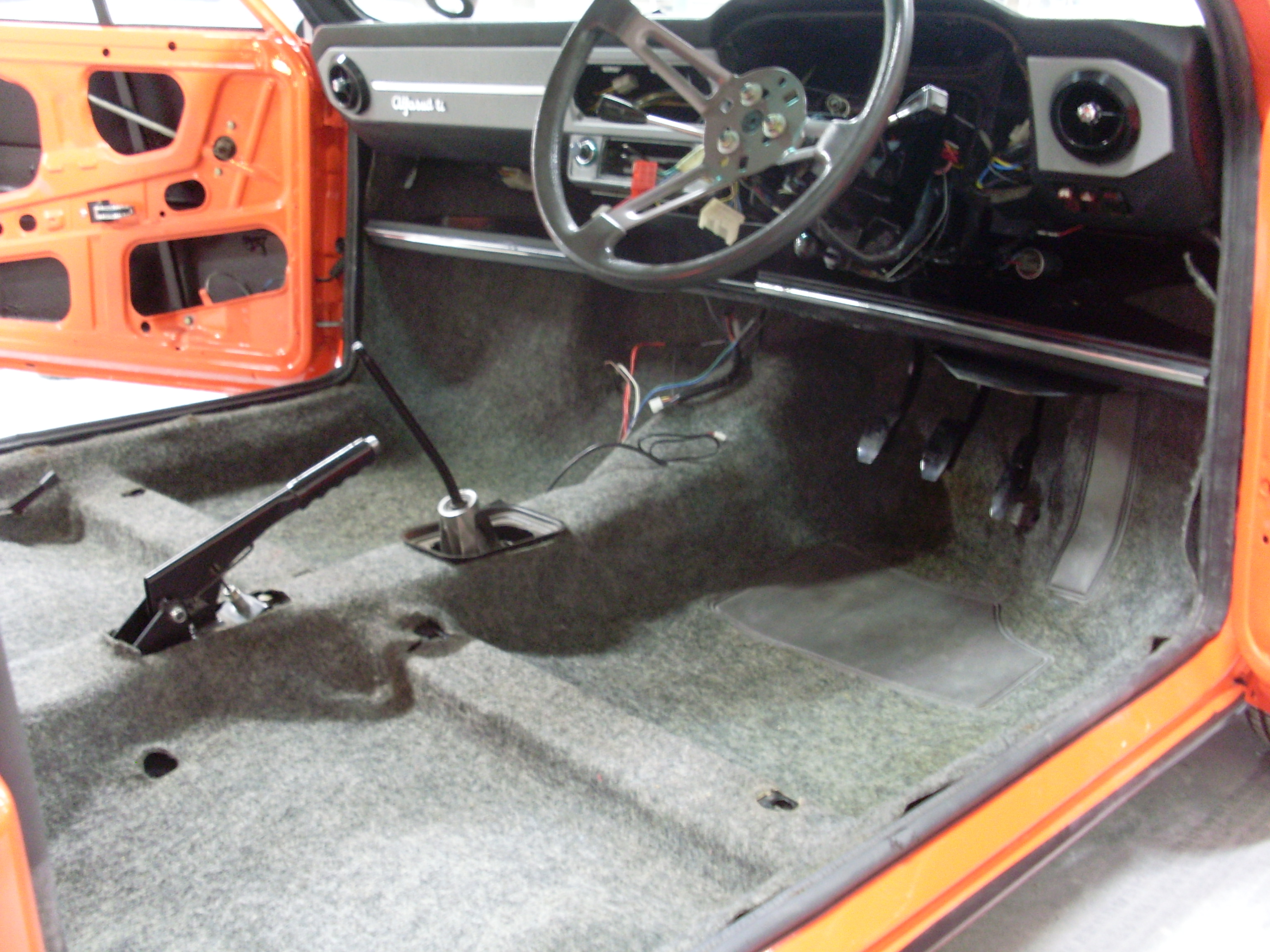

yes, factory original seats lauren. original to this car actually hence why they're a bit thin in places...had them cleaned but still look a bit shaby. due to the delicate nature of the fabric the valeter daren't use anything strong cleaning solution wise or feared they'd fall to pieces!
carpet isn't an orignal S1 ti item though, should be more of a greay/charcoal colour. couldn't find one anywhere.
kieth has a proper one :twisted:
:D

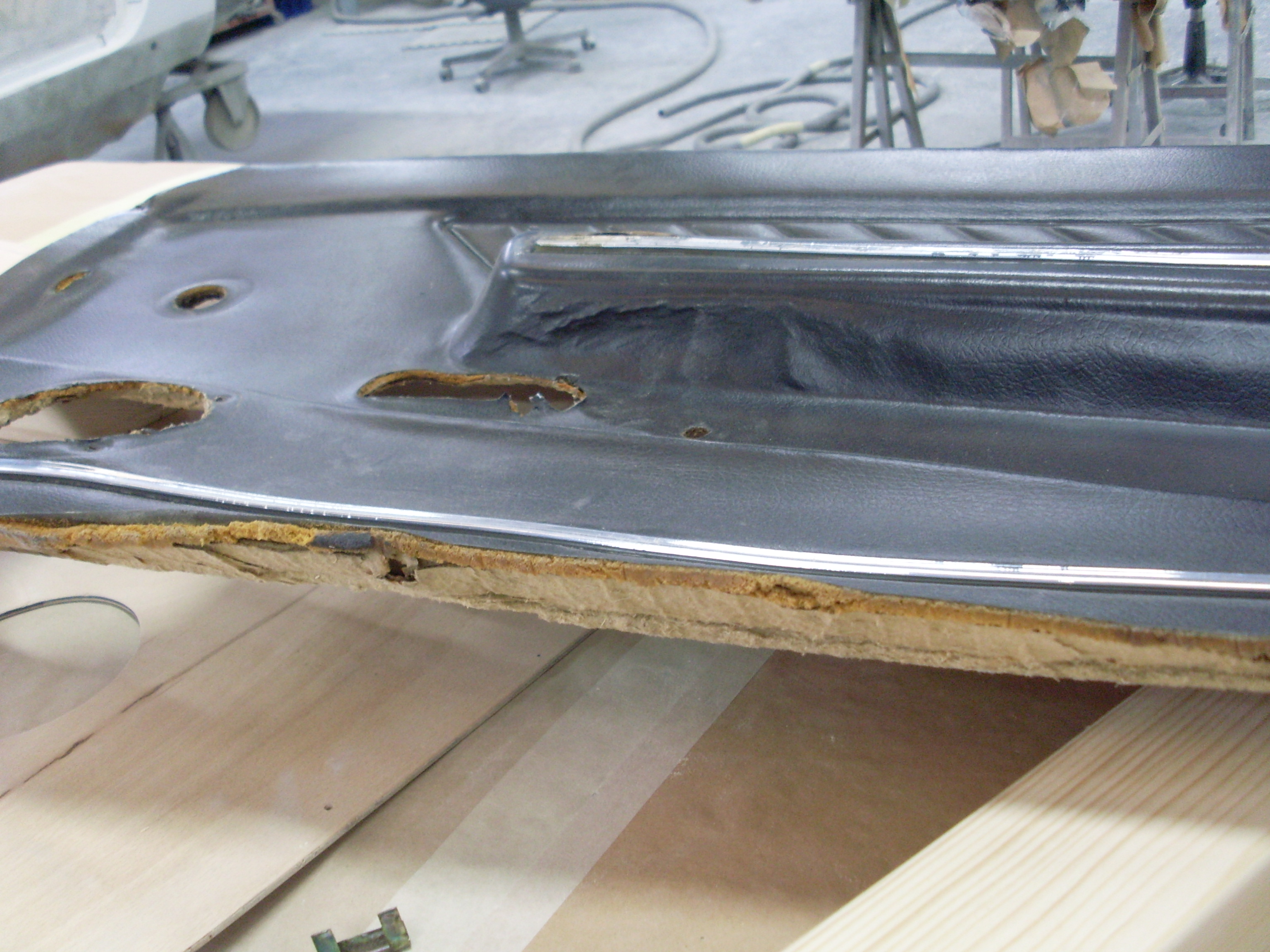

Here you go Kev, like I told you at Duxford you can see the rusty staining in these photos.
I threw everything you can think of at this carpet. Soaked in industrial cleaner, cillit bang, scrubbed with even a wire brush as well as blasted to death with a steam cleaner. Over all it came up well in the end. I did notice it is different to John Trinders carpet. Mine looks more industrial, John's looks more car carpet not left overs from an office re-fit. :D
Door cards are definitely the Holy Grail for S1 cars. I am in the process of trying to make something out of my old ones. I will do a thread on it soon. It will be a retro job mixing original bits with new.

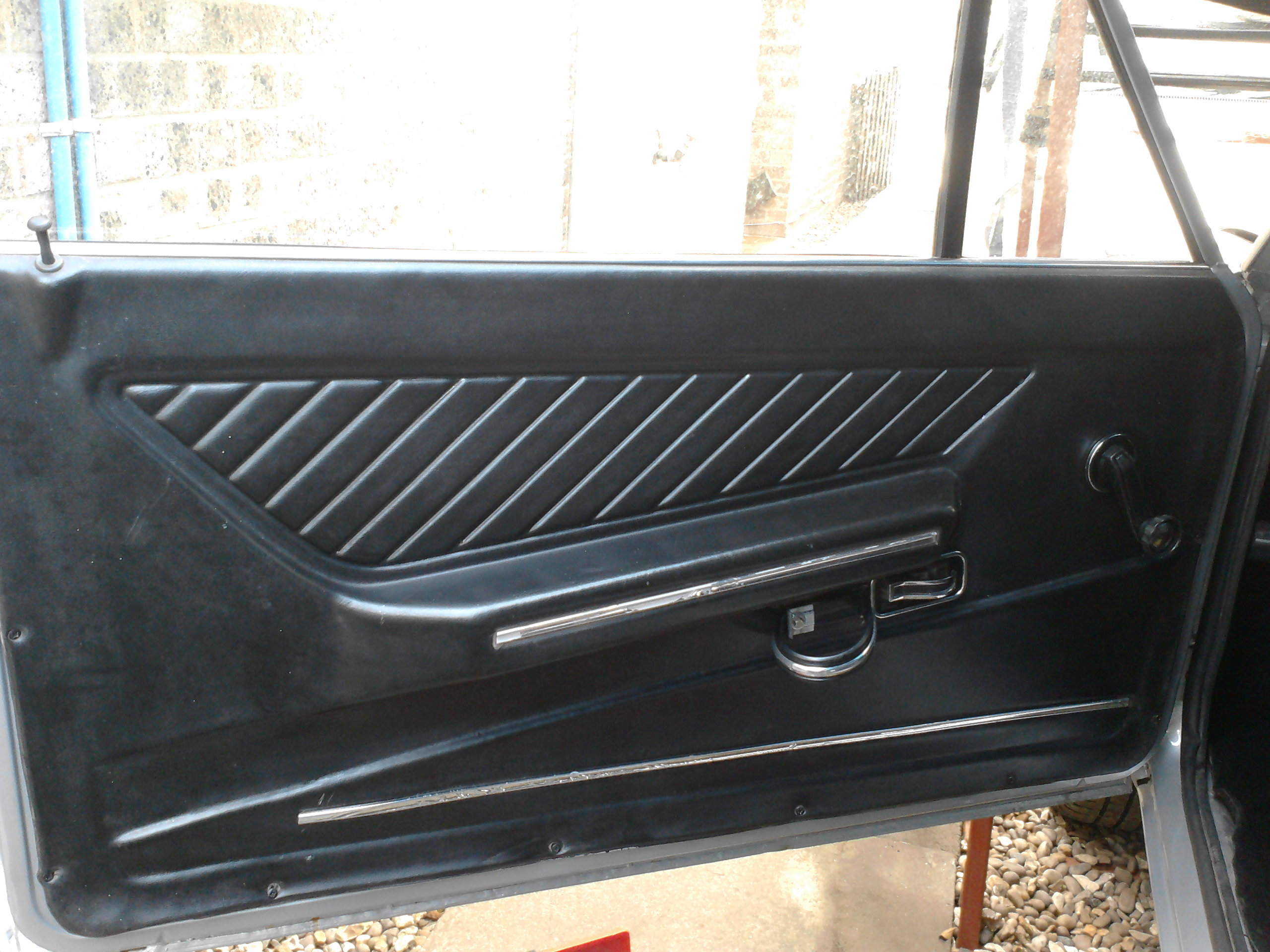

re door cards, - was discussing this yesterday with a customer, series 2 door cards are exactly the same when you look at the back of them, - so I wondered if it would be possible to strip the covering off them ( a series 2 door card ) and recover in vinyl a la series 1, - I have some spare series 2 door cards.......

justsuds wrote:re door cards, - was discussing this yesterday with a customer, series 2 door cards are exactly the same when you look at the back of them, - so I wondered if it would be possible to strip the covering off them ( a series 2 door card ) and recover in vinyl a la series 1, - I have some spare series 2 door cards.......
John
interesting point that john.
know that kieth will be interested to know that also.
i'll see if mine straighten out enough to use

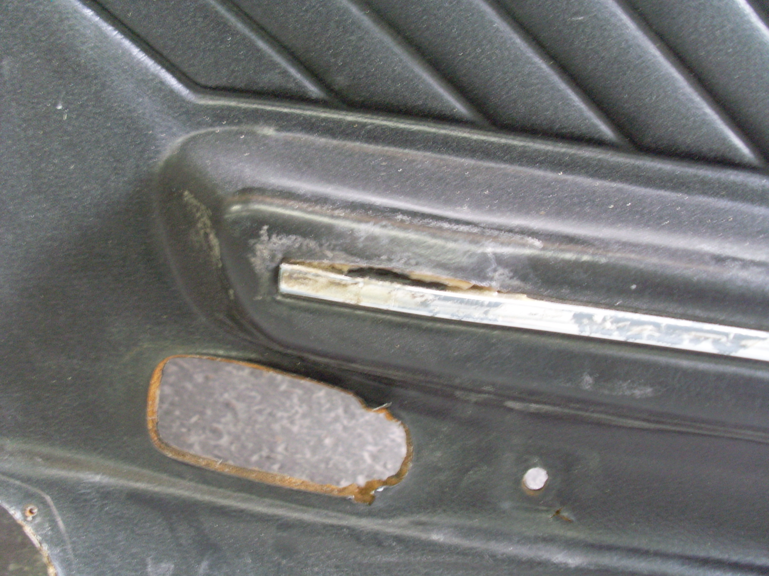

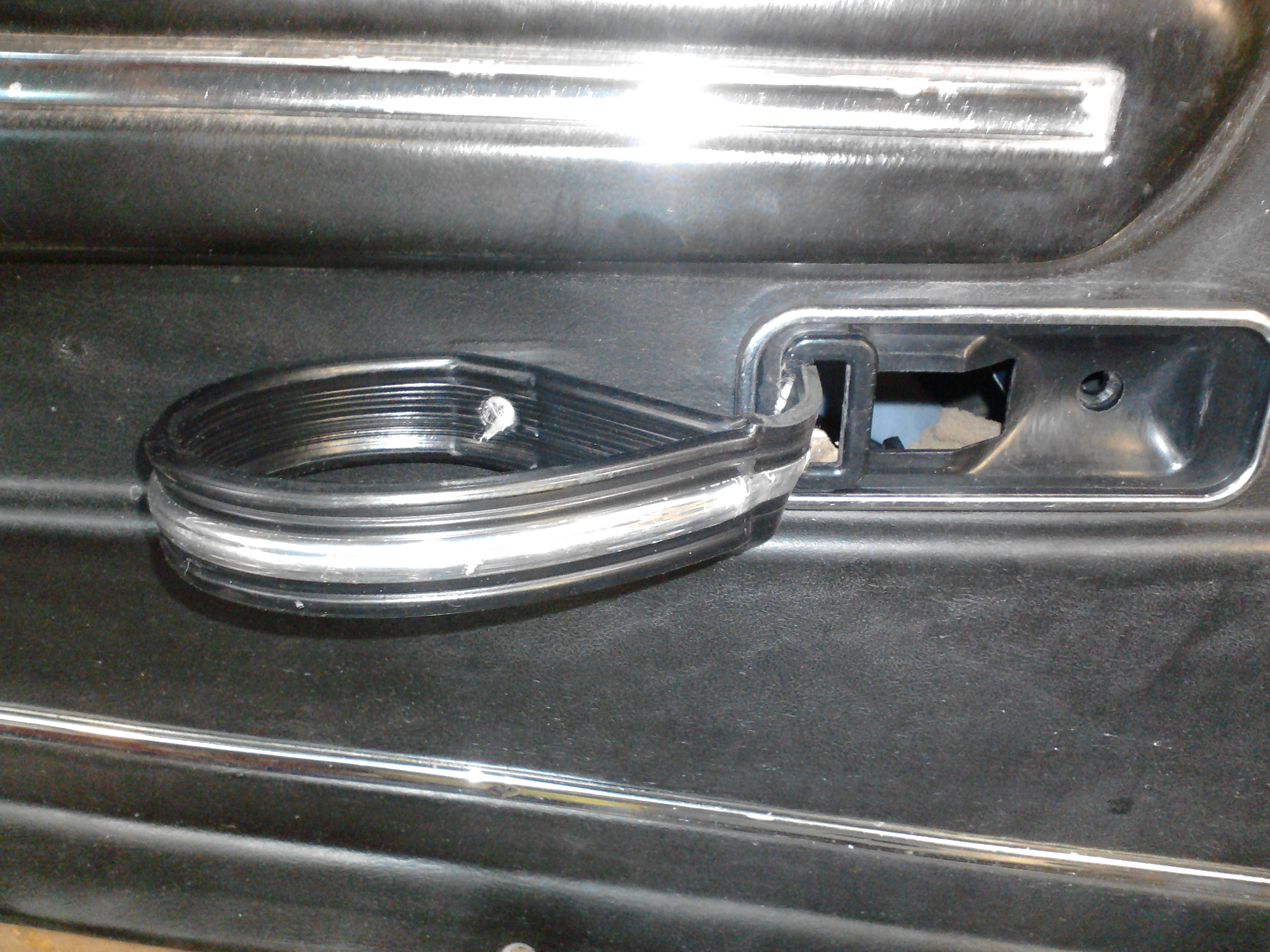

Re: My S1 Sud Ti
can someone do me a favor please and point out what else i need to affix the door pull, guessing it goes something like the pic but probably a bracket or 2 missing to attach it all to the door.
at least i'll know what to look for then :D

One thing that a trimmer friend pointed out to me was that the process used to make the ribbed, triangular panel is a vinyl welding process to the backing board.We don't think it will retain its shape and definition if pulled off. Also, it would be hard to cover the moulded arm rest without creases. It would probably look nicer to just except series 2 trim panels fitted if a nice set could be found.
I plan to make some with a compromise using the welded panel, cut off my old panels and inserted as a feature. A separate trimmed arm rest will be stitched and attached to the new card (3mm ply card, covered in a suitable vinyl). My trimmer friend is rather busy at the moment so it hasn't happened yet. I will put up some pics as I want to make a start soon so that he can fit them into his work schedule. I know they will never be technically correct but it is all a compromise.

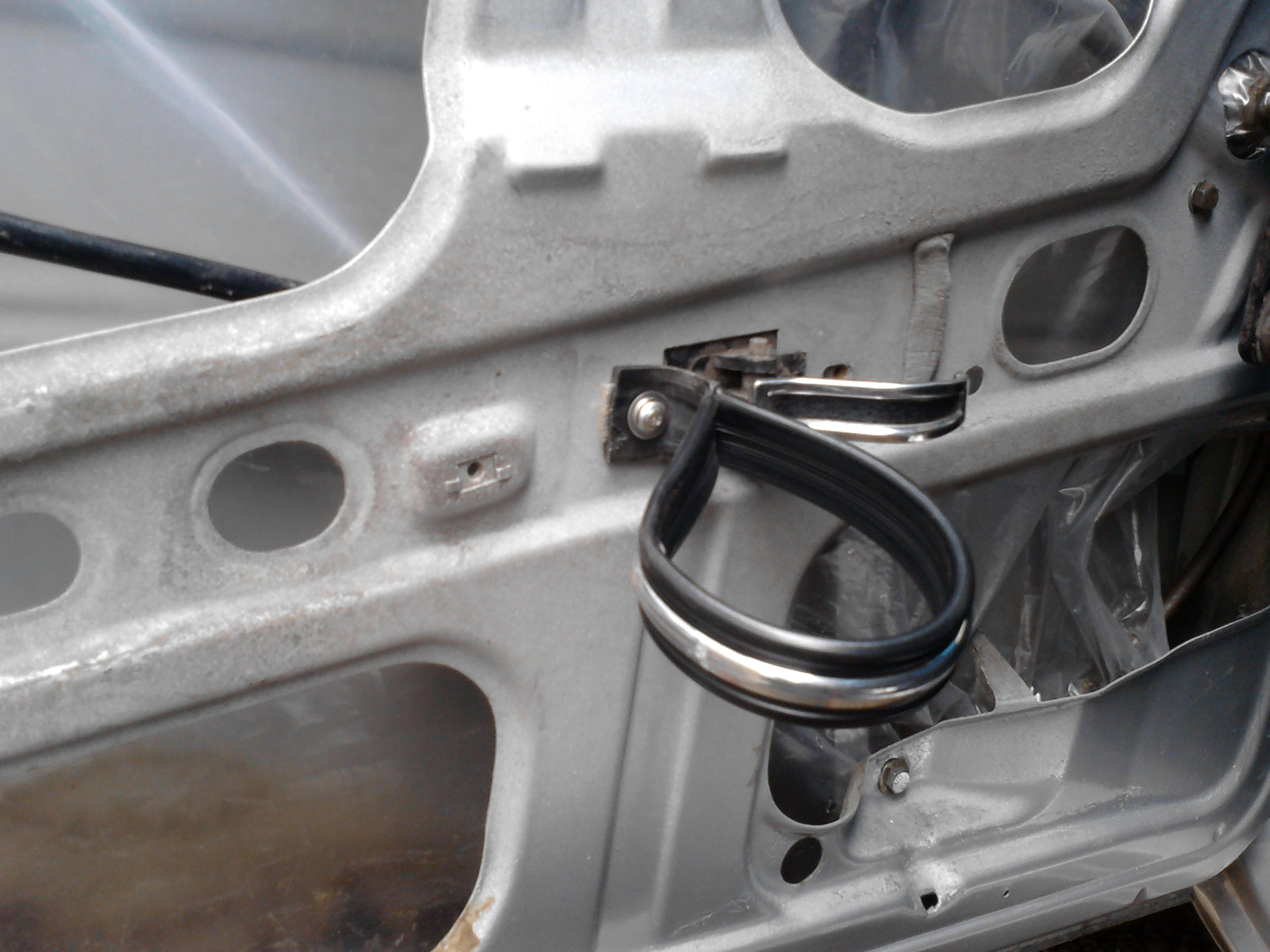

Kev, don't know if this photo helps but it looks like there is a metal rectangular "washer" to add support for the pull. My car only had two old bits of leather belt screwed to the door to make a crude pull. :o
Keith.

Re: My S1 Sud Ti

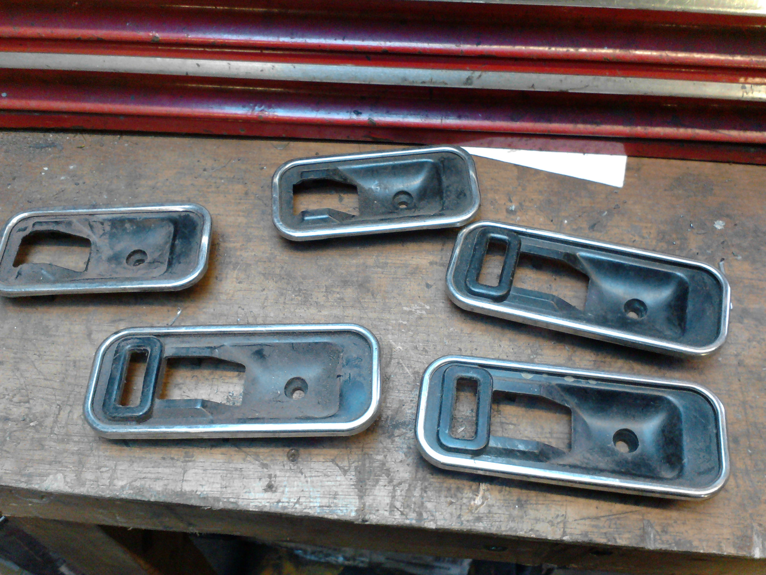

looking at that pic kieth it appears you have the smaller door pull covers rather than the bigger ones in my previous pic.
below is a pic of the ones i found, ignored the smaller ones as they didn't cover the whole hole in the door card, but maybe the cut out is for the door pull to go in behind the door pull cover?
thought there must be some kind of washer for the other mount point half way along as there is an indentaion where it's been fastened before. i'll have a look for them ;)
incedentally mate i found a spare black plastic boot badeg cowling, fits between the badge and the boot, do you still need one?

Re: My S1 Sud Ti
sussed it.
needed the smaller door opener handle covers which luckily i had 2 to hand so cleaned the crud off them.
the door pull itself is held on via the door opener rear screw
door card is them placed over the pull and folded back to be used to pull the door card flush with the rear screw, a little plate with a protective edge on it holds it all on.
simply then fit all the other bits on.
the door card material, vinyl i guess, appears to have shrunk which is probably why the edges curl up rather than the backing going soggy, the screw holes aren't quite in line and appear to be stretching the card. i need to get some more countersunk washers to help stop the screws from trying to pull through.
given the rarity of these door cards i'm ok with the result.
i did actually try and train the curled up edges back into more shape. dampened the curly backing bits then laid the card flat on the bench and placed heavy weights on the curly bits so they stayed flat. i used a couple of car batteries but anything heavy would do. once dried overnight the card was way better than before although not perfect, but now useable i think.
i'm also going to make new fixings between the original holes so the spread of screws isn't so wide.

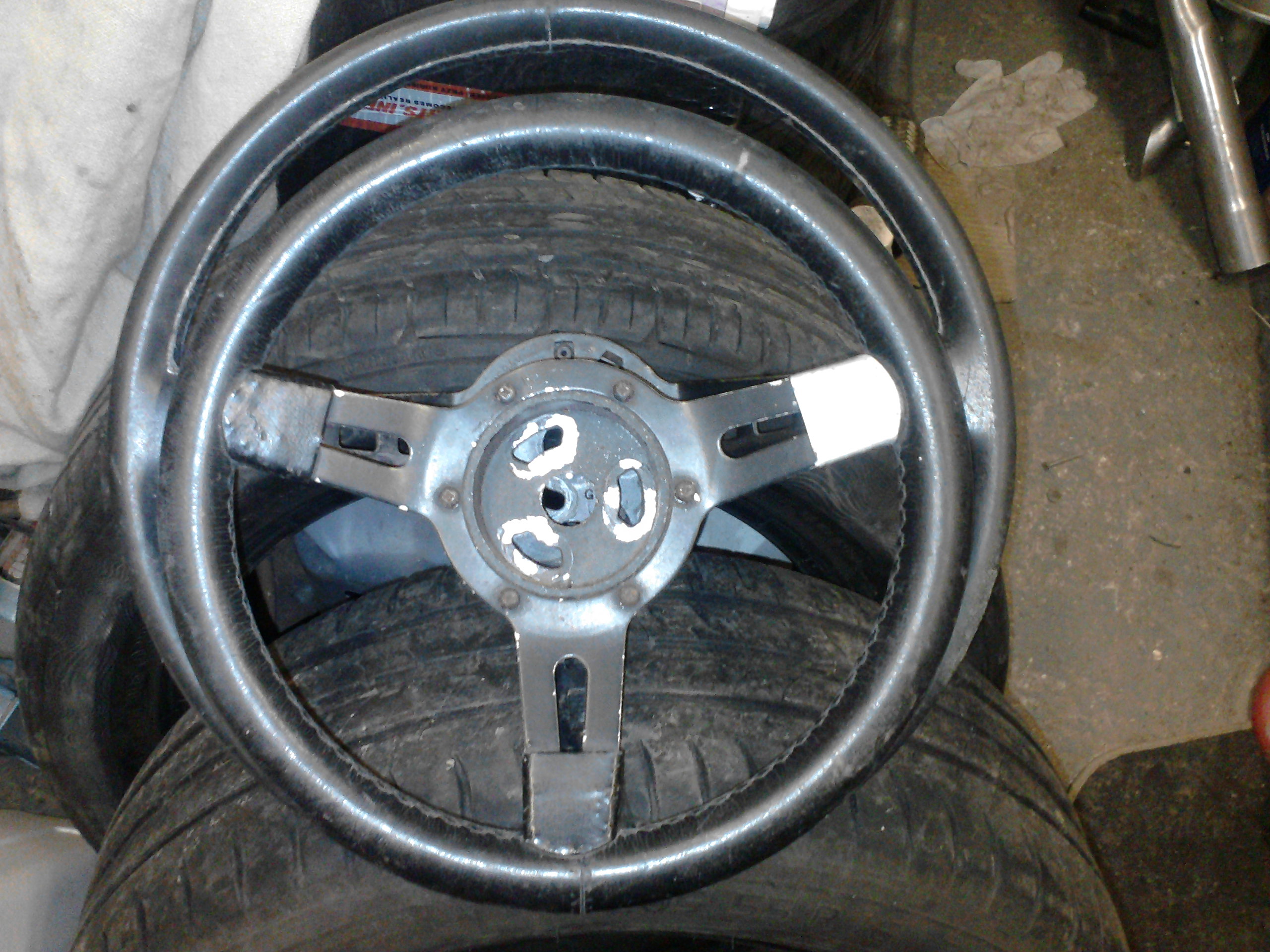

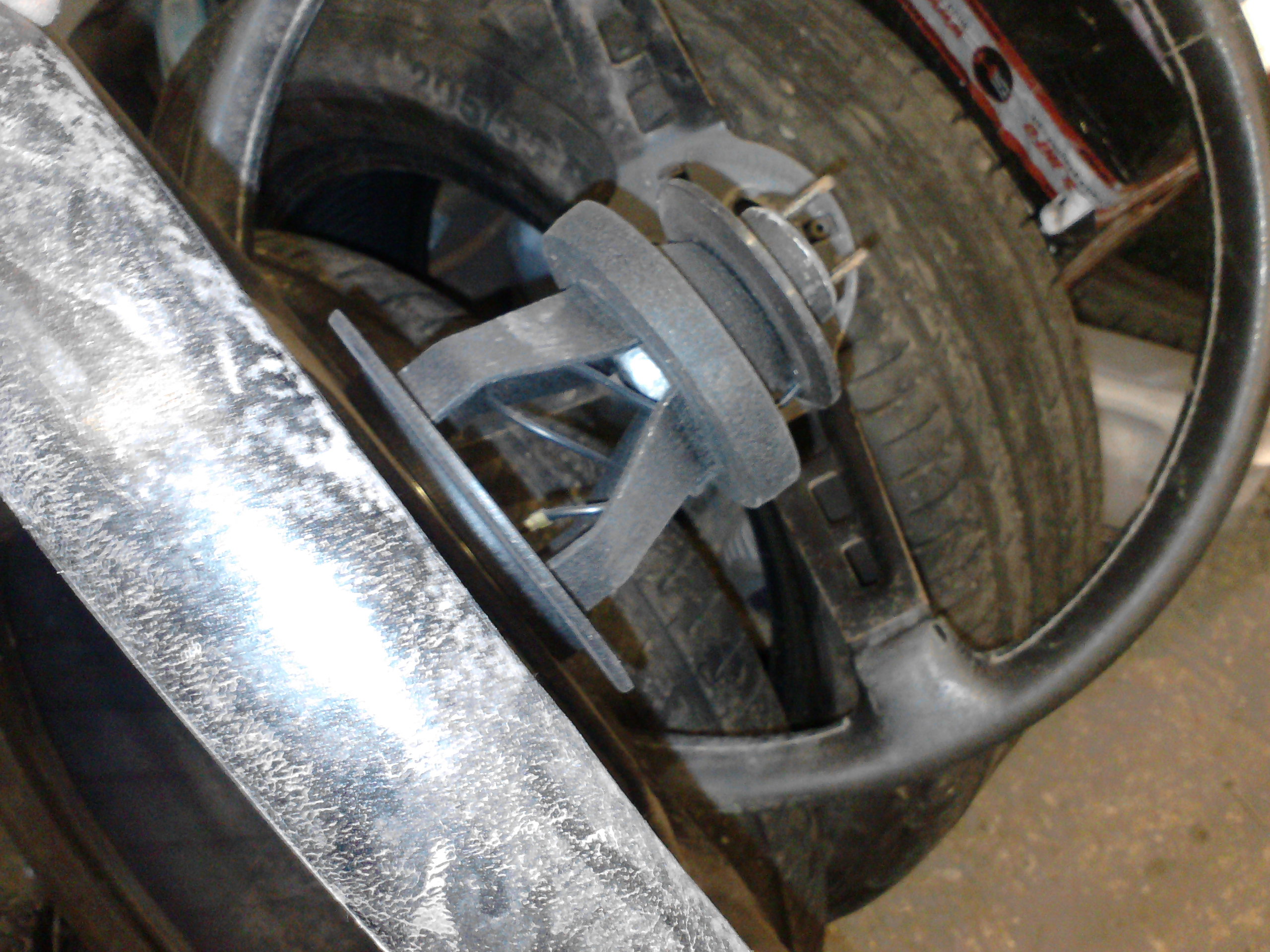

took the dials out again as the rev counter back light wasn't working. was going to leave it until i know nothing else needs mending but couldn't resist fiddling.
also twigged that the steering wheel isn't the correct S1 ti one, although i think someone esle mentioned this to me......
we're on the case to check the stock for the correct one or i'll have to make the alterations to the one i have.
at least i have the correct centre piece

For getting edges of the door card to go back to shape I have found that using furniture wax (which is pretty inert) on the card, then putting it outside on a sunny day with a weight applied worked well.
At the same time the wax protects the staples and waterproofs the card. I did let the wax soften before I started.

(Quote Kev )
Also twigged that the steering wheel isn't the correct S1 ti one, although i think someone esle mentioned this to me......
at least i have the correct centre piece[/quote]
Kev, I have a spare one if you need it. It was on the car at Duxford. It has been blasted and painted as you saw.
I have decided to put the original wheel back on to keep it with the car. Got it off Shrew a while back.
Let me know if needed.

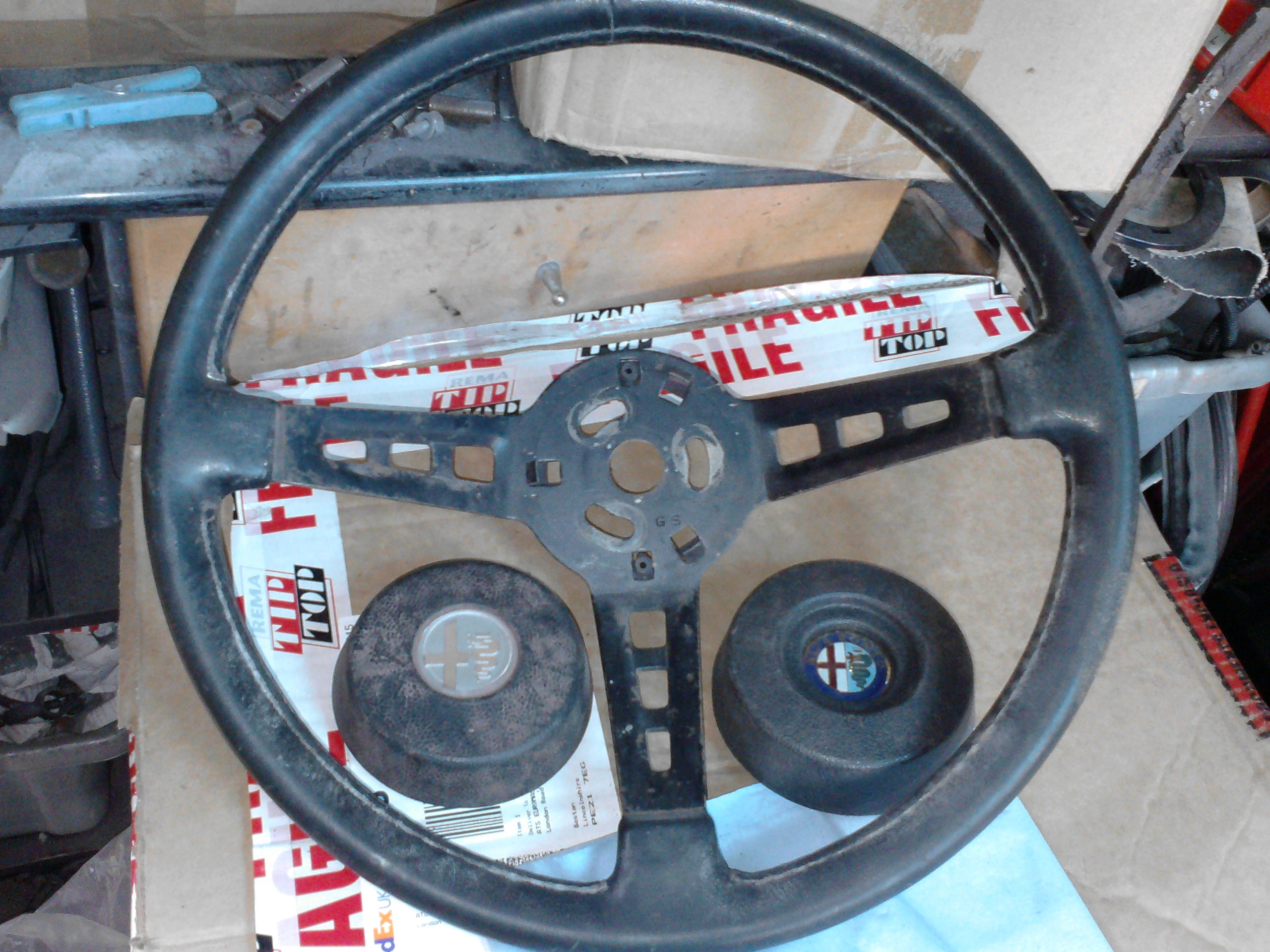

Re: My S1 Sud Ti
No probs, I got it off Shrew hoping it would have a thicker rim but it is the same as my original.

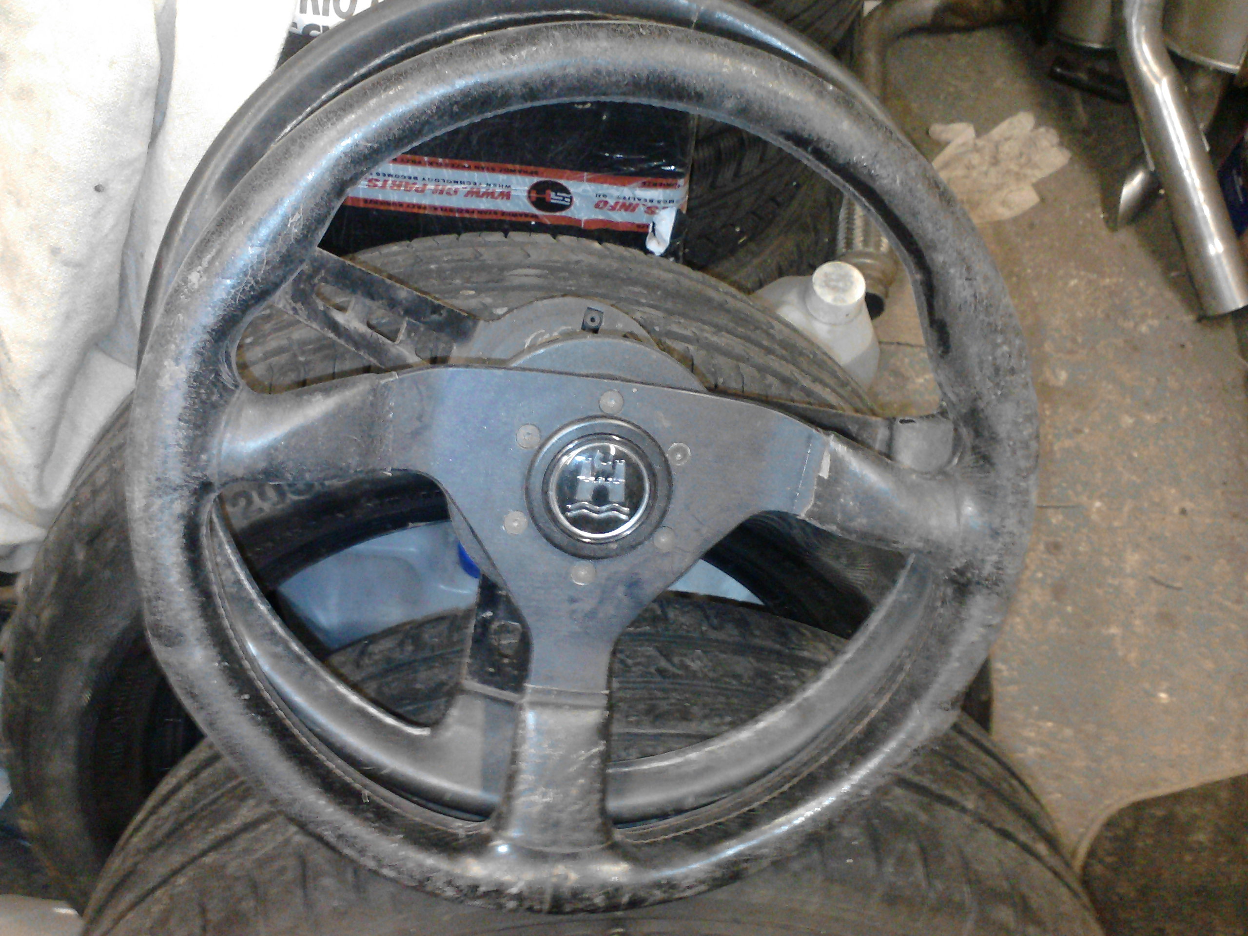

The one you have there looks a thicker rim, any ideas what model it is off?
Re: My S1 Sud Ti
as far as i know it's an S3 ti one mate, looks like the one VJM had.
if you want a ticker rimmed one i have a couple in the shed....

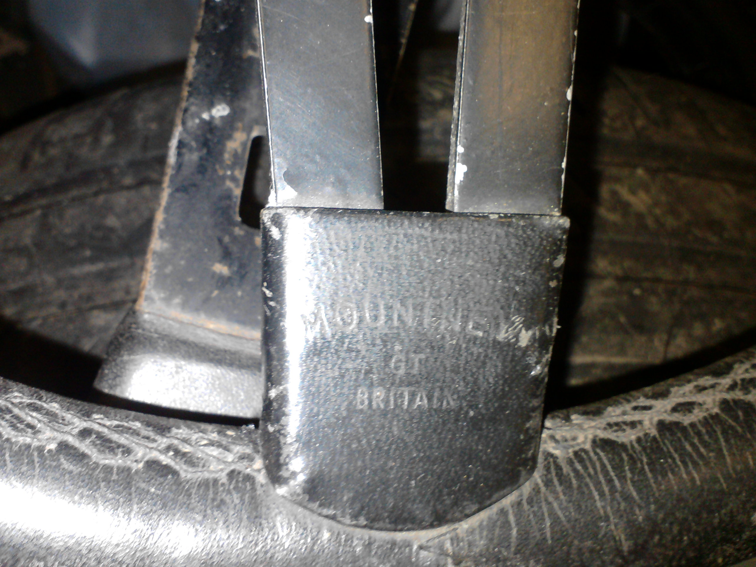

Re: My S1 Sud Ti
got a mountney one that has a 30mm thick rim, S3 one has a 25mm one.
also a momo one that has an oval section rim, 27mm x 35mm
Posts: 2894
Re: My S1 Sud Ti
Hi Kev,
Just measured the S1 wheel and it seems to be about the same as the S3.
The photo you put up looks thicker, maybe it is just because it has leather around it.
Thinking about it, this may sound silly but is the rim circular rather than bevelled?
